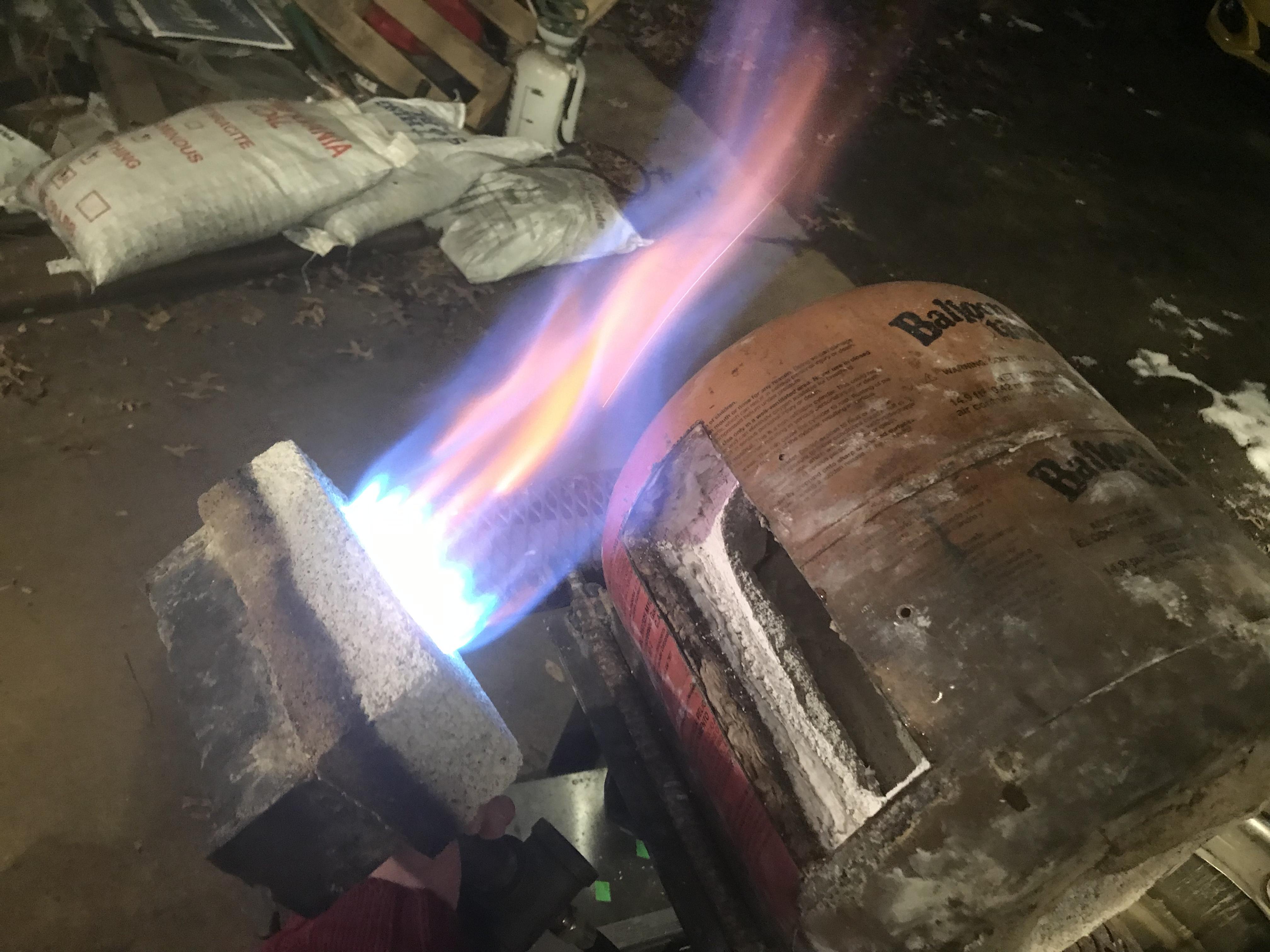

Burning outside the forge:
  • Replies 1.1k
  • Views 238.4k
Looks a little bit rich John, close though. The orange is probably calcite in the flame. It might be a really rich flame but it's only coming from two outlets so I doubt that.
Well, I can always revisit it in a month or two -- however long it takes the excess calcite to burn out -- and retune the burner as necessary.
It  just occurred to me the yellow/orange flames may be crayon rems burning out. I'd just let it run and get good and hot. That should take care of any wax, wrapper, whatever is left. Heck, did you use Crisco as a release agent? The residue has to burn out too.
It looks good John, maybe a little fine tuning but that's no big deal.

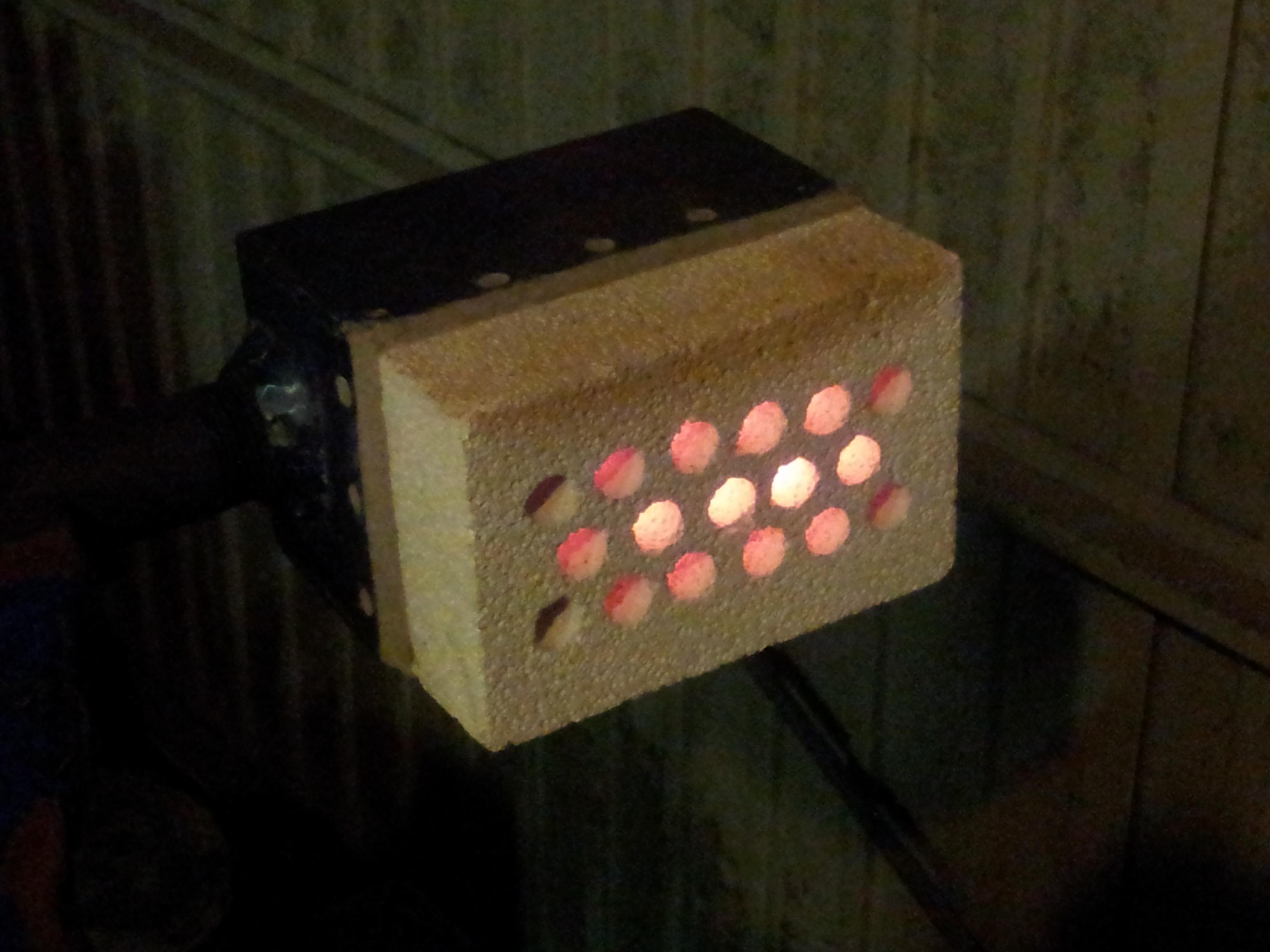

Hi there,
I'm Tim,  a wrinkly engineer (mid-50s) from Bristol in England, who has been reading up for months, so that I don't ask the silly questions (too much ;) ).
Anyway, after building an IFB forge, fitted with a 3/4" AMAL Propane injector & 9" iron nipple, I have been using it sucessfully for over 6 months, making tongs and tools, and the occasional blade to practice quenching & tempering.
I then got caught up in the NARB thread and started planning my own multiport burner.  Just as I was finishing the design, Judson Yaggy posted up his NARB based on a drilled-out IFB, just like I was building! Cool!
So I went ahead and finished off my NARB. The plenum is folded and welded-up stainless plate, with 2 3/4" pipe bosses welded to the sides (one on the long side and one on the short, so I can mount it in different orientations and just use a blanking plug on the un-used boss).
So it lights and burns OK, and with the AMAL injector I can adjust how rich or lean it burns. In free-air it looks ok to me, (but I am Red/Green insensitive so not the best judge).

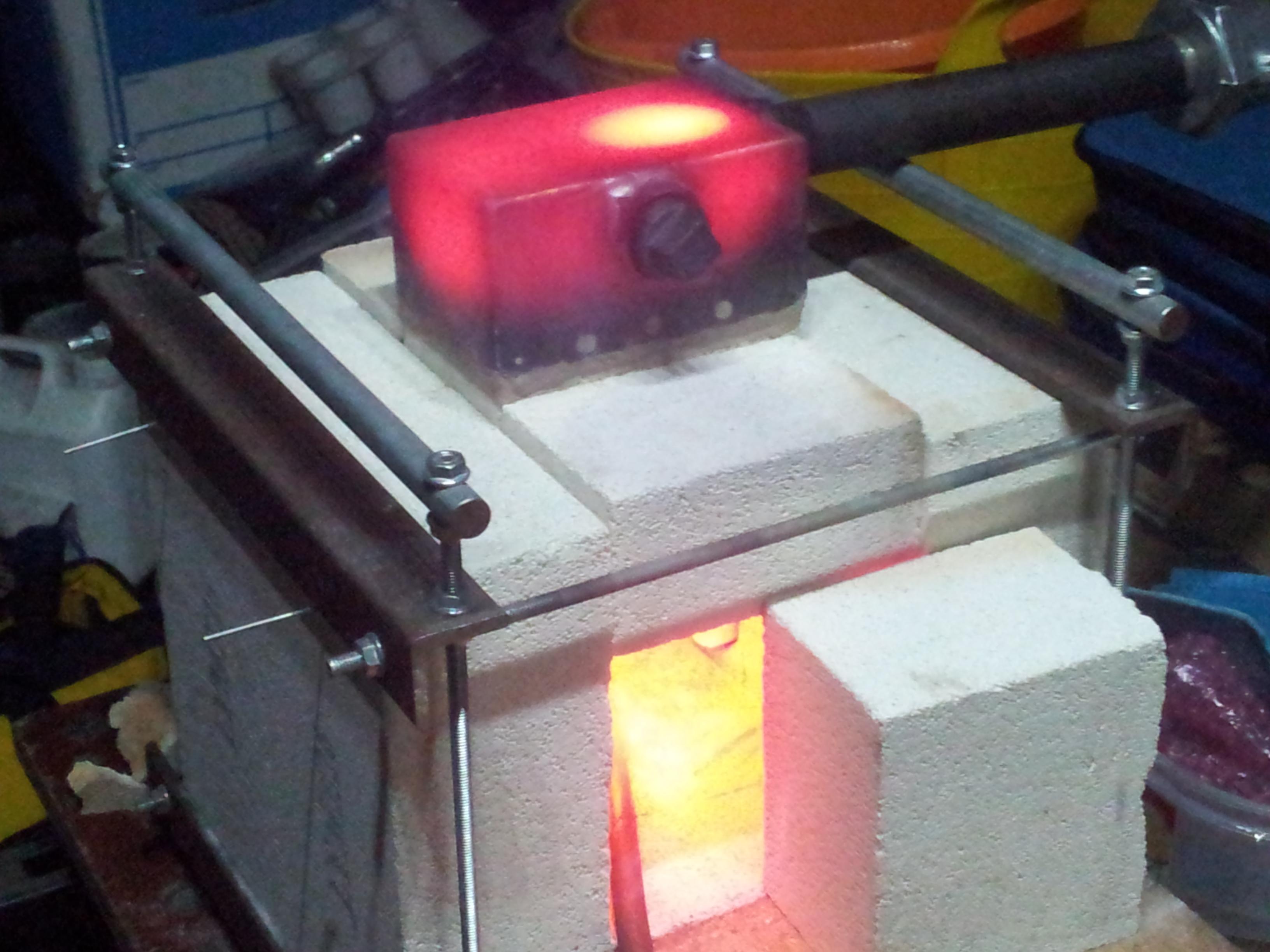

The issue I have is that when fitted into the top of my forge and turned up to ~5psi, the plenum starts to glow red-hot, with a dull-orange-hot patch appearing on the top.  Now I know the plenum is going to get pretty hot, and I know stainless steel is a poorer conductor of heat than mild steel, so its possible that the heat isn't getting disipated as effectively as it would be if it was mild steel construction.
I was concerned that I might get ignition in the plenum, but for the 15mins I ran it, it seemed stable and the plenum didn't appear to get any hotter.
Any suggestions/observations regarding this Plenum glow?
How large are those ports?  They seem big by my eye gauge.
I suspect it is burning in the plenum.  That fourth image looks like it is still running?  The last image looks like the flame is burning right after the injector.

It's burning inside the plenum. The outlets are too large so the Fuel Air Mix (FAM) velocity is too low to prevent it burning back once it warms up a little. And I MEAN a LITTLE. The intense IR from the forge isn't effected by the FAM flow, so the thin walls between outlet holes absorbs heat faster than the flow can cool it.
Once hot and burning back it looks like the flame is right inside the plenum's margin and the flame exiting the outlets is what's left over. I have 19 crayon sized outlets driven by a home made T inducer. My T burners are nowhere near as effective as an AMAL "injector".
I think you need more than a little tinkering here Tim, looks to me like you're looking at a tanking this one for a redo. I made a plenum with tabs so I could screw it to 2" x 2" wooden test burner blocks till I found the number of outlets and inlet orientation that worked best.

Hi Frosty,
I initially based my hole diameters on Judson Yaggy's NARB dimensions, where his 5/16" holes come out as 7.9mm, so I converted to 8mm for my outer 2 rows, and 7mm for the inner row, so I could widen out as needed.
The initial testing with these dimensions kept blowing out, so I widened the inner row from 7mm to 8mm and it seemed much more stable. I also added ~10mm depth of flare at each hole exit, taking it out to firstly a 9mm and then a 10mm step flare. These step flares are probably why the holes look bigger than they should, but at their narrowest, the holes are still 8mm (~5/16") in diameter.  Judson's NARB was functional at these dimensions.
I can see from the glowing IFB core that spacing out the holes more would help to reduce heat build-up in the core, so I can easily knock out the old IFB and drill out a new one. The Plenum was designed to be a slight resistance fit over the end of a firebrick, so I can get 3 to 4 test blocks out of a single IFB, saving casting and drying time is short with the fire cement bonding the IFB in place.. Once the design is optimised I was planning on casting a more heavy duty version, but for now, IFB is fine for development.
I don't think its helped by the vertical mounting position, and for my future Butane Tank forge, I will be going for a side entry slightly down-facing position.

I like the plenum design.
Port size/quantity seems to be a bit of a balancing act.  You need enough ports to let the inducer breath but they need to be small enough so the FAM velocity is above the propagation rate.  You stated that it was blowing the flame off at the smaller holes, was that before the flares?  I think you want the streams moving fast enough to be close to blowing off at start up.  This is where the step flares may help hold the flame or starting at a lower pressure and increasing once the block heats a little.  As the block heats and begins preheating the FAM, the propagation rate increases, so you want the FAM streams moving fast enough to prevent roll back.
Before you scrap the block, block one/some of the ports and see what happens.
I think the increased exposure to IR tapered outlets represent make keeping the burner block cool enough to prevent burn back much more unlikely.
Trying to slow the flow by modifying outlets is doing it the hard way. if it's too fast, add an outlet.

Listen to the others, but just for comparison; my plenum never gets so hot that I can't touch it....even at welding heats in the forge.  The flame should never enter the plenum (except maybe a blowback when shutting off).

Hi Another FrankenBurner,
Initially 12 holes at 8mm and 5 holes at 7mm, the flame burned fairly stable outside the forge, and facing upwards, and I could adjust the FAM through rich to lean pretty well.
But when I mounted the NARB upside down in the top of the forge (as seen in my previous photos) the flame would only stay on if the FAM was adjusted to very rich, so yellow flames were pouring out of the forge openings at both ends. When I started to lean out the mixture, the yellow would go and then the flame would pop and blow out. I was probably at a couple of PSI at this stage.
It was after this that I took the 5 x 7mm holes up to 8mm, yet still had the same behaviour, so added the step flares to the holes. The flame would now stay on in the forge without blowing out, but we see the burning in the plenum now.
Hi frosty,
I think my holes are too close together, as the web between them is what glows the hotest, but the holes around the edge don't at all. My next test will be with more widely spaced holes and maybe slightly more of them and slightly smaller, maybe angled outwards to give more material between each hole at the hot face?
