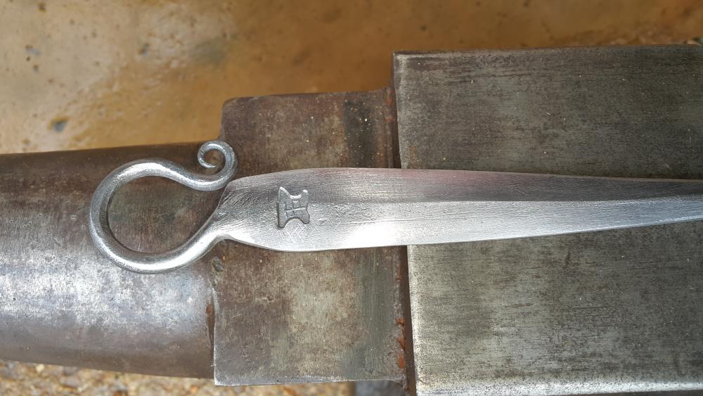

2 tine roasting fork (small)
Here is a 2 tine roasting fork.. Made from 1/4 X 1" Just a touch of whitesmithing and then hand wire brushed.. No finish..
I like the overall shape but have to ask about the filleting by the fork end. Is there a purpose for it or is just for looks?
Just a finial/decoration.  but it also adds strength to the junction of the shaft to tines.

Thank you..  I do make sets..  This was actually a little smaller design in a toasting fork.. The fillets are usually a little larger..

Not to bad forging wise..    maybe 30minutes of forge time.. 2 minutes with the file and another few with the wire brush.. This was made in the old blacksmith trailer and the floor would bounce about 1/2" with every hammer blow..

Since you guys are liking these.. Here is the fork, as forged and here is a pair.. each fork going to a different person..

Thanks guys.. The bigger one is for hot dogs and marshmallows.. Have very little curve to the tines..

let us know how you made out.. Pictures to please..    6lbs for initial forging of the shaft. 4lbs for the majority and 2 for the finish work and turning of the rat tail finial..

Make me feel like a wimp. My main hammers are a 2lb drilling hammer and a ballpien that's probably 24oz or so. Only on occasion do I really reach for my 3 or 4lb hammers.
