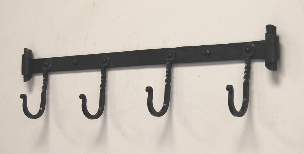

Al Stephens Posted September 1, 2016 Share Posted September 1, 2016 Years ago I came up with a beginners project that would teach a lot of basics, and give the student a usable completed project to take home at the end of the day. I've used this with 10 year old 4-H classes, boy scouts, college adult education classes, with young and old, most of which had never done any forging, and every student has completed it in a day. It's a simple 4 Hook Coat rack, I'll let everybody figure out everything it teaches. Link to comment Share on other sites More sharing options...

VaughnT Posted September 17, 2016 Share Posted September 17, 2016 On September 1, 2016 at 8:50 AM, PVF Al said: Years ago I came up with a beginners project that would teach a lot of basics, and give the student a usable completed project to take home at the end of the day. I've used this with 10 year old 4-H classes, boy scouts, college adult education classes, with young and old, most of which had never done any forging, and every student has completed it in a day. It's a simple 4 Hook Coat rack, I'll let everybody figure out everything it teaches. That's a really really good idea. I like that it covers all the bases but also builds on very simply things to end up with something that they can use for the rest of their lives. It's not too hard and it's very practical. One of the things I usually get new people to make is a simple hook from a store-bought nail. Smaller nails can also be used. Combine several on a plank and you have a nice rack for the hallway or kitchen without much fuss or preamble. It's not much, admittedly, but it's something everyone can use in their home, even if it's relegated to the garage or garden shed. The key point is that it shows the student some basic stuff like bending and punching but isn't too technically difficult -- and it opens their eyes to the possibilities in found objects. I've had students that have never swung a hammer in their entire lives, so I always assume the worst when it comes to their technical abilities and like to have something like these hooks for them. Link to comment Share on other sites More sharing options...
