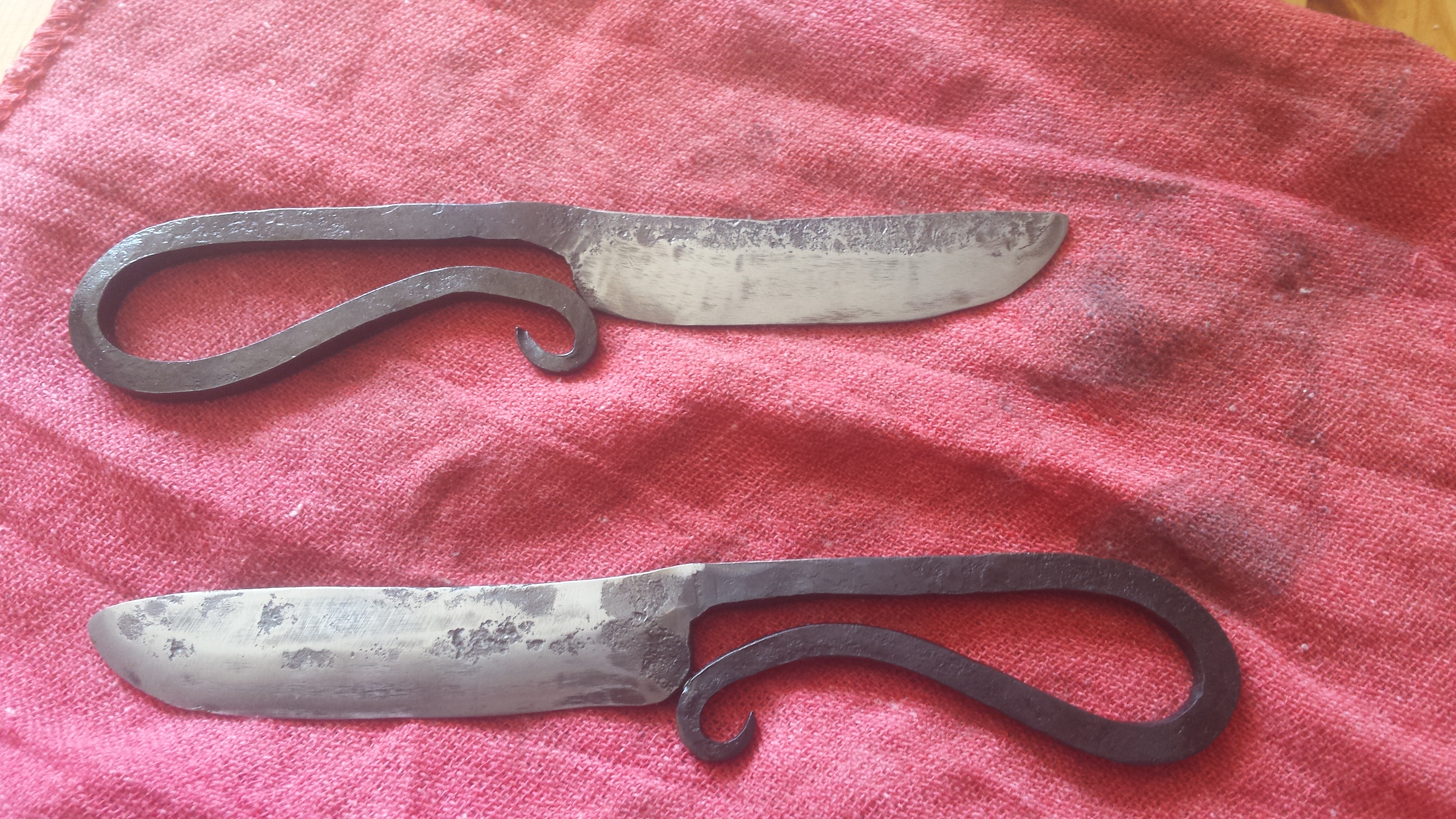

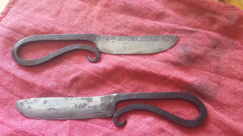

D.C. Posted August 27, 2016 Share Posted August 27, 2016 So I was asked to be the on-site blacksmith at our local rendezvous. In repayment for me doing demos, I'm given a prime location free of charge, and can sell any period appropriate items. Sounds great, but here's where I could use some advice. Equipment: I am knocking together a dirt box side draft(thank you Charles R Stevens) and simple bellows. My 1908 Trenton at least looks the part, but when did things like post vices, and hand drills really enter the scene? Demo items: Well, flint strikers are a given, but I was also considering small "medieval "style knives that are so popular. These can be hammered real close to finished, touched up with a file, hardened and a rough differential heat treat.(knife makers be kind....I stray meekly into your realm). Besides toasting forks and fire pokers, what do you find is easy to demo, but also sells? Thought about nails, but I'd have to practice that. Any and all advice is helpful. I've frequented rendezvous for years, but this is my first time participating. Thanks! Link to comment Share on other sites More sharing options...

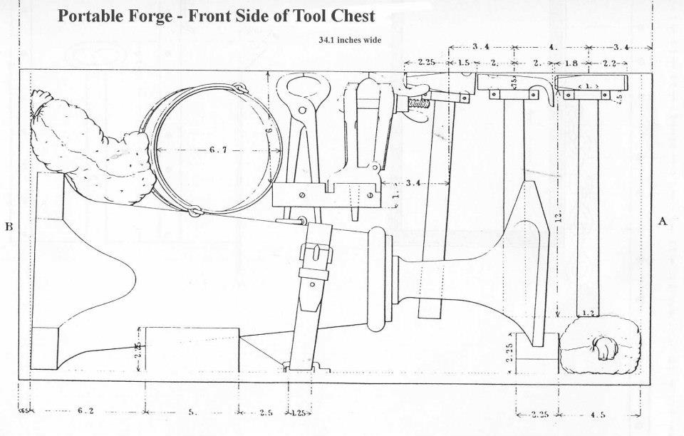

David Einhorn Posted August 30, 2016 Share Posted August 30, 2016 1840 is close to 1850s, so documentation on what was used for backpacking in during the 1850s are likely to apply to the 1840s. Hand vise yes. Here is a small-stump-anvil and hardy-mounted-vise documented in the 1850s by and for use of the U.S. Army. Leg vises were not carried on horse back and not mounted on wagons,,, for wagon mounted vise see wagon/tongue vise. Link to comment Share on other sites More sharing options...

D.C. Posted August 30, 2016 Author Share Posted August 30, 2016 Holy smokes Dave.....that is invaluable! Like I said, they're pretty lax for requirements. But the history nerd in me is screaming..."build it...build it...." MAYBE not the stand, but the stake anvil is too cool NOT to fabricate. The clamp may be beyond my skills though. Then again, I'm with Frosty...THE TEMPTATION to use the "tongue vice" could overpower me. And that wouldn't be the best demonstration of smithing. Even if it is accurate Link to comment Share on other sites More sharing options...

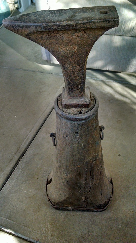

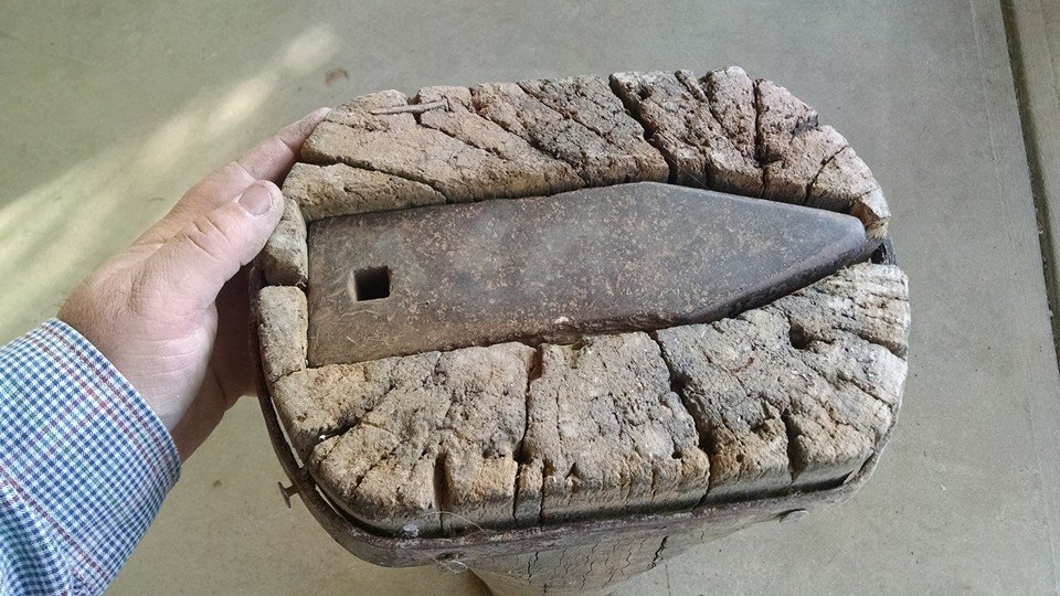

John McPherson Posted August 31, 2016 Share Posted August 31, 2016 Someone posted these a while back on facebook, IIRC. They still exist, if rare. Link to comment Share on other sites More sharing options...
David Einhorn Posted August 31, 2016 Share Posted August 31, 2016 Stock vise or Wagon-tongue vise. Used on wagons and army "Traveling Forges" Link to comment Share on other sites More sharing options...
JHCC Posted January 18, 2017 Share Posted January 18, 2017 On 8/30/2016 at 8:48 PM, John McPherson said: Someone posted these a while back on facebook, IIRC. They still exist, if rare. So, the anvil packs inside the stand? Cool! Link to comment Share on other sites More sharing options...
