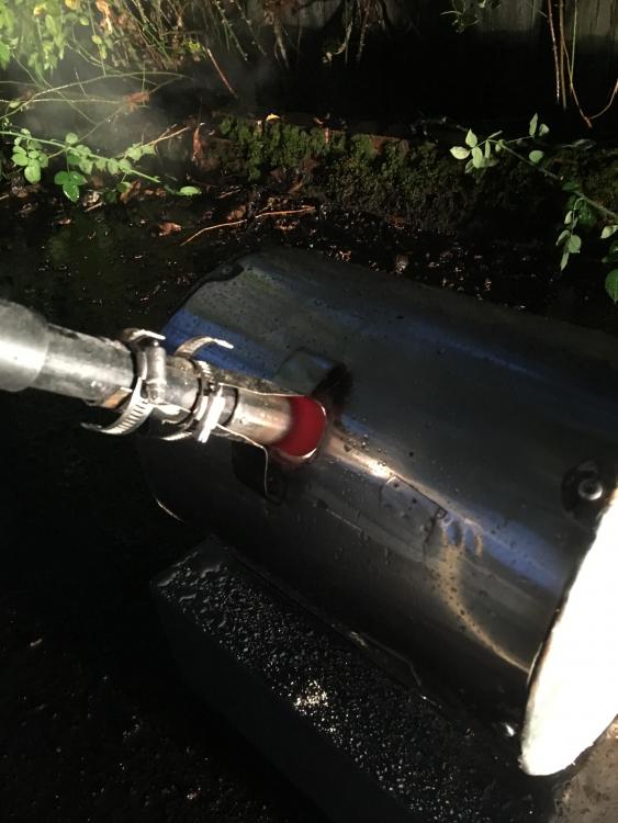

Hello and thank you every body for putting up with me.

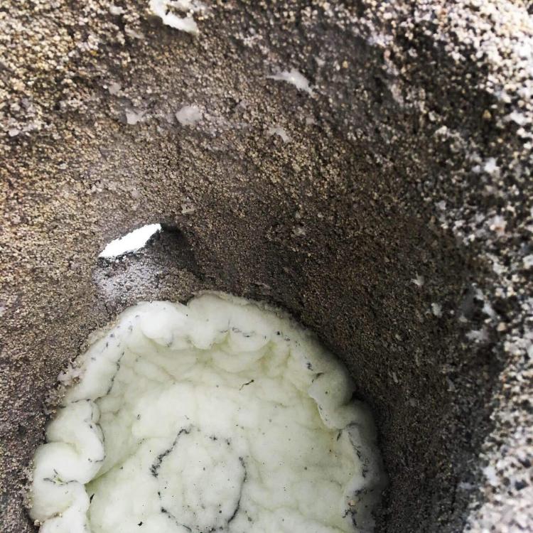

Well I did it. It’s a frankenForge but I didn’t rush the build.
The shell is an old stainless brewers pot that I cut down to size.
First a layer of 1” ceramic wool, rigidized and coated with KOL-30 and left to cure before another layer of 1” wool rigidized followed by the last layer of KOL-30. The kastolite is pretty thin maybe 1/4” a bit thicker around the ports and the floor. But I used less then 10 pounds of KOL30.
i used Metrikote over the kastolite and I put it on kinda thick.
if I did the math right I have just over 350cu inches for my 3/4” burner.
I think the opening should have been bigger but it should work
my main issue is the burner in relation to the port. Placement and how close it should be.
i currently have it inserted about 3/8” into the shell. The port being about 2” thick and flaring slightly
I thought it needed an air gap between the burner flare and the forge wall.
Test fired it it for the first time tonight but the nozzle was getting a lot hotter then it did firing the burner by itself.
I know it looks crude but is the burner in a bad position?
That is completely normal. You should put it deeper into the forge, leaving only about 1'' inside of its inner wall (hot face). It should then become yellow hot.
This is a variation from what we recommend.  I would not tear it apart and rebuild at this point, but there is little to no value to a layer of KOL-30 between 2 layers of fiber blanket.  The purpose of the insulation is to hold the heat and the purpose of the kastolite is to protect the insulation from us ham-handed smiths poking it with hot metal, so putting kastolite between the layers of blanket is unnecessary at the very least.
This isn't intended to pick on you so much as clarify for anyone who may be reading this thread later.
As Mikey has said it is normal for the last bit of a flare to get hot enough to glow.  However, if your mixing tube would get that hot (and it doesn't look like it is),  that would indicate a problem.  Chances are that inserting your flare a little deeper and maybe some final tweaking will have you bashing hot steel in short order.  If you need help doing the final tweaks on your burner then some pictures of the flame in the forge shortly after startup will help us help you.
