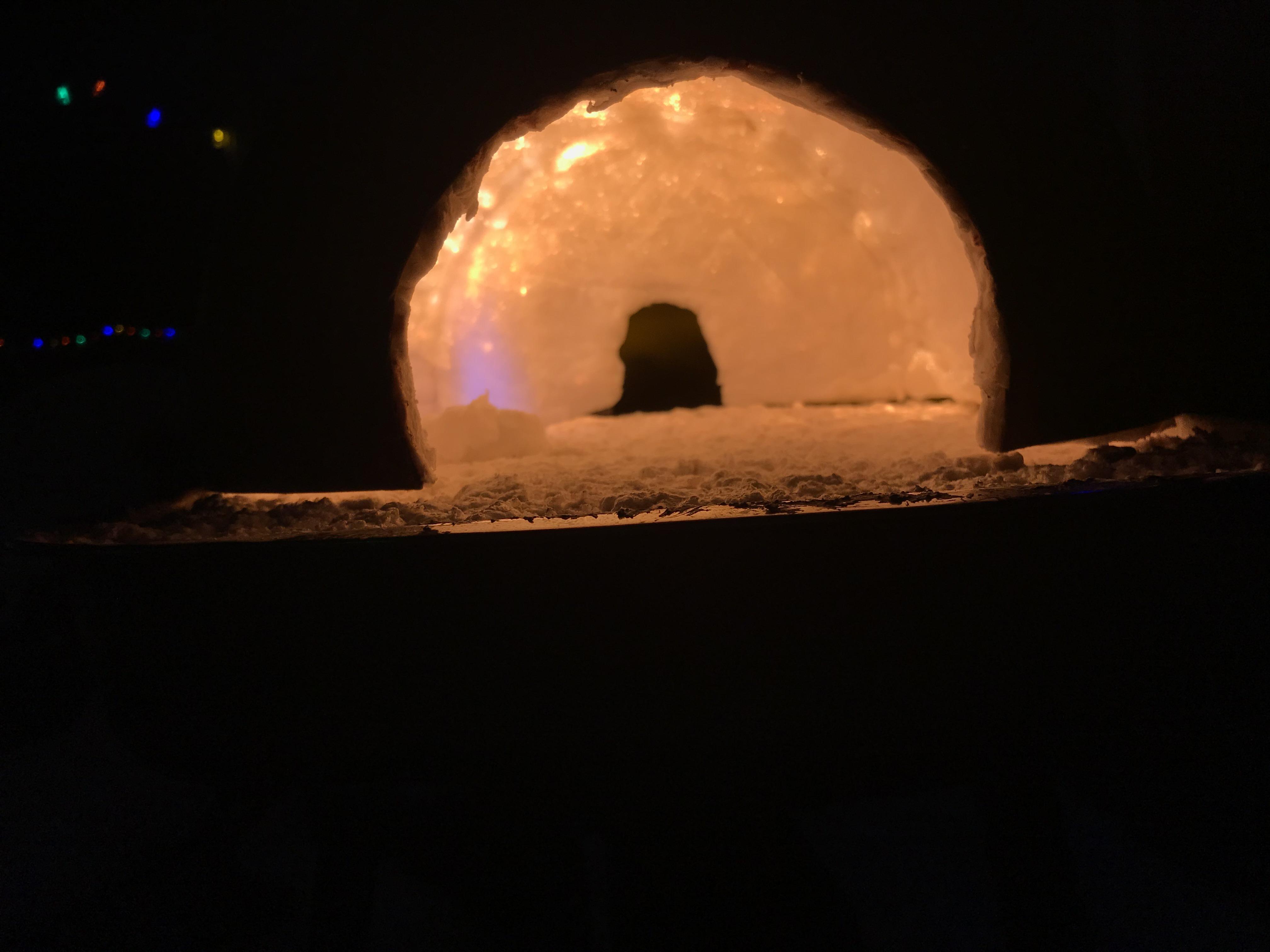

671jungle Posted January 14, 2020 Share Posted January 14, 2020 Rigidized the first layer of blanket with one 3/4" burner. This forge will accommodate two. The second port is stuffed with blanket. The second layer of blanket plus the kasto should help soften the flame impact and create more swirl. I also saved the cut-out from the forge entrance to use as the baffle door. The burner is choked. Once it warms it can be opened up to full air. Quote Link to comment Share on other sites More sharing options...

Frosty Posted January 14, 2020 Share Posted January 14, 2020 On 1/14/2020 at 12:24 PM, 671jungle said: The burner is choked. Once it warms it can be opened up to full air. Open it up more, the opaque yellow flame isn't doing any good, just burning fuel and altering YOUR breathing air. I don't recall if you said so forgive me for asking if you have, please. Why are your burners so close together? Frosty The Lucky. Quote Link to comment Share on other sites More sharing options...
671jungle Posted January 14, 2020 Share Posted January 14, 2020 On 1/14/2020 at 4:58 PM, Frosty said: Open it up more It is just barely choked. It blows off the nozzle until it heats up a bit then it can handle full open. The nozzle still has the thread from the stainless reducer. I will try opening it up to try to get the flame to stick. On 1/14/2020 at 4:58 PM, Frosty said: forgive me for asking I consider you one of the great teachers on this forum. It is an honor to catch a question or response from the Elder Curmugeons. How many times have you answered the same questions and repeated instructions to newbies like me. The least we can do is explain a method to our ignorance. My reasoning for the burners so close together is to place them toward the back of the forge and increase swirl hangtime before the flame exhaust out the front. Trying to mimic the swirl in my small two 1/4" burner d-forge. Quote Link to comment Share on other sites More sharing options...

Mikey98118 Posted January 15, 2020 Author Share Posted January 15, 2020 Your forge is running about as hot as those refractories will ever allow,671; congratulations for a blue ribbon effort Quote Link to comment Share on other sites More sharing options...

Frosty Posted January 20, 2020 Share Posted January 20, 2020 On 1/14/2020 at 5:32 PM, 671jungle said: It is just barely choked. It blows off the nozzle until it heats up a bit then it can handle full open. The nozzle still has the thread from the stainless reducer. I will try opening it up to try to get the flame to stick. I almost pulled a good one! I finished the post, sent and read Mikes reply and it didn't jibe with my recollection so I went back and looked at your last one and xxxx xxxx I was responding to someone else! Your forge is looking hot enough to do most anything you want. It may be a LITTLE bit rich but we're talking a few strokes with a nail file at a time fine tuning. Watch your ventilation. Ah you flatter me sir, I'm just a guy who likes to tinker and talk. I got a jump on making NA burners when an old coffee shop friend dumped a box of induction device: fliers, papers and such on me. He was hoping to find an application patent and make a buck but I couldn't figure out a way to make one of these things inflate tires so he lost interest. Anyway, when I started messing around I had the advantage of a bunch of paperwork showing the basic ratios and how they worked together to induce motion in fluids. Mostly though, helping folks makes me feel good, I'm selfish like that. Frosty The Lucky. Quote Link to comment Share on other sites More sharing options...
671jungle Posted January 20, 2020 Share Posted January 20, 2020 7 hours ago, Frosty said: I almost pulled a good one! I was confused at first. Then realized what was happening. I am working on the second burner and will try opening it up. The original black iron reducer I used as a nozzle produced a neutral flame and had no issues after a minute of warming up. I could wave it around like a wand and the flame would stick. The stainless reducer has a shorter body so I'm thinking grinding the threads out will hold the flame? 10 hours ago, Another FrankenBurner said: This is after the forge had been going for a few hours. That is great! I may follow your lead for my baffle doors. Might also be a great way to make a forge body. How did you get the aggregate into the fibers? Or were they sifted out? Quote Link to comment Share on other sites More sharing options...
