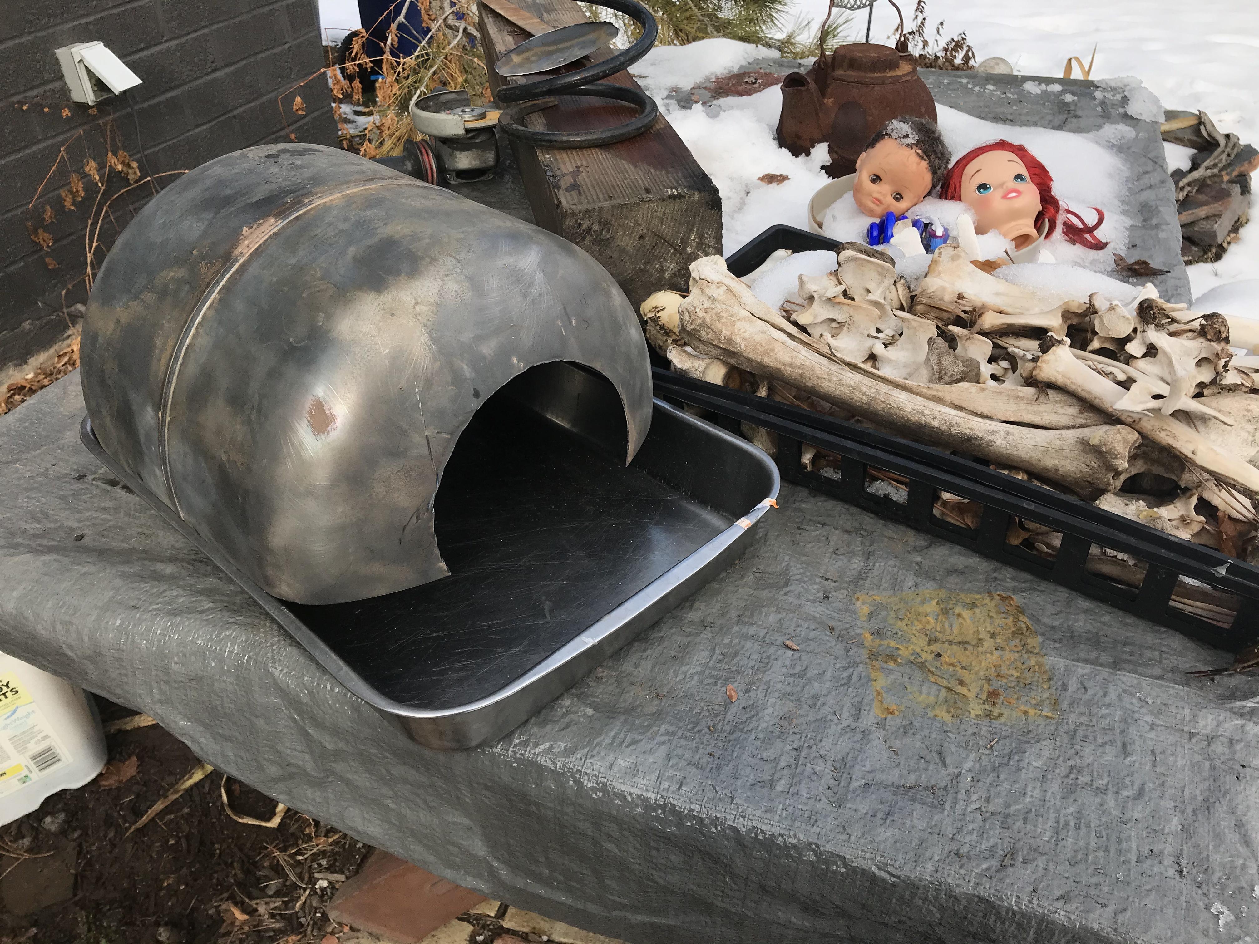

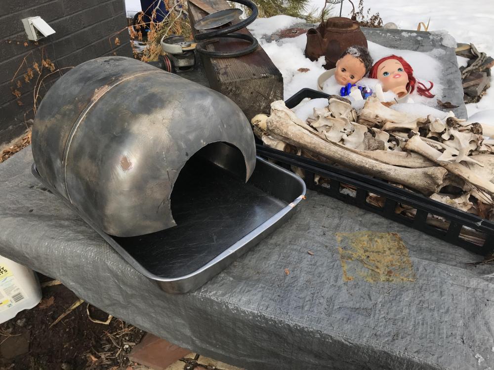

671jungle Posted January 4, 2020 Share Posted January 4, 2020 Made the cuts for the D forge. It will be powered by a bottom mounted 3/4” burner. Maybe 2? Link to comment Share on other sites More sharing options...
671jungle Posted January 4, 2020 Share Posted January 4, 2020 Guess I’m starting with overkill and go for two burners. One port can always be plugged. This build has me all excited to see that “white heat” in a bigger space. I’ve always wanted to enter a kiln like room where everything is “whiteyellow” hot. Not in this lifetime . Also got some cool cut outs from the work. Maybe a wind chime of sorts? Link to comment Share on other sites More sharing options...
671jungle Posted January 5, 2020 Share Posted January 5, 2020 worked a bit more on the forge build. Cut holes in the plate for extra support under stainless baking pan. Link to comment Share on other sites More sharing options...
Mikey98118 Posted January 6, 2020 Author Share Posted January 6, 2020 Glad to see you positioned both burner portals toward the back of your forge. Obtaining white heat (above 2700 F) in a small space requires hotter lame temperatures from a better burner design. added oxygen, or a hotter burning fuel than propane. Propylene in refillable cylinders (from a welding supply store), ends up no more expensive than burning propane, as the 1/3 additional fuel cost is offset by the 1/3 higher flame temperatures, allowing the burners to be run at lower fuel pressure. Otherwise, the burners must be turned up so much that the forge will have a huge exhaust flame. As Another Frankenburner can attest, such temperatures usually require any flame retention nozzle to be made from refractory; #316 SS nozzles will end up dripping unto the forge floor at worst. Great looking stand in the photos Link to comment Share on other sites More sharing options...
