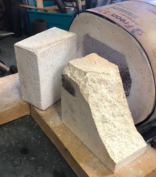

Tired of cracking expensive bricks, we tried something.  Rigidized blanket, fully coated in kast o lite.  It has several hours of fire time.  We are happy so far and making more.  We also just faced the first one with matrikote.
