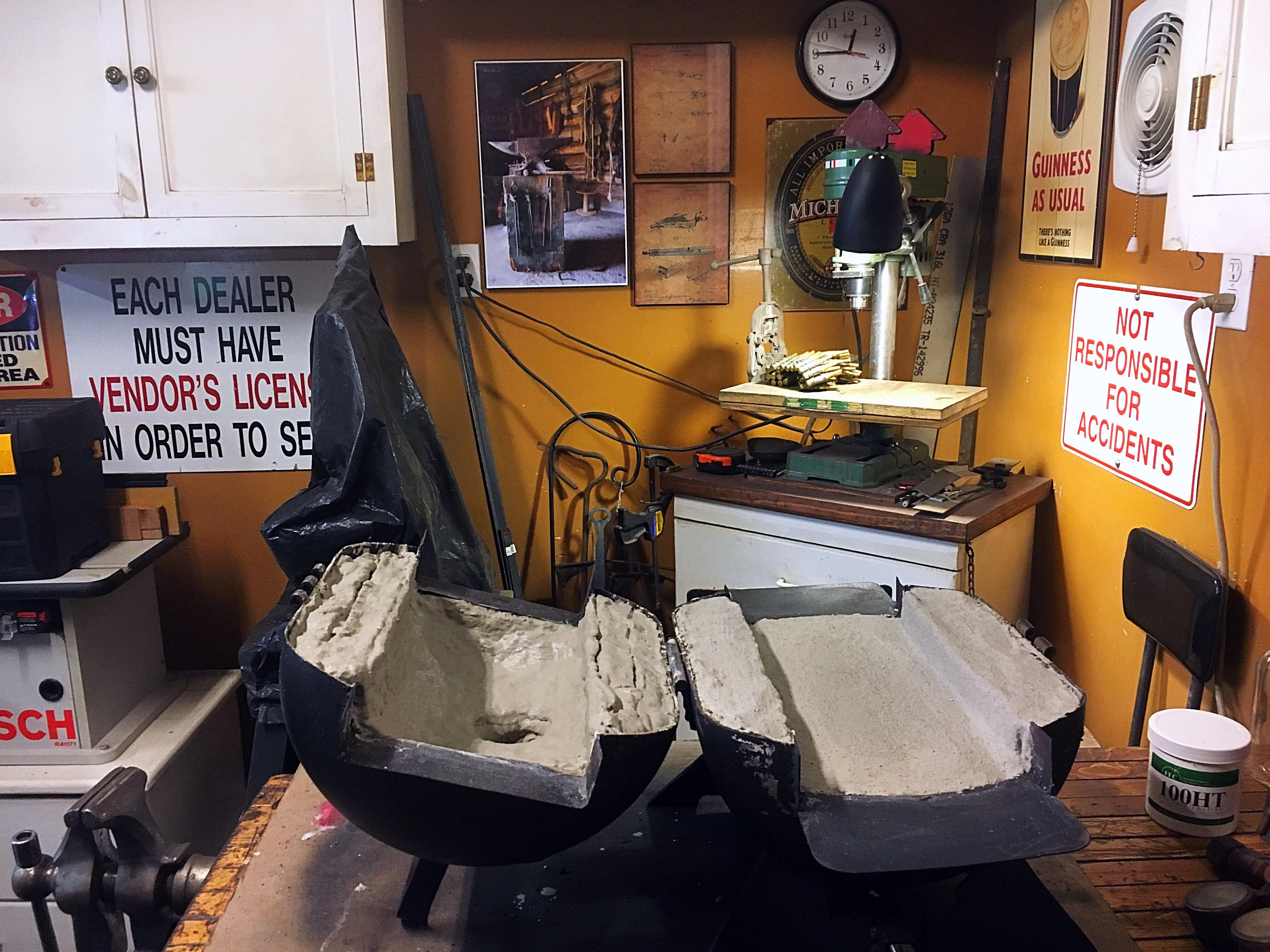

Well since Mikey mentioned a clamshell style forge a couple posts above I’ll post up the new to me “stove with stand” forge I bought two weeks ago & am sorting out!
I just received the ITC 100 and applied it.
(that stuff isn’t cheap!!)
I have to ask, as there are no directions on the little tub, how long is the cure time for this material?
Also, I kind of thought it’d be thicker but it’s more of a gritty ceramic slip than anything.
The formula I used was ready to go immediately. Products change over the years, so look on the tub for directions.
The “directions” leave a bit to be desired.
There was nothing but the tub & the bill of sale in the box.
I didn’t know if a heat gun on low was recommended or not.
