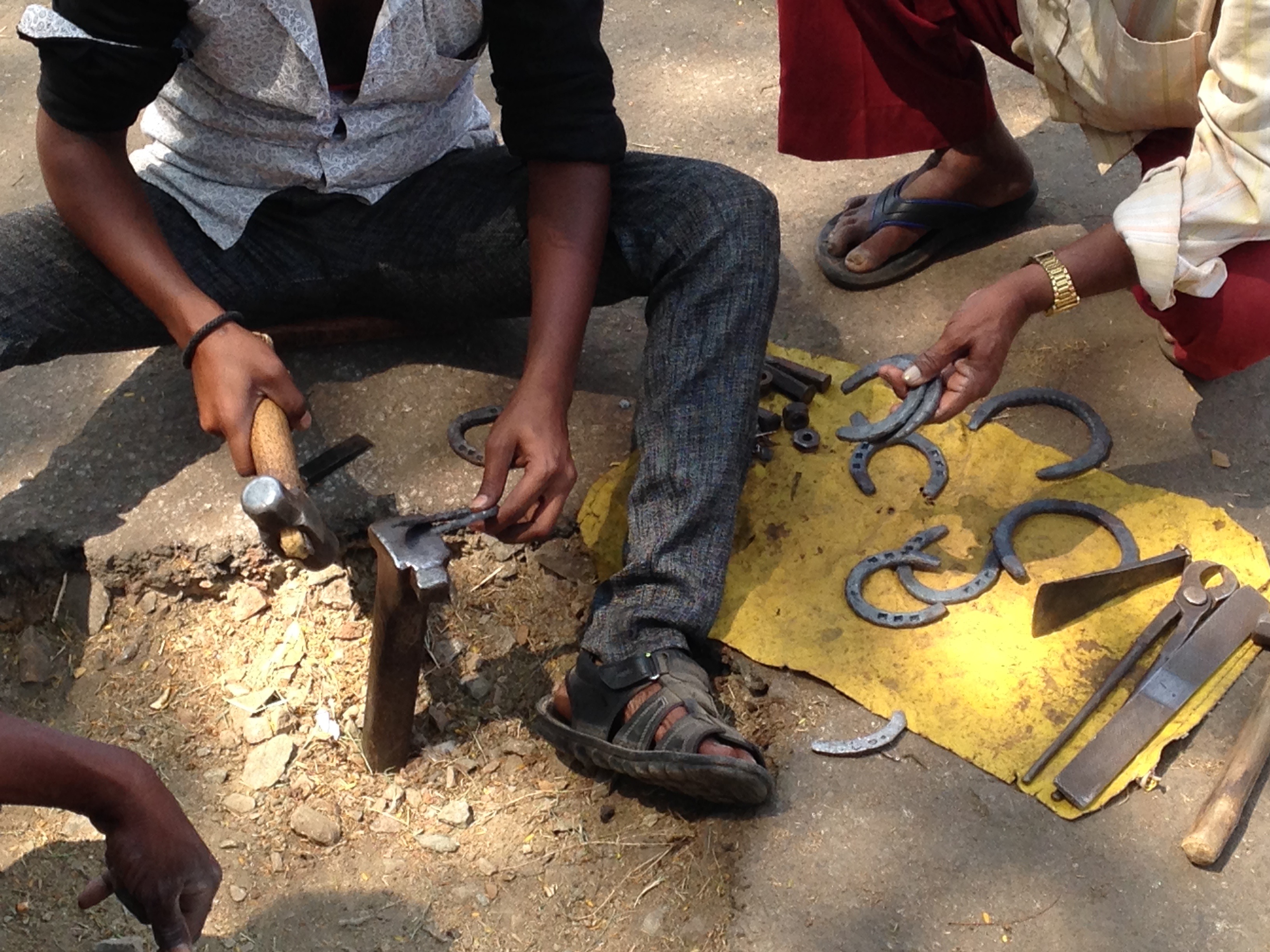

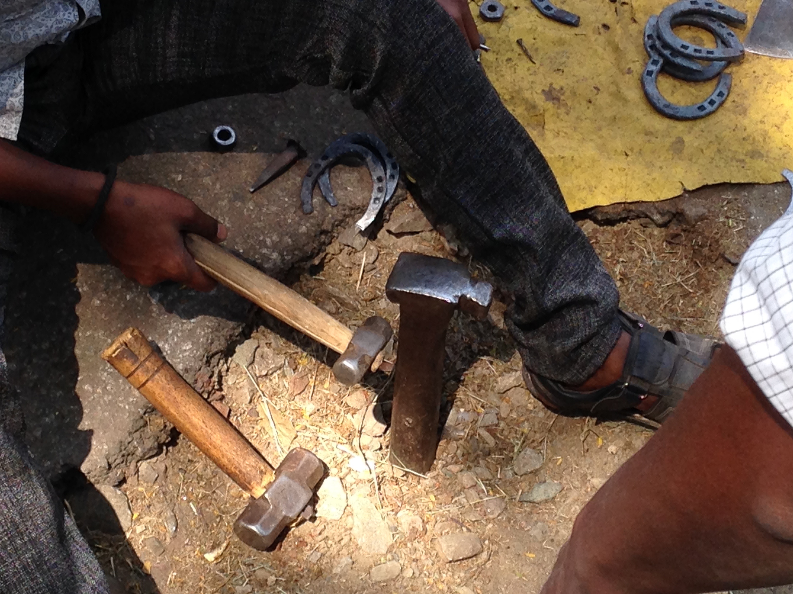

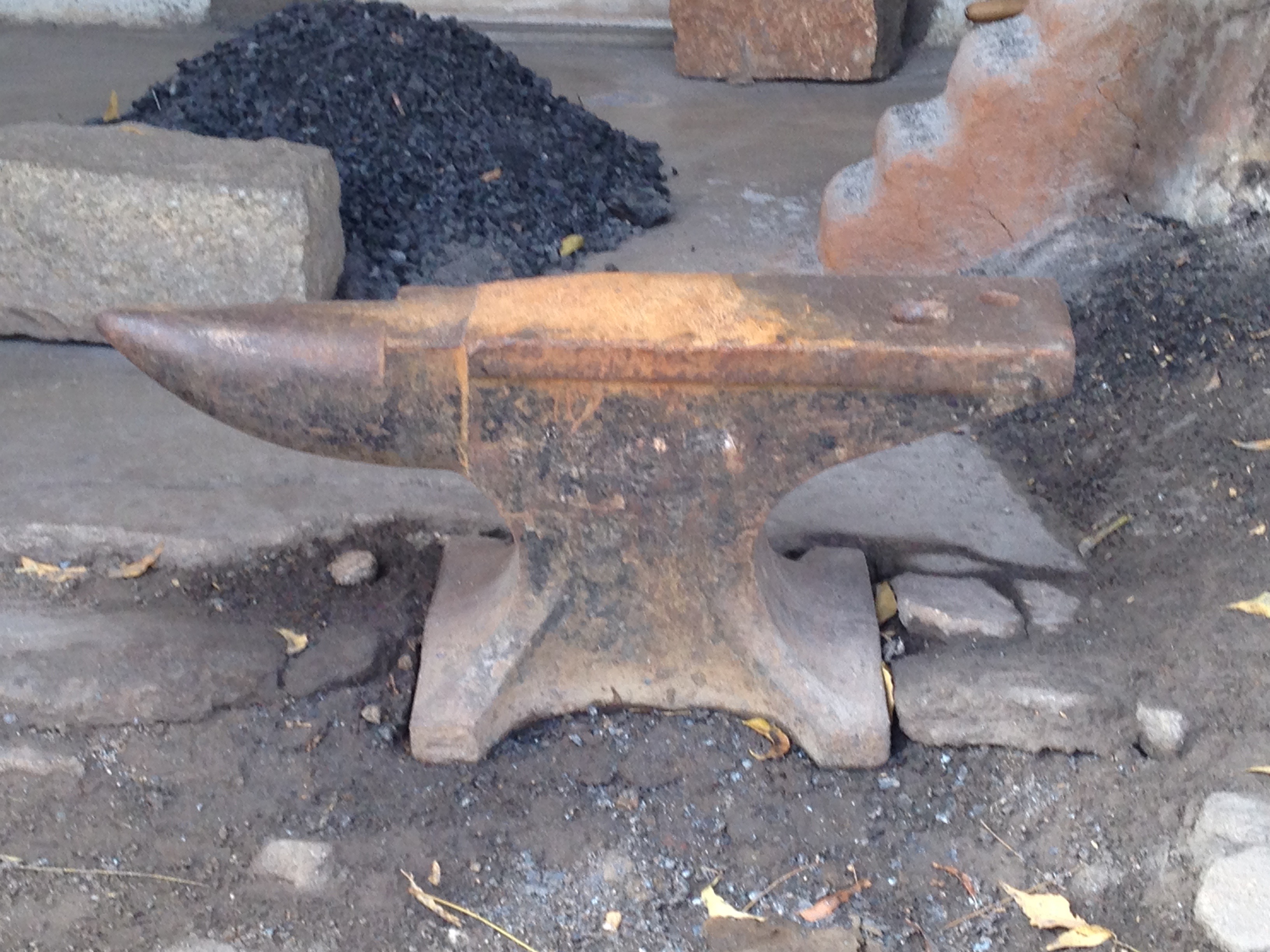

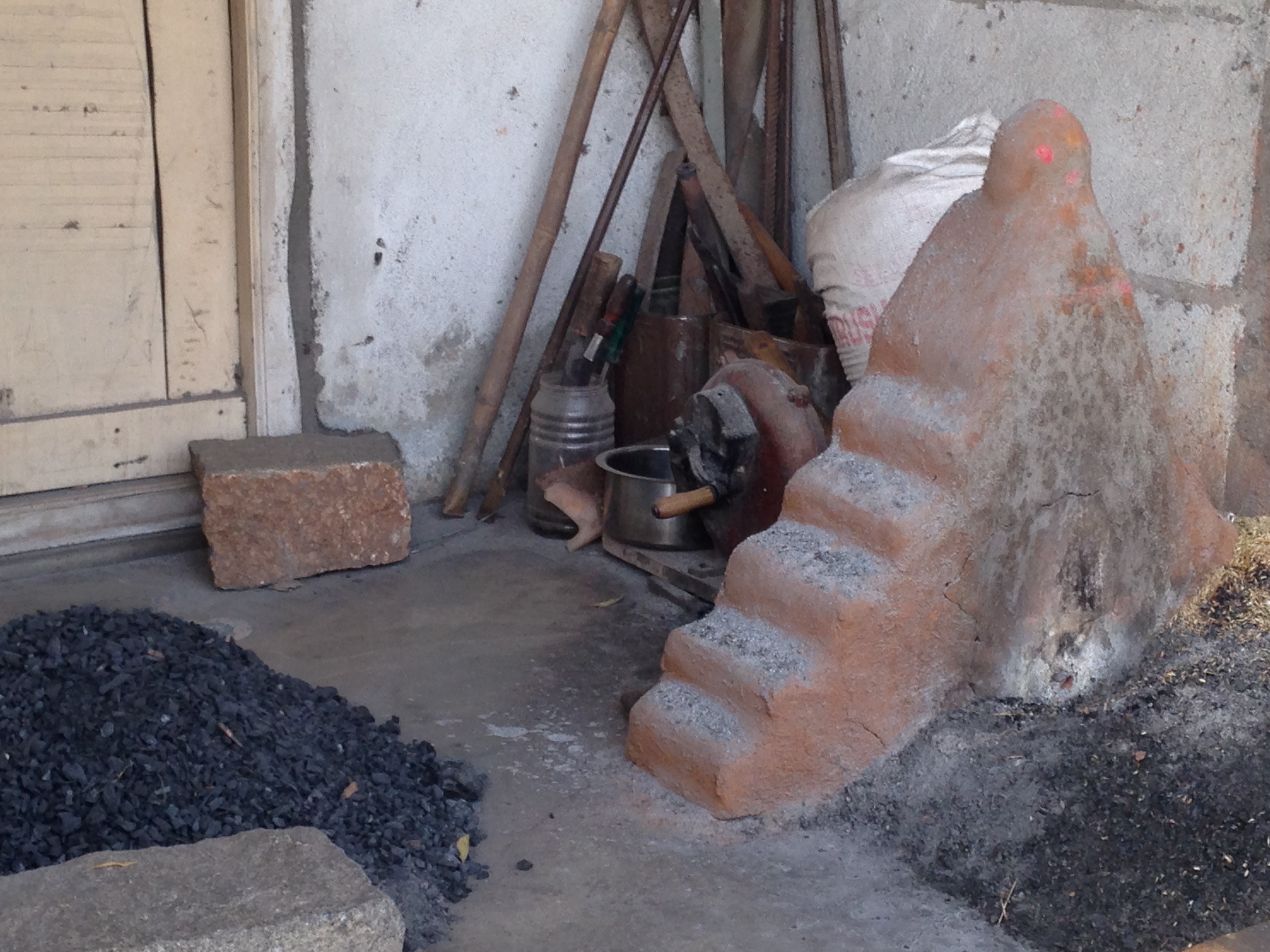

JNewman Posted July 17, 2016 Share Posted July 17, 2016 Several years ago one of our OABA members did a slide show at one of our meetings of his trip though Asia.. He visited a lot of blacksmith shops many with a roof only, many of them with a piece of round bar on end as their anvil. These were full time blacksmiths. One I remember in particular was a shop on a busy street in India, it was about 10' wide when working and about 4' deep with a steel rollup door on the front, this was a shop that 3 or 4 smiths worked out of. They did spill out onto the sidewalk a little when working but even if they doubled the size that is still 3 smiths working in 8x10 with lots of pedestrians walking through half the shop. He did not take any pictures but mentioned their were also smiths in India he saw who worked out of a square of sidewalk, a hole chipped in the sidewalk as their firepot. Link to comment Share on other sites More sharing options...
Judson Yaggy Posted July 29, 2016 Share Posted July 29, 2016 I went to India this past winter, and in many places breaking thru the sidewalk (if there was one, and if it happened to be an unoccupied space) would result in discovering the sewer. I didn't find many "blacksmithing only" shops but there were hundreds of little shops at most 10' by 10' behind a roll-up door, whose equipment consisted of a chop saw, a 75 year old stick welder, perhaps a drill press, and about 15 employees. I did find some farriers working cold shoes with an anvil driven into a city street (first few photos) and shop that forged agricultural hand tools, also around 10' by 10'. Anvil was something cast locally as far as I could understand. Side draft forge with hand cranked blower, the blocks of granite were workbenches and seats. They of course did have huge manufacturing and heavy industry right alongside little shops like this, but I didn't get to see any. I started in a 64 square foot lean-to with a forge, blower, anvil and 2 hammers. Made enough money to build a 12x16' shop with walls! and electricity! Built in a little door in the wall behind the power hammer so I could pass longer pieces thru the hammer and out the wall. Made enough money in that shop to start paying a mortgage on an old farm and turned one of the barns into a "real" shop... the next one will be in the 4k sq.ft. range. (don't tell my wife!) Link to comment Share on other sites More sharing options...
