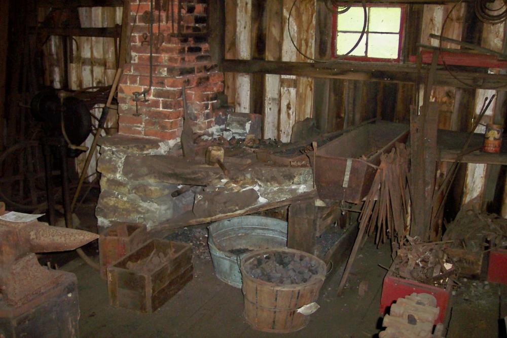

notownkid Posted July 9, 2016 Share Posted July 9, 2016 2 hours ago, Kardall said: My shed concerns would be the floor of a shed is wood, so I would have to put something else on the floor to prevent burning the place down I have many pictures of old blacksmith shops esp. in the New England area and the vast majority of them were wooden floored. I remember 3 blacksmith shops were still operating when I was a kid 50 yrs ago and they all had wooden floors. those buildings are still standing and were converted to other uses. Wooden floors in a shop doesn't mean it will burn. I do go to 2 shops where they had caught fire at one time and the roof beams and boards were burned but not the walls or floor, both are part of museums today. Quote Link to comment Share on other sites More sharing options...

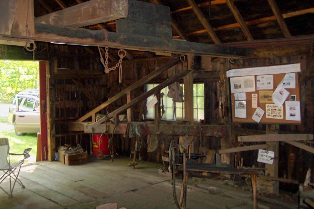

notownkid Posted July 9, 2016 Share Posted July 9, 2016 an original shop in CT with wooden floors. It was built 1870-1880 time frame and was used until late 1950. Frame in picture is shoeing stocks that swing out from the wall stone forge with wooden floor all the way around it. Quote Link to comment Share on other sites More sharing options...

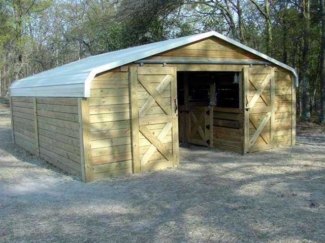

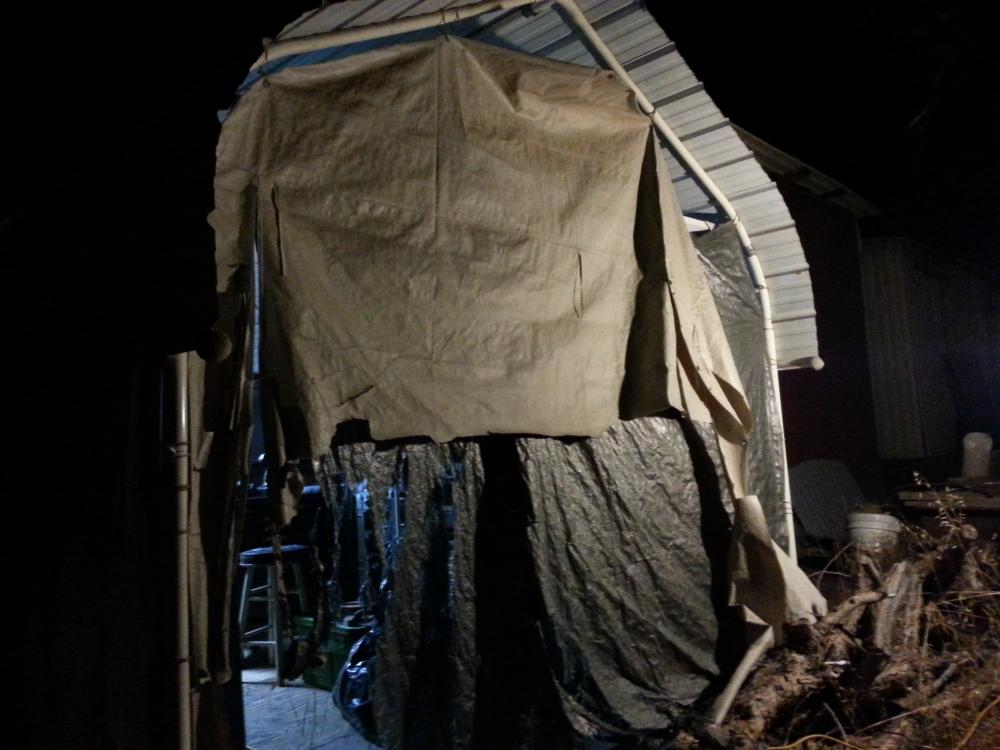

Bo T Posted July 12, 2016 Share Posted July 12, 2016 I checked CL and found a number of carports for sale. You could mount it on skids (non permanent) and use tarps to shield the sides. Quote Link to comment Share on other sites More sharing options...

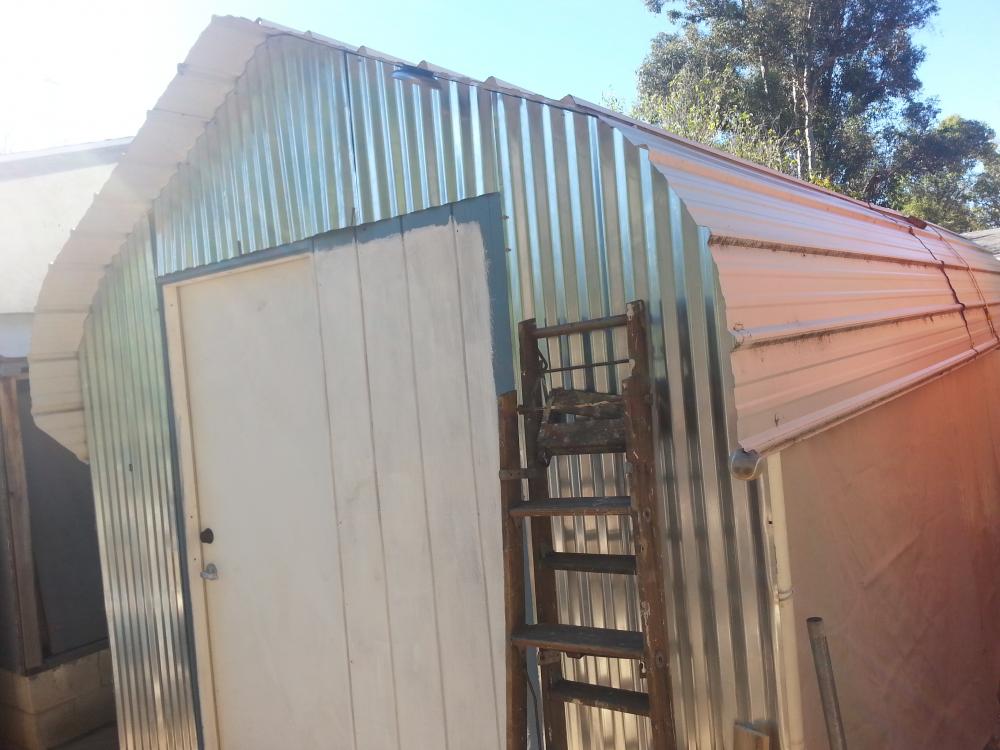

Charles R. Stevens Posted July 12, 2016 Share Posted July 12, 2016 Upgrade and buy panels from your steel roofing supper and finish the sides solid or... Quote Link to comment Share on other sites More sharing options...
Anachronist58 Posted July 13, 2016 Share Posted July 13, 2016 Was Now Quote Link to comment Share on other sites More sharing options...
Charles R. Stevens Posted July 13, 2016 Share Posted July 13, 2016 Works Quote Link to comment Share on other sites More sharing options...
