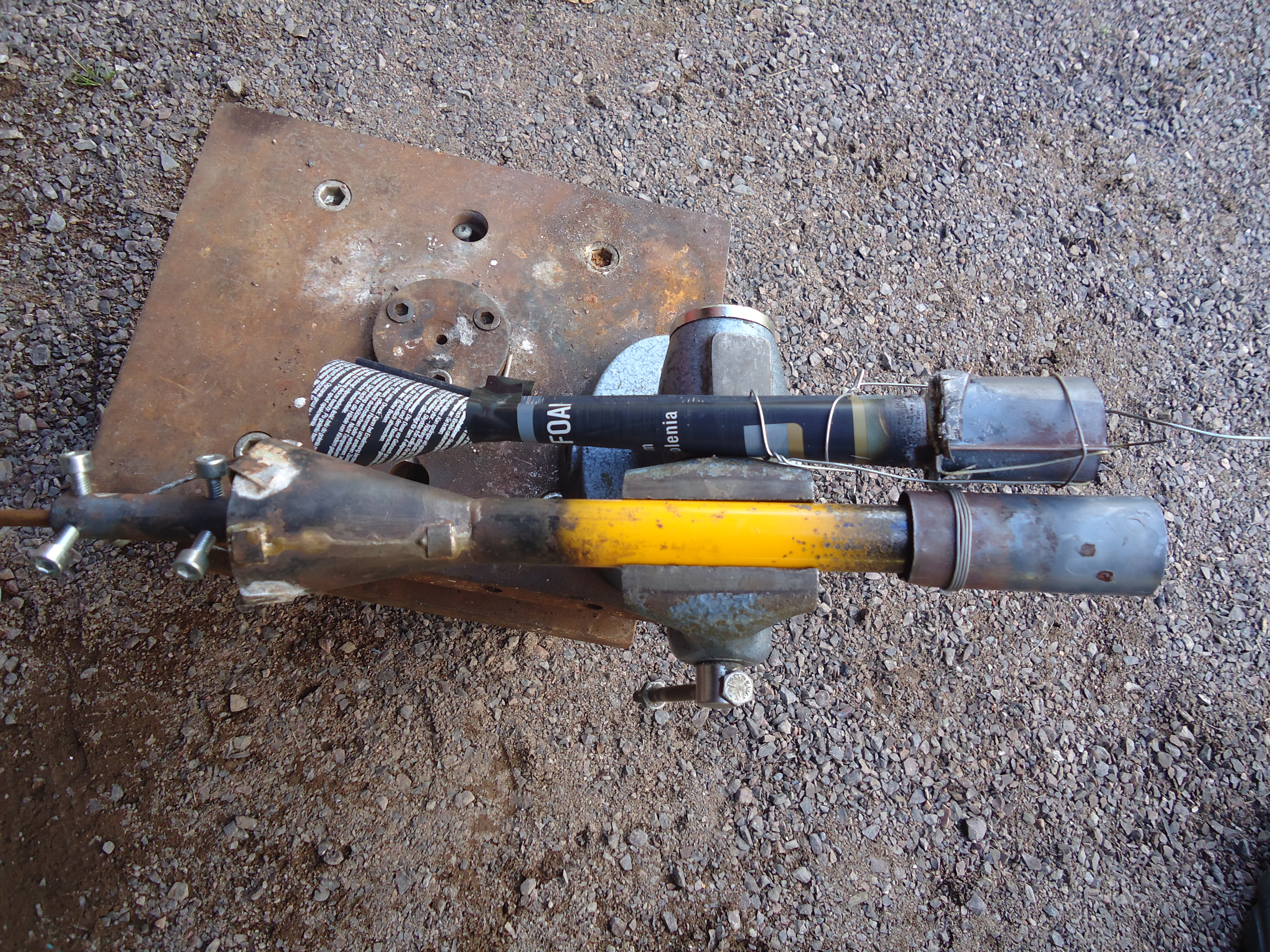

Out of the history of all cobbled together xxxx this might be the worst… but as it actually worked as a prototype and can be a useful method for someone else who perhaps want to do it a bit more seriously I'll show it here.
I got interested in the wasp waists the last few days, and threw together a very, VERY basic prototype. It's simply two sheet metal cones and a flame retention nozzle. Metal comes from old shaving foam spray cans - costs nothing and is very easy to work with, good enough for a quick n dirty prototype. I didn't bother trying to go for a specific length to diameter ratio anywhere, as my thinking is that I grind the small end off the cones shorter until the waist is large enough to produce a neutral flame - changing the diameter and length at the same time, so it's basically only good for finding the approximate waist diameter to go with the 0.6mm MIG tip I'm borrowing from my previous build (that has a 18mm mixing tube, yellow on the second picture, the prototype waist is 12mm for starters). The entry cone has the same angle as on the linear burner (that's 3x mix tube diameter att the entry and 4x diameter length, but in this case, as I said, I more or less ignored everything but the angle), and the exit cone opens up at 2 degrees from center line, 4 degrees included angle.
Testing conditions weren't ideal, couldn't see the flame well outside in daylight so I can't really say much about the waist size vs. tip size now - need to work on that in less light. But so far: It burns most stable with the gas turned up relatively high, and the gas jet needs to be rather far back from the waist, going closer causes fluttering. I held steel wire in the flame and it goes bright orange (same for the 18mm burner), but the hottest zone of the flame is closer to the burner.
It's far from a functional burner, but it's interesting that it burns as well as it does with the gas jet out of a burner with 50% larger mixing tube diameter = 2.25 times the size of the opening. My testing is probably shut down for winter soon, but this seems like a concept worth diving deeper into later. And anyone else can make the same kind of cones, thicker sheet metal just requires a round bar to work it around and a mallet to shape it with.
A couple points. No need for a flame retention nozzle, that feature came about as an attempt to stabilize burners that didn't have a full length tapered mixing tube.
So long as the mixing tube taper does NOT exceed 1:12 the flow will remain smooth more taper and turbulence will break it up and it won't work.
The air intake cone is typically much more obtuse on commercial versions.
Glad to see the experiment.
I see nothing wrong with "cobbled together" burners as a method of quicker experimentation, Frosty has used wooden multi-flames nozzles and others have used plastic air chambers, making temporary forms to experiment with; both tests methods having good results.

Thankyou.
I added the nozzle as some of the commercial wasp waist burners flare out into a short nozzle. Others just end without anything after the cone. Easy enough to remove and see what happens.
I should be good on the taper. Good to know a number to aim under, for future versions.
The intake cone on many commercial versions seem to often be a smooth radiused bell mouth, starting at a steep angle (often ~90 degrees), progressively going down to basically zero angle at the waist. As I have a "straight" cone, the steeper the angle, the more sudden change of direction at the waist. I wanted to keep the sudden change at the waist relatively small, especially as I have no "rounding off" between the cones = there's a sharp step there (and from what I know of aerodynamics big sharp steps are generally good to avoid). Could get both a steep angle entry and small angle change at the waist by making a multi-stage cone, two or three different angles from the start to the waist, but I think that belongs somewhere later in the testing procedures - when most of the pieces aren't held together with just wire and tape.
The read somewhere that the measuring venturis typically have an inlet cone of 30° and an outlet cone of 5°(included angles) to reduce aerodynamic drag.  This would give you a throat angle of 200° which isn't very sharp.  That is provided the cones line up.  These venturis have a different intention and a lot of them are used in applications where the stream being measured is moving in relation to the venturi.

I tried a few wasp waisted 3/4” inlet with a 1:12  to 1” outlet
Please everybody disregard my this post, it's as wrong as can be. I had ratios backwards in my head. See the post below.
I've qualified the 1:12 diverging taper rule of thumb often but I need to say it more strongly. The 1:12 taper is the MAX increase or decrease that can be placed on an fluid flow and still maintain a smooth stream. Next time I see Mark I'll have to remember to measure the burner on his forge and see what it is.
Dan: next time try less, say 1 :10 or just pick something more gradual. We know that 1:12 is too fast an increase. Yes? That's what your burner performance sounds like to me. It's that old empirical evidence vs. theory thing again.
Were I making a concerted effort to find the best taper for a particular intake structure I'd bracket and split the difference. It's pretty darned fast. So, knowing 1:12 is too much and we know zero works but not as well as tapered. Split the difference is 1:6 and test. Still to much? 1:3 and test. Not enough? 1:9 and test. Lather rinse repeat till it's silky smooth and manageable with that special glow. B)
I'm not suggesting anyone go to this hassle but if you do PLEASE take pictures, notes and keep us in the loop! :)

If 1:12 is the "fast" limit, it seems like longer tapers would be "slower", so you'd be looking at 1:13 and onward.
YES, that's exactly right Tim!  ARGHHH!!!!! I got that completely backwards! Please everybody disregard my last post, it's as wrong as can be.
I had ratios backwards in my head. I never thought of tapers as fast / slow but it's a much better way to visualize what's happening. Heck, a straight pipe would be a ratio of 1: infinity.
I think I'm going to be quiet for a while, that's as fundamental an error as can be.
Thank you for pointing my mistake out Tim, seriously I appreciate it.
Frosty The Embarrassed.
Would perhaps make more sense to talk about angles than diameter to length ratios.
Stuff happens. I think we all knew what you meant. Occasionally making a mistake is normal: it certainly doesn't mean you should stop thinking.
I only pointed it out because it's the internet and someone encountering this thread at some point in the future might otherwise pursue a path of extreme frustration.
