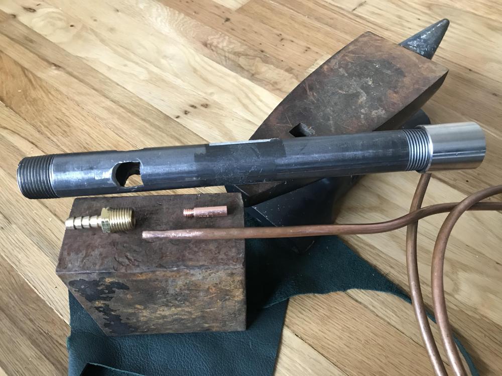

671jungle Posted December 22, 2019 Share Posted December 22, 2019 3/4" minimal brazing Mikey ejector experiment. mix tube: 3/4" x 10" (7/8" id) slots cut at about 7" from end. Shorter length will hopefully soften the flame. Jet: .025 mig tip with threads turned down to be pressed and brazed into 1/4" copper line. Copper line will be measured, cut and pressed into 1/4" male hose barb. (copper line must be cold worked to fit the hose barb.) Once mig tip brazed to copper line has been pressed into hose barb, I spray some clear coat down the inside of threaded area to seal any possible air leaks. If pressed properly there wont be any leaks. Still waiting on the 3/4" x 1/4" bell reducer which will marry the mix tube to the jet. Nozzle: 3/4" x 1 1/2" 316 stainless coupling. If this works, it will be an easy and cheap build. My only concern is with my choice of mix tube length. I figure by shortening the distance from intake to nozzle i could soften and slow down the flame keeping it in the forge longer? Link to comment Share on other sites More sharing options...
Mikey98118 Posted December 23, 2019 Author Share Posted December 23, 2019 No...that is a tube burner, and it may even end up with a thigh speed flame, but you have taken some major liberties with my design Link to comment Share on other sites More sharing options...
671jungle Posted December 23, 2019 Share Posted December 23, 2019 8 hours ago, Mikey98118 said: you have taken some major liberties with my design I hope you don't mind. I like hotrods and high speeds! I started with shorter slots so I could tune to neutral without a choke then add a choke for reducing if needed. What do you think of the shorter mix tube? BTW, I couldn't help but notice the time stamp on your post. Sleep much? Link to comment Share on other sites More sharing options...

671jungle Posted December 23, 2019 Share Posted December 23, 2019 1 minute ago, Jasent said: A slow flame keeps more heat in the forge and not racing out the door Yes. However the forge design (D forge with bottom mounted burners) I will be using forces maximum swirl and with added baffle walls it shouldn't be an issue. I'm also hoping the shorter mix tube will slow the flame just a little. Just messin around with designs trying simpler solutions. Link to comment Share on other sites More sharing options...
Another FrankenBurner Posted December 23, 2019 Share Posted December 23, 2019 A shorter mix tube is less resistance. I am not sure about slower, I suspect the opposite, but what I have seen is blunt, bushy flames. If pushed too short, the flame will show under mixing symptoms Link to comment Share on other sites More sharing options...
671jungle Posted December 23, 2019 Share Posted December 23, 2019 7 minutes ago, Another FrankenBurner said: but what I have seen is blunt, bushy flames. Thank you! That is what I meant by slower I guess. Less laminar flow and more of an explosion. Link to comment Share on other sites More sharing options...

Mikey98118 Posted December 23, 2019 Author Share Posted December 23, 2019 6 hours ago, 671jungle said: I hope you don't mind. I like hotrods and high speeds! I started with shorter slots so I could tune to neutral without a choke then add a choke for reducing if needed. What do you think of the shorter mix tube? BTW, I couldn't help but notice the time stamp on your post. Sleep much? Don't mind at all; just keeping the record straight. Furthermore, if you end up improving the design, than more power to you Shorter,/wider slots will strengthen the burner's performance; this design was brand new when I wrote the book, and I went far out of my way to ensure the burner's stability, outside of a forge or furnace. You can afford to "sail closer to the wind" with a tool that you control the use of. As to mixing tube length, you are changing the flow dynamics in your burner, so what the best length is, will change too. Link to comment Share on other sites More sharing options...
Mikey98118 Posted December 24, 2019 Author Share Posted December 24, 2019 12 hours ago, 671jungle said: but what I have seen is blunt, bushy flames. Yes, and they are faster flames too, while longer mixing tubes will flow slow speed, resulting in smoother more laminar flames. Aside from this, Frosty and I want back and forth for a couple of hears about slower flames giving more hang time, versus faster flames t-e-n-d-i-n-g to be hotter; bottom line is that swirling the burner flame within the forge makes a great compromise to the problem in circular shaped forges, and multiple flame nozzles are the better way around the problem in box forges. Often the write answer isn't to pick out the fastest dog on the track, but to build a faster track for the whole pack to run on. Link to comment Share on other sites More sharing options...
