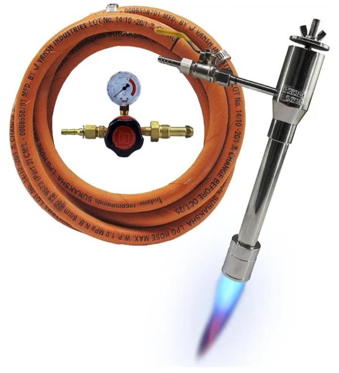

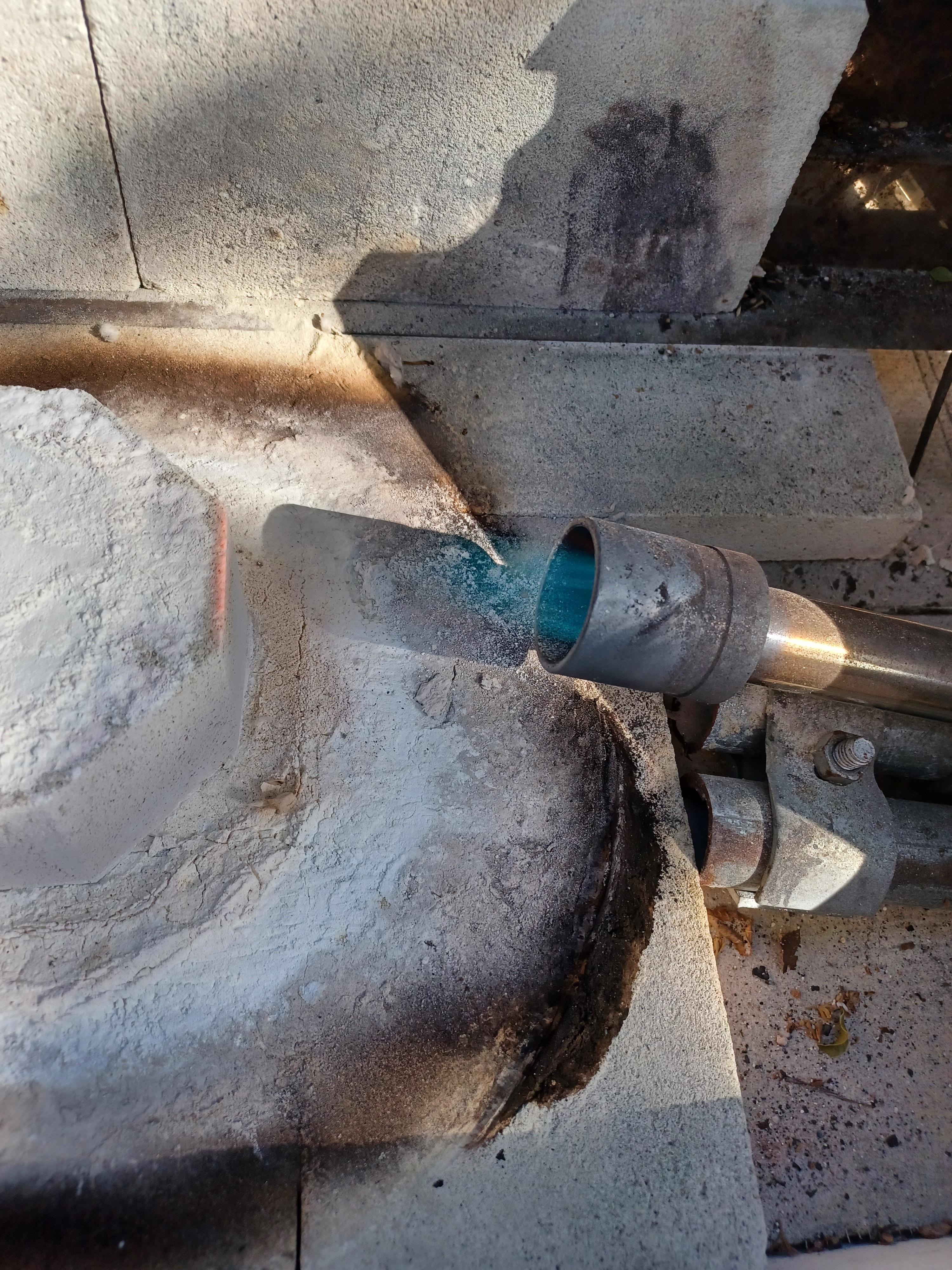

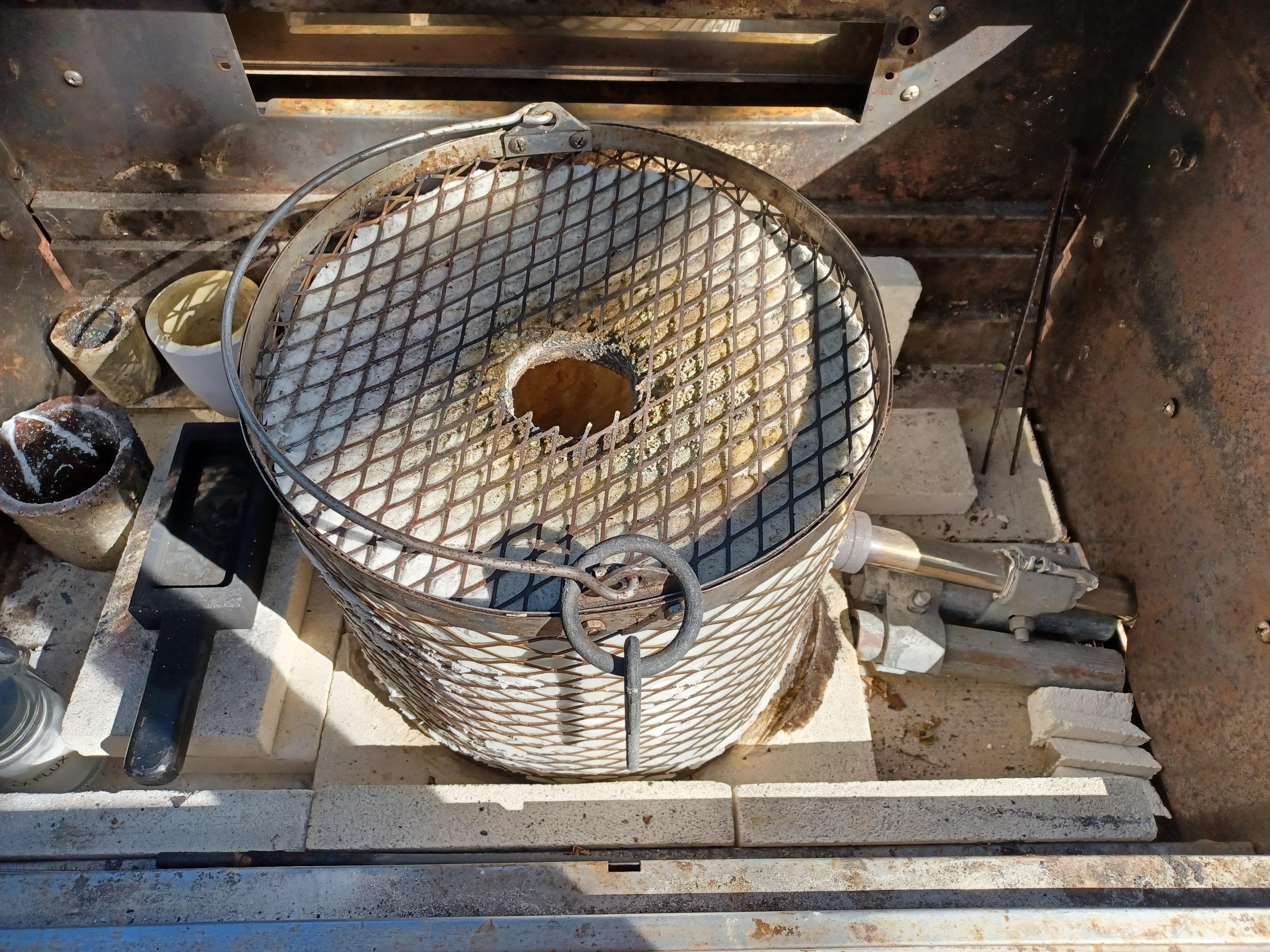

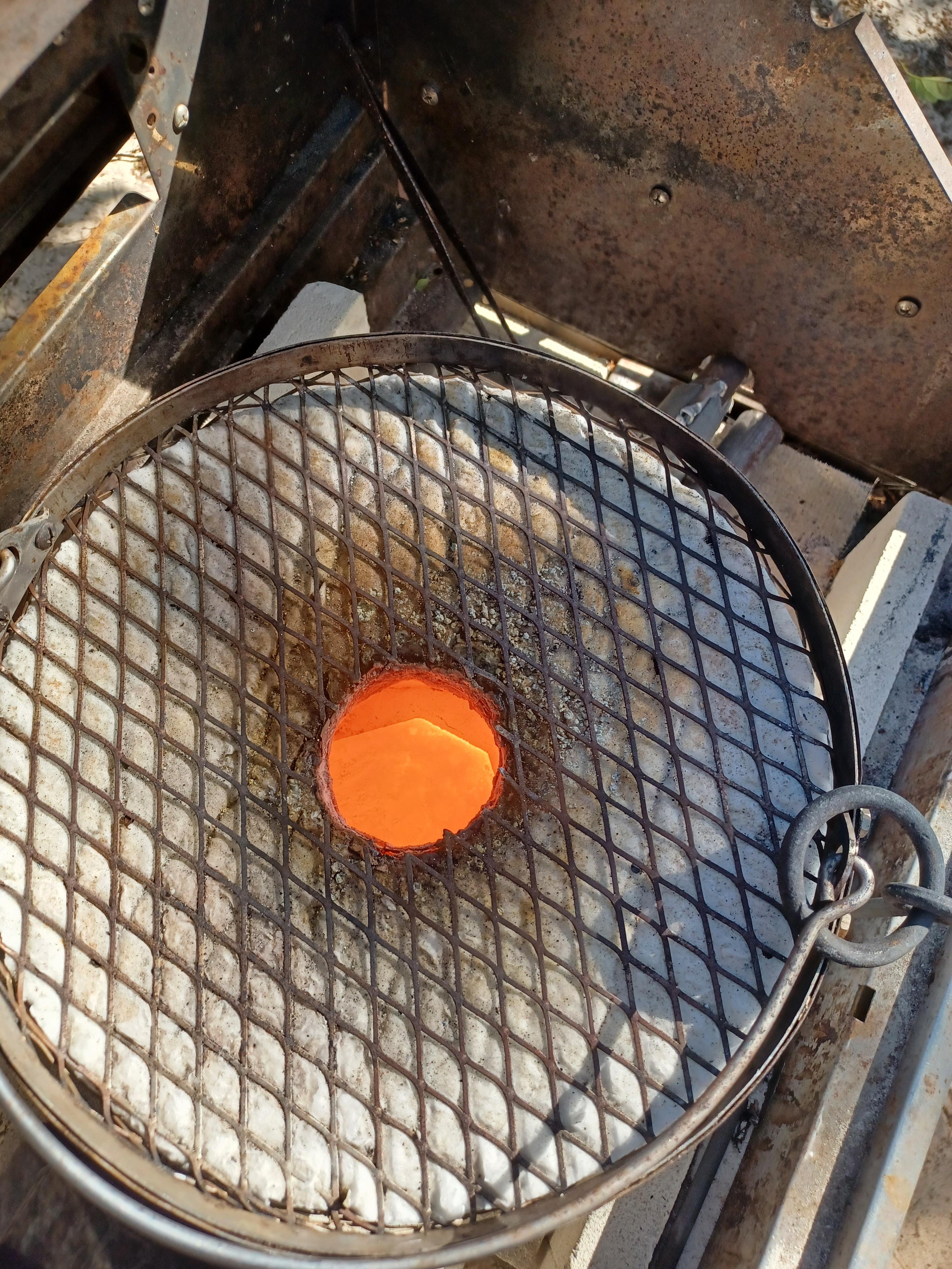

Florida Man Metals Posted Monday at 02:17 PM Share Posted Monday at 02:17 PM Tried to take some pictures of the burner but found it hard to capture well in the full sunlight and due to my design. The only decent photo I could get was it operating outside of the furnace, so no back pressure. Hard to get a photo thru the exhaust port. It was running for about 10 minutes in this photo. The burner was made in India. My furnace is a version of a Top Hat Raku Kiln. I built the entire thing in an old stainless steel grill body. It is all at a working height of around my belly button. Once the metal is molten I remove the furnace (top hat) and set it out of the way on a nice piece of steel. This allows for easy access to the crucible. Eliminates a lot of the unneccesary moving around of the crucible. Just pick up the crucible once, and pour it into the mold in one simple movement. The last two pictures I added are pretty much cold just to illustrate how everything works together. Quote Link to comment Share on other sites More sharing options...
Mikey98118 Posted Monday at 05:02 PM Author Share Posted Monday at 05:02 PM You're right, that the light level makes looking for secondary and/or tertiary flames nearly impossible. However the primary flame looks good enough that I would not expect to see much secondary flame, anyway. As to the burner assembly; you more than got your money's worth Could the burner be improved? Yes; do you really need to? NO! Quote Link to comment Share on other sites More sharing options...
Florida Man Metals Posted Monday at 05:26 PM Share Posted Monday at 05:26 PM I appreciate the input Mickey. I wanted to share a store bought burner that was good enough and at a decent price for begginers. I felt this qualified as an option. I have no problems melting copper with this burner and haven't had any problems with it. It also came with a second gas orifice and a tool to replace it. Nothing compares to making your own burner thou. *Sorry I meant Mikey Quote Link to comment Share on other sites More sharing options...
Another FrankenBurner Posted Monday at 06:04 PM Share Posted Monday at 06:04 PM I searched Amazon for Simone Store and found a couple of blacksmith forges with the sand burner design. Any chance you can get pictures in lower light? Also, a picture down the intake so we can see what they are doing with the orifice. Looks like a cross tube design from the outside. Any specific reason you aimed the burner for direct impingement on the crucible as opposed to the swirl around it that most use/recommend? Is the top hat solid refectory? How is it attached to the wire skin? I was plotting something similar with my next furnace but I like your idea better. Quote Link to comment Share on other sites More sharing options...
Frosty Posted Monday at 06:13 PM Share Posted Monday at 06:13 PM Ditto Mike about not being able to see the flame for the light, maybe take a pic in the evening? Does the burner actually tilt up at the angle it appears to? With the type of melter you're using the crucible should be stable enough to use a smaller plinth and aim the burner under it. As it is the flame is directed in an upwards swirl and you want to keep the flame IN the melter as long as possible to transfer energy where you want it. Yes? That is my favorite type of small scale melter, I hate lifting the crucible out of a flaming pit, too much chance of tipping or dropping it while you're getting BBQed by the radiant heat. All that said if it's been working all this time (Since you could get a decent burner for $85) I call it a good effective burner. How about this for you. While you're melting and casting with your current set up how about building a burner? Just because it is home built doesn't mean a Mikey or T is a "better" burner, they're just relatively cheap and you get to add to your acquired skills list. Hmmm? I'll bet I know where you can get a hand getting them right and tuned. You have NO IDEA how hard it's going to be for me to not refer people to . . . "Mickey." Thank you for that. Frosty The Lucky. Quote Link to comment Share on other sites More sharing options...
Florida Man Metals Posted Monday at 07:04 PM Share Posted Monday at 07:04 PM Good eye Frosty. I agree with your assement. Initially when I placed the burner through the grill body I tried using an existing hole vs cutting my own. So yes the burner is at an angle like you said. Me and my darn short cuts. That is why I put such a large plinth in it to compensate. The way the burner hits the plinth seems to give it sufficient swirl and hang time in the furnace. At some point I will reposition the burner thou. Quote Link to comment Share on other sites More sharing options...
Mikey98118 Posted Monday at 07:57 PM Author Share Posted Monday at 07:57 PM Mikey or Micky; it's all the same to me. Let confusion rain, if it will What Florida Man gained for his $85 was a burner, gas hose, and adjustable pressure regulator. Conservatively figuring, only about $50 of this price was for a stainless steel burner of better than average design. So, this is actually a very good price for a gas burner. Quote Link to comment Share on other sites More sharing options...
