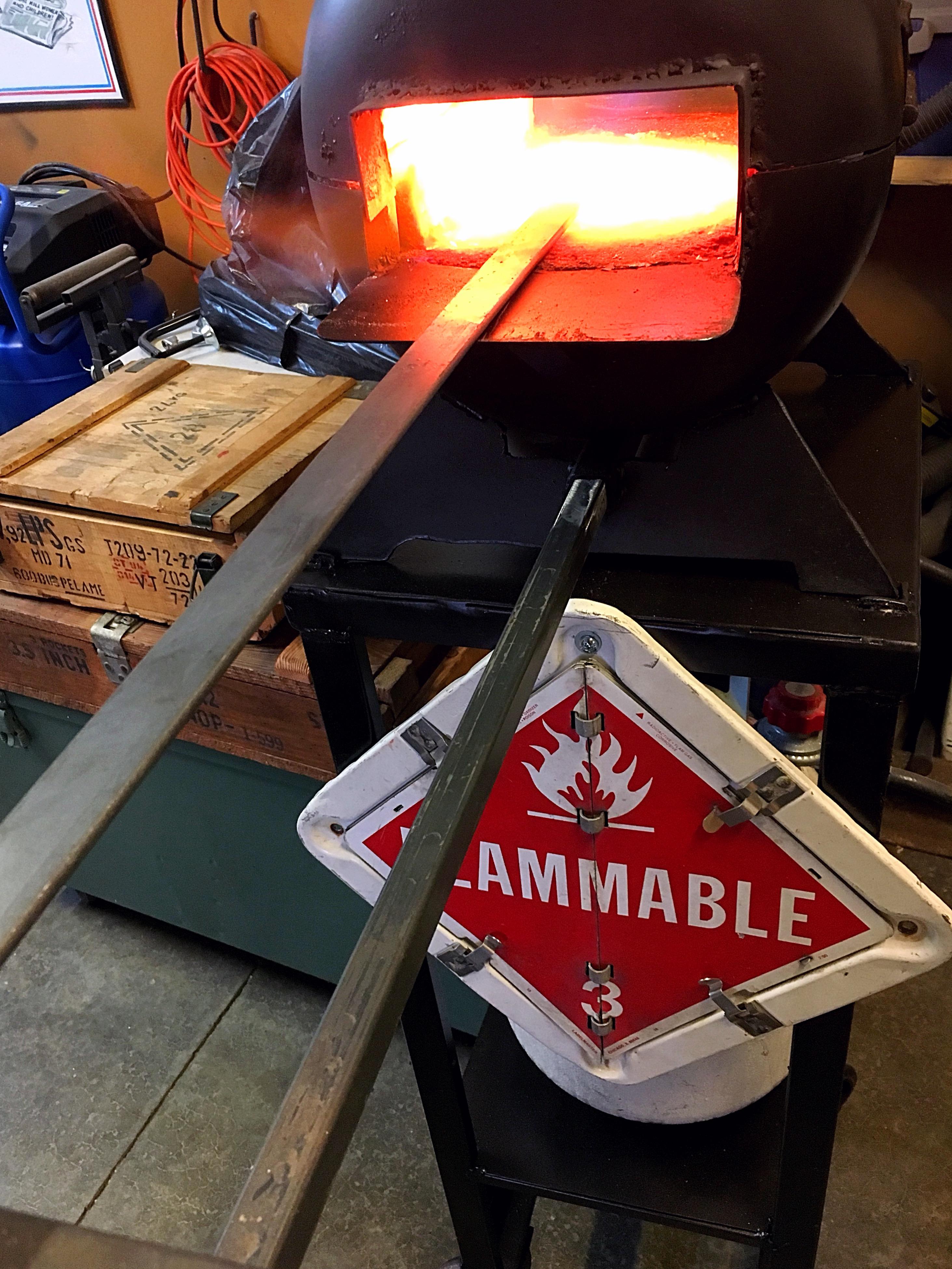

Mikey98118 Posted August 17, 2019 Author Share Posted August 17, 2019 8 hours ago, GrumpyBiker said: If it was yours how would you go about getting the most out of this setup? I would try pulling the MIG tip further away from the mixing tube entrance on the modified side-arm burner. Re-read Frosty's "T" burner directions, which are posted on this forum; they include the proper steps to tune his burners. Quote Link to comment Share on other sites More sharing options...

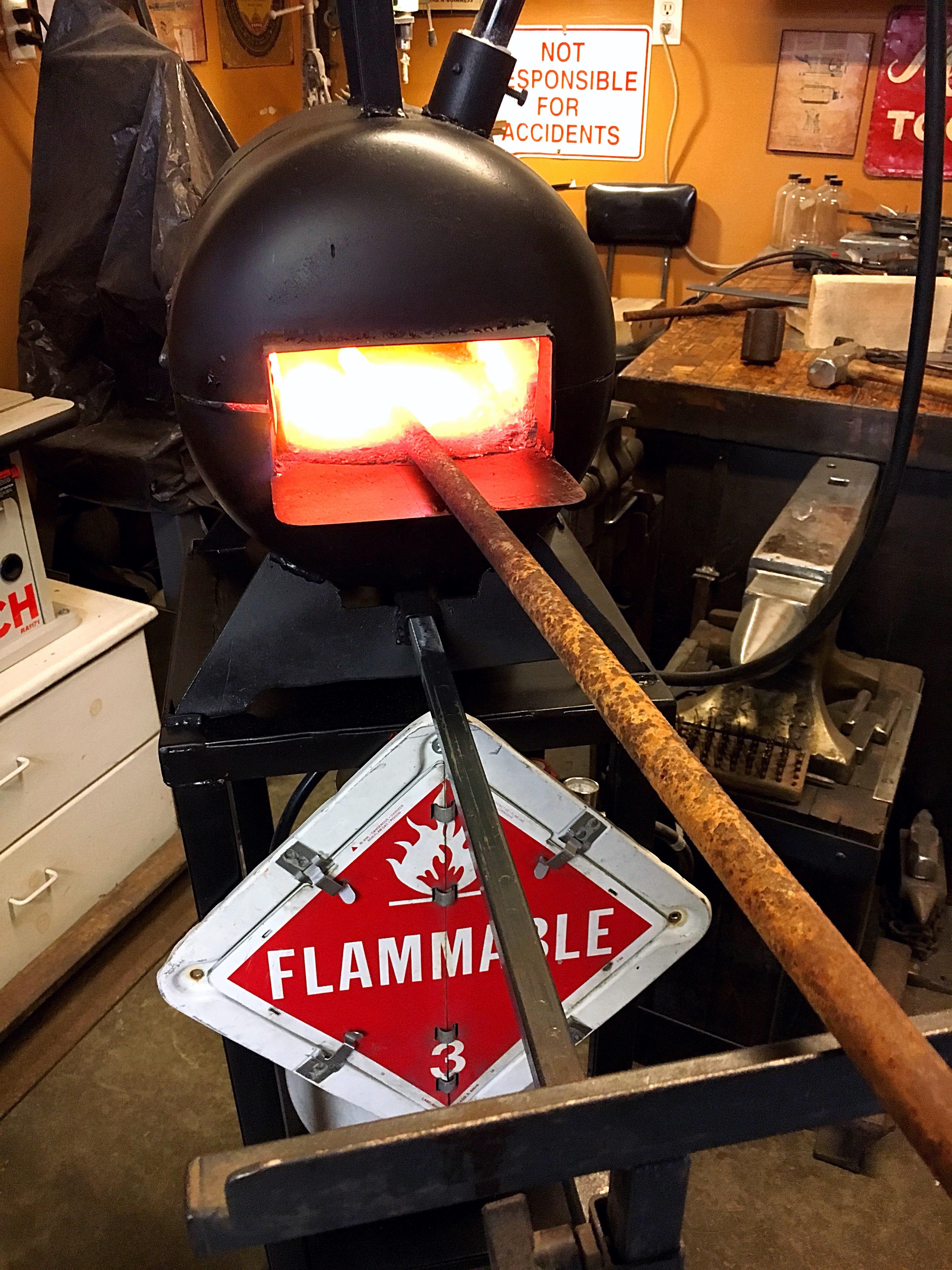

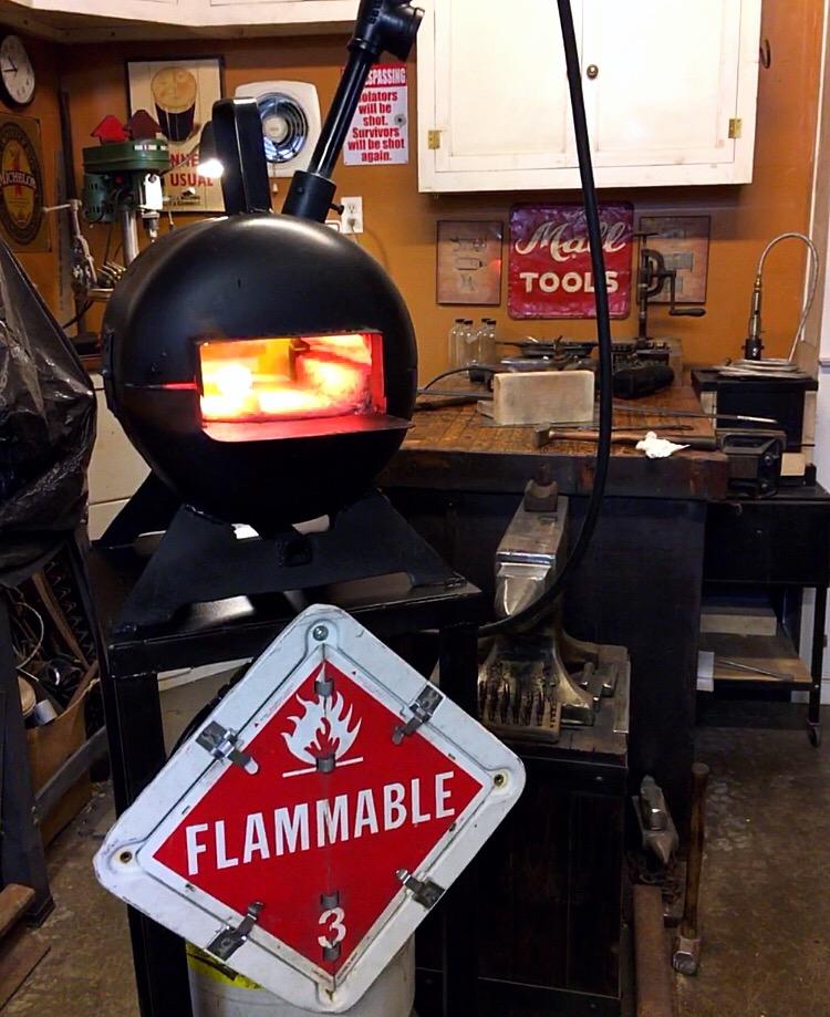

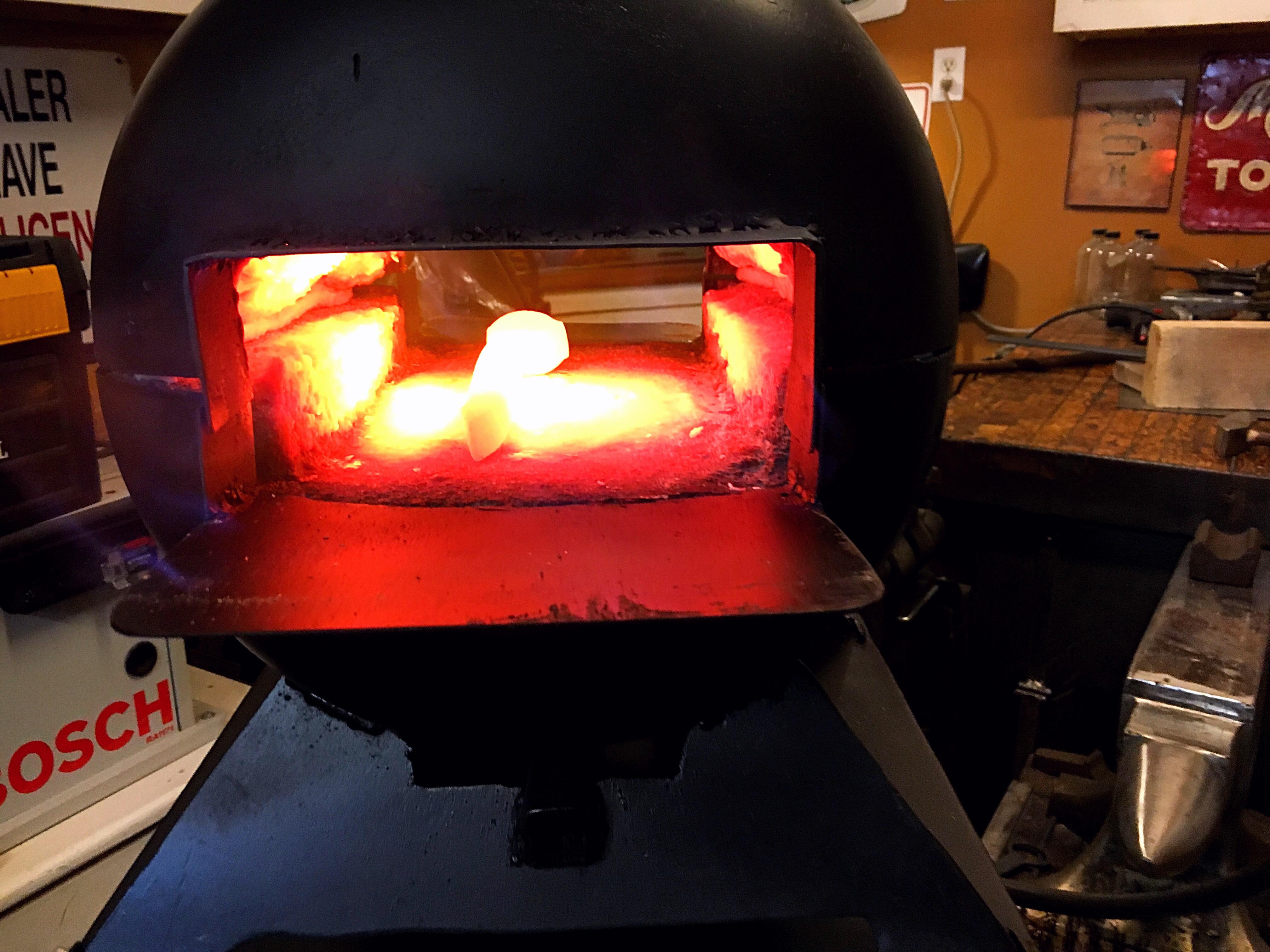

GrumpyBiker Posted August 17, 2019 Share Posted August 17, 2019 Thank you for putting it in layman’s terms for me. Went back and re-read the section you suggested. Played with the nozzle “overhang(?)” and backed off the mig tip and ditched the 6” tube for an 8”. (When the new nozzle arrives I’ll add that as well) Its running quite well now. I have one more question that I’ve racked my brain over, I’ll go post it in the forge section if you feel it’s an issue with the forge. Why would the temperature & flame be reduced when I block off the back of my forge? The dragons breath has blue tips when blocked off (nothing like in the previous pics) and yet it goes back to running hot & orange if I open it up. I don’t get that. Is it because of a lack of oxygen? Quote Link to comment Share on other sites More sharing options...
Mikey98118 Posted August 18, 2019 Author Share Posted August 18, 2019 3 hours ago, GrumpyBiker said: Why would the temperature & flame be reduced when I block off the back of my forge? The dragons breath has blue tips when blocked off (nothing like in the previous pics) and yet it goes back to running hot & orange if I open it up. I don’t get that. Is it because of a lack of oxygen? No; lack of pressure, or to put it another way: too much back pressure for a naturally aspirated burner. However, the solution isn't to leave the exhaust opening wide open. Instead look into using a baffle wall in front of the opening, but a little way forward of it. Your forge has a convenient ledge to stack bricks on, so that you can leave a small opening to move stock in and out of, while exhaust can freely vent upward between the brick and forge shell, and for radiant energy to bounce back into the forge from; a win, win, win situation. As to which thread these answer belong in...alas, life is not perfect Quote Link to comment Share on other sites More sharing options...

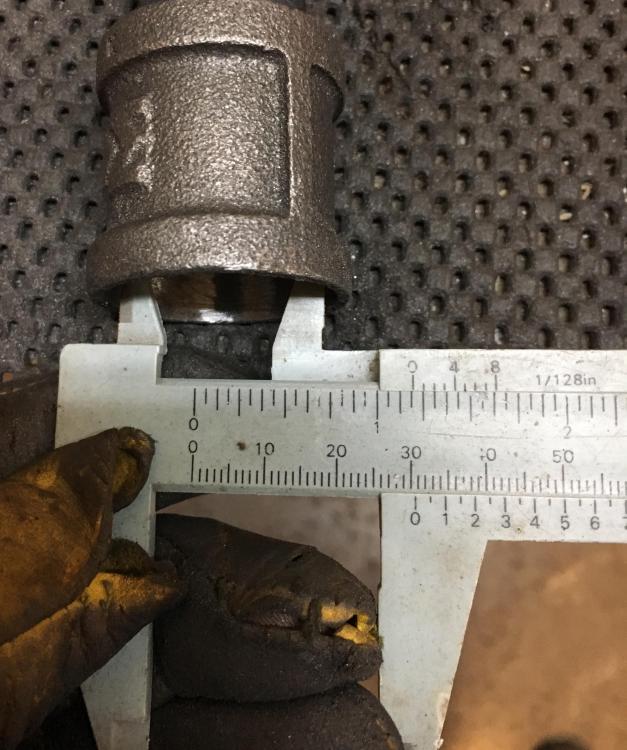

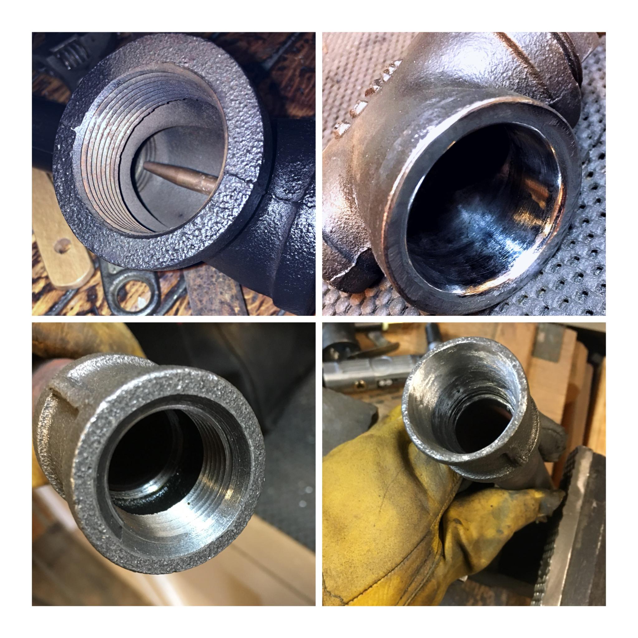

GrumpyBiker Posted August 19, 2019 Share Posted August 19, 2019 Well I know this is burner related... Has anyone done a “Port & Polish” type job to a home built burner? I bought an extra one of these reducing T’s and thought I’d see if removing the threads & opening it up a bit and polishing the inside would make a difference. Also beveling the top of the tube & polishing it. It was 95° and I didn’t feel like running the forge. We used to do this to the intake manifolds on my hot rods to improve flow and performance and I got to thinking that while it’s s short run , would it make any positive difference? I’ve yet to run it but was wondering if anyone had tried it? Also what’s you opinion on altering a coupling into a nozzle? I looked over Frosty’s PDF and thought that while I was making a mess of my shop I’d give this a go as well. Quote Link to comment Share on other sites More sharing options...
GrumpyBiker Posted August 19, 2019 Share Posted August 19, 2019 Any opinions & feelings are welcomed, I’m just playing around at this point since I’ve been helped into a working & usable forge. I now have a little time to mess around. Quote Link to comment Share on other sites More sharing options...

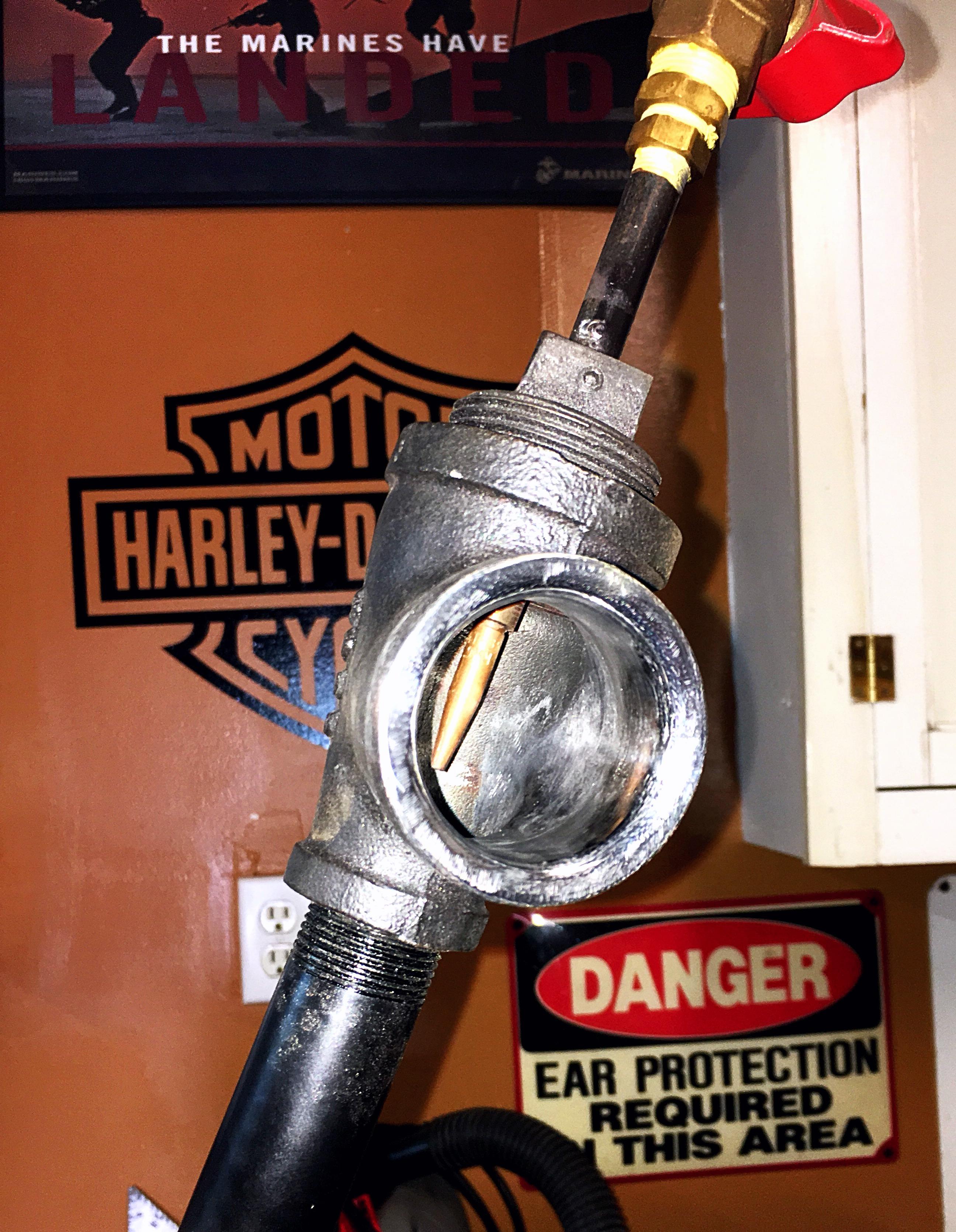

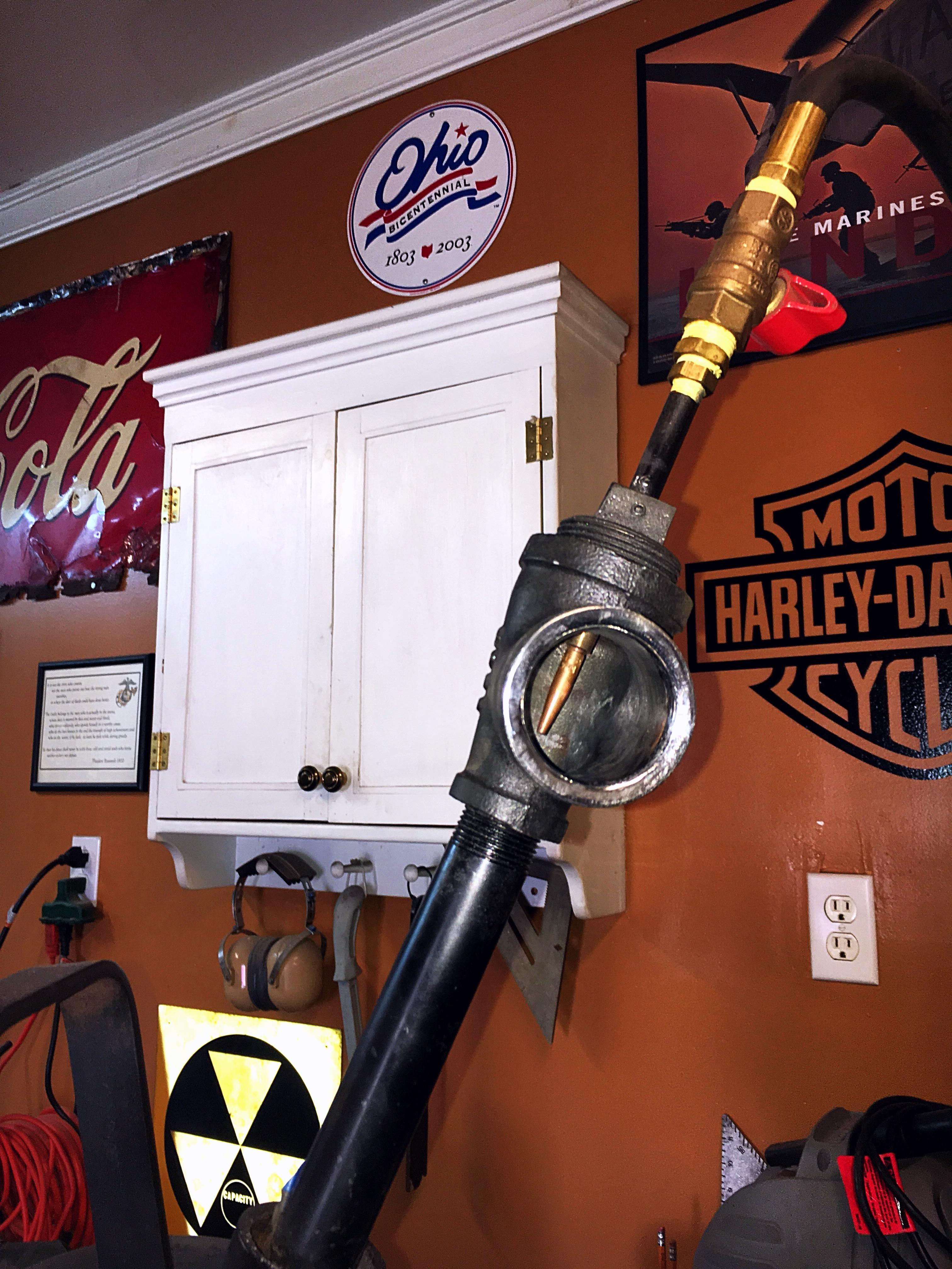

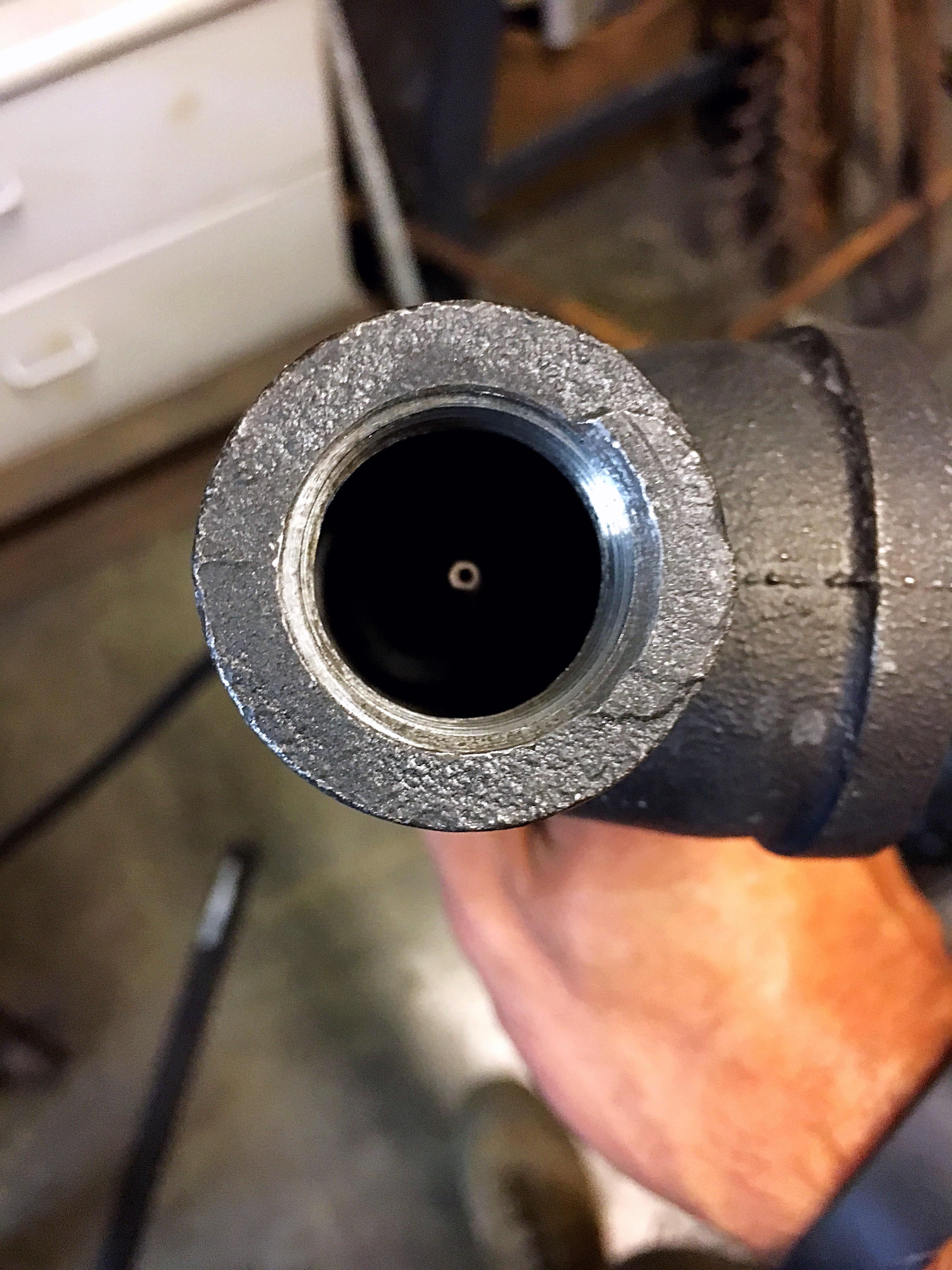

Mikey98118 Posted August 19, 2019 Author Share Posted August 19, 2019 The last two photos show the MIG tip moved back; that's good. None of the photos show us whether or not it is aimed to center at the mixing tube; why? Quote Link to comment Share on other sites More sharing options...
GrumpyBiker Posted August 19, 2019 Share Posted August 19, 2019 There’s only one set screw holding the mig tip nipple in place . Theres no lateral adjustment in its current iteration. I’ll disassemble it in a bit and take a pic from the burner tube hole with the tube removed. Quote Link to comment Share on other sites More sharing options...
Another FrankenBurner Posted August 19, 2019 Share Posted August 19, 2019 2 hours ago, GrumpyBiker said: I’ve yet to run it but was wondering if anyone had tried it? You already did it. Start at a lower pressure and fire it up. You can educate us as to whether it's worth doing or not. 42 minutes ago, GrumpyBiker said: I'll disassemble it in a bit and take a pic from the burner tube hole with the tube removed. If you sight down the burner from the flame end with the mix tube still on, you can gauge the jet alignment. Quote Link to comment Share on other sites More sharing options...
GrumpyBiker Posted August 19, 2019 Share Posted August 19, 2019 Well that was not easy given a smart phones offset camera . 15 pics later and all with the flash were garbage. This is sadly as good as I got today. I did take a slow-mo video of the swirling flame from the burner. Not experienced enough with this burner as it’s new to me , to be able to say if it’s better or by how much. I may start a forge log and keep track of the temp , humidity & barometric pressure each time I run it and document observations for the first couple months until this Forge & I get to know each other better. Quote Link to comment Share on other sites More sharing options...
Mikey98118 Posted August 19, 2019 Author Share Posted August 19, 2019 It looks a little out of center. If the flame comes out of the flame retention nozzle looking even and centered, it is good enough. If the flame is unever and/or lopsided, then you need to get another plug, and try again. Also, the MIG tip's orifice look way too large. Quote Link to comment Share on other sites More sharing options...
Frosty Posted August 20, 2019 Share Posted August 20, 2019 I've tried cleaning out the threads and machining tapers on my lathe but wasn't impressed. That was years ago and I didn't persist so my impression doesn't mean much now. When I see swirling orange flames like that in a forge I think it's running richer than I like and I like my forge running a LITTLE rich. However it may be the refractory you used in your forge. What refractory is your flame face? It's hard to get a good line on the mig tip just looking at the fitting. What looks like an out of line jet in the pic may be the camera angle. If you screw a pipe nipple on it so you have a longer sight line and stand back it'll become obvious. You won't have to ask us if it's aligned. You're coming along, this isn't as intuitive as it sounds but a little practice and it'll come to you. It's like tuning an engine by ear, you have to know what slightly: too lean, out of time, corroded points, etc. sounds like. Once you do you can tell as a car drive past. Yes? Frosty The Lucky. Quote Link to comment Share on other sites More sharing options...
