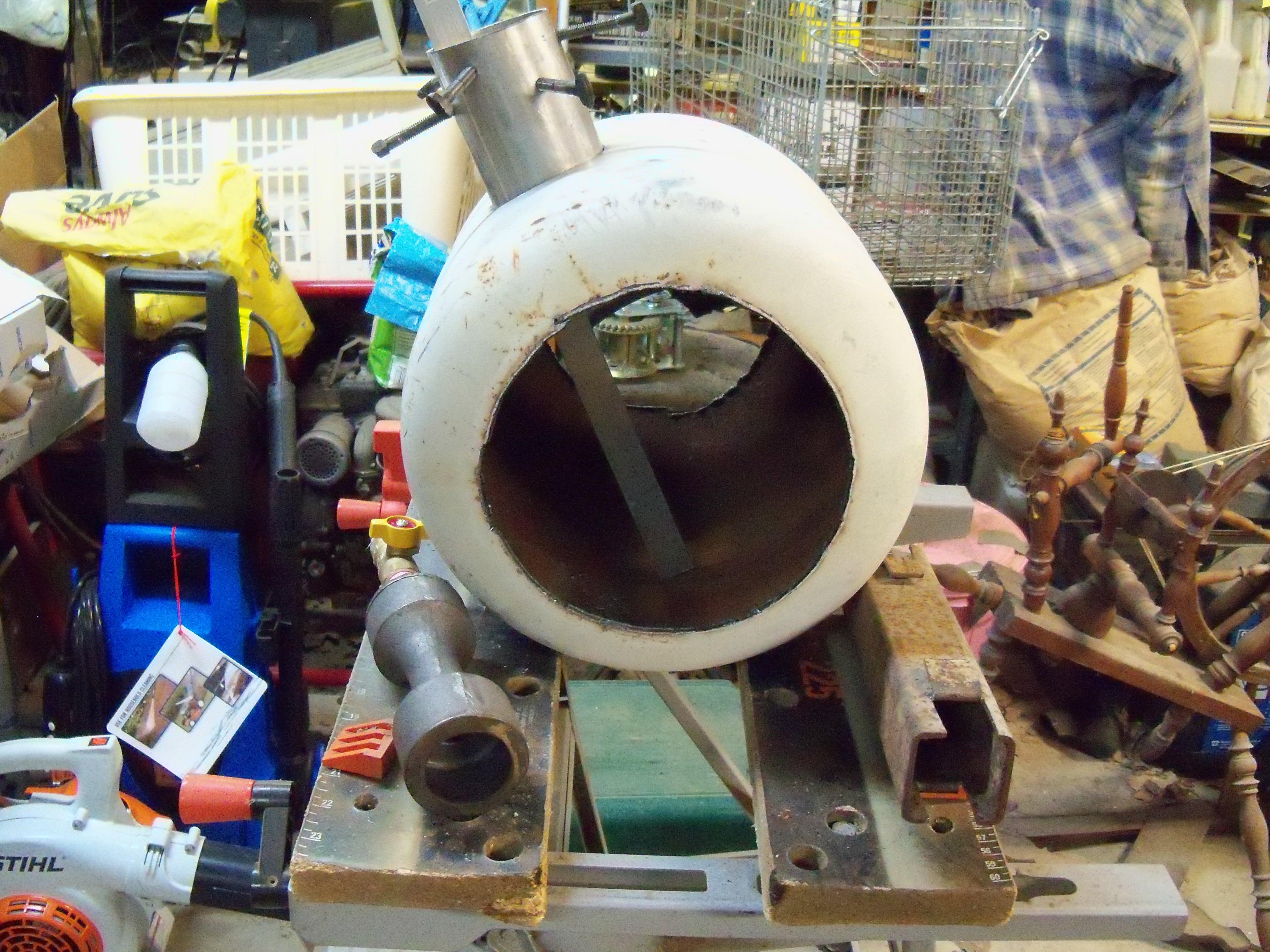

Another FrankenBurner Posted June 28, 2019 Share Posted June 28, 2019 8 hours ago, BlueGoat said: I do want to see if I can get similar results using a 030 Orifice diameter has a sweet spot just like mix tube length and nozzle overhang. It's all about balance. Based on your pictures and description, I think you have found a nice balance. I suspect a smaller jet will result in a very lean flame. Maybe a flame that will not stay lit. The only reason I see for going to a smaller jet is if you can not induce enough air. Edit: you just posted as I posted. Quote Link to comment Share on other sites More sharing options...
Trevor84 Posted June 28, 2019 Share Posted June 28, 2019 Ok that's good to know, I'll make sure not to lose the settings I have currently. I'll tinker with it a bit just to see since I have the parts already. I'm thinking my forge will allow room to swirl the flame I have but you got my thinking about a slower fatter flame when we were talking about the mixing tubes. I'm heading to the shop in 10 to go play mad scientist a little more and see what happens. Then it's on to finishing up the forge so I can really test this sucker. (Jynx) Quote Link to comment Share on other sites More sharing options...
Another FrankenBurner Posted June 28, 2019 Share Posted June 28, 2019 Tinker away. That's good stuff. Great way to learn. As to the shorter flame, you probably won't see much difference between 8" and 6.5" mix tube lengths in that regard. You may see your flame go darker blue. I have no doubts about your forge getting hot enough if it is insulated well. Quote Link to comment Share on other sites More sharing options...

Trevor84 Posted June 28, 2019 Share Posted June 28, 2019 Thank you, I will watch for that as I put things together then I tried 7.5, 7, 6.5, 6 mixing tubes with both 0.030 and 0.035. I either ran rich with the 030 (believe it or not) and lean with 035. It seems my original set up is burning the best thought the range. Without drilling the 030 bigger. 023 wouldn't even light. Time to get the forge finished then adjust it in there too if needed. Thanks for the help so far guys. Quote Link to comment Share on other sites More sharing options...

Frosty Posted June 28, 2019 Share Posted June 28, 2019 2 hours ago, BlueGoat said: I either ran rich with the 030 (believe it or not) and lean with 035. Did you take any pics of this? That is so backwards of what should be happening I have to wonder if you're seeing what you think you're seeing. Forget about the 3 zone burner flame. That's a legacy description I wish would go away. Back when the internet went public and I discovered there were other metal heads out there I was tinkering trying to get a burner to work properly. I based a lot of my tinkering, tweaking and tuning on how an oxy acetylene flame is supposed to look. I managed to get the early T burners to produce a 3 combustion zone flame AND work well. However an air propane flame shouldn't have the same burn zones as an oxy fuel flame. All that rambled and the point is. Do NOT worry about or try to get a 3 burn zone flame. Your's looks pretty good as it is. Shorter mixing tube makes faster bushier flame, longer makes slower longer flame. Lots of folk make the mistake and make 3/4" tube 8" long, it's within the generous tolerances this type burner allows us. But be prepared to shorten it some once it's inside a forge, the back pressure WILL effect it but maybe not enough to need tweaking. Frosty The Lucky. Quote Link to comment Share on other sites More sharing options...
Trevor84 Posted June 29, 2019 Share Posted June 29, 2019 I hyper focused on trying to get those two "zones" to kinda blur as I was tinkering. I wrote notes but didn't lable the pictures while I was testing shorter tubes, doh. I did notice like you say the shorter bushier flames but I had to move the choke quite a bit throughout the psi range to keep the flame looking decent. I have the notes regarding the different length mixing tubes and nozzle over hang. So when I get it in the forge I'll have a starting point. These two sets of pictures are with the 8" the first set is 035 no choke adjustment the second is 030 with choke almost closed at the beginning and finishing wide open. Quote Link to comment Share on other sites More sharing options...
Frosty Posted June 29, 2019 Share Posted June 29, 2019 Having to choke it means the 0.030 jet is drawing more air than it needs. The pics are labeled (0.030 x 8 x 1) Aren't these 3/4" tubes or did I miss the change? I don't understand the 3 digit number either. I like the first three 0.035 pics. The 0.030 looks pretty good all around. Frosty The Lucky. Quote Link to comment Share on other sites More sharing options...
Trevor84 Posted June 29, 2019 Share Posted June 29, 2019 Those numbers are my own reference kinda. 8"mixing tube (3/4") with a 1 7/16" or 1 9/16"over hang of the nozzle. Those seemed to be the magic numbers for stability. I couldn't type it that way when I named my album. If you think the 030 is best all around I'll grab a couple pics with the different mixing tube lengths tomorrow. I may not be reading it right, it's really hard looking at a flame with my eye, through my phone and trying to match it to pics from here. I'd post the videos of the flame but I haven't figured out how yet. Quote Link to comment Share on other sites More sharing options...
Trevor84 Posted June 29, 2019 Share Posted June 29, 2019 I'm trying to use these pics as guides but I'll see green with my eye and bright blue on my phone, I'll see a ghostly blue with my eye and a darker blue on the phone etc when I dim the light filter to snap a shot. I guess I'm being nit picky but I'm waiting for insulation anyways. As for the choke, I'm hoping to get it to run with out it so I don't have to muck around with it unless I want a reducing flame. Thanks again Frosty, I'll check in tomorrow. Quote Link to comment Share on other sites More sharing options...
Mikey98118 Posted June 29, 2019 Author Share Posted June 29, 2019 42 minutes ago, Frosty said: he 0.030 looks pretty good all around. agreed. Quote Link to comment Share on other sites More sharing options...
Mikey98118 Posted June 29, 2019 Author Share Posted June 29, 2019 Your numbers are reversed to how we use them. What you call number 4 isn't a part of the flame at all; it is the interface between the incoming fuel/air mixture and the flame, as seen through the flame envelope. What you call number 3, and we would label number 1; it is the primary flame envelope, but is in this case it is reducing, which is why there is a short secondary flame, which you and we both label number 2. The final visible flame, which you call number 1, and we label number 3, is a tertiary flame. Quote Link to comment Share on other sites More sharing options...
