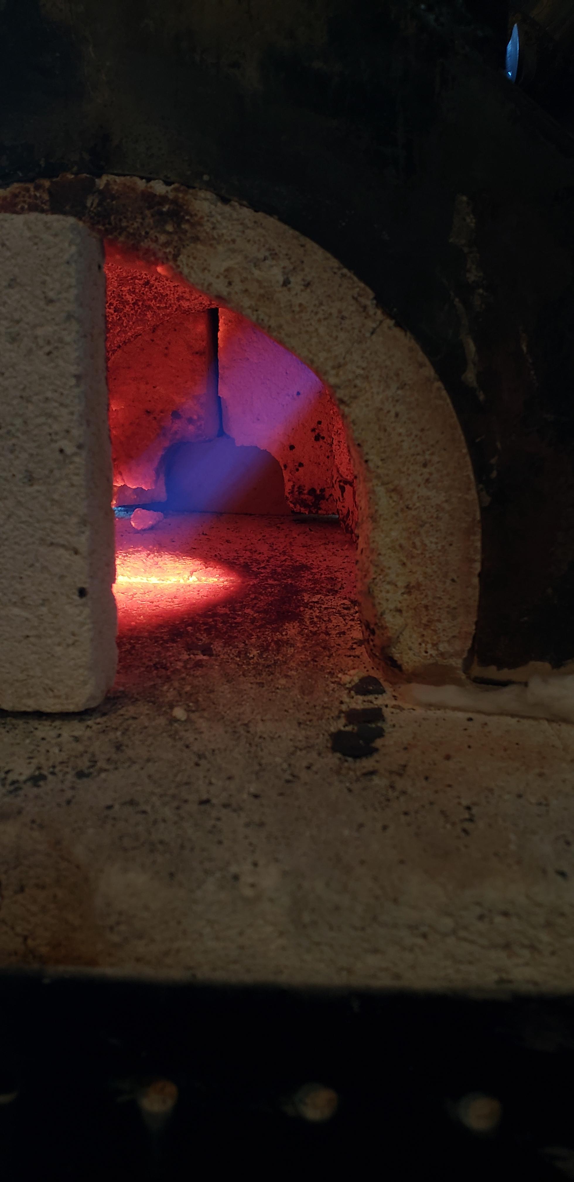

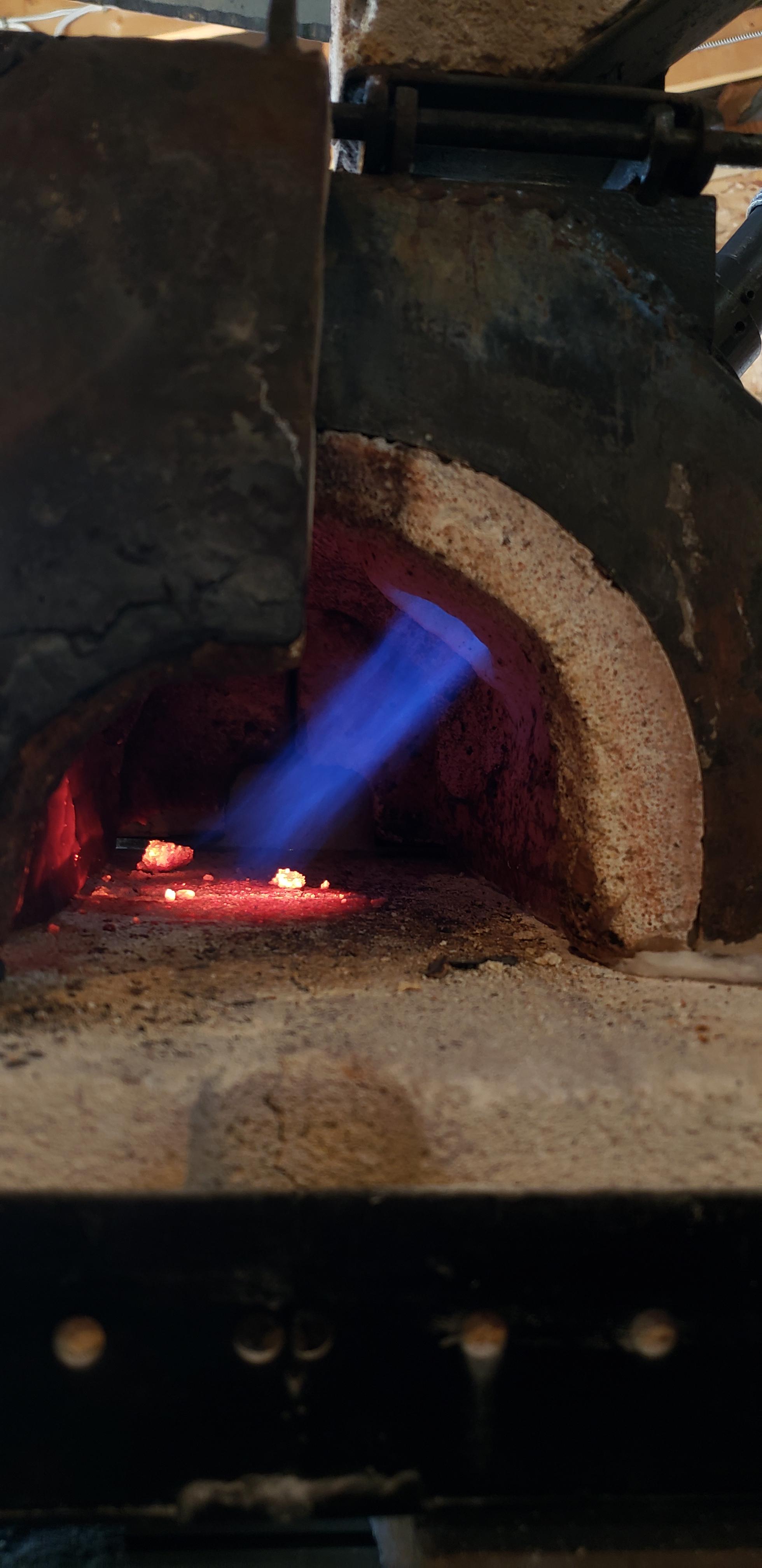

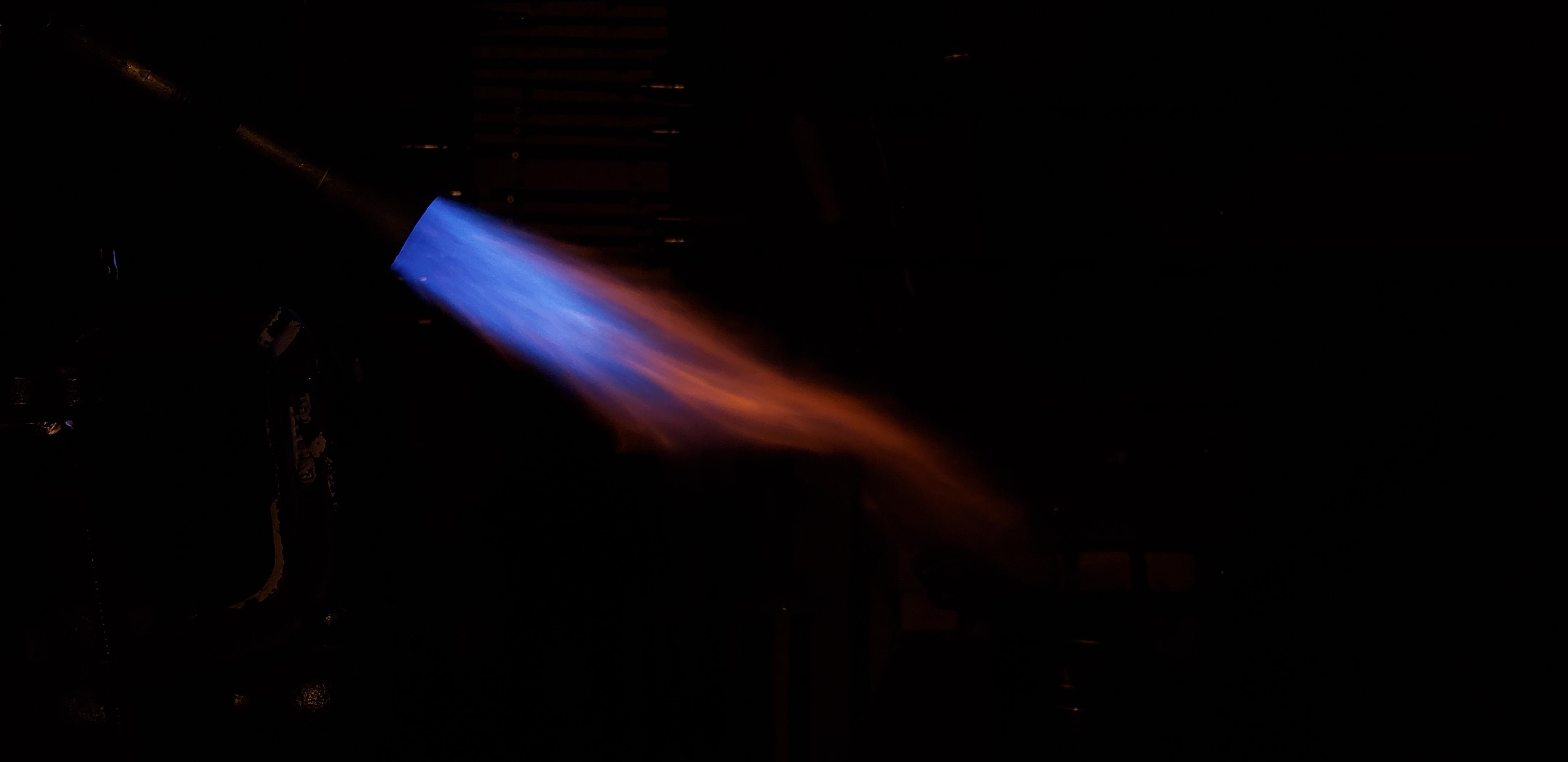

Flame's a little rich, it needs more air. I'd make suggestions but Mike adjusts his burner's the air fuel ratio differently than I do on.

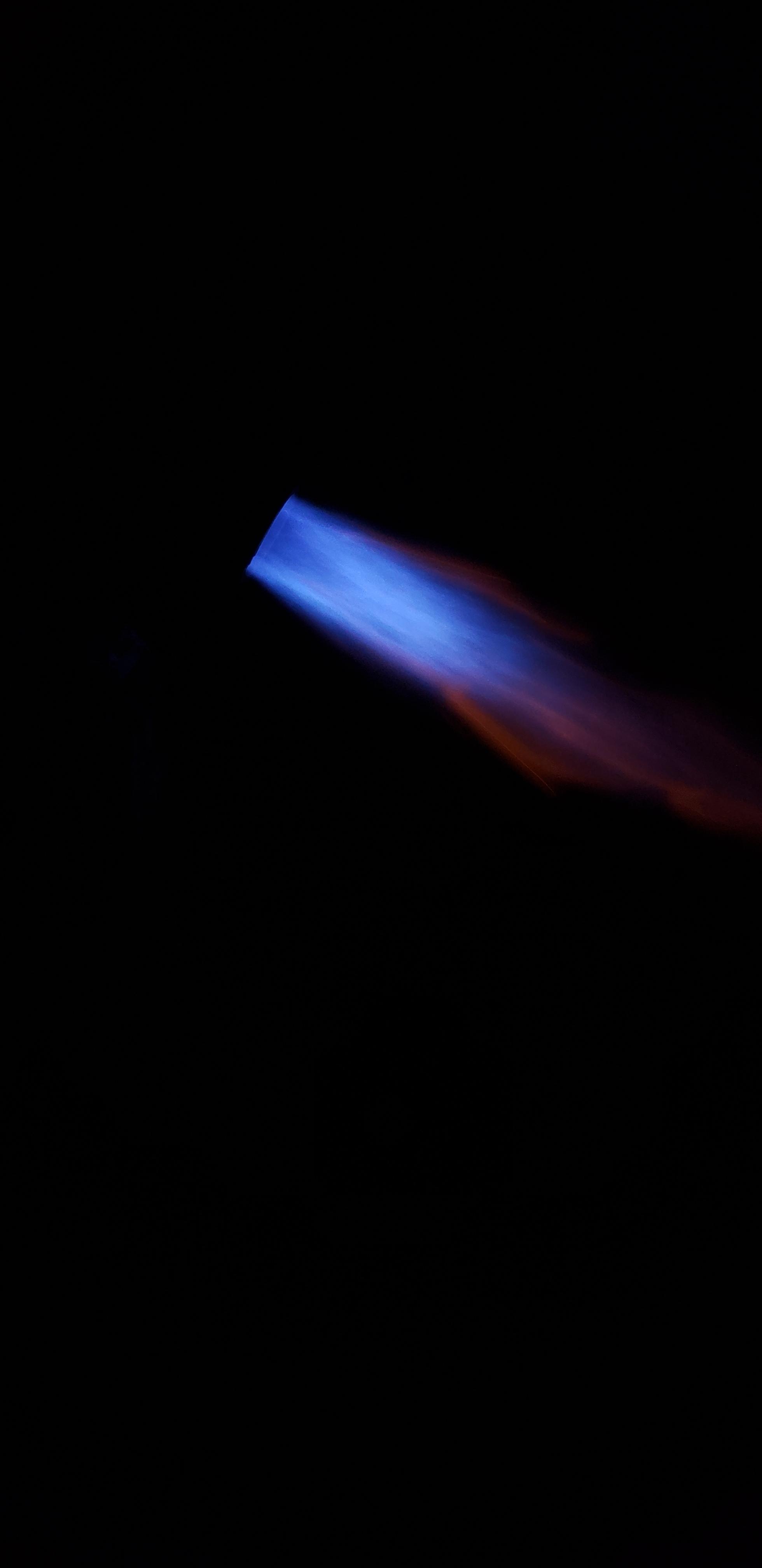

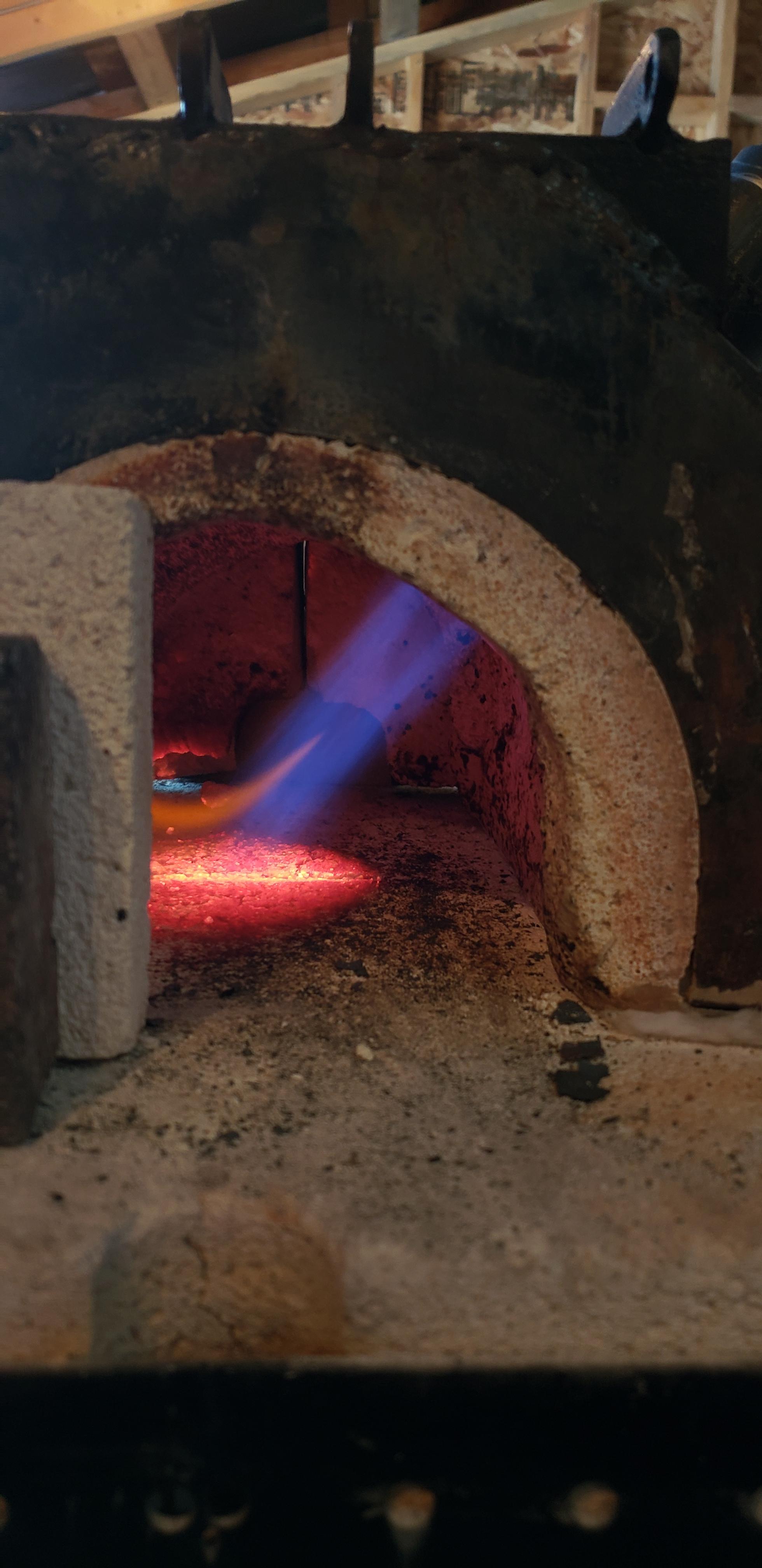

The last 3 pics are all without changing anything with the burner but the amount of orange will constantly change. In the forge the nozzle is cast into my liner however outside the forge I have a step nozzle on there. The nozzle is a 1" nipple with a 1/2" overhang then a 1 1/4" overhanging the 1" by about 7/8". The orifice seems to have the same outcome when I set it between 1/2" from the bottom of the air slots up to about 1 1/2". I have another jet set up with a .030 tip that I will try out tonight but in the meantime if you have any thoughts I am all ears.
Frosty thank you. I wasn't quite sure about the color but if you're thinking that looks rich I will definitely try out the .030 jet, I always struggle judging the flame colors. Is the tertiary suggesting rich or the color of the blue?
Moving the gas jet doesn't seem to have the kind of effects on Air Fuel (AF) ratio as it does with a T burner so I wouldn't mess with jet position, leave it where Mike says it should be.

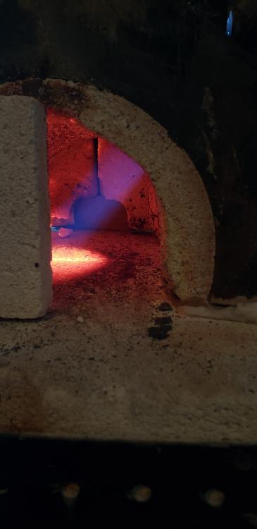

The best looking though still rich flame is in the forge. However you've shaped your liner it's working well as the nozzle, you might try pulling the burner farther out by degrees.
I'm not envisioning what you're describing for the step nozzle you're using outside the forge. If I'm not mistaken lengthening the final nozzle after the step increases induction, for a Mikey.
I'd play with the final nozzle or position in the forge BEFORE changing to a smaller jet. I THINK a 0.035 jet is pretty large for a Mikey but if you can get one adjusted to neutral it'll make him a happy camper. I'll also get to say "I told you so!:P"
Seriously, play with adjusting what you have ONE THING AT A TIME, then test and TAKE NOTES. Save making physical changes to the burner till you've exhausted adjustments.

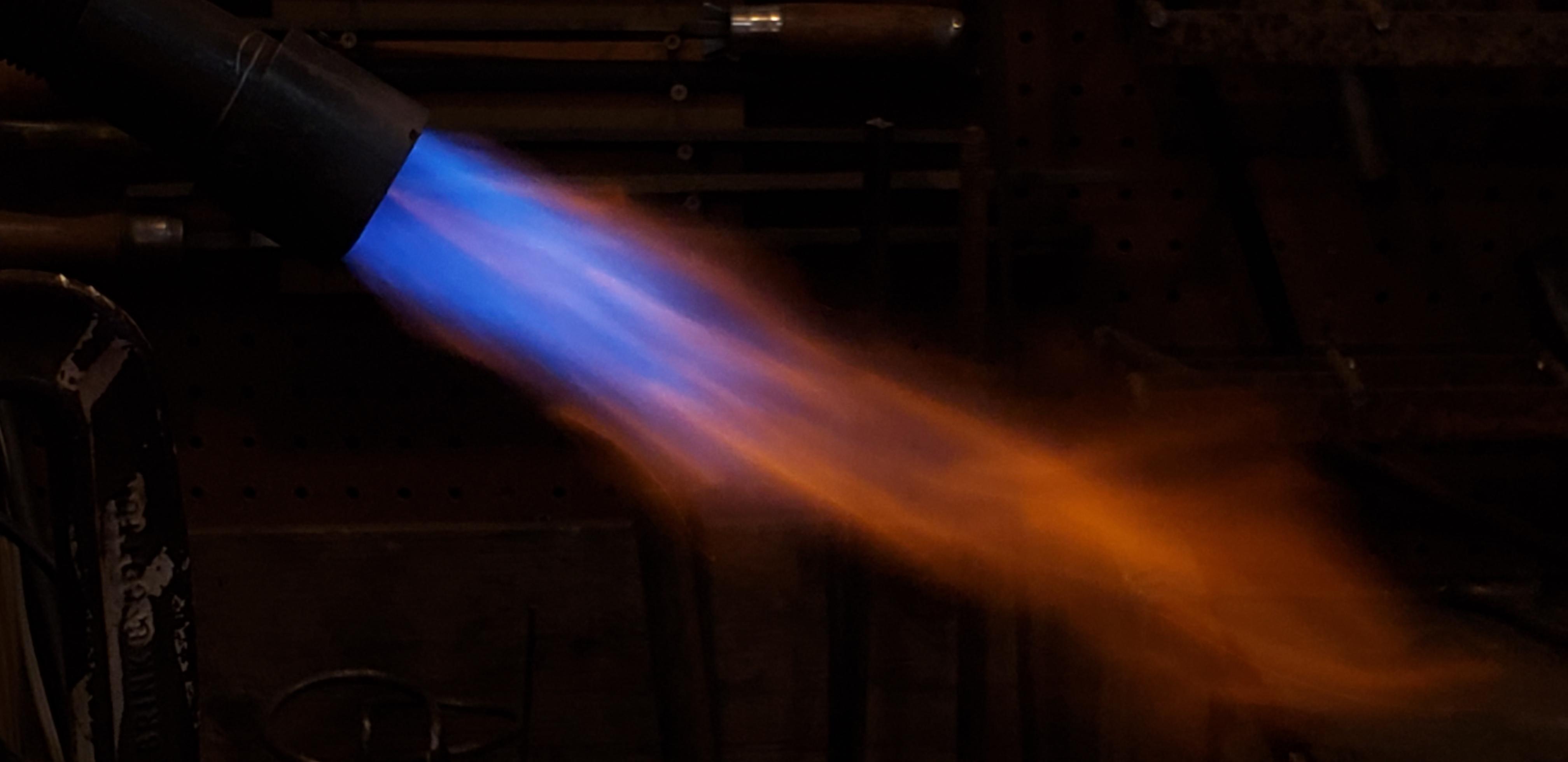

Any time you see long feathery flames it's rich, whether there is orange or yellow in the flames. Orange AND feathery is like a rotating beacon. The color is opaque light blue indicating unburnt propane, water vapor and CO2 are invisible. A stoichometric (sp?) or perfectly balanced AF ratio leaving no unburnt fuel or oxy, propane flame byproducts are water and CO2. If the tertiary flame is visible it isn't really neutral.
For my forge I like a SLIGHTLY rich/reducing fire to prevent scale forming IN the forge. Scale WILL form the second you expose hot steel to ambient air, no help for that but you certainly don't want your forge acting like a scale factory. Don't overdo though, just a LITTLE rich is more than good enough. That's getting down to fine tuning so let's get you in the ball park first.

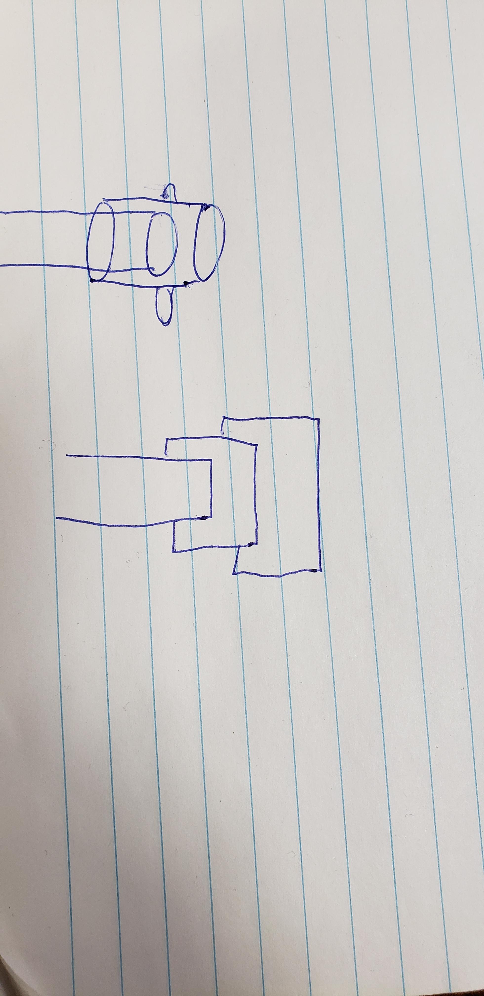

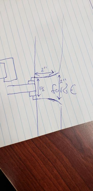

When the burner is in the forge the current pieces I am using as a nozzle only act as spacers, they butt up to the flare in the liner. Outside the forge I just slid these spacers out into a multi step type nozzle just to see how it would act ( I do have other pieces to make a step nozzle as Mickey describes which will be used in future testing ).
Your description of the flame makes sense and adds to my ability to visualize what I am looking for. I guess the first thing I do tonight is going to be taking this apart and give it a clean again to make sure I have zero residue left to rule that out then put the proper step nozzle on and exhaust tuning option there before moving to the next step.
When it comes to the where the orifice should be, I have not found that measurement so I have just listened to it and it sounds like about 1/2" away from the throat may be the ticket there. With the 035 tip in there using the choke does zip until it's almost fully closed so no adjustment to play with there currently.
I do know from reading that the 035 is way bigger than what Mickey calls for so I'm not sure why I started there but it's an easy change if I can't find neutral.
Thanks again Frosty I'm sure Mickey will be around eventually, I got at least 9hrs before I can get back to it anyway........... that whole work thing ;)
this is how the current step looks like

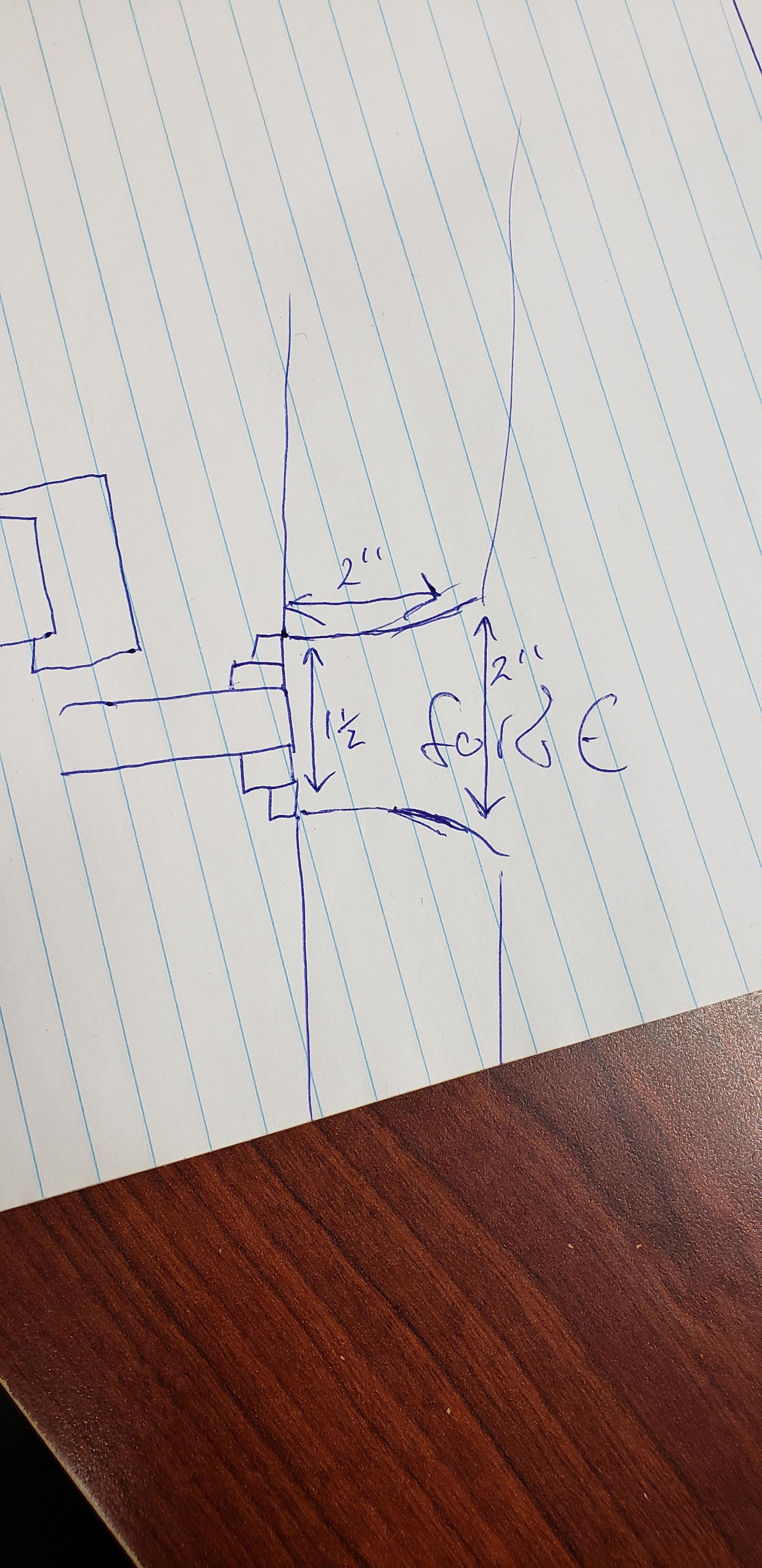

this is a rough idea of how the burner lines up in the forge, it mates up with the cast liner about an inch into the liner unlike how it looks like in the pic but this shows how the cast nozzle kind of looks
The first point is that, you have already succeeded in making a very hot burner, in a very hot forge. I suspect that it is doing this well because you choose to update the air opening placement to three openings with wider ribs between them; smart move.
You have one, and possibly two major mistakes; the definite mistake is is your choice of MIG tip size. The book originally suggested a MIG contact tip for .O23" or .030" welding wire; these have .031" and .038" orifices, respectively. I noted in the book that one was a touch small, and the other a touch large, and suggested that a little work with a wire file from a set of torch tip cleaners would enlarge the smaller orifice to a perfect size.
In the years since publication MIG tips for .025" welding wire have come into the marketplace; with an orifice size, or .034". However, it wouldn't surprise me to find that, do to the improved air openings, your burner could handle a MIG tip for .030" welding wire. We do I think this? Because it is only running a little rich with the oversized .035" wire tip; so, really, that is a simple change.
The possible major mistake is the length of the mixing tube, which looks a little short; why possible? Because the position of the burner is foreshorten by the angle of the photos.
Are there other problems? Yes, but they are too minor, to effect performance in the view of perfectly sane people :D

Nevertheless, a very hot flame--from a high speed tube burner--has a single flame envelope--without secondary flame; it is also compact. There is far more that can be stated, and has been, but those are the first factors to look at. A "T" burner makes a different flame, which is also very hot. Another Frankenburner's deign probably has some difference in his perfect flame, and is almost certainly, the hottest burner around.
If you do decide to build a second burner, try shortening the air openings to about two-thirds the length you have. I deliberately  made the original openings a little long. The wider air openings also shorten the length needed; these two factors together, make shorter openings desirable, for those who want a better burner design.

Oh boy I missed a bunch while I was away. 671Jungle, that's a beautiful flame nice stable shape.
Hey Mike I already had two burner Tubes made up so I would be able to try different lengths after the air slots. For some reason I can't get a decent flame burning outside the forge, I'm trying to use a step nozzle and have put it together in several configurations but I either run rich with the orange flame or I blow the flame out.
I cleaned up the air slots, trimmed the mixing tube to 8" after the air slots, 0.023 contact tip. Inside the forge I can get these flames. I get no dragons breathe once I get the forge up into the yellow range and yellow is easy to hit and hold. Im not sure what you see in these flames but they seem to be working fairly well.
To hold a yellow temp with my old burner running a 0.035 tip I would run about 10psi. This burner running a 0.023 I run about 10psi for the se yellow temp. Am I correct in assuming that I am using less fuel but getting more heat because I'm getting a more efficient burn?

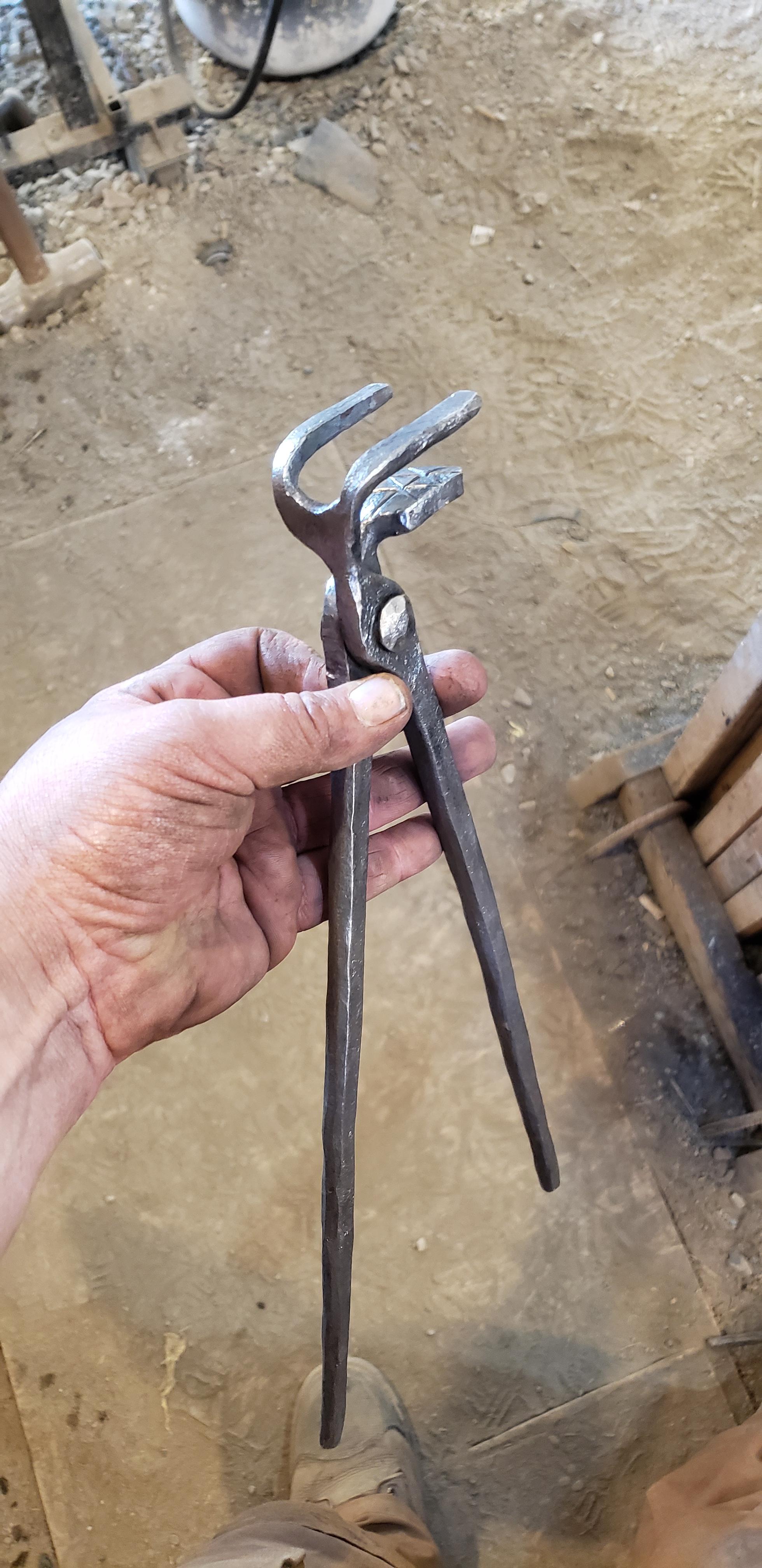

Here's a couple flame pics and a pair of tongs this new burner helped make.

Trevor, nice tongs.  Are those for rail spikes?
