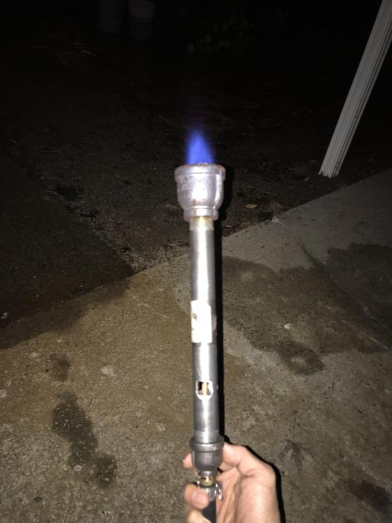

671jungle Posted December 25, 2019 Share Posted December 25, 2019 Burner is too fast for the coupling. Didn’t have readied material to make a step nozzle so I threw a 3/4” - 1 1/2” reducer on the end. Seems to like it. Happy holidays everyone! Thank you for all the help and great reading https://youtu.be/lq3sABu5ezo Link to comment Share on other sites More sharing options...
Frosty Posted December 25, 2019 Share Posted December 25, 2019 Merry Christmas All. Frosty The Lucky. Link to comment Share on other sites More sharing options...
Mikey98118 Posted December 25, 2019 Author Share Posted December 25, 2019 First, congratulations on such a hot flame. And then, yes you will most likely have to use a slide-over flame retention nozzle to sufficiently adjust the flame. Or maybe not; have you tried wrapping paper around the mixing tube, and running it back and forth to adjust incoming air? The video only confirms the photo; it is a perfect flame. Link to comment Share on other sites More sharing options...
671jungle Posted December 27, 2019 Share Posted December 27, 2019 On 12/25/2019 at 2:29 AM, Mikey98118 said: have you tried wrapping paper around the mixing tube, Seems to like it as is. I will add a choke for blademaking and welding. I am very happy with the rigidity of the design and heat it puts out. However Another Frankenburner is on a tear with his compact high output ideas. Larger orifice + smaller mixtube = heat comparable to larger burners must mean proper mixing is starting right at the get go coupled with the proper retention nozzle? Link to comment Share on other sites More sharing options...
Mikey98118 Posted December 27, 2019 Author Share Posted December 27, 2019 His ideas, and his success with them does not negate your success with this burner. Choices are a good thing Link to comment Share on other sites More sharing options...
Another FrankenBurner Posted December 28, 2019 Share Posted December 28, 2019 What he said. Your latest burner looks like a great burner. On the easier to build end of the spectrum which is a great thing. What was your reasoning for placing the air inlets that far from the end of the pipe? Link to comment Share on other sites More sharing options...
671jungle Posted December 28, 2019 Share Posted December 28, 2019 Thank you gentlemen. I base my ideas on the info you provide. It is much appreciated! I wasn’t sure how far I needed to open the intakes to get sufficient air, so I started at target distance from flame end and worked my way back. It also mitigates the need to bevel the reducer for smoother air flow. The 8” pipe in big box stores could be used too but the reducer must be beveled. Link to comment Share on other sites More sharing options...
