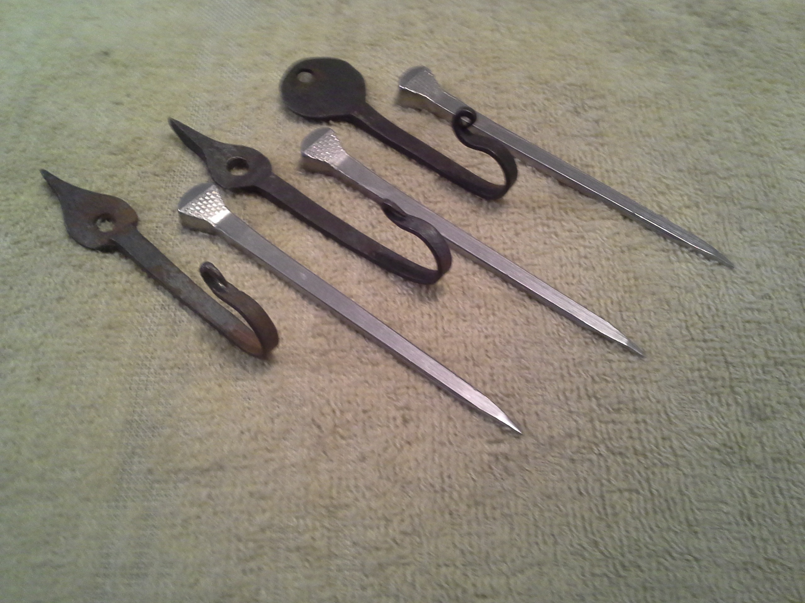

SReynolds Posted April 3, 2016 Share Posted April 3, 2016 I understand some won't agree but this project/lesson will develop serious smithing skills. It's alot like the Mr. Miyagi -Karate Kid approach. Yes it stinks. But we can't all dive directly into smithing knives from iron and 52100. I am quite a supporter of drawing 1/4 square into a long taper and this can piggyback that exercise. This is for established smiths too. Grab yous a box (dirt cheap and many uses) of #16 horse shoe nails. The head is kinda small but it's possible. They are about 3/8x1/4 head. Draw just the very tip of head into a point. Then widen out the remaining portion to resemble a flame. Heat the opposite end (nail point) and form eye with a hammer or needle nose pliers. This eye is rolled to the back side. Backside being the flat side of flame you forged. The use a small jig to roll the hook or a small bick works well. Punch a hole cold as it is quite thin. Horseshoe nail candle flame hook. A mouthful, yes. Another is a forged quarter-sized nail head with mounting hole. Try these. Not so easy unless you have precise hammer control. And yes; These little guys will frustrate you to point of wanting to throw a hammer. Sleep will be lost untill you master these exercises. I have my students (attempt) to make these. They think drawing out stock and S-Hooks are stupid. Though they can't do either draw out nor S-Hooks , these little guys are humbling cuz I make it look so easy. Besides; it's just a nail. How hard could THAT be? Quote Link to comment Share on other sites More sharing options...

SReynolds Posted April 3, 2016 Author Share Posted April 3, 2016 The exercises are more intended to establish hammer skills and fire control for beginners. It's nice in that the exercises employ little steel stock and it heats rapidly. The down side is it burns real easy and cools quickly. I employ a number of beginners exercises in the class; draw out. Cutting on the hardie. Rounding square stock. S hooks. Twisting. And the two aforementioned nail hooks and round headed nail hooks. If time allows; forging 3/16 nails. Please feel free to share some beginners exercises you teach or have used yourself. Quote Link to comment Share on other sites More sharing options...
VaughnT Posted April 4, 2016 Share Posted April 4, 2016 Love it, S! I'm always looking for projects that keep folks working on the basics. Too many people think they can fly before they even know how to crawl. I always ask, how can you expect to make a sword when you can't even make a decent hook? This will definitely be a challenge since I've never attempted to work anything so small. But, there's a store right down the road that sells horse stuff and I can see me picking up a box of nails in the near future. Quote Link to comment Share on other sites More sharing options...
ThomasPowers Posted April 4, 2016 Share Posted April 4, 2016 My "intro" class does a S hook and two nails out of 1/4" sq stock and then if they have enough time they do a chile pepper out of black iron pipe. All of these projects have drawing out and keeping it square doing so as part of them. The hook is hammer and anvil; though after teaching them how to do the counterbend with the hammer and anvil I then demonstrate how to do the other end with a pair of needle nose pliers that is dedicated to forge work---"The only correct way to do a process blacksmithing is ANY WAY THAT WORKS!" (Had a more advanced student having trouble bending some 1/2" sw stock on the horn so I reeled off several other methods: stick it in the hardy hole, use bending forks or wrench, use the postvise---best for his skill level and requirements; etc.) I used to do all my small work with a 3.5# swedish cross peen; till I realized I was just bragging about the control I had and in rality I was messing up my arm "holding back" the hammer when doing delicate work. Been married nearly 32 years now and don't need to impress *anybody* so now I use and teach doing small delicate work with small delicate tools, works better and you can do it all day long without messing with your arm---though to mess with their minds I will sometimes switch from the 8 oz cross peen to the 8# one handed sledge to more a different project along...Gas forges are great for having delicated and heavy work in them at the same time! Quote Link to comment Share on other sites More sharing options...
SReynolds Posted April 4, 2016 Author Share Posted April 4, 2016 Yes sir, I agree. When I have them perform the S-Hook, one end is hammer/anvil and other end utilizes pliers for an eye and a jig for hook. Quote Link to comment Share on other sites More sharing options...
