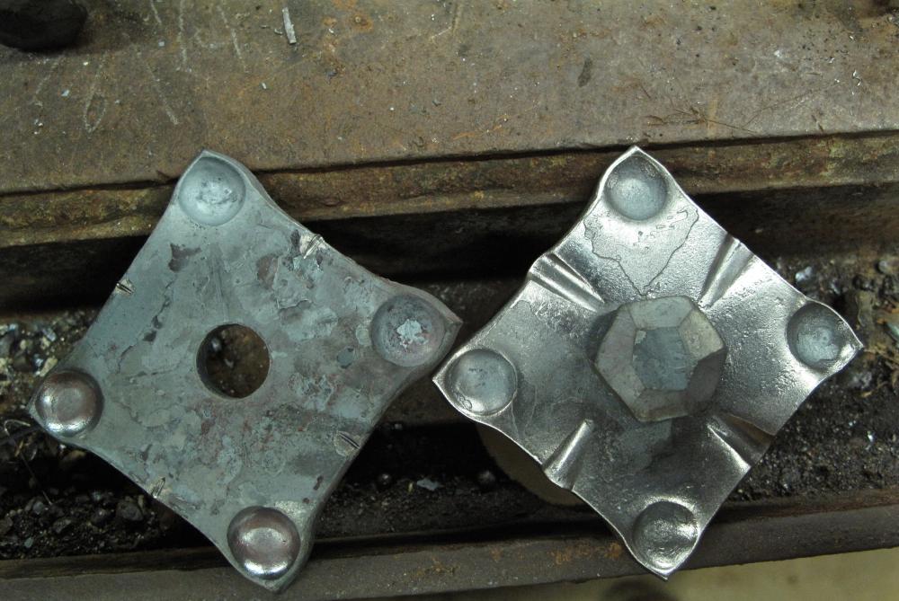

VaughnT Posted July 5, 2016 Share Posted July 5, 2016 The bolt heads are just basically chamfered, but I did do up a few pretty washers to back them up. To keep things moving quickly when I bring them out of the forge, I use a cold chisel to nick the location for the top tool to hit. It might not be necessary, but it makes me feel better about keeping things aligned. Tonight's task is to make a wider top fuller so the washers can get have a bit more spread between the corner divots. You can be that tomorrow will see me in town buying some more lag bolts so I can practice making more complicated head designs! Quote Link to comment Share on other sites More sharing options...
ausfire Posted July 5, 2016 Author Share Posted July 5, 2016 Nice idea, Vaughn. Very decorative. Quote Link to comment Share on other sites More sharing options...

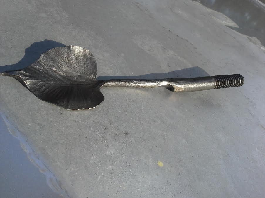

Black Frog Posted July 26, 2016 Share Posted July 26, 2016 Not only do bolts make fun stuff... but threaded rod does too. :-) Quote Link to comment Share on other sites More sharing options...
Daswulf Posted July 26, 2016 Share Posted July 26, 2016 Always love what you come up with Black Frog. What size rod did you use? Quote Link to comment Share on other sites More sharing options...
Michael Cochran Posted July 26, 2016 Share Posted July 26, 2016 That's a very good lookin cobra. I bet I could have fun with one of those sitting in the edge of the bushes by the front door. Quote Link to comment Share on other sites More sharing options...
ThomasPowers Posted July 26, 2016 Share Posted July 26, 2016 I have a rasptle snake under the hose reel picking up some drips to patinate it---my landlord's handyman who waters the place remarked to me on the "surprise" he got the first time he saw it...of course last year we had a total of 24 rattlesnakes caught out here. This year it's been too dry for them. Quote Link to comment Share on other sites More sharing options...
freddy317 Posted July 26, 2016 Share Posted July 26, 2016 Very nice! I like the detail on the underside of the hood. Quote Link to comment Share on other sites More sharing options...
Black Frog Posted July 27, 2016 Share Posted July 27, 2016 21 hours ago, Daswulf said: What size rod did you use? That's a good question, I really don't remember. It was a scrap piece from something... I want to say it was 3/4", possibly 7/8"? Threads forge down and you lose some bulk diameter, so you start a little bigger than you think. Quote Link to comment Share on other sites More sharing options...
ausfire Posted July 28, 2016 Author Share Posted July 28, 2016 Great cobra, Black Frog. That has gone into the inspirations file! Quote Link to comment Share on other sites More sharing options...

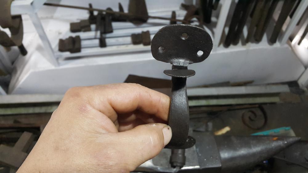

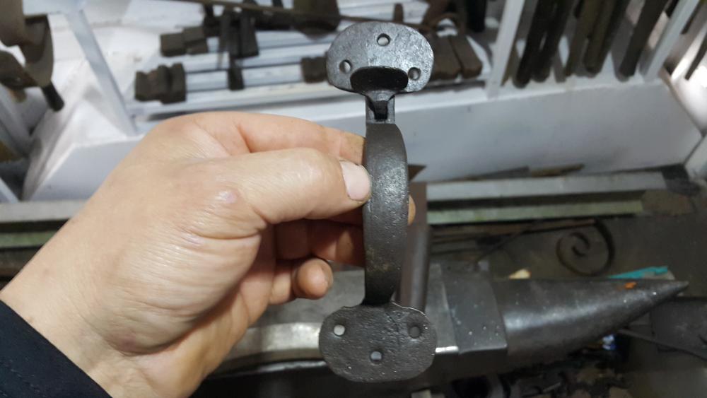

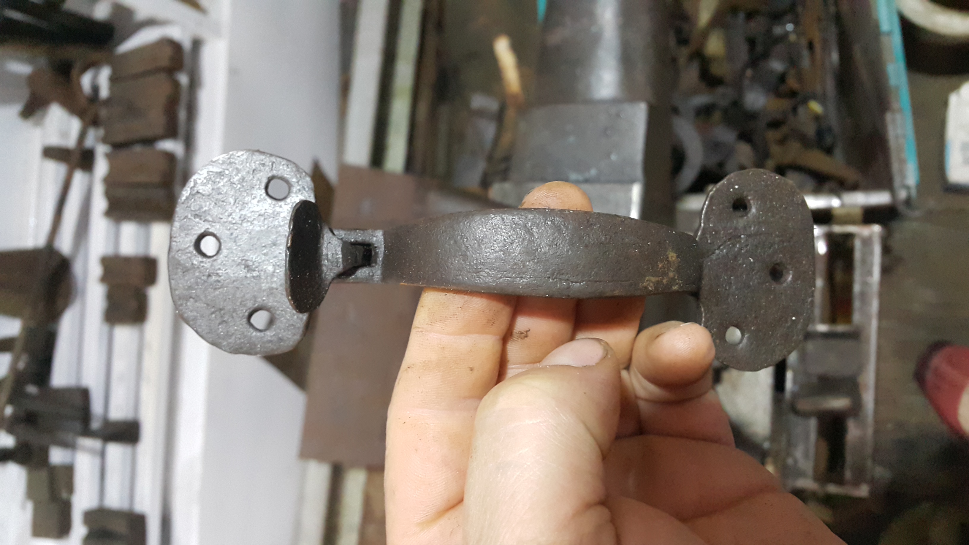

jlpservicesinc Posted September 7, 2016 Share Posted September 7, 2016 Suffolk latch.. 2 wrought iron bolts welded together.. Quote Link to comment Share on other sites More sharing options...
aessinus Posted September 8, 2016 Share Posted September 8, 2016 On 7/29/2016 at 11:33 AM, Donniev said: I've got 4 of these big bolts, been wondering what I could make out of em. Using a 7/8" one for a vise hinge, with RR plate for the hinge cheeks... Quote Link to comment Share on other sites More sharing options...
ausfire Posted September 8, 2016 Author Share Posted September 8, 2016 Great work with the latch, jlp. You would never know it came from two bolts. Neat idea. Quote Link to comment Share on other sites More sharing options...
