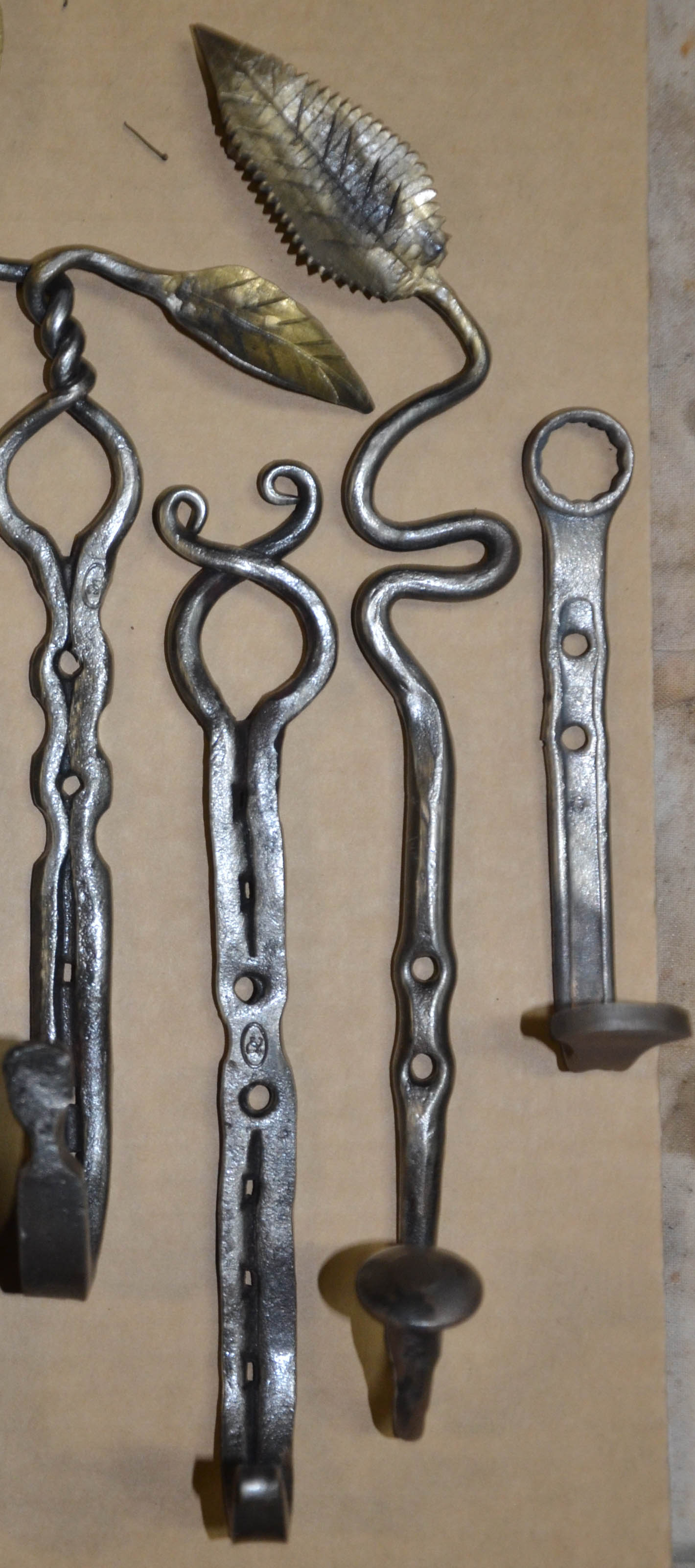

ausfire Posted January 7, 2016 Share Posted January 7, 2016 OK, we've all got heaps of old bolts around the place. So what to do with them?? They make nice leaf hooks, and if you are careful you can use the threads to form serrations on the leaf. The leaf hook on the right (made from a 3/8 cuphead bolt) in this pic is done like that. Show us your ideas! Quote Link to comment Share on other sites More sharing options...
Daswulf Posted January 7, 2016 Share Posted January 7, 2016 Wow Ausfire, you are on it! Nice work on everything pictured. I'll have to try some ideas and get them on here. Can't say I utilized the bolt head in them but I have used bolts to make nails. Thinking back on that .... Using a bolt to make a nail is a little reversal on technology. Quote Link to comment Share on other sites More sharing options...
ausfire Posted January 7, 2016 Author Share Posted January 7, 2016 Thanks Das. I made a whole panel of hooks that were made from different common objects - horseshoes, spanners, tools, and yes, bolts. The tourists like to guess what they were before they became wall hooks. I'm thinking a double hook might be an idea. Two bolts twisted together perhaps. Quote Link to comment Share on other sites More sharing options...

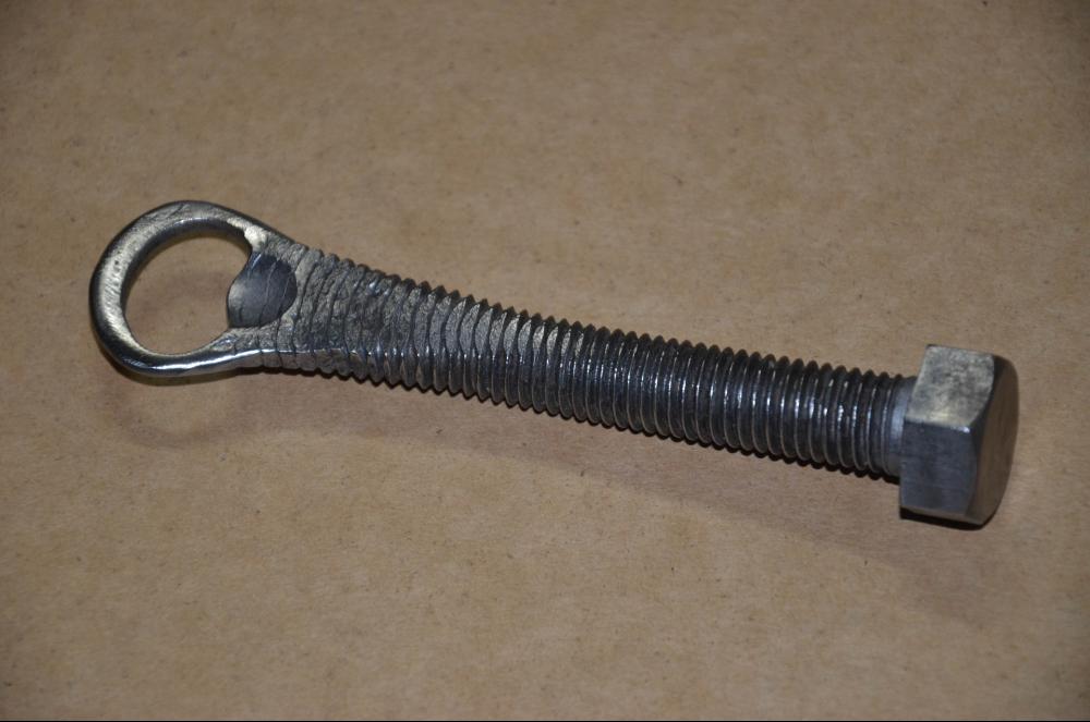

ausfire Posted January 10, 2016 Author Share Posted January 10, 2016 Well here's a bolt bottle opener. Not too spectacular but simple enough. Has a good grip with the threads. Comfortable in the hand too. 5/8" full thread bolt. Quote Link to comment Share on other sites More sharing options...

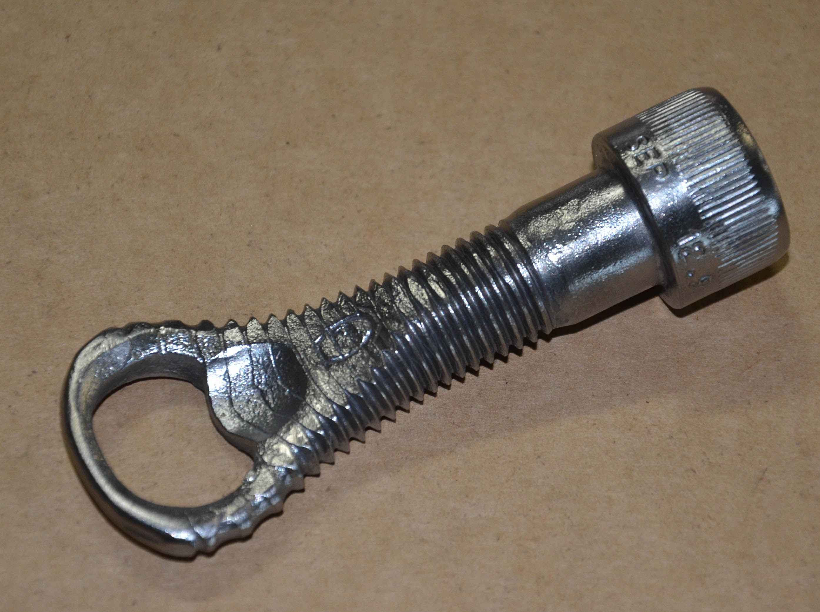

ausfire Posted January 12, 2016 Author Share Posted January 12, 2016 OK, here's another bolt. This is a 5/8 cap bolt. Don't know what grade of steel it is but it was hard. It is stamped SEP and the numbers 12 - 9 which I guess is date of manufacture Sept 2012?? Quote Link to comment Share on other sites More sharing options...
BIGGUNDOCTOR Posted January 12, 2016 Share Posted January 12, 2016 12.9 is the grade of bolt, 176,900 psi tensile strength. SEP is the manufacturer. Quote Link to comment Share on other sites More sharing options...
ausfire Posted January 12, 2016 Author Share Posted January 12, 2016 Ah, thanks. I assumed wrongly. It was certainly hard metal. Is SEP an American manufacturer? Quote Link to comment Share on other sites More sharing options...

bigfootnampa Posted January 20, 2016 Share Posted January 20, 2016 Ausfire; That type bolt is almost always pretty high strength steel. They are mostly used for machine and tool assembly and are usually made in some of the highest grades of steel available. Just for general info. They are also commonly sold with blued steel finishes, so safer for forging than galvanized bolts! Too expensive to buy new for forging stock... but good stuff to look for at the scrappers! Quote Link to comment Share on other sites More sharing options...
ausfire Posted January 20, 2016 Author Share Posted January 20, 2016 Yes, I googled SEP, as stamped on the cap bolt, and it said they make high strength steel bolts for various technical applications, including 'explosive(?) bolts', whatever they are. I like the blued steel finish .. much better than playing with gal or cad plated bolts. A guy dropped in a bucket load of them the other day so I have a few to mess with. Quote Link to comment Share on other sites More sharing options...
