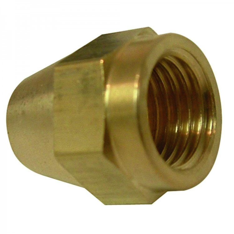

1. Is 1/4" SAE flare fitting designated that size by the I.D. of the copper pipe/tube that goes into it? This was my understanding but I want to confirm this to get the right fittings for copper pipe/tube that I have).
 and
2. If I have the above correct, what is the thread size on a 1/4" SAE flare fitting? Is it 7/16" - 14? or 7/16" - 20? or something totally different? I have to confirm this so I can hunt down the right size tap to tap the back of my T burner to take one end of a 1/4" SAE flare double union which will then be tapped to hold the mig tip (as per Frosty's recommendation about 3 pages back).
All help greatly appreciated.
Cheers,
Jono.
I used these which was designated by 1/4” OD tubing.
I’m not understanding your second question.  The MiG tips I used was 1/4-20 which you tap on the inside of the 1/8” NPT side of the 1/8” NPT x 1/4” flare fitting with 1/4” side going to gas.   The top of the 3/4x1x3/4 T gets drilled and tapped  1/8” NPT which is bigger than you would expect because it’s Pipe so that’s ID.
hardest part was sourcing 1/4” flare to 3/8” flare to attach to my gas.  Couldn’t find the fitting at Home Depot or my local propane supplier.  I found a solution at Lowe’s where I went 1/4” flare to 1/4” NPT, 1/4” NPT tp 3/8” NPT, 3/8” NPT to 3/8” flare.
hopefully this helps and I didn’t misunderstand or confuse you worse.

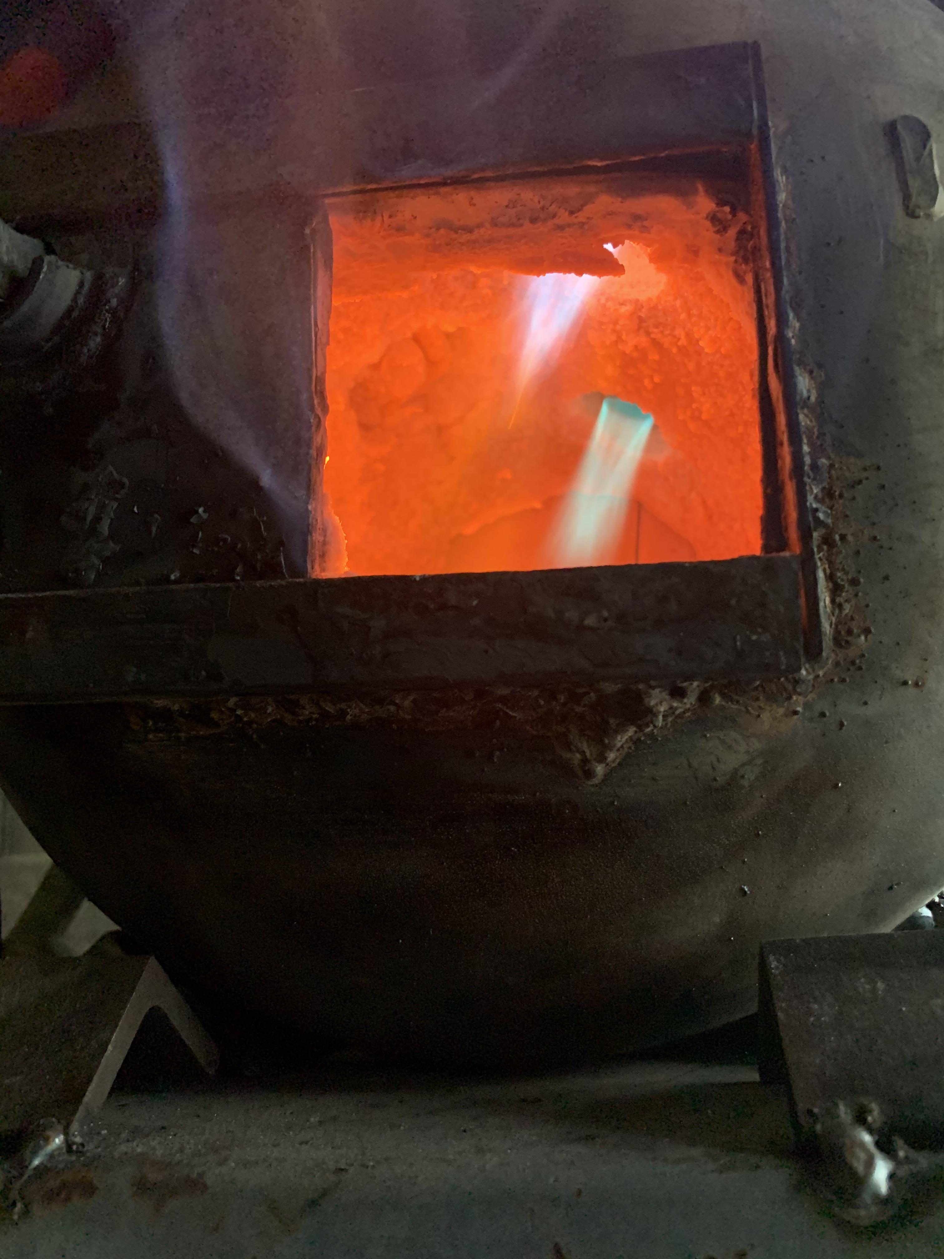

Chris: As  G-son says, multiple burners won't cause a pressure drop in the propane until you exceed the volume capacity of the regulator. My too large shop forge runs up to four 3/4" T burners at once without problem. My regulator is at least 35 yrs old, 0-20psi adjustable. More recently 0-30 psi are the norm.
If you have questions building T burners give me a shout.
As a last note, the burner in the above pics above is burning rich, back off the gas a little it should get much hotter. However if the liner is freshly made from a high alumina hard refractory SOME of the orange "dragon's breath" is the refractory's calcite binder oxidizing. However the amount of dragon's breath and "feathery" nature says to me there is fuel burning OUTSIDE the forge doing you no good. Ease off the psi a little at a time, it should get much hotter.
To add my vote for the Frosty viewpoint; that forge COULD NOT get anywhere near that heat with such a reducing flame, if it's burner design weren't already exceptional. Change the the bath water, and keep the baby :D

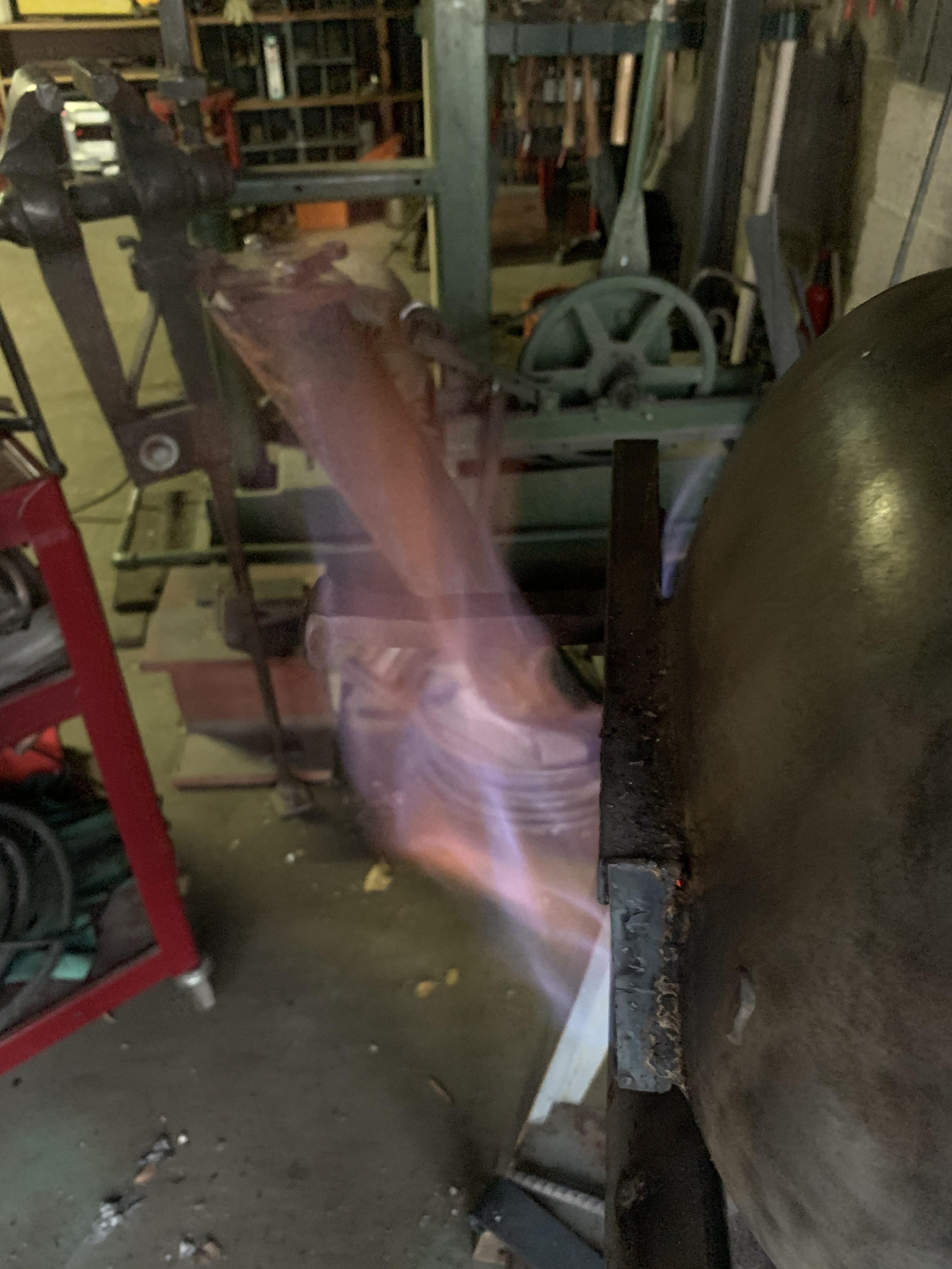

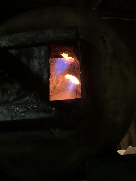

Ok I have video this time. I fired it upFor the first time and this is what I got. I’m using .030 tips instead of .025 which of what was recommended because of my altitude but I’m thinking more like.035 like the original plans say. I cut my nipples down to 6” instead of 8”. Pretty much everything is at original plans specs.
16 minutes ago, Irondragon Forge & Clay said:
Your video's don't play for me, got sound but no picture.
I Know , gimme a bit to figure this computer thing out and I;ll re-send everything.
Are you trying to demonstrate something? Does it require video?  Can you describe it or take a picture?  Pictures require less bandwidth and can show flames well.
Any reason for cutting the mix tube shorter than the plans?  Two inches of mix tube can change performance quite a bit.
I didn’t change the length of the length of the mix tubes to a different length than from the plans I actually cut them down to the length in the plans. 8” to 6”. I’ll send some pics. Basically one of the flare tubes that go into T and receive the mig  tips is stripped out. So it not being tight is messing things up. That particular burner is burning way too rich. I switched back out to a.025 and it was worse that with .030. I’m thinking I should try a.035 trimmed down tomorrow after I get a new T and flare. I’m hoping the actual T is not stripped out but I think I threaded it too deep and it made the whole too big since the tap is tapered.

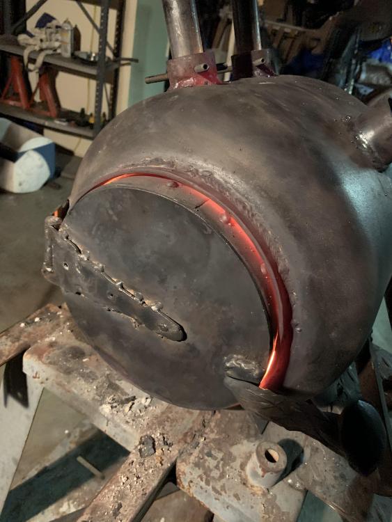

OK I have a feeling that my Forge is losing way too much heat and that’s why I cannot get up to welding temperature because my forge will not hold in heat. Also I finally got my Venturi burners working and I think their tune pretty OK. Again I still wish I had somebody here that can help me in person but it is what it is. I am using .025 tips cut down about 1/16” so that the Meg tip is about halfway through the T. Whenever I run it on about 8 to 10 psi flames shoot up through the holes that the nipples are in but they’re not going up into the tease at least. They are trying to sputter every great once in a while though. I am still thinking about usingWhenever I run it on about 8 to 10 psi flames shoot up to the holes that the nipples are in but they’re not going up into the tease at least. They are trying to sputter every great once in a while though. I am still thinking about using trying the .030 tips just to see. Monday I will be going to the blacksmith Monday I will be going to the blacksmith  and farrier shop to get Either more wall either more kao wool or some bricks or both. I’m thinking about squaring off the inside of the forge. Anyways, more to come and more to forge.
