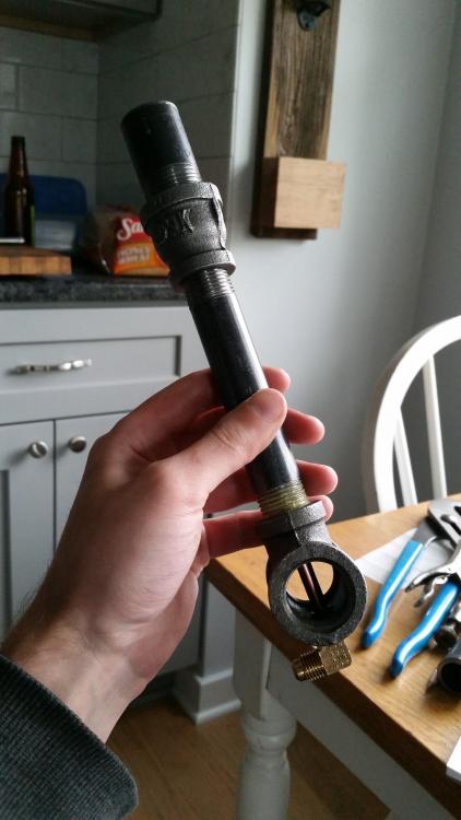

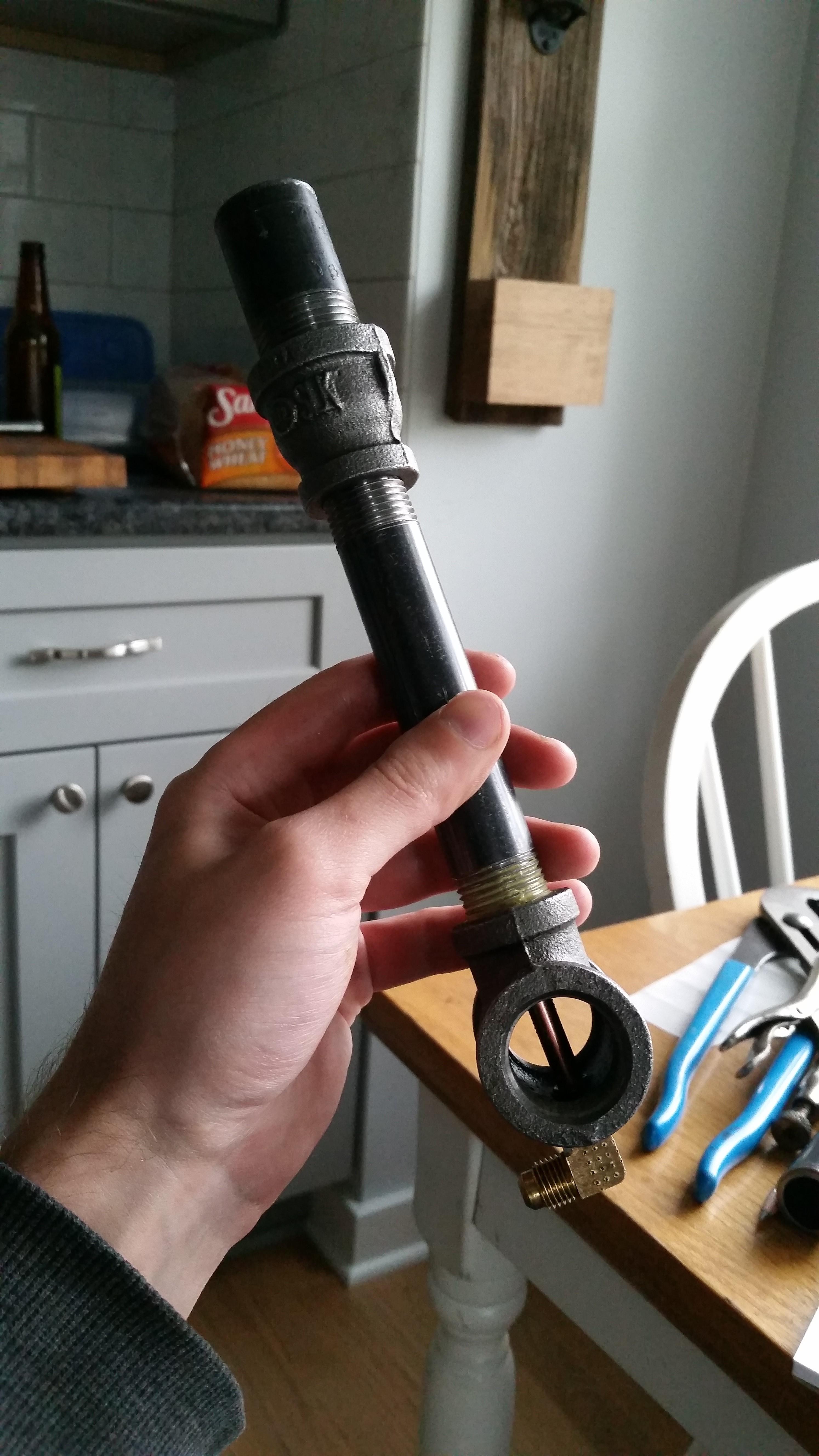

nconoan Posted April 29, 2019 Share Posted April 29, 2019 Hello All! My name is Nick from Omaha, NE. I've been working on designing a forge for a few months now. Initially I intended to just buy a commercial burner or perhaps a modified side-arm burner from Zoller Forge, but then I stumbled across Frosty's design and was surprised by how straight forward it was and how clear and easy to follow the instructions were (I suppose we have Spanky to thank for that!). It gave me the confidence to go ahead and try and make one for myself, so here is my take on a 1/2 inch T-burner. Feel free to tell me the flare is absurd, I spent a long time on here last night reading, trying to decide if I even needed one , and how I'd go about attaching one without welding equipment. So that's what I came up with, probably way too long, but it should have the 1:12 ratio. Great thing is, if it sucks, just unscrew it. I just wanted to thank everyone on here for all of the discussions and wisdom, there is a ridiculous amount of information here and I can't wait to start putting it to use! Maybe I will start a thread about the forge build. -Cheers! Quote Link to comment Share on other sites More sharing options...
Frosty Posted April 29, 2019 Author Share Posted April 29, 2019 Welcome aboard Nick, glad to have you. It should work a lot better if you lose the nipple after the bell reducer. The mixing tube looks long too, it SI more than 4". Yes? Tsk tsk. By the look it should probably run rich as is but that's just a tuning detail. 8 minutes ago, nconoan said: there is a ridiculous amount of information here There's a significant amount of ridiculous information here too. Not that I'm a perpetrator thereof. Frosty The Lucky. Quote Link to comment Share on other sites More sharing options...
nconoan Posted April 29, 2019 Share Posted April 29, 2019 Easy enough fix, will do. I know earlier either in this thread or burners 101 you (or maybe Mike) mentioned that bell reducers make poor flares due to excessive turbulence, so should I just lose the whole flare altogether? Originally I was going to, (you mention you run yours without) but then saw Mike's post about the importance of flame control....perhaps a difference of opinions here? Hahaha, impressive eye (it's like you've built a few of these or something ) Yeah, I went with a 5," was trying to err on on the long side, but at 10*D I might have gone too far. I think I can find 4" at the hardware store. Quote Link to comment Share on other sites More sharing options...
Frosty Posted April 29, 2019 Author Share Posted April 29, 2019 I was probably more outspoken about bell reducers being poor flares but in the face of so many burners running beautifully using bell reducers as flares I shut up about dis-proven . . . "knowledge". Yes, I use thread protectors instead of a "flare" I get them by the bucket from the local plumbing shop for free. It costs more to scrap them than they're worth. Thread protectors only LOOK like couplers, they're screwed onto the ends of lengths of pipe to protect the threads in transit. They make nice "flarelike thingies" but in truth I use them as mounts, I weld them to flanges or forge shells or the plenum on multiple outlet burners. I tune the burner to not need a flare so they don't. Mike and I tune our burners differently, he fine tunes his be moving the flare in or out, I trim the jet farther back from the throat of the mixing tube to draw more combustion air. His can be adjusted as necessary. Mine gets tuned and that's it they don't even have chokes. In either case we control the flames, it's not a difference of opinion we work with different machines with different methods. Both work to our standards. Mike aimed to make as effective a burner as reasonably possible. I aimed to make an effective burner that required the minimum shop tools or shop skills. Mikes burners are hotter and with a more neutral flame. Mine takes a drill press, tap set and about 15-20 minutes to build start to final tune. Glad I reread your post. Another tip that makes building these things much easier. Buy plumbing at a plumbing or HVAC supply NOT a big box or hardware store. Frosty The Lucky. Quote Link to comment Share on other sites More sharing options...

nconoan Posted May 3, 2019 Share Posted May 3, 2019 Lit it up last night, with a different mig tip than the one shown and with the other changes you suggested, Frosty! It is running extremely rich in open air (green hue at the end of the primary flame) So I will start cutting the tip back. Time to order ceramic blanket and refractory/kiln wash! Quote Link to comment Share on other sites More sharing options...
Frosty Posted May 3, 2019 Author Share Posted May 3, 2019 38 minutes ago, nconoan said: (green hue at the end of the primary flame) So I will start cutting the tip back. That's RICH alright! If you have a couple mig tips so you can replace mistakes I'd make the first cut just under 1/2 way back as seen through the intake ports. Final tuning should be in really small increments, 1/16" is a BIG trim. Oh, I highly recommend you tune it IN THE FORGE. Frosty The Lucky. Quote Link to comment Share on other sites More sharing options...

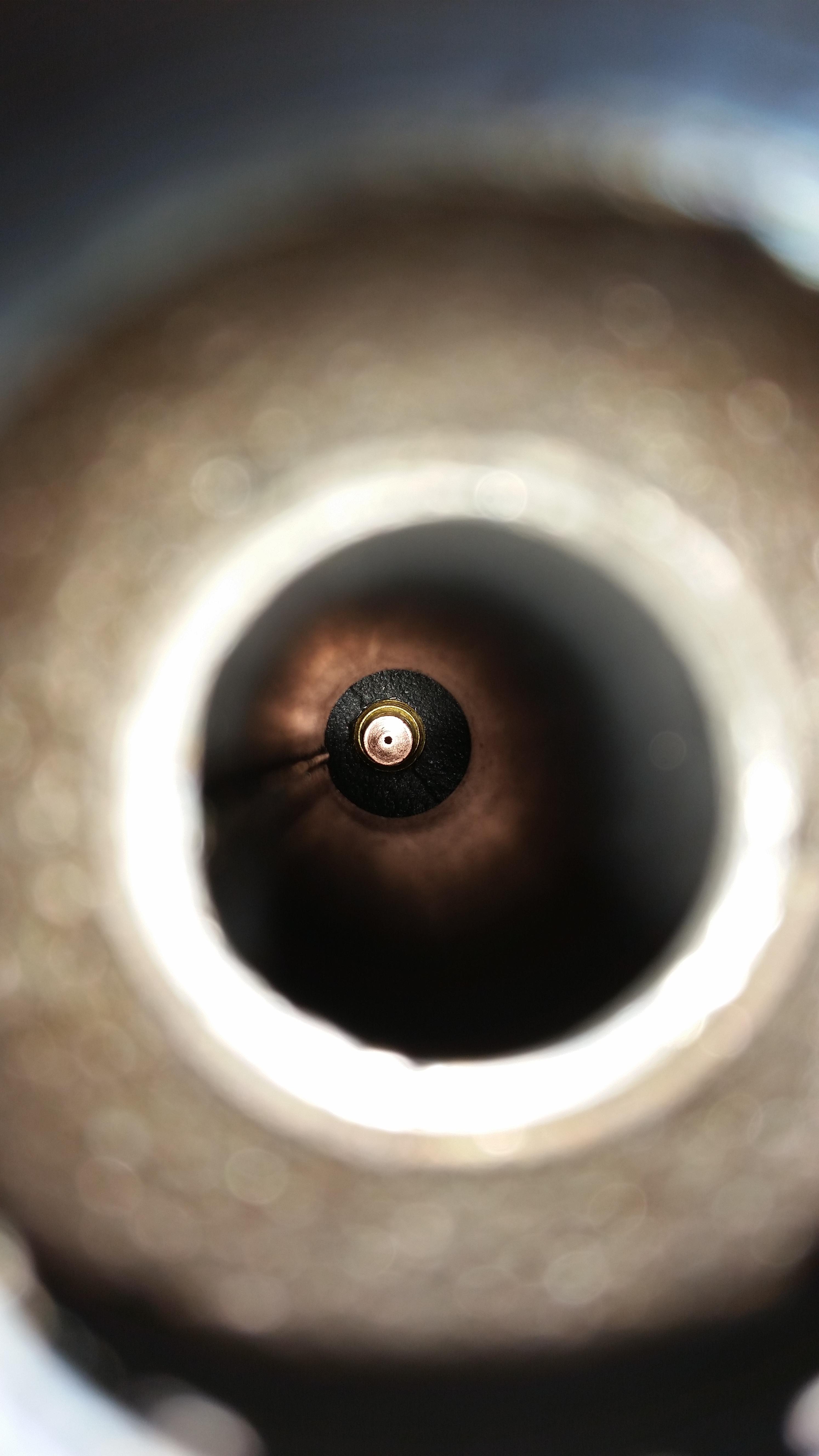

nconoan Posted May 10, 2019 Share Posted May 10, 2019 Yes, this is an excellent point! I believe I did exactly that on the first jet, which would explain why it ran just about as rich (still green tipped) after being trimmed. I have cut another one down, being much more careful this time. I should be able to fire it up tonight. My hole in the T fitting also isn't very well aligned (see below) so I am wondering if that also is causing poor induction. If the tip I just cut down doesn't lean it out then I will go back to square one and get a better alignment. Quote Link to comment Share on other sites More sharing options...
Frosty Posted May 11, 2019 Author Share Posted May 11, 2019 Being that far out of alignment will hurt induction as well. However you MIGHT be able to bend it straight GENTLY with flat screw driver. Be careful, the threaded section will break off if you push too hard. It also makes it problematical if you have to trim it again as it won't screw in as easily nor as straight. Frosty The Lucky. Quote Link to comment Share on other sites More sharing options...
