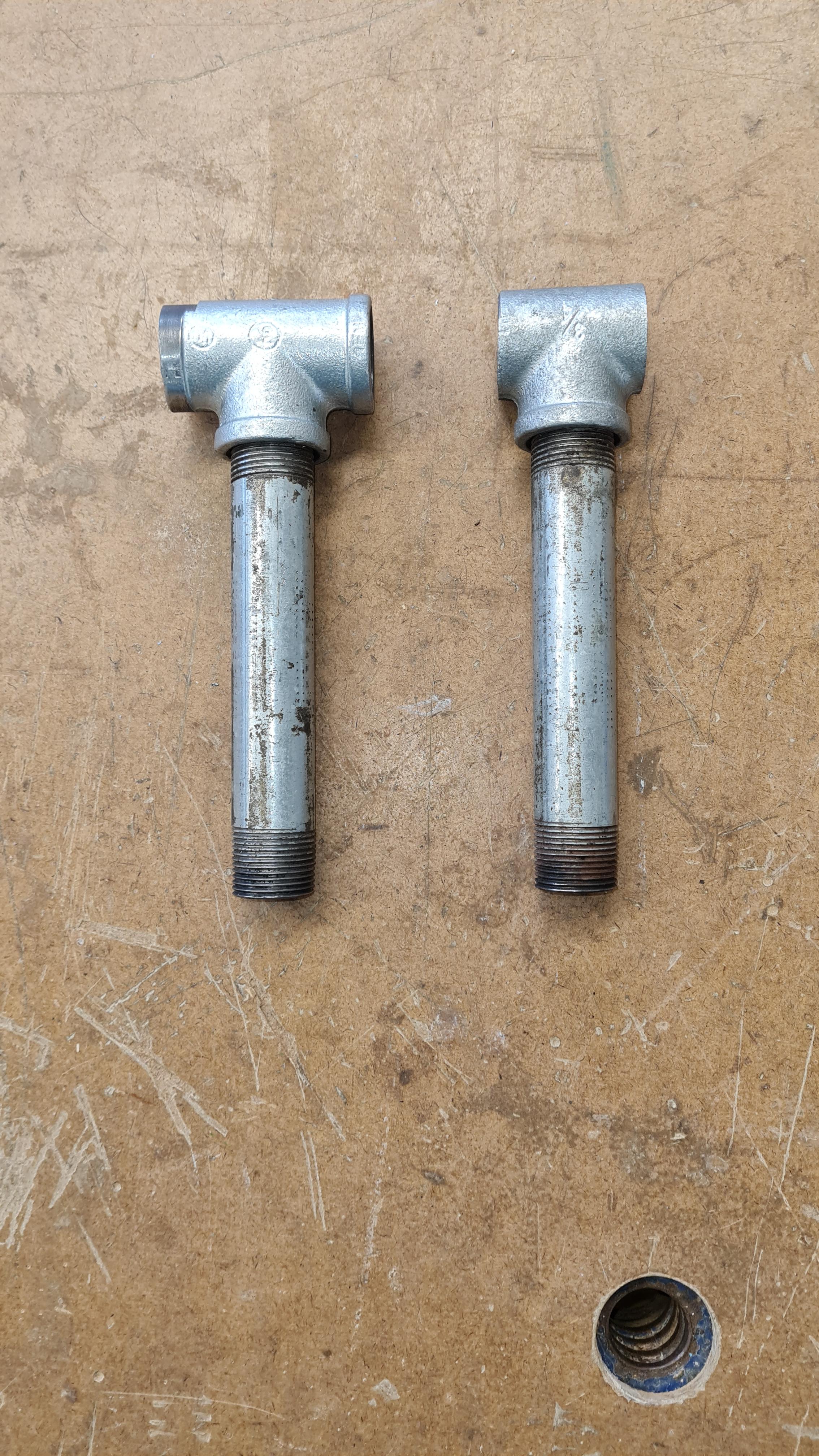

Hefty Posted August 12, 2021 Share Posted August 12, 2021 As Holmes said to Watson at dinner time: "Rats! Foiled again!" Frosty, you were right about alignment but I think the pictures were a bit misleading. It's not so much that everything is on an angle to the tube (Well, maybe that too with the original MIG tip) but actually that the hole for the brass fitting about 1/8" or so to one side of the centre of the mix tube! ON BOTH TEES!! Foolish me, way back when I drilled the Tees in the lathe, didn't think about the fact that as a cast part, the centres of the machined holes don't necessarily correspond to the centre of the outside of the casting Oh well, I'll have to order some more and get really impatient waiting for them to ship. Still, thanks again everyone for the replies. I've still learned heaps that will get me started quickly when they arrive! Cheers, Jono. Quote Link to comment Share on other sites More sharing options...

Another FrankenBurner Posted August 12, 2021 Share Posted August 12, 2021 That is a bummer hefty. As you said though, you learned heaps. Knowing more about your burners will make future troubleshooting easier. When I made some Frosty T's with the lathe, I threaded the tee onto the mix tube and centered the mix tube. So long as the mix tube is concentric, the hole will be drilled In the tee, centered on the mix tube, no matter how far out the tee is. Plus there is no measuring to determine where mix tube center happens to land on the tee. If I am remembering correctly, Frosty suggested it to me. It almost takes the work out of it. Nice dig Tink. Interesting find. Over thinking Teflon tape... we can be friends. Quote Link to comment Share on other sites More sharing options...
Frosty Posted August 13, 2021 Author Share Posted August 13, 2021 Good info Tink, I've been under the impression it was a chemical problem, not mechanical. Thanks! Chucking up a nipple and screwing on the T centers everything. I tried chucking the T itself one time and couldn't get it to run true. What was a real head slapper for me was when I was trying to come up with a way to keep the T centered on a drill press without an expensive drill vise and fussy set up. I was standing there lamenting not using my lathe and the ease of mounting it on a nipple to drill and tap. I spent a lot of time trying to make an effective propane burner a person could make with minimal shop skills and tools. Otherwise I'd use the lathe. Anyway, I'm standing there coming up with all sorts of ideas to jig the T on the drill table and look over at my shop forge with 4 T burners standing on floor flanges. Talk about a head slapping DUH moment! I jumped in the car, drove to the plumbing supply at the end of our road and was home with a 3/4" floor flange in under 15 minutes. That was the last real improvement to the T burner. Frosty The Lucky. Quote Link to comment Share on other sites More sharing options...

Hefty Posted August 13, 2021 Share Posted August 13, 2021 Frosty, I'm reading through the burners 101 thread and I saw that early on you tried turning the threads out of the tees but the only practical advantage was the enlarged air intakes. Because I'm impatient and because our big box stores have equal tees but not reducing tees, I'm considering doing this to save shipping time and money on a reducing tee. But, before rush into it, I wanted to check if the centering of the two intakes is mission critical, knowing the issues I've already had with castings not being true. I could thread one side onto a nipple to centre it but I would literally be turning the threads off that would hold the other side in order to do the same. Another thought has also come to me but it may be too dodgy: Could I JB weld my off-centre holes shut and then re-drill and re-tap? It would end up with mostly metal in the new holes with a section of JB weld down one side. Cheers, Jono. Quote Link to comment Share on other sites More sharing options...
Frosty Posted August 13, 2021 Author Share Posted August 13, 2021 The intake ports aren't critical, they don't have to be the same size or aligned, within reason that is. The really critical thing is the gas jet alignment. Don't you guys have down under have plumbing supply stores? We have big box stores and hardware stores not to far off but regular plumbing and HVAC supplies are more common. Not being critical, we live on opposite sides of the planet after all, I'm curious. Frosty The Lucky. Quote Link to comment Share on other sites More sharing options...

Hefty Posted August 18, 2021 Share Posted August 18, 2021 Ok, so once I found time to phone around, I confirmed that even most plumbing supply places around here don't carry much in the way of iron pipe fittings and none of the ones I contacted had reducer tees. I got some 3/4" equal tees and turned out the threads on the air intakes. One turned out ok, the other one was bored so off centre from its casting that I broke through the section where I had to true up the outside to the same centre as the nipple I had it on so I could hold the second side in the lathe chuck!! I've had to cut off the broken section and the other side to match. Will this still work? It still has a little bit of iron with the right sized holes in the perpendicular alignment before the her and mix tube, but not much It funny/sad: I consider myself reasonably handy but, Frosty, you designed this to be fairly easy to construct and I'm still messing things up! Actually, IF the shorter intakes on the tee end up working, in future I might just cut the thread section off without any further turning. They actually get bigger inside after the threads! Quote Link to comment Share on other sites More sharing options...
Frosty Posted August 18, 2021 Author Share Posted August 18, 2021 Why are you turning the outside? If you use the live center to hold it in position while you tighten the chuck it'll turn true enough IF you take light cuts. Don't make it pretty! Just clean out the threads a couple thou. at a pass. That's how I chuck them up and it works well enough. The air intake ports don't need to be close to precise, they don't have to be more than close to the same diameter. I cleaned the threads out to see if it improved performance but I don't think it did. Not enough to make it part of the build, even as a suggestion. If you want to make a T burner using a 3/4" x 3/4" T use a smaller jet (mig tip) and be prepared to trim it farther back from the throat. My first working T was 1" x 1" T on 1" mixing tube. The first couple 3/4" were 3/4" x 3/4" Ts. They all work a treat. IIRC a 0.030 mig tip worked in the straight 3/4" T. Don't quote me though that was more than 20 years and a TBI ago. I started using the reducing Ts because I was going for maximum effect. The limiting factor with home made burners is inducing enough air to make a neutral flame. The more air you can induce the more propane you can introduce to make the neutral flame. The larger the intake air you can supply with propane the more combustible mixture goes into the forge per second so the forge gets hotter. The other side of that coin is the slower the combustible mix is moving so the longer it stays in the forge shedding energy to the liner. (Hang time) I found the increase in intake vs. mixing tube ratio hits a point of diminishing returns at 1" x 3/4". It gets hard to get a greater ratio to perform and it doesn't perform enough better to be worth the hassle. That's just me though, I prefer not to fix things that aren't broken. Unless they need to be broken that is. Keep at it, we'll get you a screaming HOT forge. Frosty The Lucky. Quote Link to comment Share on other sites More sharing options...
Hefty Posted August 18, 2021 Share Posted August 18, 2021 Yeah, I had to use the conical outer section of a tail stock drill chuck to centre them because I didn't have a big enough live centre, and I only figured out I could do that after I messed up the first one. I seem to keep finding helpful info just after it would be helpful. I had read some of your info on intake to mix tube diameter ratios for inducing more air but missed the fact that I could run 3/4" equal tees unmodified with a smaller mig tip. Oh well, I'll know for next time. Anyways, I managed a reasonably stable flame on the tee I didn't have to cut down and I got a video. This is untuned with a full length mig tip. You can see it sputtering slightly at lower pressure at the start, then it settles into a stable flame when I bring the pressure up a bit but then I turned the pressure up too high at the end and it blew out off the nozzle. I'm very new to reading burner flames but I'm presuming from the second layer of blue and orange flame (and the fact that I haven't trimmed the mig tip yet) means that this is a fuel rich flame, yes? First Tee Burner Flame - Untuned Also, how do others light their burners? I don't mean that to sound like a dumb question but I'm using a little butane can torch to light the FAM as it exits the mix tube and I really have to play with the regulator carefully to get it to light without blowing the flame off the end of the mix tube. Is this something that will be less of a problem when it's mounted in, and tuned for, a forge? Cheers, Jono. Quote Link to comment Share on other sites More sharing options...

Trees Posted August 20, 2021 Share Posted August 20, 2021 I'm having a xxxx of a time trying to get the hole for the brass fitting tapped straight... I tried tapping 4 tees, on only one of them the fitting looks straight enough to try to put together, and even on that one, when I put it back on the nipple & flange to chase for tapping for the MIG tip, the centre of the brass fitting is off-centred from the drill bit. I'm off tomorrow to pick up a new batch of tees to try again, and maybe a new flange & nipples (in case those were compounding the error)... My guess is that even though I am being really careful to lightly peck the drill bit to start it (after filing a flat on top of the tee), that it is still deflecting some amount that I can't see and drilling off-centre. Both flange and nipple still seem to be very close to centre after removing the tee, certainly not off enough to get these results... Just wanted to throw this out there before trying again in case anyone has any extra tips, or sees anything obvious with my setup. Quote Link to comment Share on other sites More sharing options...
ThomasPowers Posted August 20, 2021 Share Posted August 20, 2021 Shorter nipple? Any angle the nipple tapping may be off is just exacerbated by extra length. Quote Link to comment Share on other sites More sharing options...
Goods Posted August 20, 2021 Share Posted August 20, 2021 Is the table on you drill press perfectly square to the drill? Is the threaded hole always off the same direction and amount? If it is, you may be able the shim you setup to fix the issue. David Quote Link to comment Share on other sites More sharing options...
Frosty Posted August 20, 2021 Author Share Posted August 20, 2021 Use a close nipple, as close as you can find. I use a 3/4" x 1" close nipple, the threads almost connect in the center. Clamp the flange directly to the table, wood warps with humidity changes. Nothing is going to pass far enough through the T to touch the table so you do not need clearance. Swing the table to one side so you can clamp the flange over the edge of the table. Check to see if the table is square to the spindle with a square. Chuck a longish drill bit in the chuck and check in different positions around it with the square. Keep everything as close as possible, short nipple, table as close to the chuck as leaves clearance to change drill bits and taps. When you put the T in the jig do NOT remove it until you are finished with the burner. PERIOD. You can drill and tap the fitting for the mig tip while it's screwed into the T, heck it's almost a MUST to align it without using instrumentation. Frosty The Lucky. Quote Link to comment Share on other sites More sharing options...
