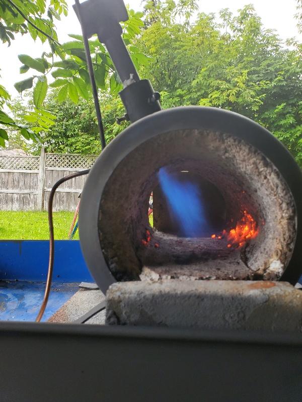

Keeley S. Posted July 11, 2020 Share Posted July 11, 2020 (edited) Hey all, Long time lurker, first time poster. I have a freon bottle forge w/ 2" ceramic blanket that's rigidized, coated with HW Kalakast AR adtech high alumina refractory with a removable "shelf" casted from the same refractory. I haven't coated with an IR wash yet but that's in the plan. Anyways, I am running a 3/4" T-burner as spec'd in Frosty's directions. I am getting a good flame (I think), I can get a pic tonight if needed. I am running it outdoors about 30 metres (98') above sea level. When I first fire it up, the flame seems quite unstable and sputters and occasionally goes out until the forge is up to temp. Also, it's happy place seems to be around 12psi. Could this be a sign of poor air induction and just needs the mig tip (0.035) trimmed, or am I way off base? Thanks for any assistance, and sorry if I am rambling Edit: just went and checked, my burner was about 3/8" from the inner wall, so I put it about 1" into the insulation, it must've slipped at some point. I didn't test yet to see if it helped. Cheers, Keeley or Sully, whatever's easiest Edited July 11, 2020 by K. Sullivan Missed some info Quote Link to comment Share on other sites More sharing options...
Frosty Posted July 11, 2020 Author Share Posted July 11, 2020 Welcome aboard Keeley, glad to have you. Some still pics in dim light will help us evaluate what's going on. One in the door when you first light it so we can see the flame as it enters the forge and another from the side so we can see the exhaust coming out the doorway. Then another couple pics from the same angles after it's heated up. T burners are susceptible to breezes outdoors, especially before the forge comes to working heat to keep them lit. If it smooths out after it warms up it's probably not a big issue. Pull the burner back out of the liner, you only want it just into the ceramic blanket, 1/2" is usually more than deep enough. It's not an exact thing but don't go very deep or the burner will tend to get a lot hotter than is good. A hot burner tends to pre-ignite and burn in the burner instead of in the forge. Frosty The Lucky. Quote Link to comment Share on other sites More sharing options...
Keeley S. Posted July 12, 2020 Share Posted July 12, 2020 Hi Frosty, Thank you so much for your reply, it was a big help. I moved the burner outlet as recommended, it's about 1/2"-ish into the blanket. I don't know if it was due to that adjustment or if it was because today was relatively breeze free at my place for a change but it started up with only a small sputter that lasted 3-4 seconds then no issues after that. I took a short video of the flame just after flashup https://youtu.be/pwdgGqOQlo4 . Also, here are some pictures of my setup(1st pic), flame on startup(2nd & 3rd), flame after heat up(4th & 5th), and as best a picture that I can get at present of the dragon's breath(6th): Quote Link to comment Share on other sites More sharing options...
Keeley S. Posted July 12, 2020 Share Posted July 12, 2020 So after running it this evening I discovered that I rushed by taking them earlier in the day(even though it was dark-ish), way more detail in the dark. Video: https://youtu.be/A1ufvkVw070 after startup exhaust after start After heat up Exhaust after heat up Quote Link to comment Share on other sites More sharing options...
Frosty Posted July 12, 2020 Author Share Posted July 12, 2020 Looks pretty good from here. A sill will help contain the fire in the chamber longer. By sill I mean a low barrier across the opening, say 1" - 1 1/2" high. As is the flame impinges the floor and a good portion flows straight out the opening at floor level. A sill deflects part upwards into the swirl the burner angle initiates. The opening can be much smaller, until it begins to effect the burner flame. Nice cart, it's a lot like mine. Have you used it, how does it heat steel for you? Frosty The Lucky. Quote Link to comment Share on other sites More sharing options...
Keeley S. Posted July 12, 2020 Share Posted July 12, 2020 I can always cast a sill to both ends of the removable floor. I was actually thinking today that I should figure out some sort of door for the front and back outside of a brick propped up against the opening, the ground isn't the most level so the brick can get a bit tippy. The forge works great, I have gotten my wrought iron to forging temp, I could probably get it to welding heat, just haven't had anything to weld yet. I took a chance on the Kalakast for the castable and it seems to do pretty good so far, it gets to forging heat in about 5 minutes. I also put some borax on the floor to test and it didn't touch the castable. The cart has worked really well so far, I have my piping run through it, and gauge/ball valve mounted to the opposite side of the forge so I can get to the valve quick if needed. The burner runs great, and easy to build. Thanks for the detailed instructions, it made life so much easier. I come from a technical background but my brain isn't what it once was, and I can't wrap my head around some directions that are out there, so something clear and concise is a life saver. Cheers Quote Link to comment Share on other sites More sharing options...
Frosty Posted July 12, 2020 Author Share Posted July 12, 2020 5 mins to working temp sounds good to me. You don't need a "reason" to weld beyond giving it a try. Make a fireplace poker with a welded point maybe, they make nice gifts. I wouldn't bond the sill to the floor until you know if it improves performance enough to be worth it. I just cut a K-26 Insulating Fire Brick. (IFB) What I like for a forge porch is a simple bracket that supports a split 3,000f hard fire brick level with the opening. The porch doesn't care how hot or what gets put on it and provides a good place for door baffles. My current NARB forge works nicely with a couple hard fire bricks laid in front of the opening with a split brick laid in the integral porch (that turned out badly). the split brick on the porch increases the height of the sill and makes the stand for the baffles. That forge is a prototype and needs to be rebuilt but it proved the NARB and works okay. I'm afraid I've never built a forge I was actually HAPPY with, every darn one has flaws. <sigh> Frosty The Lucky. Quote Link to comment Share on other sites More sharing options...
