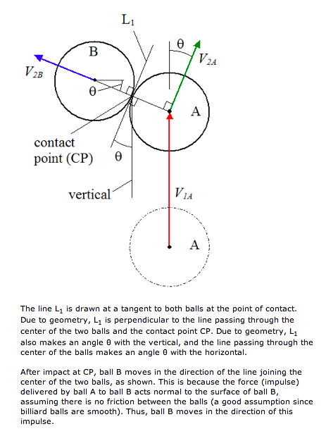

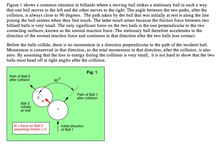

It would be the crown face of the punch rather than the hammer which would direct the energy into the centre axis of the tool.
Perhaps, ... but a fellow Countryman of yours had a somewhat different opinion .....
"The relationship between an object's mass m, its acceleration a, and the applied force F is F = ma. Acceleration and force are vectors (as indicated by their symbols being displayed in slant bold font); ... in this law the direction of the force vector is the same as the direction of the acceleration vector.
Therefore, ... my understanding of Newton's 2nd Law of Motion, leads me to believe the Hammer and Punch have an equal influence in directing the force of the blow.
Since the original post was a question about the shape of the Hammer Face, ... the response deals primarily with that issue.
Well I admit my conclusions are based on empirical observation rather than theory, but I think they conform to Sir Isaac's law.
My understanding of the law you quote is that it refers to the direction of movement of the hammer head itself, and not a line perpendicular to the hammer face crown, which is what you appear to be saying.
The crown of the punch or chisel head as a section of sphere centred on the working end as far as I can understand is what is directing the energy there. The shape of the hammer face has little beneficial influence on this, and in my experience is better flat than rounded from the point of view of glancing blows.
Given that the angle of incidence we are talking about between a hammer and a long and thin hand held punch or chisel is pretty negligible the effects either way are also fairly slight.
However slight, the principal of my crowned head system was arrived at initially from using flat and wide faced chasing hammers with crowned topped commercially made punches via the use of "dee" shaped fullers which conform to tapers under the power hammer pallets and a not particularly misspent youth which involved an occasional game of snooker, as Illustrated below. :)
