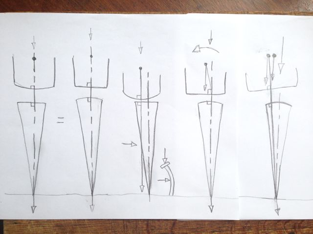

Alan Evans Posted May 3, 2015 Share Posted May 3, 2015 (edited) Just in case anybody is confused by SmoothBore's interpretation of Newton's 2nd law or the physicists' illustration of billiard balls I posted. I sketched up what I think is happening…and why I think the crowned punch head better directs the energy to the workpiece and the crowned or round face of a hammer may help with reducing roll and pitch of the hammer head. When both systems are perfectly in line they are obviously equally effective. It is when the hammer strike point is offset that the crowning comes into play. When the crowned face hammer strikes off centre, the energy is not directed to the centre axis of the tool (it continues via the "normal reaction" in line with the acceleration vector as I interpret Newton's observation) and the off centre blow tries to bend the punch. The same forces as make it difficult to drive a bent nail, I remember the unpleasant tingle in my fingers from a flexing punch when it is hit off centre. Wasted energy and sore fingers! When the flat faced hammer is offset it still strikes the centre line of the punch and the energy travels directly to the working tip via the "normal reaction force". But the hammers centre of mass carries on and tries to rotate the head around the strike point. If you tilt the flat faced hammer relative to its direction of travel so that the strike point is offset, the energy is still directed via the "normal reaction force" to the working tip of the tool. The amount of pitch or roll of the hammer head will be determined by the degree to which the centre of mass is offset from its direction of travel to the strike point. Whilst as SmoothBore said this is relative to a gently rounded hammer the same applies even more so to a round faced hammer. The energy transfer issue is interesting to muse on but not the main reason I use flat faced hammers for punches and chisels. The overriding disadvantage of the round faced hammer for me is just as VaughnT originally posited…the likelihood of the glancing blow. I would rather have something I can control; like the hammer twisting in my hand, than something I can't; which is the punch flying off across the room. Even though I completed my first 10,000 hours of hitting things with hammers nearly forty years ago, I still want to give myself every opportunity to make every blow count and not have to rely solely on my hammer skills. Why make it any more difficult than it need be? It is much more important to be concentrating on the effect the working tip of the tool is having on the workpiece, rather than hitting the tool-head in just the right place. Alan, who has drunk too many mugs of coffee this morning and must now go and mow the grass… Edited May 3, 2015 by Alan Evans delete doubled up image Quote Link to comment Share on other sites More sharing options...
arftist Posted May 3, 2015 Share Posted May 3, 2015 Alan, by flat face do you mean truly flat? I have always been taught that hammer faces should be slightly crowned. Never did understand the exact physics behind it unfortunately, but it made sense at the time. (I do understand why a perfectly flat hammer would leave marks in a forging)Second, are you trying to say that a rounded punch end is the exception rather than the rule? Again I have always rounded my punch ends and also advocate fiercely that others do so as well. Seems like you are making a case for mutual exclusivity. The exception to the above of course being stone carvers chisels with a hard struck end being struck by a soft hammer. Different dynamic as the stoneworkers chisel actually takes a bite into the hammer face with each blow.........but this is a blacksmiths forum. Quote Link to comment Share on other sites More sharing options...

Alan Evans Posted May 3, 2015 Share Posted May 3, 2015 Alan, by flat face do you mean truly flat? I have always been taught that hammer faces should be slightly crowned. Never did understand the exact physics behind it unfortunately, but it made sense at the time. (I do understand why a perfectly flat hammer would leave marks in a forging)Second, are you trying to say that a rounded punch end is the exception rather than the rule? Again I have always rounded my punch ends and also advocate fiercely that others do so as well. Seems like you are making a case for mutual exclusivity. The exception to the above of course being stone carvers chisels with a hard struck end being struck by a soft hammer. Different dynamic as the stoneworkers chisel actually takes a bite into the hammer face with each blow.........but this is a blacksmiths forum. The only hammers I have which are truly flat (or at least as flat as I can get them) are my chasing hammers which are used with my chasing punches and hammer gravers. All the others have some degree of crown as you say.I and everybody that I know also have crowned end punches, drifts and chisels. Whether they grind them as I do, envisaging the working point as the centre of the crown's arc, I do not know. So no, I am not claiming anything exceptional.My posts in this thread were directly in response to the comment by SmoothBore when he corrected VaughnT's post...and then subsequently corrected mine. I agreed with VaughnT and not the corrections by SmoothBore. But as I also indicated above, I think the energy transfer issue is fairly inconsequential…but having my statement questioned/refuted is not!Someone disagreeing with you always wakes up the brain, I have never really considered the effects theoretically before, just accepted the results as observed. So it has been a good exercise.I really hope he can prove me wrong. I think any discussion like this has a win win result. If I win the argument okay..but if I lose the argument by being proved wrong then I win by learning something new…a new knowledge and insight to add to my experience! Happy either way.Alan Quote Link to comment Share on other sites More sharing options...

SmoothBore Posted May 3, 2015 Share Posted May 3, 2015 I think the difference of opinion on this issue, results from viewing the Hammer blow as the result of travel in a straight line, ... rather than an arc.The example of the Power Hammer, ... and Billiard Balls, ... illustrate this quite well.But the essence of my original point, is that the geometry of a FLAT Hammer Face, striking a Punch, ( WHILE TRAVELING IN AN ARC ), ... has more of a tendency to transfer that energy radially ( glancing blow ), ... than axially.I agree totally, ... that the pragmatic result, is often inconsequential. Others have commented on Hammer Control being useful in mitigating these issues, ... and I find that to be true in many cases, ... but when it's necessary to really 'bear down" on the punch, ... my "control" is seriously diminished. . Quote Link to comment Share on other sites More sharing options...

Alan Evans Posted May 3, 2015 Share Posted May 3, 2015 I think the difference of opinion on this issue, results from viewing the Hammer blow as the result of travel in a straight line, ... rather than an arc.The example of the Power Hammer, ... and Billiard Balls, ... illustrate this quite well.But the essence of my original point, is that the geometry of a FLAT Hammer Face, striking a Punch, ( WHILE TRAVELING IN AN ARC ), ... has more of a tendency to transfer that energy radially ( glancing blow ), ... than axially.I agree totally, ... that the pragmatic result, is often inconsequential. Others have commented on Hammer Control being useful in mitigating these issues, ... and I find that to be true in many cases, ... but when it's necessary to really 'bear down" on the punch, ... my "control" is seriously diminished.Maybe, maybe not. I don't think our difference of opinion is relative to considering or ignoring the arc…Both the hammers are travelling through an arc whether flat or round faced. The off tool-centre strike point effect I sketched still applies whether to front and back (generated by an inappropriate arc) or side to side. I confess I did not pick up that essence from your posts...I didn't get past your contention that the round hammer face directed the energy to the axis of the tool. But in which case why did you quote Newton at me if you were in agreement with my statement that a curved hammer face was likely to reduce the pitch and roll?I think our difference could be more to do with the degree of strike point inaccuracy we are each envisaging. But...even when the offset is so great that one cannot prevent the hammers from rolling and knocking the tool sideways (you obviously have a lot more leverage with the handle to control the pitch, which I assume is why punches always seem to fly sideways) the round faced hammer would have still have the additional sideways forces generated by the curve and knock the punch further across the room! Alan Quote Link to comment Share on other sites More sharing options...
