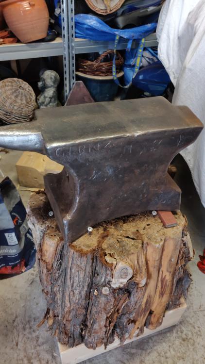

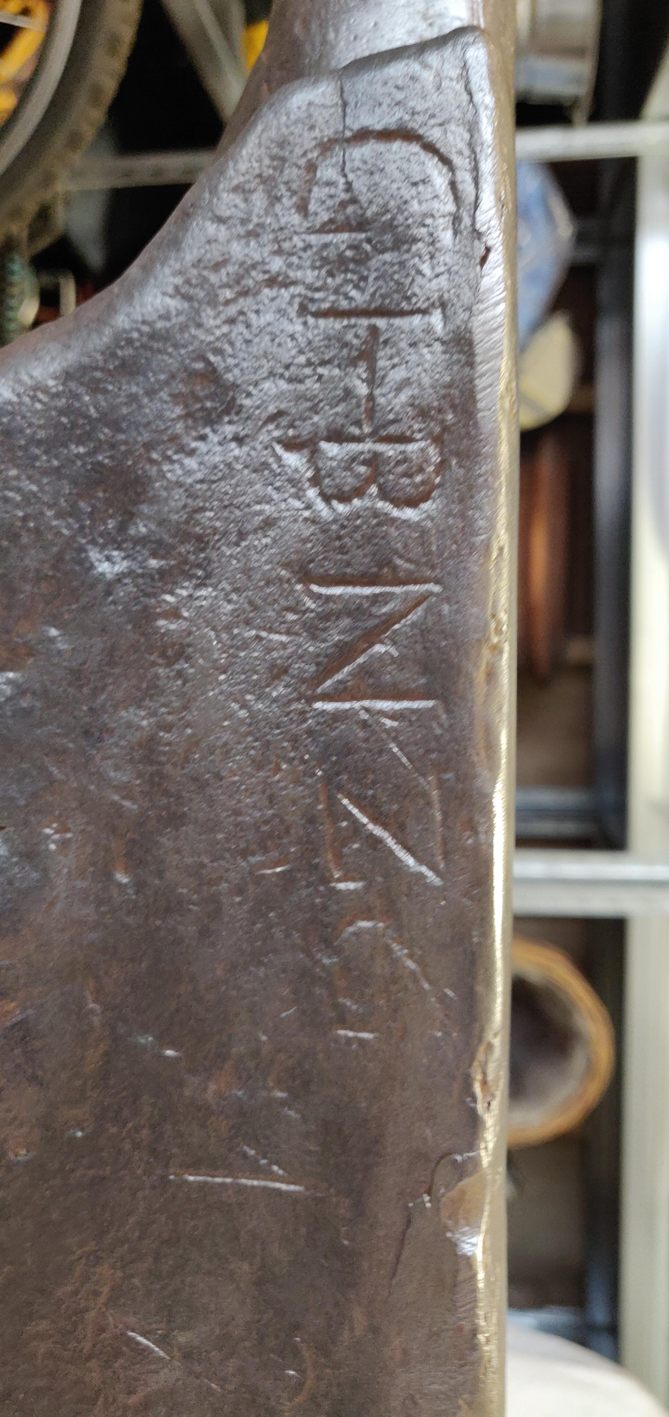

This is my (guesstimate) 60 kg old European church window anvil I saved from a scrapper for 50 euros. The heel with the hardy hole is broken off, but the face is in top condition considering its age. On these old anvils the date of manufacturing was often engraved on the far side where the church window is located. If this date is right the anvil was made in 1778.
I'm glad I stopped by the scrapyard before it was destroyed for good. And its great to be able to work on a literal piece of history.
Currently the anvil is securely mounted to the stump with metal straps (not in the picture).

Edited by Jobtiel1
Removed duplicate picture
