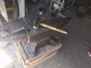

BsnNFrnt Posted August 28, 2020 Share Posted August 28, 2020 My first post, been lurking on and off since 2008. I Was able to procure my dream anvil, 320 kilo Krageloh~1935. Quote Link to comment Share on other sites More sharing options...
JHCC Posted August 28, 2020 Share Posted August 28, 2020 Welcome! Good looking anvil; can you tell us more about it and you? Quote Link to comment Share on other sites More sharing options...
BsnNFrnt Posted August 28, 2020 Share Posted August 28, 2020 Thank you sir. I will say the anvil is way awesome - around 95% rebound. I mostly make axes and whittling knives right now. Got back on the site to see the best way to build a stand for the new anvil. There is so much excellent insight around here. Quote Link to comment Share on other sites More sharing options...
ThomasPowers Posted August 28, 2020 Share Posted August 28, 2020 It's a beauty all right! When they get to that size the stand makes a lesser contribution to the inertia of the system; but it perhaps more important to the "don't let it fall over during heavy sledging" part of the equation. I remember that my 469# Fisher originally wasn't fastened down until one day we were doing some heavy work on it and I noticed that it started to creep. I installed some fence staples to corral it "U" shaped along the sides and that's worked fine. Quote Link to comment Share on other sites More sharing options...
Frosty Posted August 28, 2020 Share Posted August 28, 2020 16 hours ago, BsnNFrnt said: My first post, been lurking on and off since 2008. I Was able to procure my dream anvil, 320 kilo Krageloh~1935. Welcome aboard, glad to have you. If you put your general location in the header you might discover how many members live within visiting distance. Is there something less awkward than BsnNFrnt we may address you by? That's a beautiful anvil, 95% puts it in the same category with Soderfors and that's a beast. I've never heard of the maker so in my searching I didn't find out anything about that make but discovered the Anvils Planet, pages and pages of anvil envy eye candy. I can't see your stand from the pic, how do you have it mounted? Frosty The Lucky. Quote Link to comment Share on other sites More sharing options...
BsnNFrnt Posted August 28, 2020 Share Posted August 28, 2020 Thank you guys. Western fringes of the Permian Basin Is the home base. Tyler. - BsnNFrnt is the homage to the haircut. The stand is stacked oak 4x6 crib boards cases on 4 sides with plywood. I have 12” spikes hammered in with chain over the feet. I will get the makers mark pic on the post at some time. As far as Krageloh goes I did not find anything either - it’s definitely hand forged. Near as I can tell the top plate is over an inch thick in places. The current stand has already handled some pretty serious 16 lb. strikes making a 15lb. hardie anvil, but the steel stand will be way better. Quote Link to comment Share on other sites More sharing options...
ThomasPowers Posted August 28, 2020 Share Posted August 28, 2020 Given a name like BsnNFrnt various Acronyms and abbreviations tend to pop up in my mind---especially on a Friday. Unfortunately the Mods would be most immoderate if I were to post any of them. Lovely anvil; do you know anything about how it got out to this neck of the desert? Quote Link to comment Share on other sites More sharing options...
BsnNFrnt Posted August 28, 2020 Share Posted August 28, 2020 I purchased the anvil from a blacksmith tooling specialist who gets them shipped over from Europe. I need to contact him before (and read the advertising guidelines) I give his name out. I can only imagine the full journey this thing has had considering the state of Europe in 1935. Quote Link to comment Share on other sites More sharing options...
JHCC Posted August 29, 2020 Share Posted August 29, 2020 The general rule is: 1. Vendors’ names are okay. 2. Vendors’ contact information is not okay, but you can offer to give it to anyone who sends you a private message. 3. Direct links to vendors’ websites are NOT okay. Quote Link to comment Share on other sites More sharing options...
Old Crew Posted August 29, 2020 Share Posted August 29, 2020 Did you purchase your anvil from Terry ? As for stands I made a steel stand for my anvil that I am happy with. I have a small anvil compared to yours at only 559# I can send you some pics if you want. Quote Link to comment Share on other sites More sharing options...
BsnNFrnt Posted August 29, 2020 Share Posted August 29, 2020 It was Terry Estes. I have known him three or four years Super dude for those who have not met him. Feel free to shoot me some pics Of the anvil or stand, it is arduous at best to peel through all the old pages if you had it on here. I have all the steel just waiting on cooler weather to tackle an all day welding project. JHCC thank you for the guidance I make enough new guy mistakes people don’t see. Quote Link to comment Share on other sites More sharing options...
