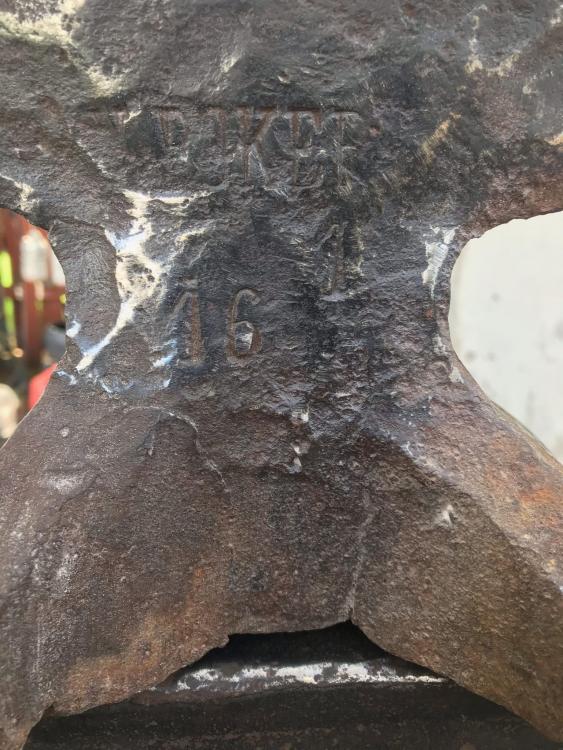

KronRon Posted May 16, 2020 Share Posted May 16, 2020 Hi all. Just signed up and new on the scene. Got a couple anvils the small one is h boker stamped 16 lb. pretty sure it’s wrought with hard surface. Has a nice ring to it. But not sure where it was made. the bigger anvil has no numbers or stamp except on bottom cast area. Looks like 27. There is a clear line between base and body and a hard plate face step and horn? Face for sure. It has a cast sound to it but decent rebound any helpful knowledge would be much appreciated Quote Link to comment Share on other sites More sharing options...
