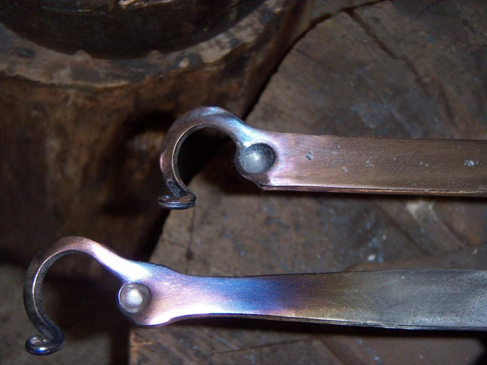

Today I ran two more test sticks, I understand more about how to control the coloring using the dragons breath of my forge. I think it's time to move on.
Almost forgot, Thanks BIGGUNDOCTOR for the tips using the oven I will give that a go when I want an even color. :)
Forging Carver, thank you, I will tell you this broadly known secret, does mean it is no secret. My best tutorial on this subject was from beammeupscotty. Best because he made me look at the beauty of a project, and worst because he made me look at my errors. As it is each time I look at these images I see areas I would like to improve upon.
Here's one I tried yesterday tryin some new things. Made from from 3/8 sq
Best practice to get the best color, and most consistent temper color is to make sure that the item is CLEAN when it goes in the oven.  So wire brush/sandblast/sand/scotchbrite/polish to the desired level of finish.  (Wire brushing and sandblasting before using other abrasives, or polishing does improve the longevity of your sanding belts, and polishing wheels, plus gives a better finish.) Then Fantastic (a brand of multi surface/degreaser) does a pretty good job getting polishing compound off of a piece, and the old standard to remove oil and finger prints from the surface is acetone.  You can get good results without whipping it down with the acetone, but if you don't you will invariably get a big splotchy finger print or grease smudge on a particularly nice piece, especially if it is a rush job, where you don't have time to redo it....

Find yourself a small ball pein hammer. Anneal it by letting it cool in the forge overnight. (Or leave it hard but use a soft hammer {eg. brass) to hit it with.) Put a loose handle wrap on it and you have an ideal tab punch. Line it up carefully and one good smack gives a neat tab.

The key part of Ausfire's suggestion is that you will probably get better results from using a ball end tool as opposed to a flat bottom tool.  I personally use bob punches (round ended) that I made from re-bar.  For this sort of application re-bar works fine for me.   Here is an image of a set I pirated off google images. I find it easier to line up a long punch like these as opposed to a modified ball pein though the latter should work just fine too.
Alright thanks. I do use a ball peen but it takes me a couple heats to get the tap right. Maybe I should use a larger ball peen.
I would not go larger.  I use either a 1/2" diameter or a 5/8" diameter.  Bigger than that is probably not a good idea.
