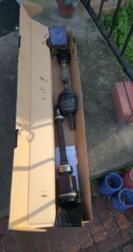

Friend of mine came by last night and dropped this off.  Said they are getting the other side done Friday and will bring them by.  I  know the price is right, but... what should I do with these?  I have no idea of what kind of metal I am using (other than an assumption it is predominately tool steel), and it will probably be a booger to work by hand.
  I appreciate any help/information on what to do with these.

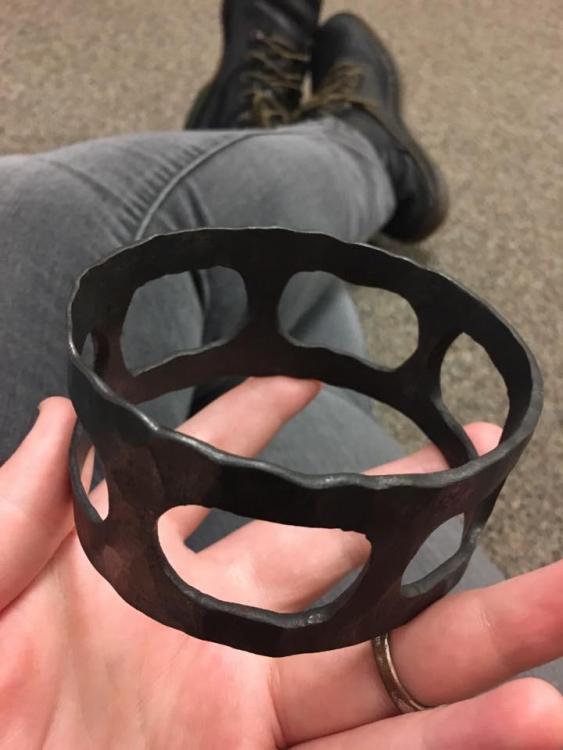

Axles are generally medium carbon, good for hammers, anvil tools, and the like. If you can bust apart the CV joint, the ball bearings can come in handy, and their retaining ring makes a cool bracelet.
Thanks JHCC.   I forgot all about the bearings, and the bracelet idea is really cool.  I like that one.  So... guess I'll store this and the next one away until I get better at my hammer work.  First dry weekend in a long time coming up, and that means I finally get to play again.  Going to start building my shop next month, which will be a work in progress.

I use to have to turn in the old cv joints for the core charge. Don't miss having to change those out.
I cant for the life of me find one, but i used a couple of the cones from CV shafts to make bells out of. The end that goes into the transmission is usually "female" on at least one of the axles. That would be opposite end of the threaded end, just to make sure no confusion. Or if the threaded end has a hole for a cotter pin you can use it. In the female ends there is usually, but not always, a sheet metal plug. After disassembly clean out all the grease, i made a link with an eye on each end out of a piece of coat hanger. I attached a sting to the slpined end to hang it with. And a string on the other end to hold the clapper. I had the style that had three flat round bearings with needle bearings, so a 1/2" disc with a hole n the middle. I used one of these for the clapper then ran a string to a small square of wood so it would swing in the breeze. They also have a really nice tone and can be quite loud.
Sorry i can not get a photo, hope i gave a good visual.
