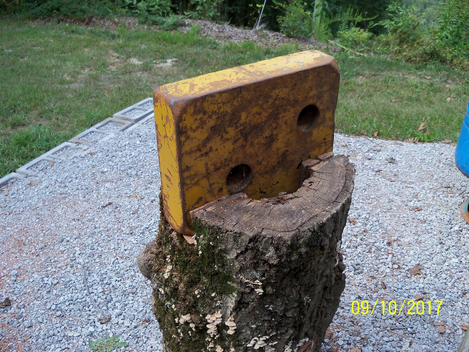

No disrespect taken here. I'll paraphrase Glenn, 1000 hours on a 100 dollar anvil will make you a better smith than 100 hours on a 1000 dollar anvil. If you have a heavy equipment repair shop or scrap yard near, check with them, bulldozers are made from anvils. This counter weight cost us $35 and we use it just as much as our 3 other London pattern anvils.
I even made a little bick for it out of a piece of sucker rod.
