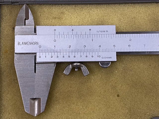

JHCC Posted December 24, 2020 Share Posted December 24, 2020 Very little time in the shop today, so I did a very little project. My secondhand vernier caliper was missing its locking knob when I bought it, so (with the help of my handy-dandy new thread gauge) I determined (A) that the locking screw has an M3-0.5 thread and (B) that my local hardware store had just what I needed: It’s been good for measuring, but I suspect this will make it good for scribing and layout as well. Quote Link to comment Share on other sites More sharing options...

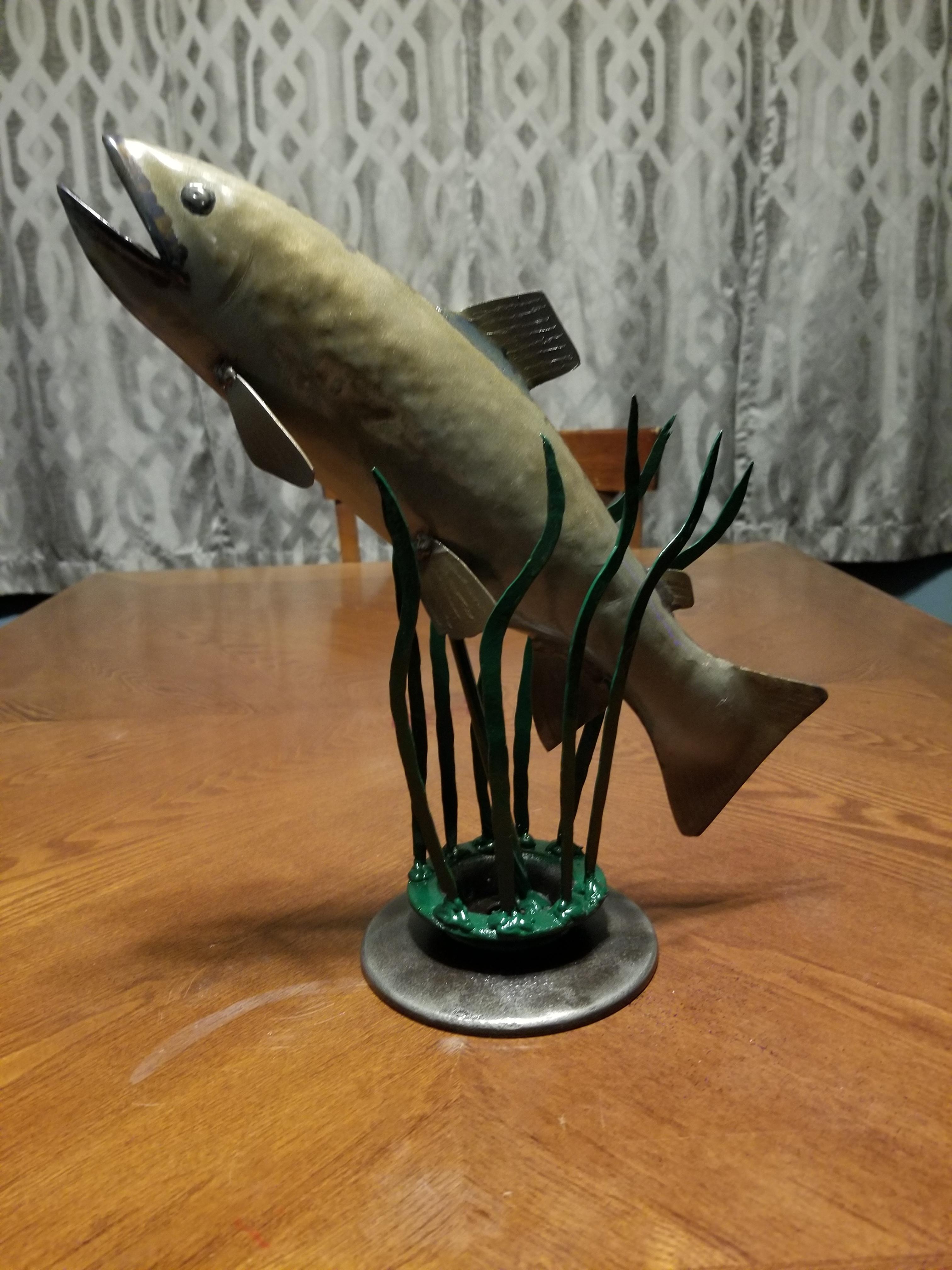

Daswulf Posted December 24, 2020 Share Posted December 24, 2020 Thanks for the explanation Frosty. Finished up the trout tonight. No time for a hook and whatnot. Looks better in person. Wound up being a brown trout. I kinda was hoping for a rainbow trout. Only thing I painted color was the green grass. The rest was heat colored and matte clear. Can do better on the next but it exceeds the commissioners request. Now I got the idea down. Was a fun learning experience. Quote Link to comment Share on other sites More sharing options...
twigg Posted December 24, 2020 Share Posted December 24, 2020 That trout looks really, really good for a two day build. Nice work! No dice today, still no room to forge in. Instead I took apart my 1x30 belt sander and converted the disk sander end to a buffer wheel with an improvised arbor. Going to test it out gingerly and see how well it works when I have something worth buffing. Unfortunately, I obliterated the drive wheel of the belt grinder during disassembly. Whoops. I'm not upset because I bought this thing for $70 hoping it would last 6 months, over 16 months ago now. Definitely got my money's worth. I might be able to turn a wood drive wheel on the wood lathe, but I'd also need the left-hand threaded screw that goes with it (also obliterated). Also tested a 1 HP single phase AC motor (120V/220V) from the scrapyard. I didn't get a motor out of it, but I did get a smoke machine! To the copper scrap pile it goes. Wasn't a total loss. I learned a bit figuring out the wiring with no diagram, just eyeballs and multimeter. (It did start, it just made some lite grinding noises and started smoking, then threw the thermal switch.) Quote Link to comment Share on other sites More sharing options...

Daswulf Posted December 24, 2020 Share Posted December 24, 2020 Andrew, twigg, thanks! The commissioner was very happy with it and the new owner will receive it tomorrow for Christmas. Quote Link to comment Share on other sites More sharing options...

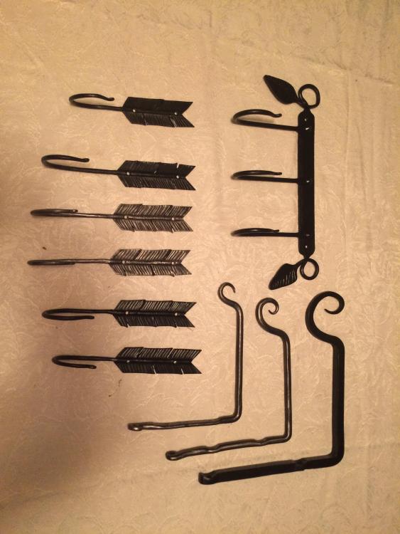

Fowllife Posted December 25, 2020 Share Posted December 25, 2020 Daswulf, I'm loving the fish. It looks great. I finished up the rest of the stuff I needed to for Christmas the last couple days. Some more wall hooks for my family and a butterfly for the wife. Quote Link to comment Share on other sites More sharing options...
Daswulf Posted December 25, 2020 Share Posted December 25, 2020 Nice work Fowllife, and thanks. All the hooks look great but that butterfly hook is awesome. Quote Link to comment Share on other sites More sharing options...
Fowllife Posted December 25, 2020 Share Posted December 25, 2020 Thanks. The body took way more time then I care to admit, and there are a few things I would like to add for the next one but I’m pretty happy with it. My wife loves dragonflies and butterflies so I think I might try a dragonfly next. Quote Link to comment Share on other sites More sharing options...
Daswulf Posted December 25, 2020 Share Posted December 25, 2020 Gatta get that first one done to realize the improvements for the next. Still, I think it is perfect as is. She will love it. Quote Link to comment Share on other sites More sharing options...
twigg Posted December 25, 2020 Share Posted December 25, 2020 Fowlife, I love the butterfly! I see what you mean about the body. Nice work! Thomas, I hear on TEFCs. I was hoping that a buffer would be a little less abusive but I hear you. Doesn't help that all the grease oozed out one of the shielded bearings. Explains the noises I heard. I'll hang onto it for now, might try to fix or replace that bearing (just for learning sake, I know it's more time than the motor's worth). Quote Link to comment Share on other sites More sharing options...
BillyBones Posted December 25, 2020 Share Posted December 25, 2020 Love that butterfly. My old lady is also into dragonflies. Fun fact about dragonflies, them and humans have something in common that is found in no other creature on this planet. We can anticipate where something is going to be. For instance ever watch a lion chase its prey? They follow move for move, humans and dragonflies can see where the prey is going then go there rather than chasing. Like when hunting leading a rabbit when it is running. Dragonflies are pretty amazing critters. Anyway, Christmas creations are done so got a little time for my needs. And i needed a nice big punch for eye holes. Started as a 2 1/2" round 2" long of S-7. Debating on a handled punch or hand held. Will provably do a wrapped handle since i do not have a punch big enough yet to make a hole, but a hand held is a little more versatile. Ah, what the heck i got a 6" long piece of 2" round H-13, i will do both. When you cant decide, do both. Moved the whole thing by hand, that was a work out now. Still needs some finish work, but i got the basic dimensions where i want them. Quote Link to comment Share on other sites More sharing options...
