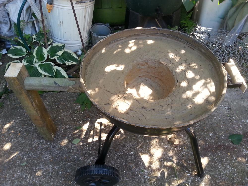

  16. Great advice, thanks! Will take it all onboard for next time I fire it up.

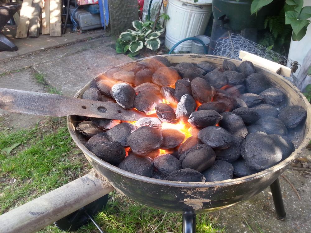

  17. Would have replied to this thread earlier, but I've only just stopped groaning from all the puns. Just had to follow-up with the original post to say that today I tried out the forge. Threw on whatever charcoal I had to hand, pulled the blade off a broken mower, and for the first time ever put hammer to hot metal. Did many things wrong; melted the metal at one point, pretty sure I burnt the metal, had the head fly off my hammer (broke a mallet handle fixing the hammer!), got a couple small burns from flying scale when I struck the metal, and ended up with the ugliest metal rod you've ever seen. BEST. SUNDAY. EVER. Now to actually read some books on how to do this right, take a few lessons, get some more metal and fuel, and practise, practise, practise.
  18. Hah, yeah, fair play. I just mean't more like the mix you mentioned… Though one man's box of dirt is another man's exciting entry into blacksmithing. I like it! Yeah, the side blasting is more like Frosty mentioned, in that it is horizontal but does appear at the bottom of the bowl rather than up a bit.
  19. Thanks for the encouragement, guys. I do expect the clay mix to shrink a bit, but I figured I can just patch that up as I go and as it cracks. Should give me a few good tried, though, and if/when it fails I'll step it up to a proper JABOD with the sand/clay mixture you mentioned, Frosty. As for fuel, ThomasPowers I only have some charcoal right now so I expect that'll be my initial test, but I'm going to get some coal - I expect that'd be better and last a bit longer.
  20. This is my first ever attempt at creating a JABOD forge - though in this case it's a small BBQ rather than a box. No idea if it'll work - there's probably a hundred things wrong with it, but I can't wait 'til the clay/dirt sets a bit and I can try the little thing out. So excited!

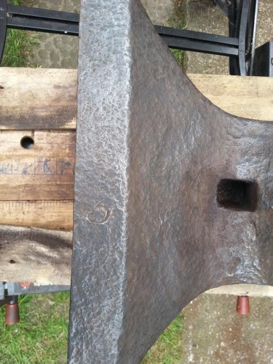

  21. Just wanted to say thanks to everyone for your great advice and welcoming nature! I've worked on my anvil, and she's looking lovely, and my vice is now in a working condition. Now I just need to make/buy/borrow/steal a forge (OK, possibly not that last one) and I can get started. :-) Here are a couple shots oh my anvil now. I only found one possible identification mark on it - possible a "G" stamped very close to the base on the front-side.

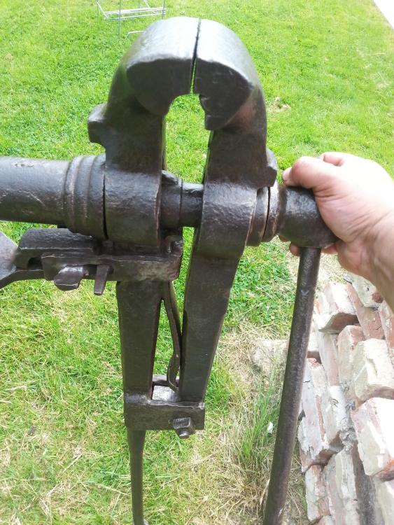

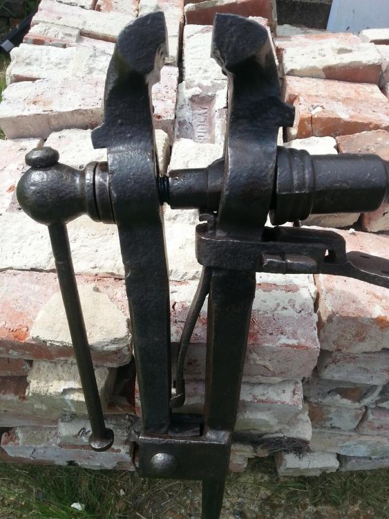

  22. Here are a couple pictures of the moving arm reattached. To be honest, from the solidly rusted vice it started as to what it looks like now, I'm really happy, and even if I don't attempt to re-arc the spring (if it even needs it) then I think it's a more than usable vice for me, especially as I'm really just starting out with this as a hobby. I just need to think about where to mount the vice now. I have no stand or bench big enough for it, but I've seen on this board that people have posted up their stand builds so I'm going to have a look at those and get some ideas. What do you think of the leg, though? It's bent near the base, so would be a bit tricky to get in a hole. Think I should see about getting it straightened when I have access to a forge?

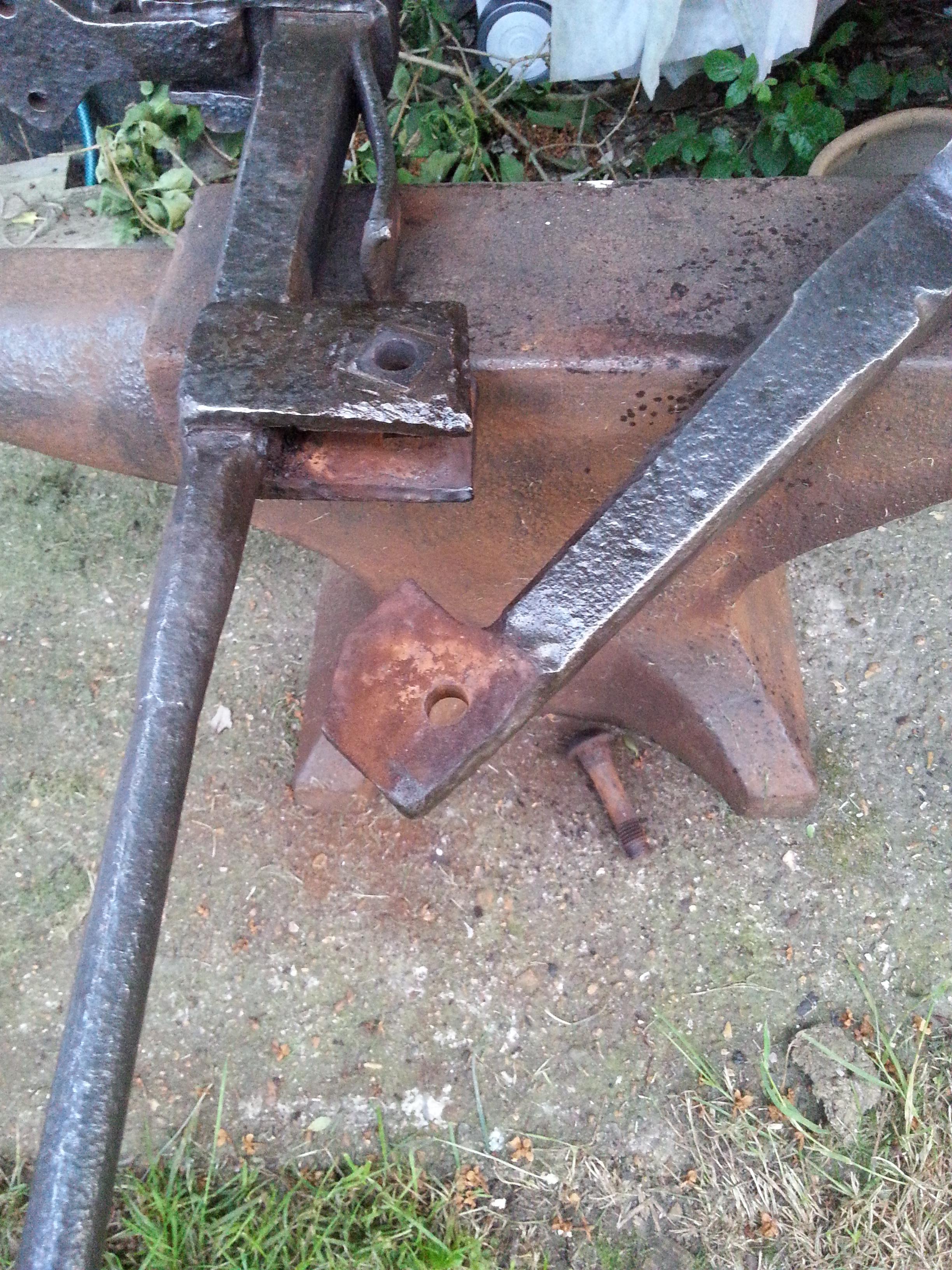

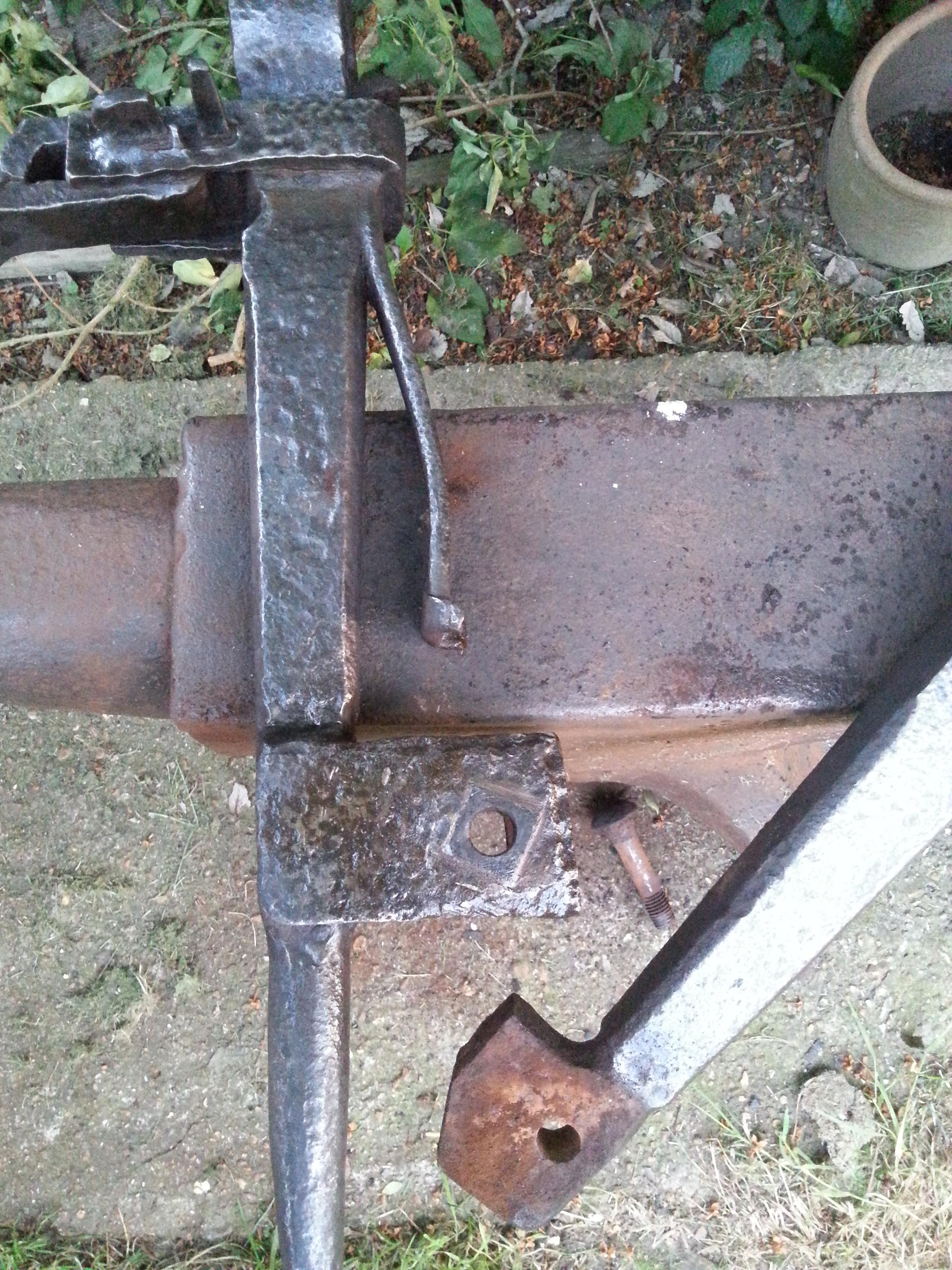

  23. Hi, After a number of attempts, a bunch of penetrating oil, and (as of today - wish I had done it sooner) some heat, I have managed to get a very rusted together vice apart. This, however, is the first leg vice I've ever hard (total newcomer to all of this) and I wonder if the spring looks in an OK position, or whether it's had so long in the same spot it's now just fixed in place. The photo attached is how far the spring protrudes, but I'm not sure whether it's meant to be more curved so as to really push back the movable arm, or whether it's just there to push it back a little bit from the closed position, of that makes sense? If it's doesn't look like it's got enough of a spring, is it relatively easy to fix (for some with literally no forging experience as of yet)? Any thoughts or advice are, as always, very gratefully received! Cheers, Andy
  24. I'm actually with you on this one. I am super happy to have them and will respect them, but at the end of they day they are tools and I need them to perform the function for which they are intended. That said, I'll try the penetrating oil for a bit and will get my hands on a torch to heat it up. If that doesn't work (which so far with just the oil it hasn't) then I've no problems about cutting off that bolt and getting a new one - I'd rather have a working vice than an original lump of scrap metal. It's larger than anything I have so will need to source one. I'm assuming you can buy parts like these from various places online so I'll have a look around just to be on the prepared side. Hopefully my knotted wire wheels will be delivered tomorrow and I can start cleaning up the vice and anvil!
