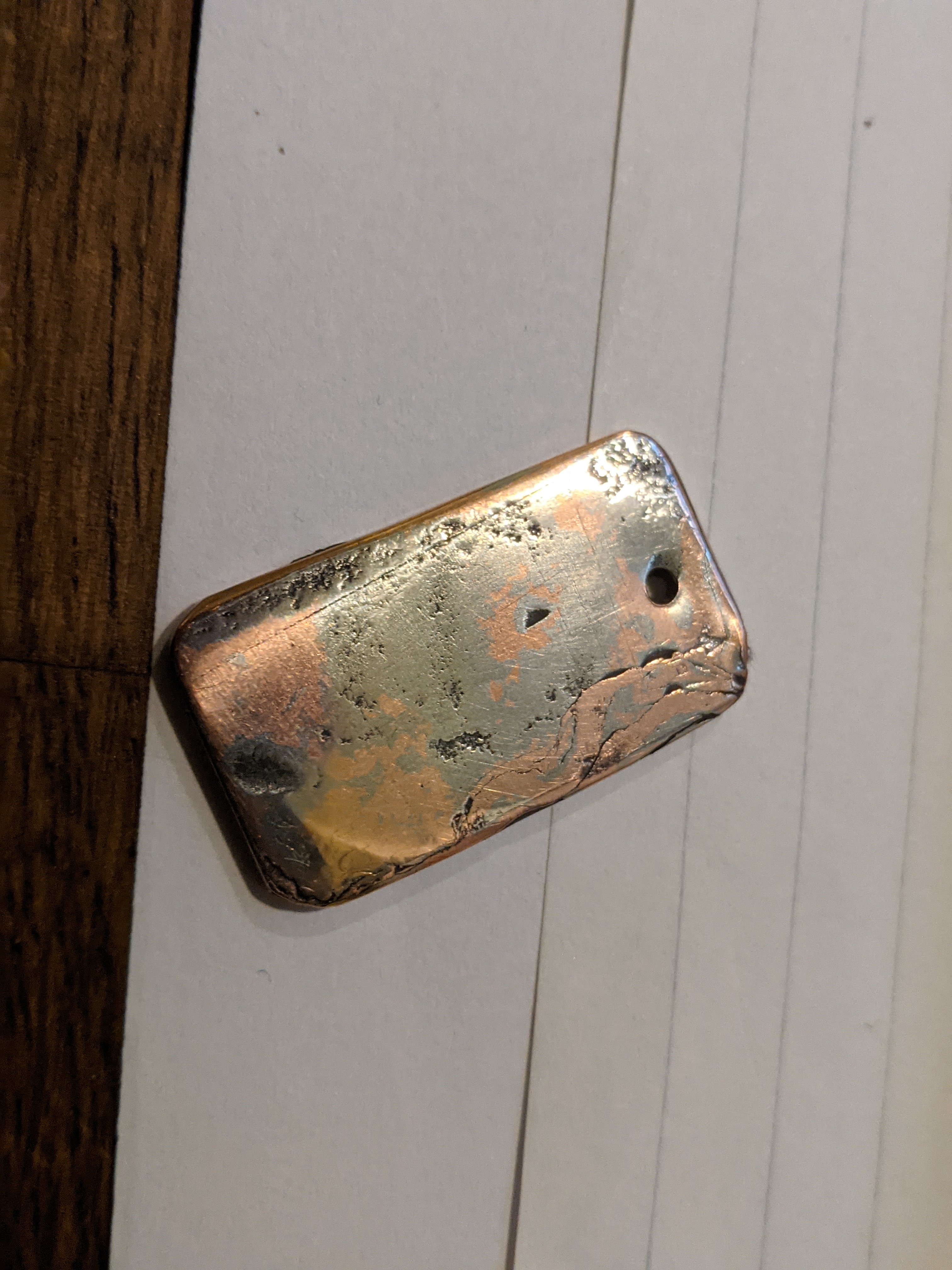

  2. MattBailey started following Andrew Collington
  3. Thanks for the great advice! Once I am able to make a decent billet, getting a pattern more than what can only be described as "splodgey" would be a good thing, so I'll try the countersinking like you suggested. I'm thinking the motor on my drill died - there's just no attempt at life when I got the power button. So looks like I might have to buy myself a new tool for the garage... "oh no!" The clamp I made was from scrap pieces of an old "up and over" garage door mechanism. Was about 42mm x 8mm, and the bolts were M8 X 45mm. I can totally appreciate what Frosty said about making them tighten evenly. I made it long enough to fit in the vice for compression but then struggled to keep the coins aligned when trying to tighten. But I definitely think it was thick enough - didn't see any noticeable bending, at least. That looks amazing, Daswulf!
  4. That's really cool, Chimaera, and inspired me to try similar today. I think I overheated the coins after the first compress and they started to slip apart. Got three of the quarters welded together, though.. so even though my drill press broke when trying to put a bolt hole in the clamp, I'm still counting it as a win!

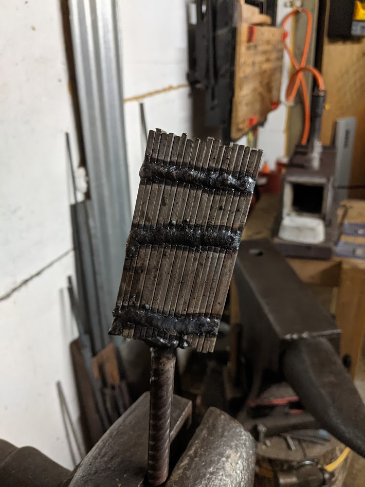

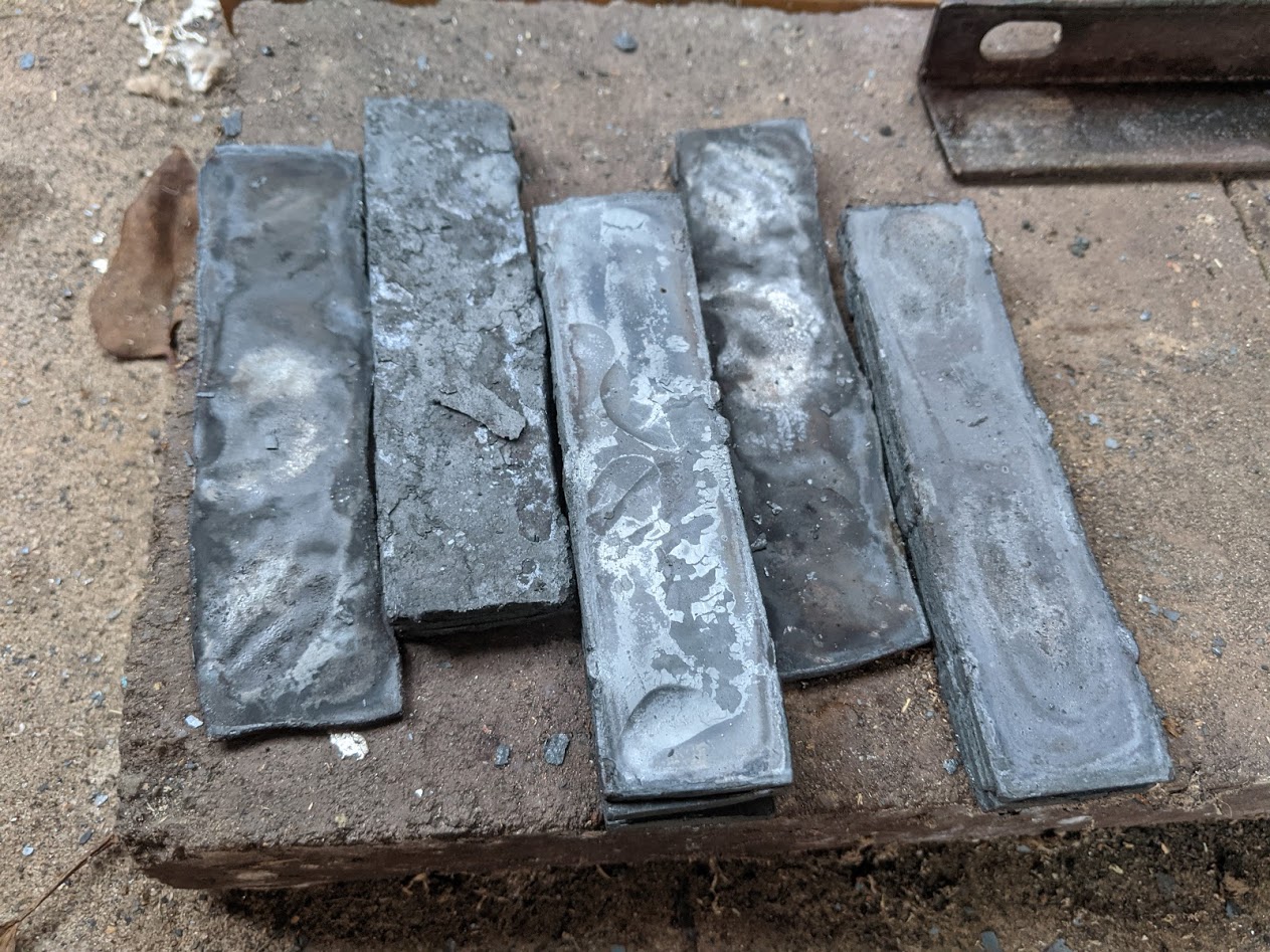

  8. Yep, I think that pretty much sums it up what I was trying to do perfectly! I'll have a look at doing some mokume gane next with nickel and wrought iron as you suggested. I'm assuming that's pretty much the same procedure? I'll go watch some videos and read some articles on it before attempting anything this time. Thanks for your feedback, Thomas Powers!
  9. Hi there, I've never tried pattern welding metal before, and I've also never used stainless steel before. But my wife thought it'd be nice to have a "simple damascus necklace" and it seemed like stainless steel was a good enough way to go, so figured I'd knock off two complete unknowns for me in one go. Needless to say, it didn't go well. I started with about 1m of 304 and 316 and cut it roughly evenly. I sanded off all the rough edges from cutting and cleaned the surfaces with acetone. I stacked and welded them together as best I could (don't look too closely at the welds - it's only the second time I've ever tried welding anything!) I got the metal warm and sprinkled with borax then brought it up to temperature (well, what I guess was temperature, anyway). Then I did some light blows to try to set the weld, repeated with a little more borax, heat, light taps, heat, then basically tried to give it some wellie to solidify. (Mostly I hit it square, but still need to practice better hammer control.) However, anytime I set to hit the metal harder the layers would start to peel apart. So I'd try a little more flux and reheat, light blows, heat, hard blows. I also tried compressing it in my leg vice with some angle iron, just to try to spread a bit more even pressure across the stack than my hammering would. In the end, though, all I made was an unholy mess with layers of metal all peeled apart. So I wondered if anyone could give a little advice for if I try this again? Was my procedure flawed? Is there a different way of working for stainless steels? Is the metal worth sanding down flat (lots of bad hammer blows on parts of them somewhat because I was tired but I think mostly because I was venting frustration ) and trying again? I know I wouldn't be able to tell the two metals apart, but that might just make for a more interesting pattern if I pull it off. Or should I just scrap all of that? Is there a better choice of metal for metals for pattern welded jewellery? Wow, that's a lot of questions! But any advice for a newbie is always appreciated. Thanks! Andy

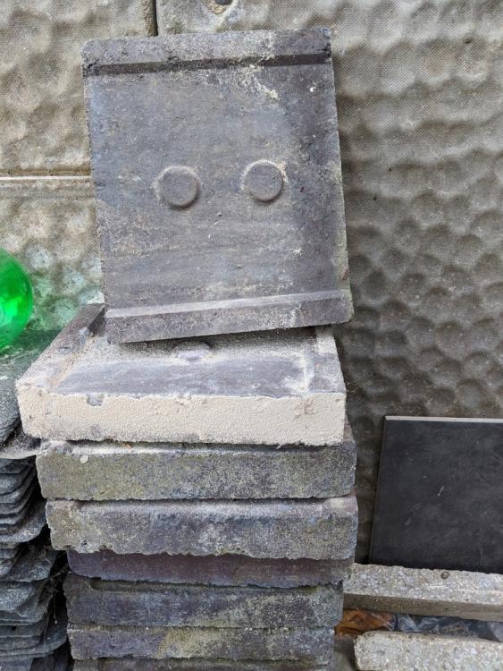

  10. Probably simple stuff, I know, but I made some tree decorations today.
  11. Good to know you're happy with the quality and thanks for posting those pictures. Yeah, there are some quite obvious gaps there... So you're just laying a base of the supplied clay (is it refactory clay or rigidiser? Is there a difference? Sorry - no idea about this stuff yet!) and then putting a much more complete layer of Kast-O-Lite over the top of it? Could one option be to remove the blanket entirely and replace it with fire bricks that are of an appropriate size? (The base ones supplied and then some on the side that effectively hold up ones across the top with holes drilled through them for the burners, of course.) Their DFPROFK series seem to use fire bricks rather than blanket, so I guess it's possible, but don't know if the internal construction of the forge you have is any different.
  12. I am considering getting a 2-burner Devil's Forge with a door (the DFPROF2+1D) and came on here to ask if the refactory clay they supply is enough or not (especially after reading the https://www.iforgeiron.com/topic/53239-ceramic-wool-insulation-safety-alert/ post!). I had seen one video of its application (https://www.youtube.com/watch?v=xNOywSx01pM) but have no idea generally how thick the clay liner should be - I just assumed it should be enough not to allow the fibres to break loose. So anyway, it was good to see this thread because it looks like someone else has figured it all out :-D So please let us know how it goes!
  13. The 90 or so bricks I got from an old ex-farrier (who I got my anvil from), and he said they were firebricks so I guess I'll just have to trust him on that one. I was pretty sure the others were firebricks... right up until you questioned it But assuming they are, it sounds like it could work out so I'll give it a go! With the reshaping or the pit; I'm assuming the premise to that if you wanted a bit of a longer heat you could widen the pit length a bit (be more oblong than round). But would anything need to be done with the tuyère to enable that? Or does it being in different shaped pit make the air circulate in the right direction to push out the heat correctly? Ah, just looked at the thread at and it appeared to answer my question about the pit shape and tuyère - sorry about that, I should have investigated a bit more first.
