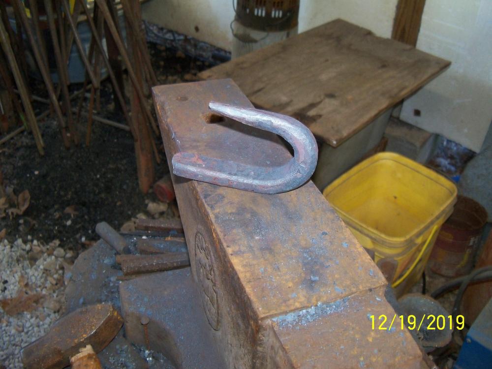

Irondragon Forge ClayWorks Posted December 19, 2019 Share Posted December 19, 2019 Happy to see you posting again Mark. Do you have any pictures of your classes? I haven't done much forging lately but today, I made a towing/lifting hook to weld on to the front loader of the new to me tractor. Made out of 3/4 inch diameter coil spring. Quote Link to comment Share on other sites More sharing options...

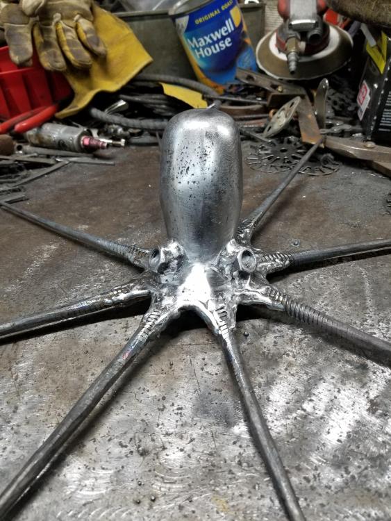

Daswulf Posted December 20, 2019 Share Posted December 20, 2019 Nice looking hook Irondragon. Any heat treat, or just normalized? More work on the octopus for me. Really hope to get this cleaned up and get the tentacles bent into a jewelry holder tomorrow maybe. Quote Link to comment Share on other sites More sharing options...
Irondragon Forge ClayWorks Posted December 20, 2019 Share Posted December 20, 2019 I just normalized it, made one for the old tractor and it worked well without any hardening or tempering. Quote Link to comment Share on other sites More sharing options...

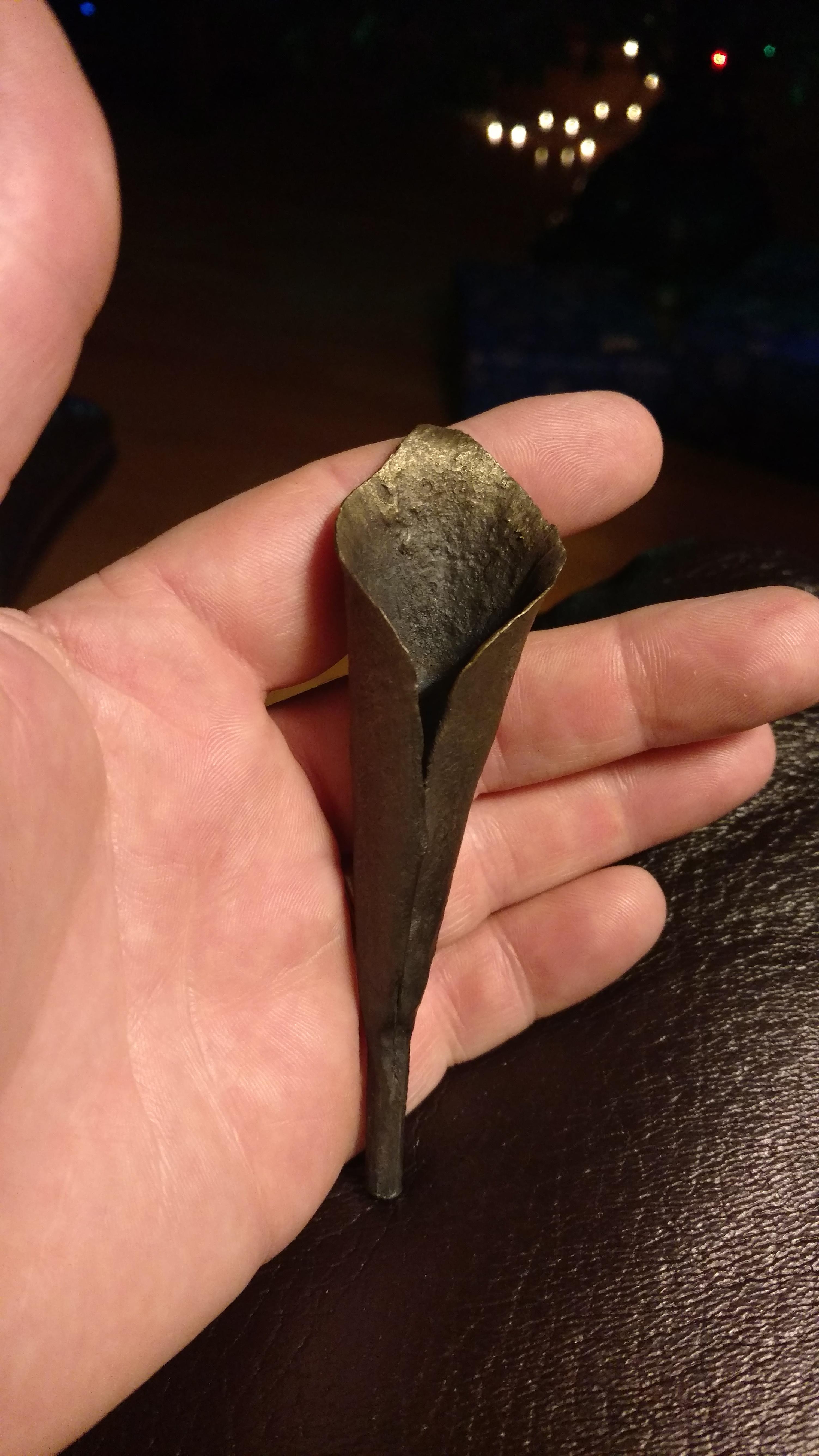

GolFisHunt Posted December 21, 2019 Share Posted December 21, 2019 I made a calla lilly for the Lady of the Manor. Had issues with excess scale during the last of the folding and the stem broke when cutting to length. Happy with the shape though. Quote Link to comment Share on other sites More sharing options...

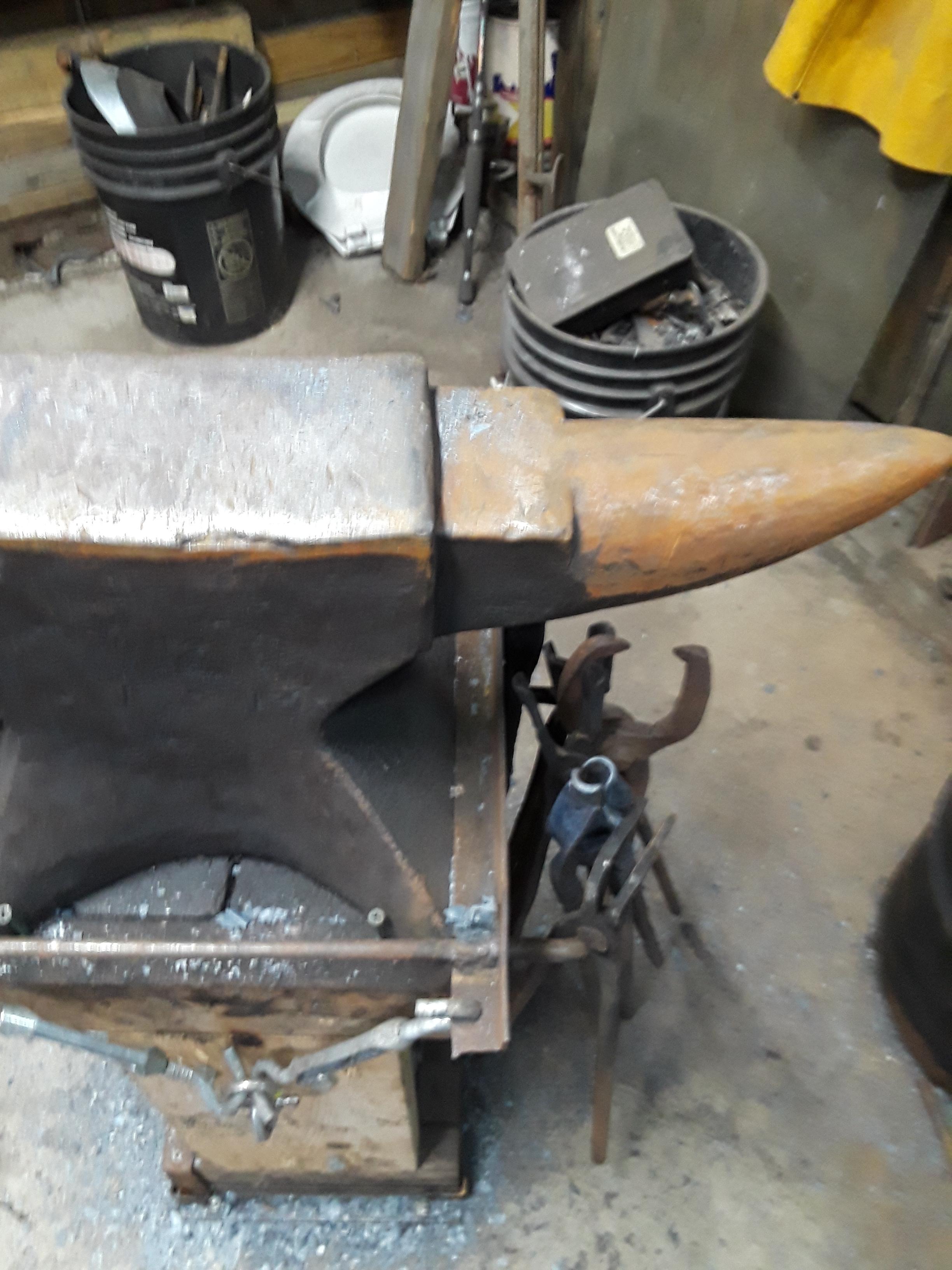

BillyBones Posted December 21, 2019 Share Posted December 21, 2019 After being sick for the past week and a half i am finally about 70%. Fever broke Thursday. It was nice just to get outside much less in the shop. Feel pretty good just sitting on the couch but after about an hour working my batteries are dead. So first my anvil after that much time not getting worked on. Got a little rust some WD-40 cleaned up pretty quick. Finished some openers for the guys i work with. Made 2 waxed all 5. They are made from the same thing as that little piece of strap. When we get reman trannies they are used to hold the torque converters in the bell housing with a carriage bolt, hence the square hole. I take everyone i can get my hands on, very handy to have around the shop when you need a small piece of strap for something or just a small piece of flat stock. Have to watch out though some are plated but some are stainless. I also of course take the bolts, 5/16" - 18 x 3 1/2" carriage bolts can become useful also. Quote Link to comment Share on other sites More sharing options...
