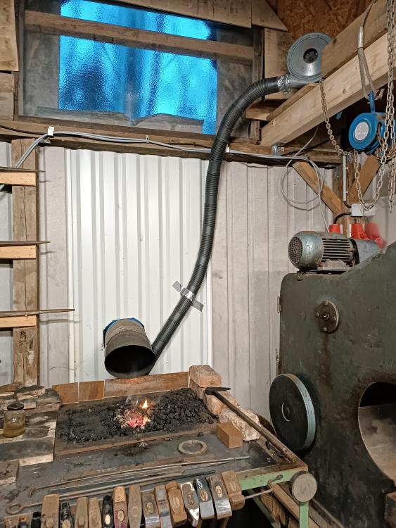

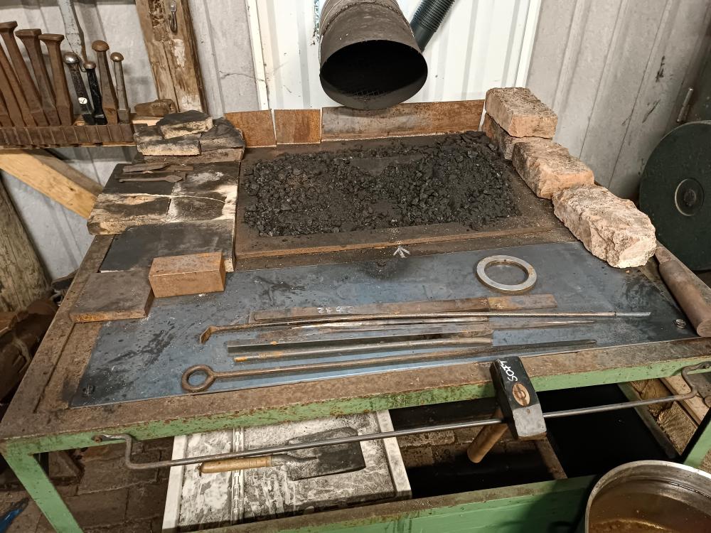

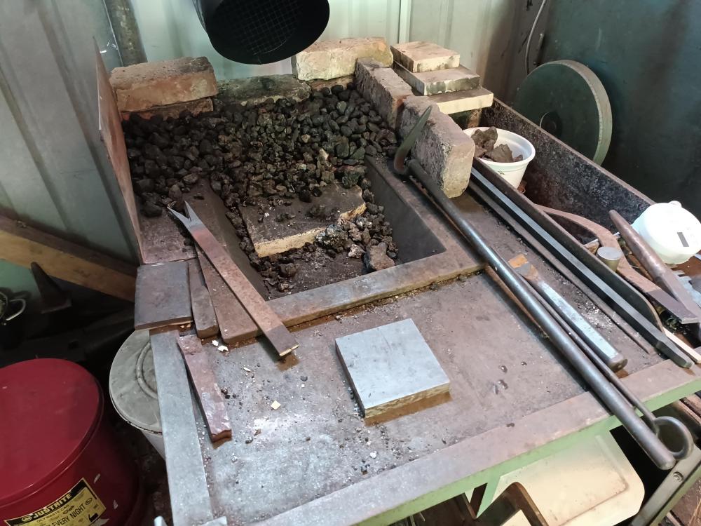

I didn't create much recently, but reorganized a lot in the shop. This week, I updated the fire to better fit the layout of the forge. At first, it wasn't really practical to have the table reach as far into the room and at the same time have so little space to warm up longer pieces. So I turned it lengthwise, but then the water trough got in the way. As I didn't really need that on there anyway, I bolted down a 6mm plate over the opening, to create more useable space. I didn't weld it in place, to be able to flawlessly reverse the process, if need be. I also moved the blower up onto a beam, it was bolted to the table before.
Before:
After:
1739898025669-Kopie.thumb.jpg.1f1bb1a3784c62ee6e33d7588eb1aa2a.jpg1739898025707-Kopie.thumb.jpg.fdf0180ae371444afccc4bff78ee25d4.jpg

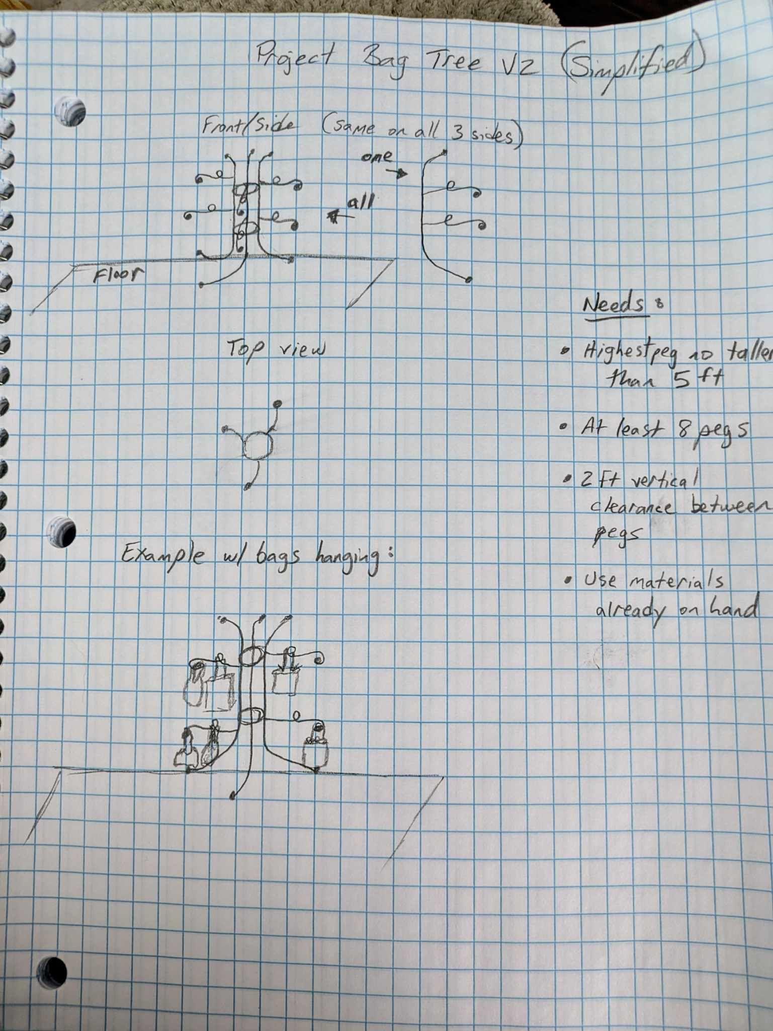

I think my original post somehow misrepresented what I was requesting in the form of advice. There is already a plan and already a design. The original deadline was this Saturday but weather has pushed it back. I have already begun working on the project and have the 3 vertical supports created (though not yet shaped for the curves). I've also finished 4 of the ball ends for the arms - which were basically randomly wrapped up 3/16 round bar to look like an unraveling ball of yarn. I have made new guillotine dies to help make the rope twist grooves into the 3/8" square bar a little faster for the creation of the arms.
What I was asking was if anyone had experience making a similar kind of thing and had tips they had already picked up which I could use to save me from learning the hard way, lol
The original plan I shared was basically shop notes for myself - to determine the length I'd need for various pieces and notes on what stock I intended to use for which parts, and other random bits of info I didn't want to forget about. I just figured I'd share that with other experienced smiths to see if they caught anything I did wrong or wasn't considering or maybe could execute differently.
For example:
  1. Am I correct in thinking a 3-legged stand is easier to balance than a 4-legged stand?
  2. Do the legs really need to curve out if it turns out that I don't have the length needed to do that and still have enough height for the rest of the stand?
  3. This will be used in the converted attic space so it will have to be carried up a stairwell. So I'll attach two arms to each leg either with tenons or welding. Then I'll have two holes in each leg and three holes in each ring. Each leg will attach to the two center rings using bolts/nuts. This is how I intended to assemble it in place so if anyone sees a problem with that which I'm missing - I'd love to hear it.
In regards to the "use materials already on hand" under the list of Needs on the image, this is (mostly) what I have that's 1/2" or smaller and of a somewhat substantial length (meaning, I'm not including bits of scrap pieces of less than 2ft).
  • 1/2" square bars from leftover big box store balusters for deck railing
  • 3/8" square bars - also balusters from a railing but this is the front porch/stair style rails. I also have the other bits of that railing - so some 3/8" preformed scrolls and some C-channel from the hand rail & base supports
  • bed rails (1.5" x 1.5" angle iron)
  • garage door spring
  • 3/16" & 1/8" round bar
  • 1/8" x 1/4" flat bar
  • 1/4" x 1" flat bar
Bolt it down if you are scared it falls over.
Also legs could be smaller in that case.
Seems a big project. Good luck and have fun.

No need to curve.  Going back to my days as a physical therapist, I'd often say this to patients -  to maintain balance (ie not fall over) the center of gravity of any object needs to be inside the base of support.
The base of support is the outline of whatever is touching the floor, no matter what the shape is.
The center of gravity (in your case here) depends on how many and where the bags are hanging on the structure.  As folks grab the bags off the rack, this will change.
In your drawing, I'd make the middle leg stick out further than the others, especially if this is against the wall and there will be no bags on the backside to counter-balance the bags on the front.
And/or make sure all the bags are on the sides and none in over the middle leg.
Thank you gewoon and billyO. I did know from what I could find that the base needed to extend beyond the span of the arms. And I did read specifically if it's a single center base, the weight needs to be enough to support maximum potential off balancing. I thought by changing it to 3 legs that I wouldn't require as much weight at the base but it sounds like that was possibly erroneous thinking.
Alas, no bolting to the floor. But I'll brainstorm on ideas for weight that can be added to the feet. Like maybe fancy sand bags or if I'm feeling especially ambitious, some kind of metal art that clips onto the feet. Or maybe I could hang heavy stuff from the inside rings?

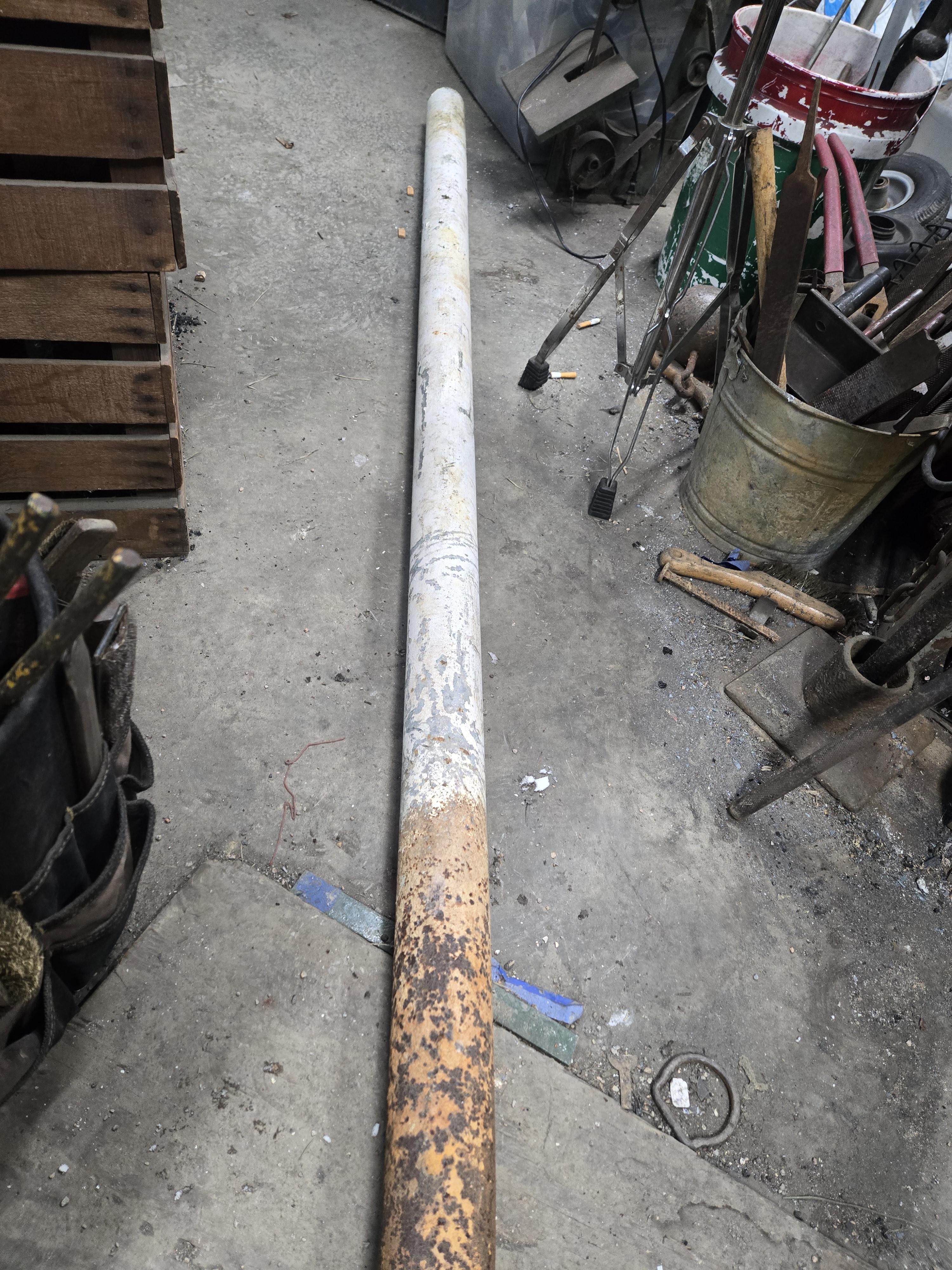

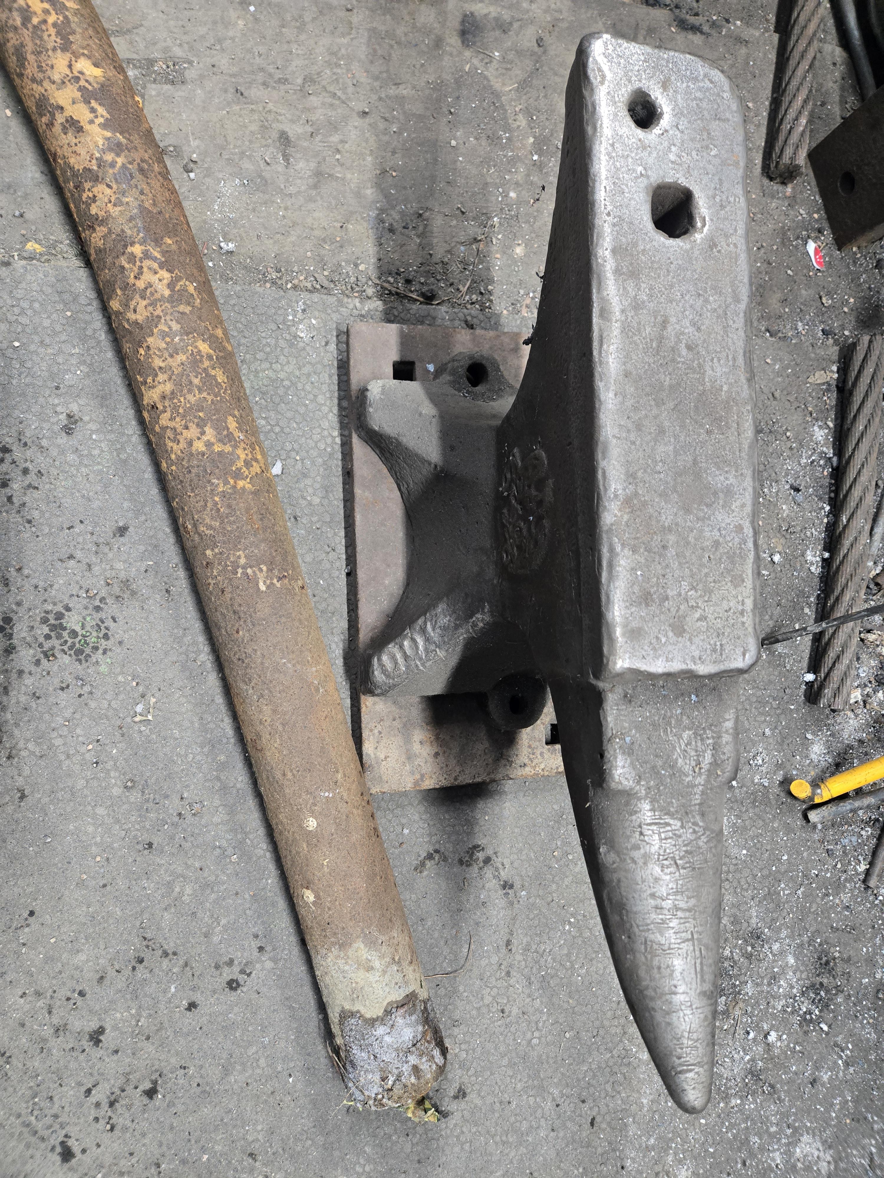

A lot of great work, wish I'd have kept up on mentioning it. It's inspirational.
I have an extra anvil hanging around my home shop that I might be able to use at work in the body shop. Got a rr tie plate and some thick walled pipe for a base and some legs. And since I never really use it at home I might take in my gas forge to make custom repair tooling. Been there almost 14 years and they are good people and know what I'm about.

This would help move the COG (center of gravity) away from the perimeter.  Even better would be adding stuff on the back against the wall. perhaps adding metal decorative elements?
Are 3 legs better than 4? Yes and no. More legs give better support. You have to look at the base of 3 legs as a triangle and not a circle. The space between the legs the base will be closer to the center of gravity than at the ends of the legs. Adding legs between the 3 would push the perimeter out away from center (yes i know that is 6 and not 4 but it is easier to visualize the idea i am trying to convey with 6). The arms may be over the legs but if you over weight two of them it will be prone to tipping in the direction between the legs.
I know you said that you did not want wood but what about a circular wood base to sit on? It could be bolted to that base rather than the floor and provide added stability.  And some weight, weight will lower the point from the top that will effect the center of gravity... some. Think of putting a stick in a bucket of sand, you can hang the top of the stick far beyond the center of the bucket. You can put weight on it but only to the point that does not move the center beyond that of the bucket.
I have trouble sometimes putting into words the idea i am trying to convey so i hope that made some kind of sense.
It makes sense. I've got a good collection of ideas to work with. I'll be sure to share my progress :)

A tripod is more Stable than a quad because no matter which direction you lean a tripod there is always at at least one point of contact on the far side of the lean. Same as for anvil stands, if one leg is a different length or on uneven surface the stand simply leans back until the third makes contact.
Put a bit of grit under one leg of a 4 legged stand and it will rock back and forth on the two legs at 90* to the long leg. Put a poker chip under one leg of a kitchen chair for an easy demo.
3 legs Will be more stable than 4. That doesn't change the basic physics that says the center of support must be wider than the center of gravity.
I can think of a couple easy modifications that will have minimal visible impact on the bag rack. #1. put flat feet on the bottoms of the legs, nothing fancy, I extended the base of the stand under my Soderfors with strips of 14ga. sheet steel a couple inches long. If I cared about looks I'd paint them to match the floor, I can always kick a little soil on them outdoors.
Whatever, it's not hard to extend the base of support.
The other issue I see for stability is how long the bag arms are, just in your sketches they appear to extend beyond the legs.
To open opportunities for joinery, plain steel nails make fine cold rivets and they're cheap. Just drill a hole in a piece of scrap so you can check nails in the store and get the right size. NO galvy or vinyl nails! the vinyl coated nails have a friction activated glue so they glue themselves in the wood when you drive them. These are NOT good particularly nails for rivets.
Nuts and bolts work nicely, I suggest using Nylock nuts so they can't loosen up over time and use. Just hanging and lifting bags off will cause enough flex in the structure to loosen plain nuts and bolts. Of course there's always lock tite.
Can you lift it to an outside window on a rope if both of you heave on it? A blanket folded over the window sill so it doesn't get scratched up and you wouldn't have to take it apart and reassemble it for the install.
Thanks for all of that Frosty, you always go above and beyond!
I wasn't being very careful in the redraw. The arms will be 1.75ft, the legs will span 2ft.
I like billyO's suggestion to hang metal decorative elements to the backside. I asked Ashley last night if she had an idea of where she'd be putting the stand - as in, against a wall, in a corner, or in the open. She said likely against a wall. So I will have one side that I can weight heavier to counterbalance. I already have a few ideas for the hanging decorations as well. They won't really be noticeable when bags are hanging but would add to the overall design when there aren't as many bags. I was also thinking I could add some empty S-hooks around the rings and she can hang stuff from those as well - which would also add to the COG yet serve a functional purpose.
I also like Frosty's suggestion to add flat feet to the bottoms of the legs. It would give more surface area to the points of stability.
I will definitely use nylock nuts.
You had me literally laughing out loud when you suggested installing through the window. I would have loved to suggest it to Ashley for the sole reason of watching her reaction! :lol:  Alas, the windows up there are not wide enough to get the fully assembled stand through.

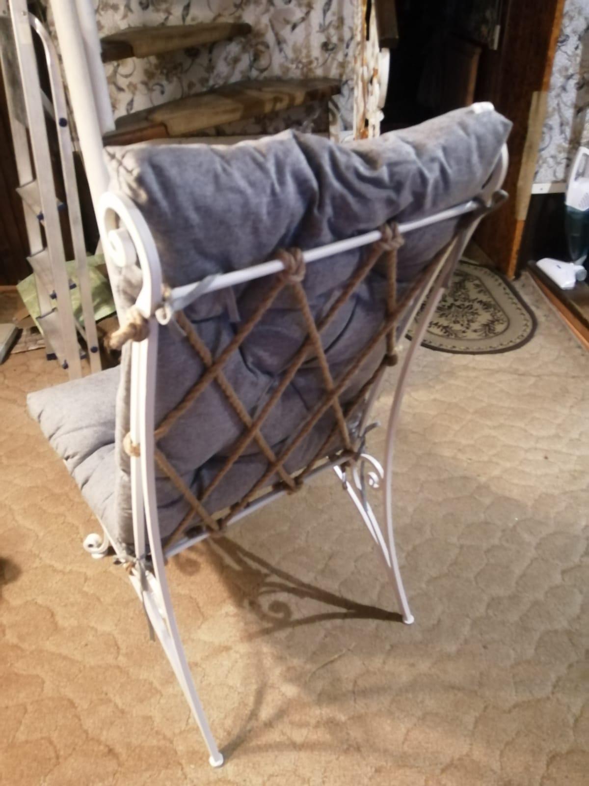

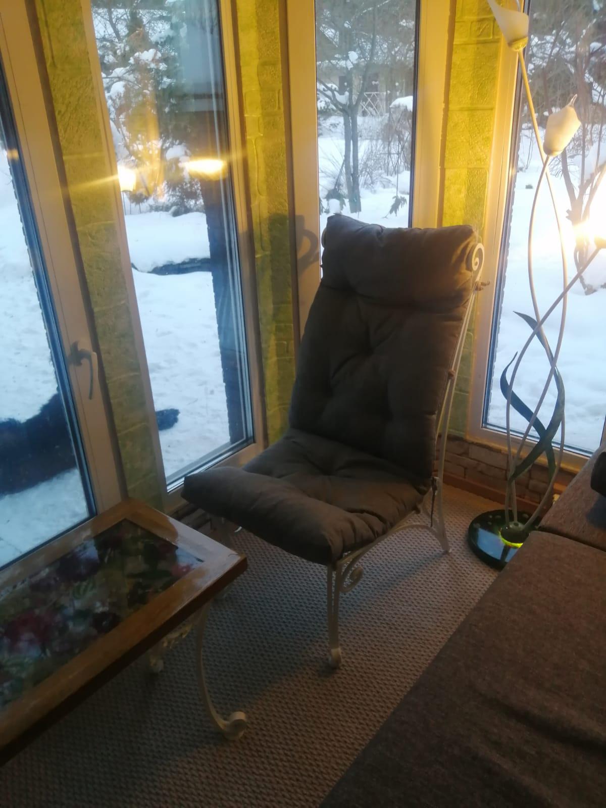

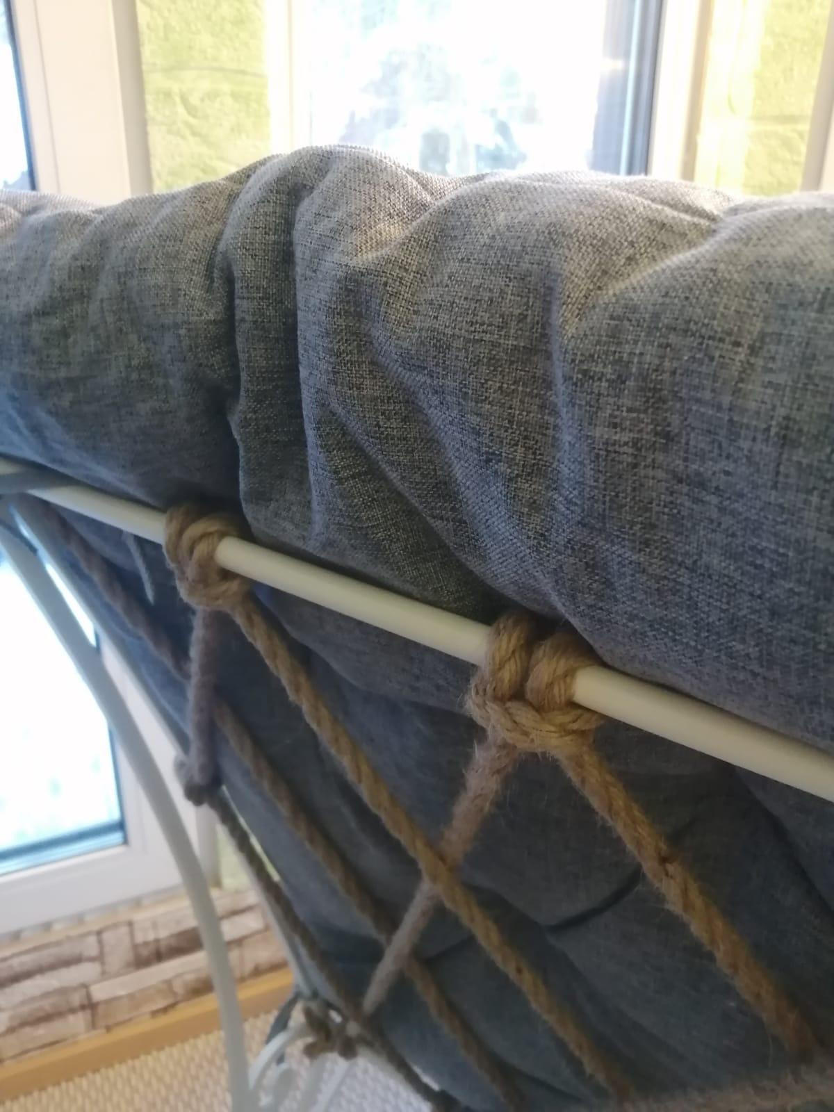

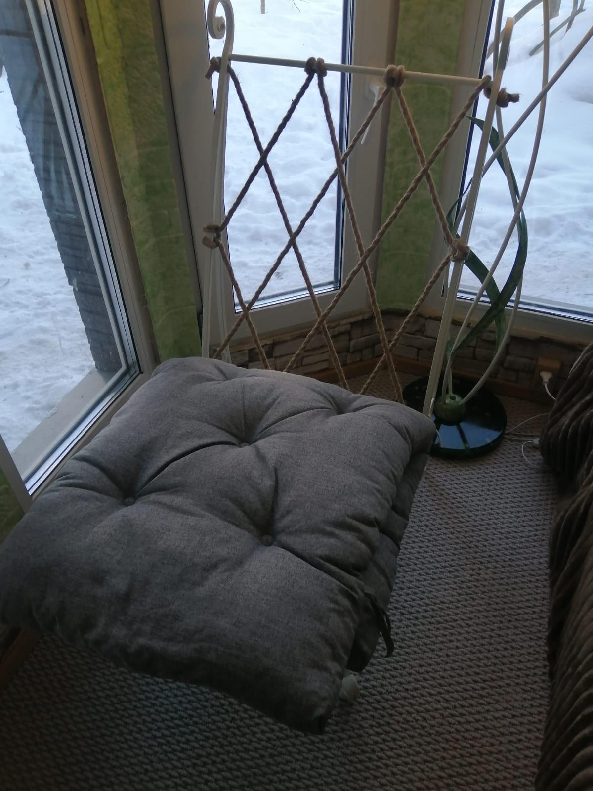

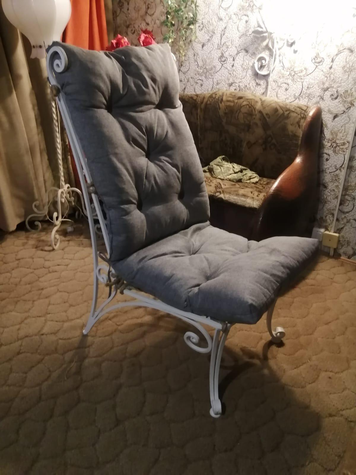

Made a chair. Thanks to the ropes, I was able to reduce the weight.
