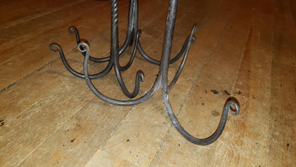

jlpservicesinc Posted March 31, 2020 Author Share Posted March 31, 2020 Anvil, I rarely use scroll tongs for scroll work.. I use them like needle nose tongs, I used them as forms, I use them for bending something that I want a radius in but it's light material where a bending fork is to large. These herb hooks are a great example. they can also be used for spiral wrap. Really handy for many types of things. Quote Link to comment Share on other sites More sharing options...
Latticino Posted March 31, 2020 Share Posted March 31, 2020 I used them the same way until I saw Kim Thomas demonstrate how to use his (which, BTW, are superbly made - robust and extremely functional). He does a lot of primarily ornamental smith work, including Yellin restorations and often needs to make large quantities of very precise scrolls. He uses the scroll tongs to grab the starting point of the scroll up against the premade scroll form when it doesn't have a penny scroll end or tight inside curve that locks against the starting point. The narrow tip fits extremely well into the gap and makes repeatable scroll generation pretty effortless. Quote Link to comment Share on other sites More sharing options...
