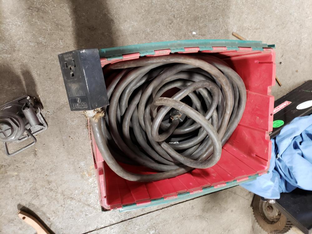

Is there anywhere you can plug in? 220 is really a minimum. There are some 110 welders that are ok, but just ok. Arc welding pulls some power. I used to run my shop off this massive ( and expensive) extension cord plugged into a dryer outlet in the basement of the house. It is 150 ft of #4 3 strand outdoor rated. I think it was around $500 in '95. It would probably be better and more cost effective to upgrade your box, or bring in a new one. I had code issues at the old place that made that a problem.
