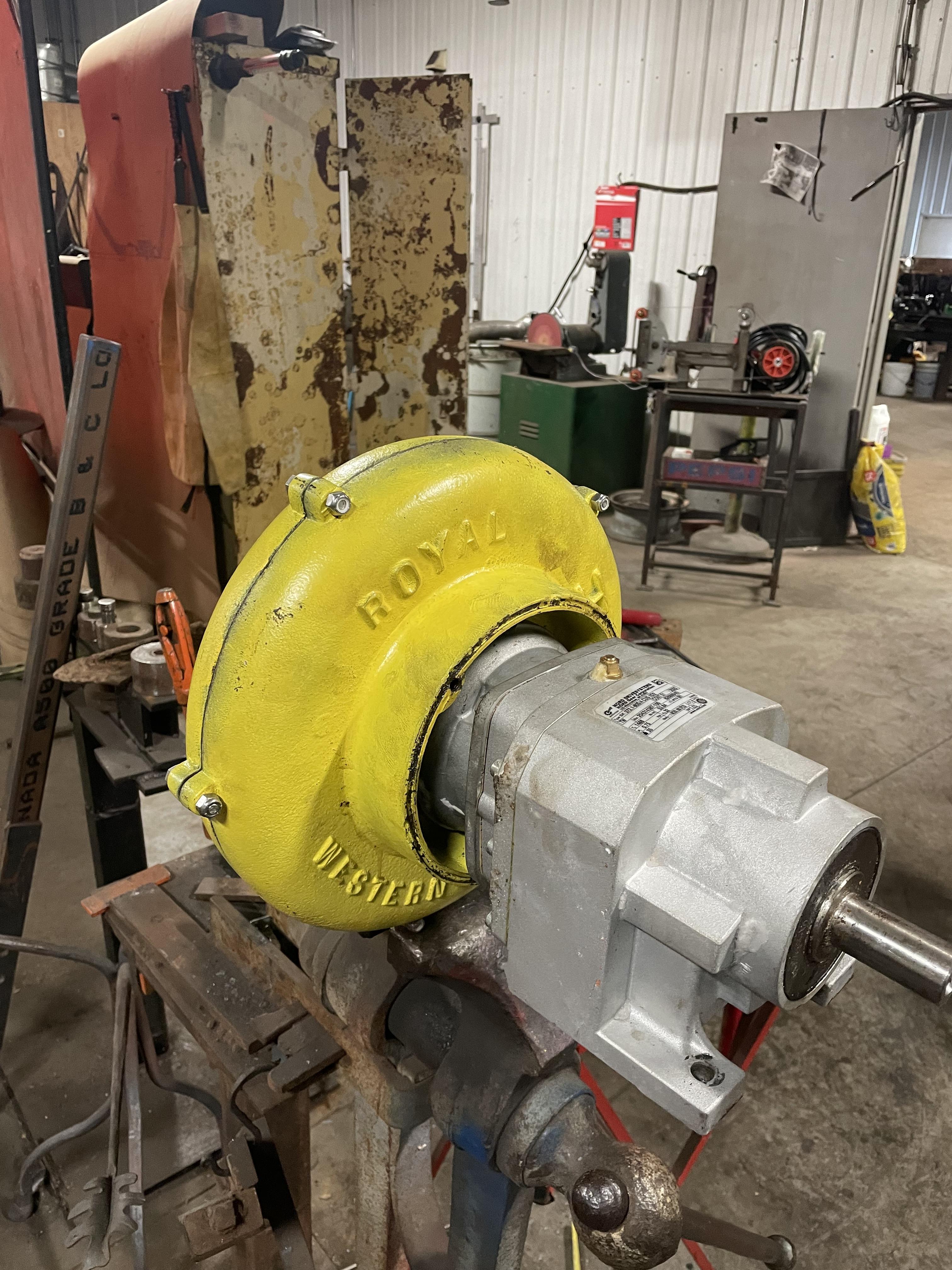

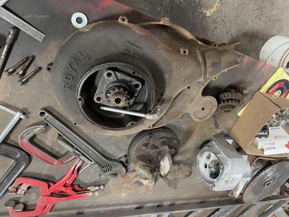

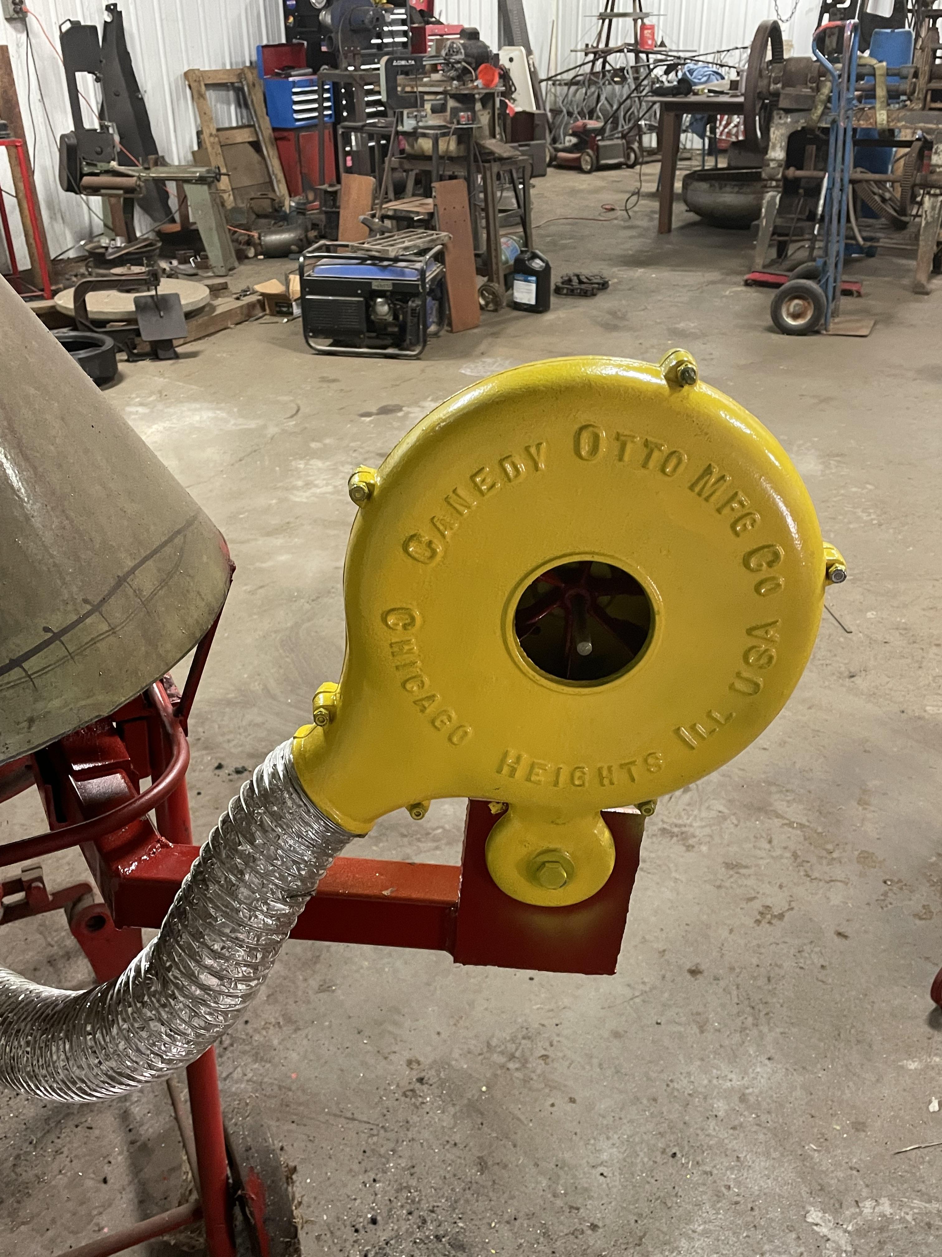

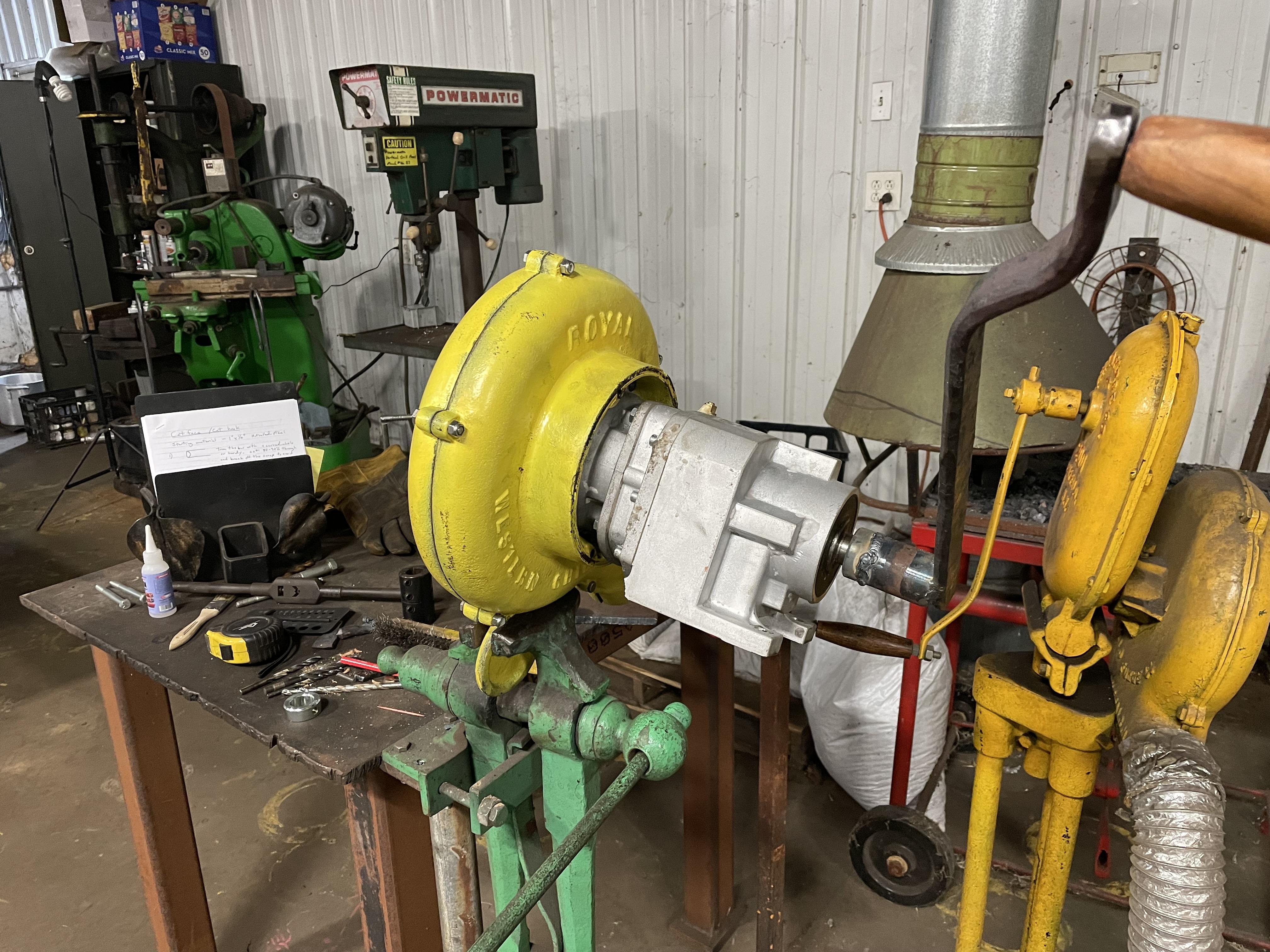

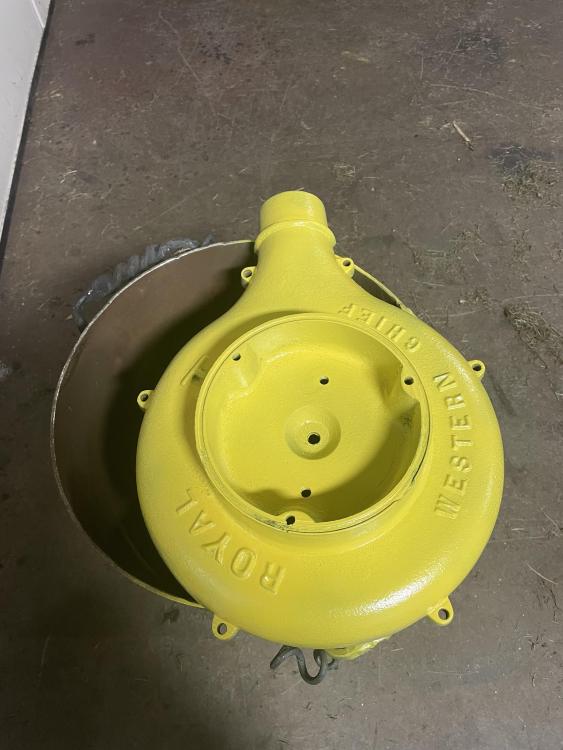

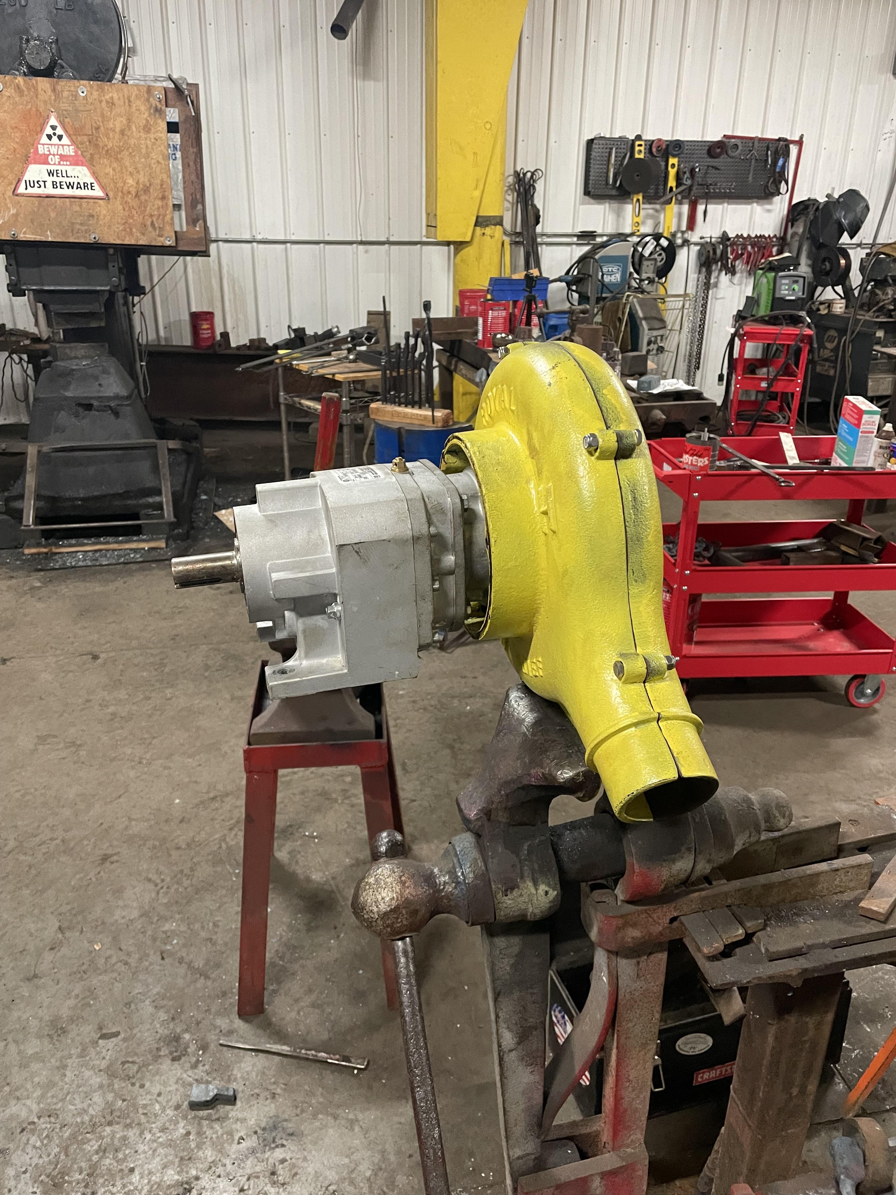

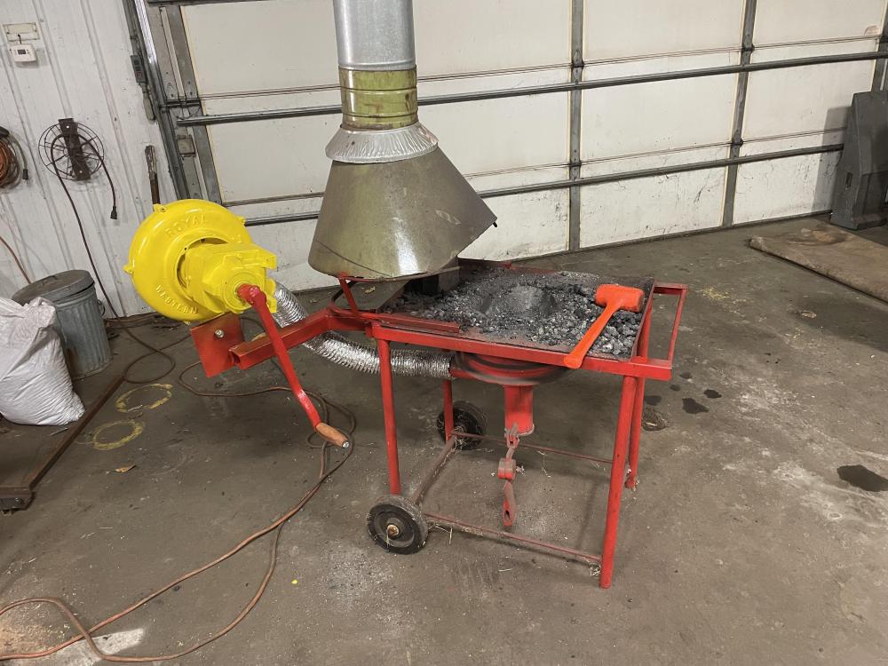

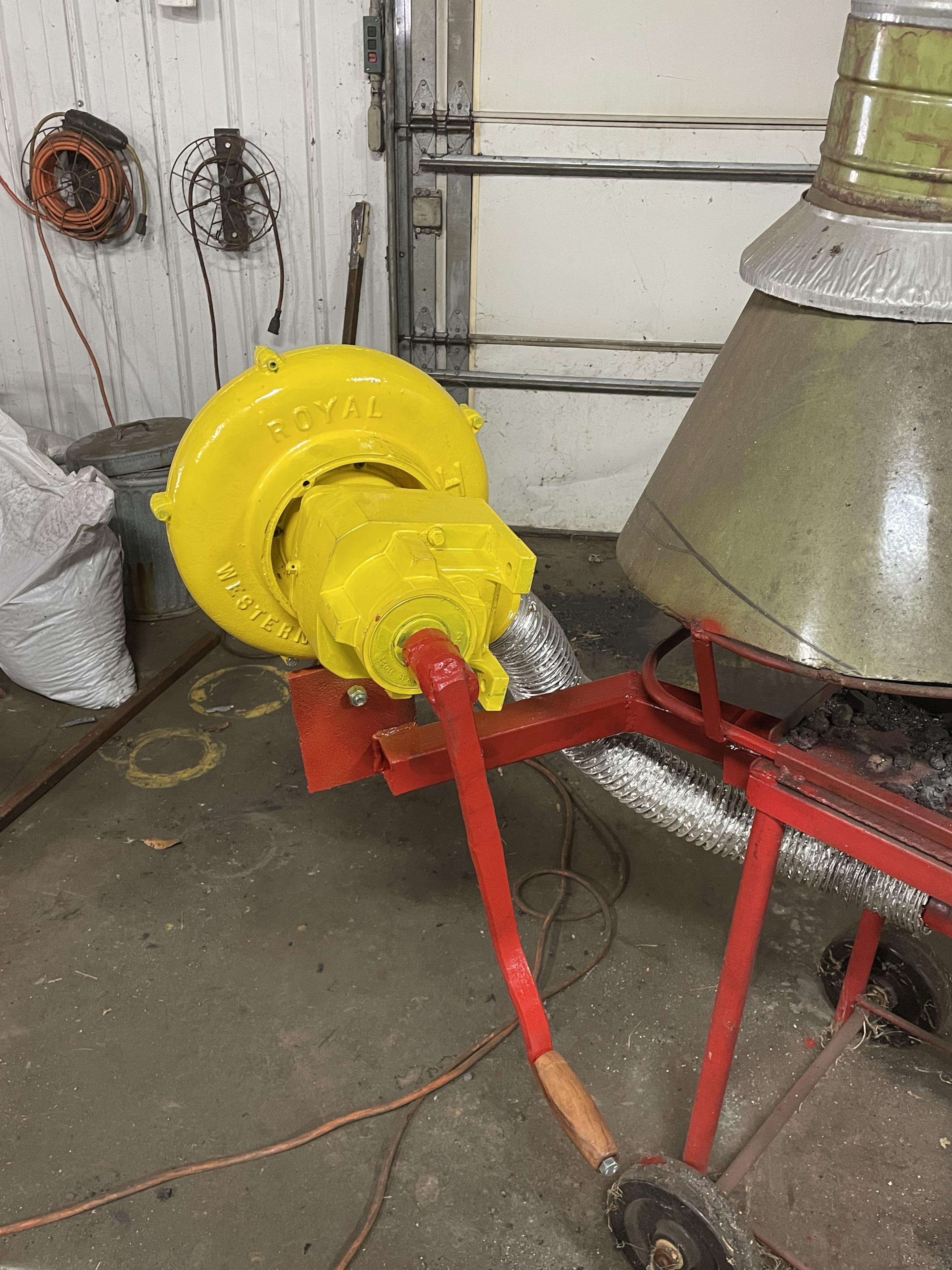

  1. A recently completed project that seems worth sharing…I inherited an old cannedy Otto blower some years ago from a shop clean out when a friend was moving. This poor old blower had lost all its gears and been converted to a belt drive from an electric motor. I needed a hand cranked blower for my portable forge so I piddled a bit with different ideas. Chain sprockets seemed to have potential… then we went through a half dozen gear motors at work in a short span…this is a gearbox off of a sew gear motor. The foot broke off, but it was otherwise perfectly good. It took a bit of fiddling to get it to run, but it actually works pretty well. The original gears would be better of course, but this just bolted into the old gear housing

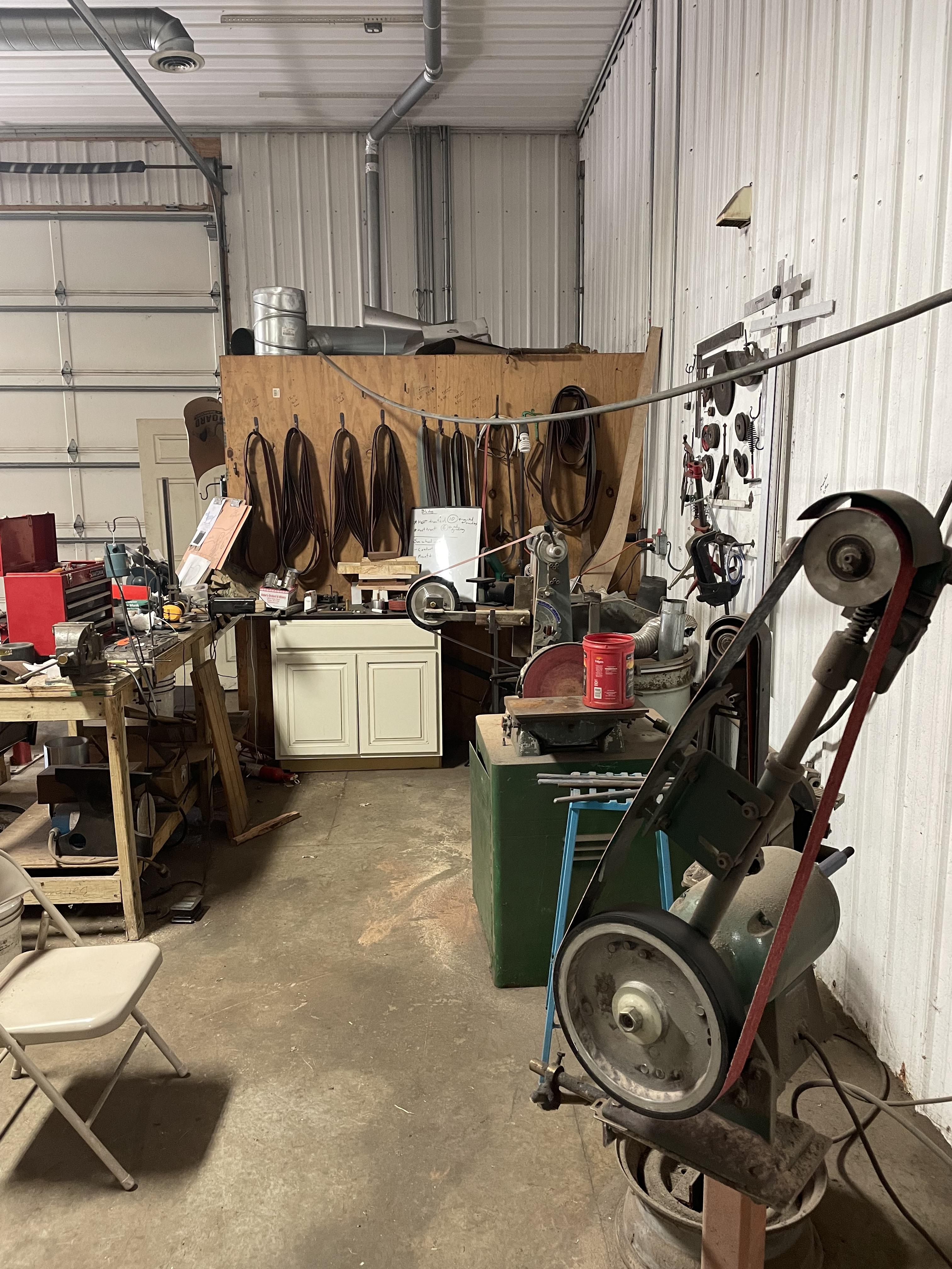

  2. I like the idea of under the floor exhaust lines. Too bad my concrete is already here… the dust hog is outside in the compressor shed it is ducted by two four inch tin pipes overhead. You can see them coming through the wall in the photo I already posted (above my library). I never thought to get pictures, but there are 3 drops on the north and south walls. One is directly above these grinders and was part of the reason to locate them here. I have several of these drums with plans to put a cyclone on at least one and duct to grinders from it to keep sparks out of my filters. I am looking for suggestions too on setting up my grinding area for comfort. I have greatly neglected cold work for a long time and am frustrated by these wide thin blades. ( not really as thin as they need to be) I always ground standing but have seen some who grind sitting. Does it help? The janky nature of the grinder collection I have might be a factor, as is my limited assortment of belts though I feel like it mostly an operator issue. This weekend I am going to try getting some better lighting just for the grinders.

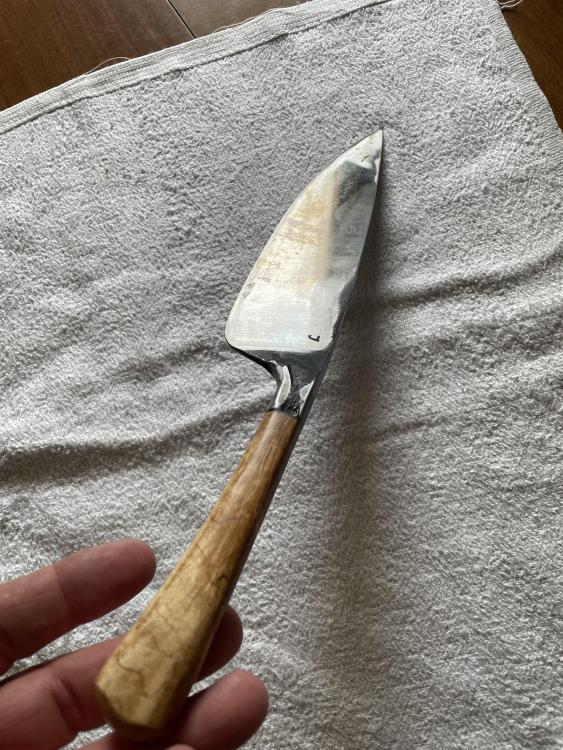

  3. I am playing with kitchen knives and trying to get better at cold end shaping. I have 4 2x72 and a 2x42, as well as a pair of buffers. I have lots of space and a dust Hogg outside with ducting along the wall. I am contemplating setting up half for sitting down and half for standing, at least one to run wet. I currently just have them all lined up along the wall and lighting is not ideal. I suspect there are some tricks to getting grinders set up that makes things easier. Eventually I would like to have a separate room to control dust
