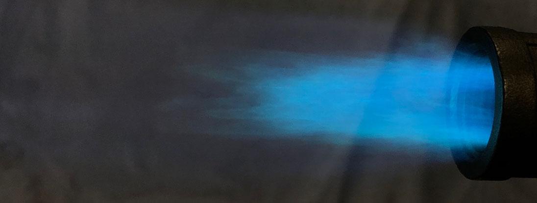

Another FrankenBurner Posted March 3, 2019 Author Share Posted March 3, 2019 Question for Mikey, what lighting is best when evaluating these flames? I am usually in dim lighting when testing as it highlights the zones. Today the sun came out, I was in shaded but brighter sun light and the flame was purple in that lighting. Also, you like the 3/8 burners. I have scaled down v41 to a 3/8 mix tube v42. I don't have the proper mix tubes or nozzles to play with in this size yet. All I have are a 4 inch nipple and a 1/2 inch x 3/8 inch threaded reducer as a nozzle. It runs rich with the 023 but I suspect having the proper sliding nozzle will correct that Quote Link to comment Share on other sites More sharing options...
Mikey98118 Posted March 3, 2019 Share Posted March 3, 2019 Starting out, I liked shaded light best for flame observation, but over time it became clear that anything but bright sunlight would do fine. Your brain learns to interpret what your eyes are seeing. It's just another learning curve. I appreciate what you observed about the purple tinting with a change in background lighting; that is interesting. However, you have taken a long step beyond me. You will need to do a little practical testing for scale formation to see how to interpret the color shift. I suspect that you saw the red of super heated oxygen molecules in that flame, but it's now time to check the results on a steel surface, then change the flame until the red shift is absent and check again. Your eyes are the probes; your mind is the meter. I also suspect that you will end up doing flame retention nozzle experiments to mach them up better with your new burner design; a hybrid nozzle with step and taper both built in. If you begin to suspect I've little more to teach you...you are so right I can't cut and paste on any of the threads anymore; will try to sends you some useful information on better gas tube and MIG tip choices for 3/8" burners. You are ready for miniature gas assemblies now. Quote Link to comment Share on other sites More sharing options...

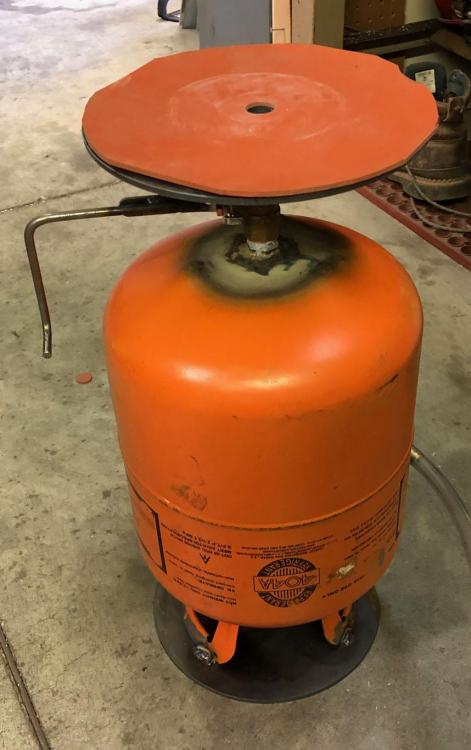

Another FrankenBurner Posted March 4, 2019 Author Share Posted March 4, 2019 I just recently realized I can display images smaller in the post. I am leaving them a bit larger now so they can be clicked on for a better view when desired. Big day today. Finished the vacuum table. Ugly and functional. Tested different investments. Also tested vacuum chamber use for bubble removal. These prints are mostly hollow, it is possible that with a vacuum chamber, we could pull the air out of the void and have investment enter. We tested today by pulling a deep vacuum on a test piece. We also worked on a better nozzle for the 3/8 version. A piece of 1/2 inch pipe was bored to slip over 3/8 mix tube. A piece of 3/4 pipe was bored to press fit the 1/2 inch step. It was a quick and dirty job. We will build some better ones when we get some stainless. We also mostly completed the new big furnace. Now we need to rebuild the little furnace. 14 hours ago, Mikey98118 said: a hybrid nozzle with step and taper both built in I built this guy a while back. I have a picture of it on page 2 (third image). I needed a bigger nozzle and just happened to have a Zoeller flare for a 3/4 inch burner so I made a step out of 3/4 inch pipe. It is the nozzle I always select now. I am wanting to experiment more with nozzles. 13 hours ago, Mikey98118 said: IFI allowed me to cut and past into Birners 101 It has been read. Thank you for the information. I read everything that goes into Burners 101, Forges 101, and the NARB thread. My accelerator assemblies are made from left over 1/4 inch pilot tube pieces. It is a good match for the tip. I turn down the mig tips and braze them. The more common pilot tube assemblies are a 3/16 tube(left in the image). I have lots of left over pieces. I measured an ID of 0.128" and plan on swaging an end to braze in capillary tube. Hopefully it performs well. Quote Link to comment Share on other sites More sharing options...

Another FrankenBurner Posted March 11, 2019 Author Share Posted March 11, 2019 We attempted our first pour. We suspect we were pulling too deep of a vacuum and cracked the investment. It is amazing how much aluminum can be pulled through a crack. We shut off the vacuum and poured to the top. It ended up hideous but we managed to pull a working burner out of it. We have built a bleeder to control the amount of vacuum for the next attempt. I also printed a 3/8 version and a 3/4 version. The 3/8 version has a beautiful flame with the 023 tip and a stepped nozzle. The 3/4 version has not been run yet as I have to get bigger tips. I am curious which tip it will end up needing. Quote Link to comment Share on other sites More sharing options...
Mikey98118 Posted March 11, 2019 Share Posted March 11, 2019 Try thinking of an .0.030' tip in this burner design series as having the flow balance equivalent to .023" in a Mikey burner, so you will end up with either an .030" or .035" tip, most likely. It is encouraging that you can use A MIG tip without resorting to a capillary tube in a 3/8" burner. Simple is a big deal with kit buyers Quote Link to comment Share on other sites More sharing options...
John in Oly, WA Posted March 12, 2019 Share Posted March 12, 2019 What temperature was your flask when you poured the aluminum? Just thinking it might be something else going on than too much vacuum. I have full vacuum (as much as my pump can create) when I'm pouring, but my flask goes from 1470F for burnout, down to 1100F for one hour, then I pour with the flask at 1100F. Don't have cracking problems. Of course, I'm pouring brass, so the temps are different than for pouring aluminum, but the point is don't pour with the flask at room temp and don't cool it to room temp and then back up to pouring temp. That can cause cracks. Now you guys have me reading the Boundary series and looking into the Black Tide Rising too. Quote Link to comment Share on other sites More sharing options...
