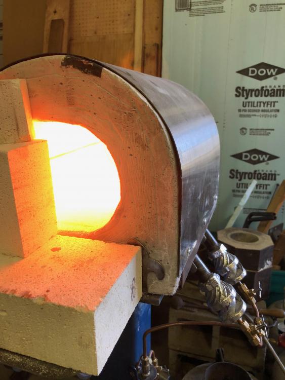

Another FrankenBurner Posted March 22, 2019 Author Share Posted March 22, 2019 We took a couple of the inducers from the last rough pour and pointed them at a forge. Quote Link to comment Share on other sites More sharing options...
Mikey98118 Posted March 22, 2019 Share Posted March 22, 2019 Oh my Look how small the mixing tubes are compared with the size of the forge they're running yellow hot. Quote Link to comment Share on other sites More sharing options...
VainEnd84 Posted March 22, 2019 Share Posted March 22, 2019 That's a thing of beauty Quote Link to comment Share on other sites More sharing options...
Another FrankenBurner Posted March 23, 2019 Author Share Posted March 23, 2019 We were excited to finally put something to a forge to see the end results of all the work. We built that forge large to test the 1/2" burners. I don't remember but I am wanting to say it is in the 450 in3 ball park. We are happy with the performance. The 1/2" burners are nice in that they are so small and their output is high enough for what we are doing with them. My daily driver is a refrigerant jug forge(150 in3) with a top mounted 3/4" modified sidearm burner. The sidearm burner is huge and sticks out like a large arm which sometimes becomes a moment arm. It runs rich enough to show green and has to be turned up enough to cause dragons breath to get to forging temps. I will be putting one of the 1/2" guys into it to see the changes. I am hoping for and expecting fuel savings. These new burners are happy to burn clean in a variety of configurations with some tuning. They can also be turned down very low which will be nice for the idle circuit. With the sidearm, the idle setting had to be set high to prevent the burner from huffing. I have been playing with nozzle design lately. I am up to v4 on the nozzles. I want to understand the dynamics of stepped, tapered, and stepped tapered. This includes playing with the harshness of the step, the angle of the taper, and the length of the nozzle. I also want to understand what happens when the nozzle outlet size is much larger then usual, what the pros/cons are, how large is too large, and why. We are happy with the kastolite nozzles. They can be shaped however desired, they don't oxidize, and they don't transfer as much heat to the mix tube. Here is a half inch burner with a 1.5 inch stainless experiment nozzle: It will heat. I reduced the exposure so the flame could be seen and look at that beautiful blue: At the other end of the nozzle size spectrum, we held the 3/4 burner to the cast nozzles of the big forge. The nozzles were smaller sized(1.25 outlet) for the 1/2" burners. Here is that flame with a cold forge: We didn't have the mix tube aligned with the nozzle very well. The nozzles point more towards the ceiling then that flame is. The kastolite is fresh and that is what is causing the contrasting orange. Quote Link to comment Share on other sites More sharing options...
Frosty Posted March 23, 2019 Share Posted March 23, 2019 Oh MY! That's beautiful. Frosty The Lucky. Quote Link to comment Share on other sites More sharing options...
Mikey98118 Posted March 23, 2019 Share Posted March 23, 2019 What I am seeing in the three photos all agree in my mind as to what is going on here. The top photos shows a flame retention flare almost into the completely yellow incandescence that a Mikey burner can get only from propylene gas (it runs about one-third hotter in air than propane). The second photo shows picture perfect flame from a burner that if I remember correctly has a jet orifice that would be reducing in one one of my burners. The third photo higlights the orange clound of oxidized nozzle particles that your burners are producing because of their extra flame temperatures, if my conclusions are correct, and if the photos show the same pictures that a human eye would. Tentative conclusions are: (1) You now are likely to be running the hottest air/fuel burners in the world--by far. (2) Start working on refractory flame retention nozzles right away; those flames are way too hot form stainless steel. (3) Mikey burners are now yesterday's news. Congratulations, champ Quote Link to comment Share on other sites More sharing options...

Another FrankenBurner Posted March 24, 2019 Author Share Posted March 24, 2019 Thanks guys. They are hot indeed. We now have a few kast o lite nozzles working. We 3D printed forms for the big forge so the nozzles are kast o lite and cast directly in the wall of the forge. We have not had any problems but they have not been in service long. I am now playing with reusable printed forms for the nozzle design experiments. What I am more excited about, I am starting to play with NARB design. My father had an idea for a feed system which he cad, printed, assembled, and it is now in investment for a pour tomorrow. We are attempting 6 in one pour. Fingers crossed. Quote Link to comment Share on other sites More sharing options...
