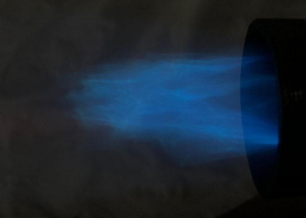

Another FrankenBurner Posted February 19, 2019 Author Share Posted February 19, 2019 The first image of the small flame is below 1 psi. The aerospike really moves the air. I tried to create a semi match of the reducer shape in the spike. Now I want to play with lengthening the ribs a little bit as they were so short the first time around. See if it hurts or helps. I have also modelled what I thought Frosty might have been saying. A thin disc with a smaller spike. I look forward to seeing what a high rotation flame will do when the burner is put into a forge. When you say fins in the nozzle, are you thinking straight fins or something opposing the flame rotation? Quote Link to comment Share on other sites More sharing options...

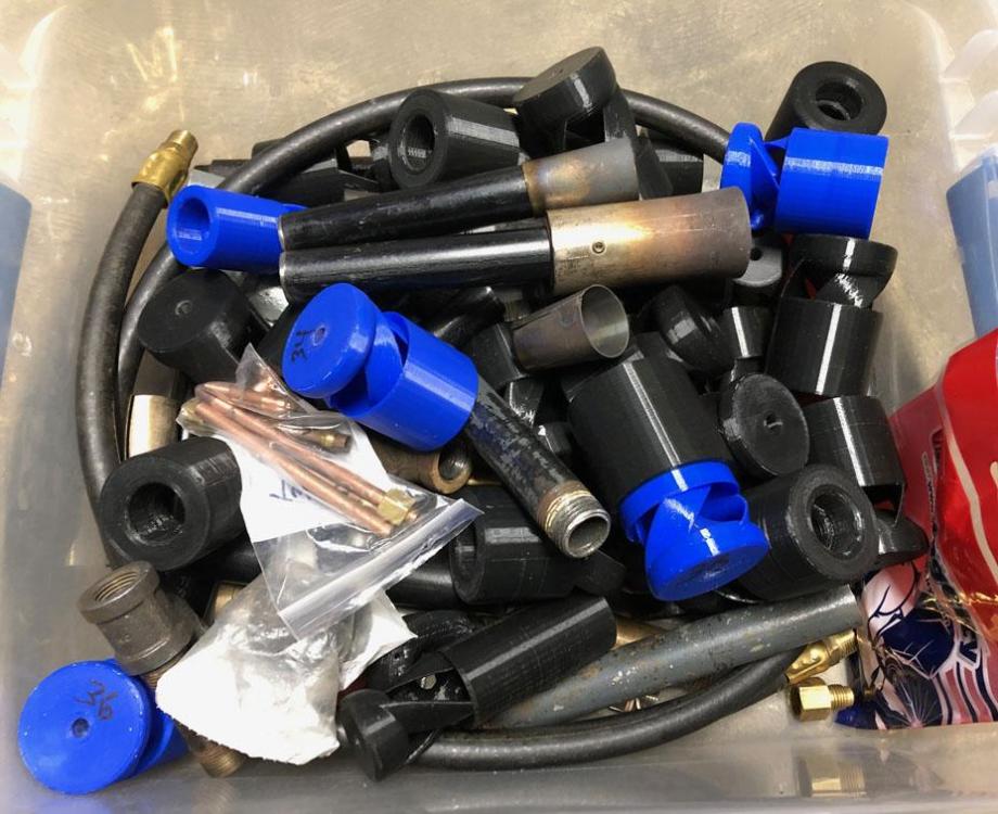

Another FrankenBurner Posted February 20, 2019 Author Share Posted February 20, 2019 I was a bad scientist and I changed more then one thing at a time. I will go back and print each thing in it's turn but I had an idea and went with it. I have enough versions now that the version system I came up with is no longer entertaining so I counted the versions and will be adding them linearly from now on. Here is the new golden boy: He is version 2.7.11 with some changes: The ribs have been lengthened to 1/2 inch (from less then 3/8) The airfoil has been changed to a laminar profile The inlet to rib ratio has been bumped to 60/40 (from 50/50) This burner induces the most air of the bunch. The flame has visible rotation like 2.7.11 but without the instability I was seeing. Now I am printing versions with one change at a time, like I should have, to see what each change brings. V31 is the same but the inlet to rib ratio is back to 50/50. I also intend on removing the small radius at the top of the reducer to see what a sharp edge does there. Quote Link to comment Share on other sites More sharing options...

Mikey98118 Posted February 26, 2019 Share Posted February 26, 2019 The most important figure for me is a stable flame at 2 PSI; that tells me you are solidly on track, to maintain that low a figure in a 3/4" burner size, and still maintain a single flame envelope. You are having your cake and eating it too. This is as good as anything I've seen with ribbon burners, and that is going pretty far Quote Link to comment Share on other sites More sharing options...

Another FrankenBurner Posted February 27, 2019 Author Share Posted February 27, 2019 I'm glad someone else likes these burners too. My wife can only look at so many plastic burners, which look the same, before even the pretend enthusiasm runs low. I think they are getting close now. Most of my recent experiments decreased performance. I still have a few more things to try, then the next step will be a bit more effort towards the casting side. Quote Link to comment Share on other sites More sharing options...

Another FrankenBurner Posted February 28, 2019 Author Share Posted February 28, 2019 I have printed several versions with the ribs at different angles. V38 is now the golden boy at an angle of 80°. I printed 60°, 70°, 75°, 80°, and 90°. V38 is capable of 1-15 psi with the big nozzle and the 030 jet. If I slide the nozzle back a bit, it runs on the peg at a very low output. I am excited about this one. The next one(v40) will be v38 with 5/8" long ribs instead of 1/2". Here is the gauge on the minimum peg with the 030 and much less nozzle overhang: Here is 1 psi with normal overhang: Here is 5 psi: Here is 15 psi: 2 hours ago, Frosty said: Maybe start using different colors? Once you decide on the best burner the others might make marketable Christmas tree ornaments. I should do something. The burner tub is getting deep. Quote Link to comment Share on other sites More sharing options...
