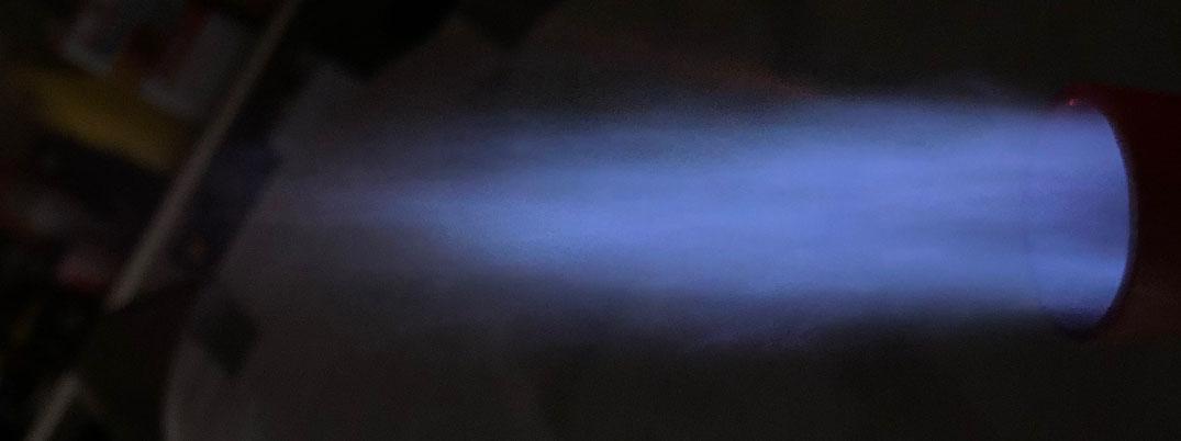

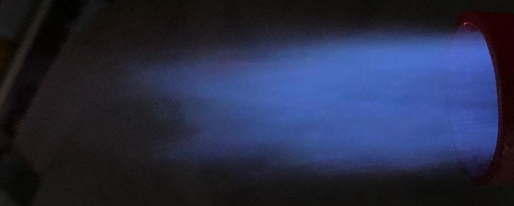

23 hours ago, Mikey98118 said:
which one of the three flame photos at different exposures most closely matched what your eyes saw?
I was demonstrating the difference in exposure.  I was able to take a picture of a purple oxidizing flame which would have been determined rich based on photo alone.  I always judge the flame based on what I witness.  What I witnessed was the nozzle temperature of the left image and the flame of the right image.
Thank you for posting all of your flame reads throughout the forums, so that I could learn to interpret the flames.  Without that, all of these experiments would not add up to much.

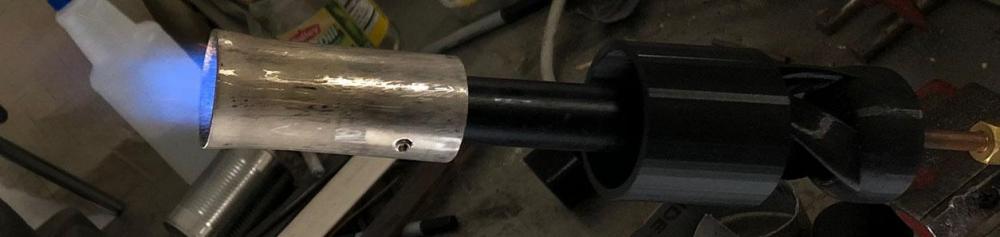

Frosty, I had another thought.  It would probably disrupt the FAM stream but if the entire mix tube were aluminum, fins of some kind could be printed inside the outlet end of the mix tube.  This would act as a heat exchanger to both cool the mix tube and preheat the FAM.  It would have to be balanced to prevent suck back and also melt down.  High output burner melt down sounds like no fun.  I have 2 shutdown ball valves(one at each end), the idle valve assembly, and the final needle valve.  I like safety nets.
I would suggest incorporation a short (4" long) stainless or mild steel section of mix tube onto the end of any cast aluminum mixing tube, for safety's sake; it is generally the last three or for inches of mix tube that really heats up.
We are relying on that for safety net, especially since the prototypes are run in plastic.  For a few experiments we have used shorter steel mix tubes but most of them are 5 inches or so.  As we obtain higher nozzle temperatures, the mix tube transfers that heat.
Once the burner is aluminum and mounted in a forge, we will be making your secondary air choke to control secondary air and block radiant heat out.
I am now playing with larger diameters which will have some hollow space at the mix tube end of the cast.  I am going to experiment with cooling fins, like air cooled engine cylinders, on the outside of the cast.

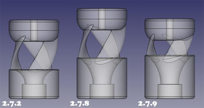

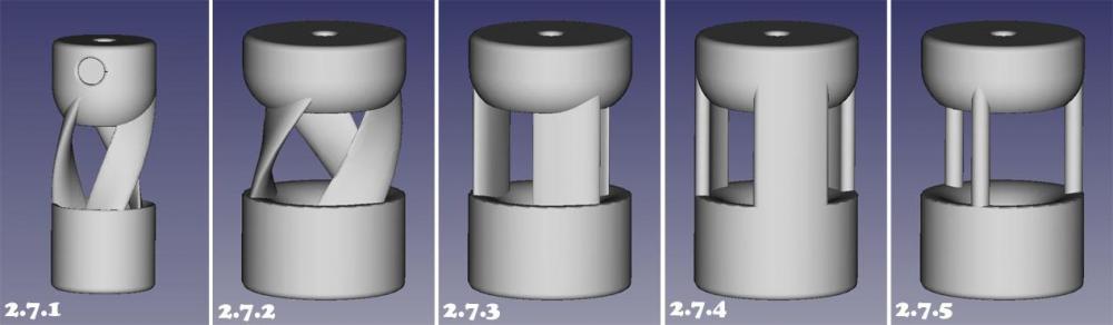

Version 2.7.2 next to version 2.7.1:
It is 1/2 inch larger diameter.  I stretched the airfoil so the air inlets are still 50/50 with the ribs.  I am going to print another with smaller ribs.  I started to tinker with it but ran out of fuel.  It seems happy with the 0.032 drilled mig tip and accepts lower pressures then it's smaller counterpart. .
I don't think smaller ribs will improve the design. Maximum spin will always improve the burner. Excess air space won't in my opinion; of course, I can always be wrong :rolleyes:
  • 2 weeks later...

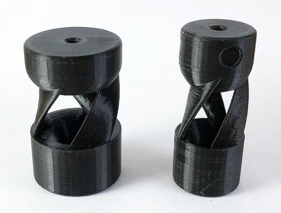

I was able to do some tinkering today.  I had previous CAD and printed several iterations of the larger diameter burner with changes to the ribs only.  The intent was to determine if the helix ribs are beneficial or harmful to burner function.  Below are the burners tested against each other today.
These are all 1/2 inch burners.
Diameter comparison:  Going to the larger diameter is an improvement.  Version 2.7.1 always has a small secondary flame, version 2.7.2 eliminates it for the most part.  Version 2.7.1 can be turned down to 6 psi before it starts to stall and it is burning very poorly by then.  It is happy above 8 psi.  Version 2.7.2 will run below 1 psi but it begins to produce a secondary flame if under 2.5 psi.  It is happy at 3 psi and above.  Both are happy to run above 20 psi.
2.7.2: So far this guy is the winner.  The helix ribs reduce some of the air induced but it is because it is using the energy to add extra spin down the mix tube.  This makes a flame which appears stable and constant.  It induces enough air so it doesn't create a problem.  It is happy with a larger range of pressures without having secondary flame show up.  It is much less susceptible to drafts then the other designs.
2.7.3: Ribs are straight with the same airfoil shape as 2.7.2.  This design induced less air and produces a secondary flame unless at higher pressures.  It was not tested long as it was a poor performer.
2.7.4: Ribs are straight, rounded.  This design induces more air then 2.7.2.  The flame is more turbulent and less stable.  It has obvious signs of spin down the mix tube when looking at the secondary flame.  The spin almost seems to oscillate or collapse which is what causes the stability issues.  It has a fluctuating roar.
2.7.5: To see what would happen with maximum air opening.  Going to the linear burner.  It induces the most air of the bunch, at the lowest pressures.  It has a secondary flame at most pressures.  I guess it is poor at mixing.

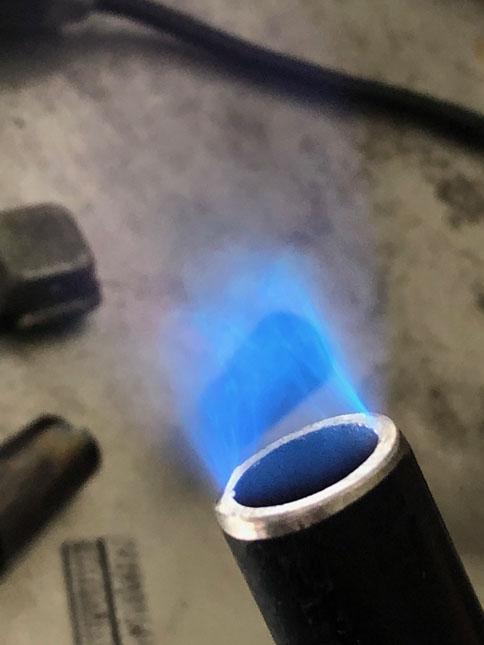

Here are some images of 2.7.2 flames at different pressures.  I like it's wide accommodating range.  Above 5 psi, it needs a bigger mig tip as it induces too much air.  They were all taken shortly after startup to prevent orange in the flame from the nozzle.
Low flame, <1 psi, without a nozzle:
I had a burner flare from Larry Zoeller meant for a 3/4 inch burner.  I made a step out of 3/4 pipe to the 1 inch stainless flare.  This gives me a stepped nozzle which is also flared.
Here is a small flame at 3 psi:
Here is a flame at 5 psi:
Here is one at 10 psi:

Bigger diameter is better, thank you Frosty, you were right.  More spin down the mix tube is better, thank you Mikey, you were right.
So far 2.7.2 has my vote. Beautiful looking flames.
From the orientation of looking down the tube intake to nozzle which way is it rotating, counter clockwise?
It is rotating clockwise currently.  That could be easily changed if you think we should try it.  I printed a previous version in both directions and did not notice a difference in the flame aside from the direction it was rotating.

The current trumpet is approx. 1.7 inch  diameter, 1/2 inch long, and necks down to 0.622 inch throat diameter (1/2 inch pipe ID):
Originally my focus was on inducing enough air as this has been such a problem in the past with burner designs.  The burner being printed with proper shapes makes it easy to induce too much air so it is no longer the focus.  Now the focus is the cleanest burning flame over the largest range of pressures which is still stable.  A few of the burners had a perfect flame at an exact pressure and were very picky about tuning.  I had one burner which produced a purple flame but also had a large secondary flame which I took to mean improper mixing.
I am pretty happy with 2.7.2 so we will be working on casting him in aluminum for some actual forge testing.
