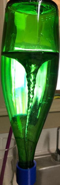

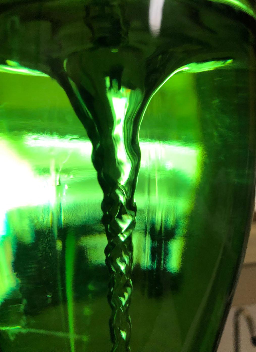

Another FrankenBurner Posted March 1, 2019 Author Share Posted March 1, 2019 V40 is a success. It is happy to run on the peg up through 15 psi without a nozzle adjustment. At higher pressures, the flame enters purple territory with the 030 jet. The rib length was increased to 5/8" which happens to be 0.625", which I find interesting as the throat diameter is 0.622". Several of the measurements which I found best, happened to land very near multiples of the throat diameter. Below 1 psi with the 030 jet, 6 inch mix tube and the 1.25 nozzle: 1 hour ago, louspinuso said: I'm sure people would pay to get some based on the results I'm reading here. I had played with that idea. It would be nice to make back some of the money I have invested in my play to fund even more experiments. I worry about the liabilities of selling high output burners. 43 minutes ago, Mikey98118 said: But, someone is going to build these parts in aluminum too; it's just a given. That is my intention and the next stage in my experiments. My original intention was always to cast these in aluminum. Until then, they are just my toys. We have built a heat treat kiln for burnout and are in the process of building the vacuum table for investment casting. 48 minutes ago, Mikey98118 said: These air chambers would make the ultimate kit part; I would buy one myself! I had wondered if I were to offer just the inducer head in aluminum, if I would still have to worry about liability. Quote Link to comment Share on other sites More sharing options...

Another FrankenBurner Posted March 2, 2019 Author Share Posted March 2, 2019 I am glad everyone likes the burner. I am excited at the idea of offering a product. I will work hard to make that happen. There is still a bit to do. Next steps in my mind: Finish vacuum table Test different investment recipes Modify model to fit commonly available pipe/tube for the choke Modify model to add set screw flats for the mix tube and accelerator (they are friction fit currently) Modify model to deal with aluminum shrinkage Cast this guy in aluminum True mix tube and accelerator ports in the lathe if needed Drill/tap for set screws Test him in several forges (top and bottom mounted) After all that is accomplished, I will have a realistic idea on whether or not I can provide them. After I have made a handful, I will have a better idea of what my cost and labor will be to make these things. After all that, it will be time to play with NARBs. I will have to research the patent stuff. I know nothing on the subject. I printed version 41 today to strengthen the ribs. It's performance is the same as v40. I am very happy with these versions. The next version will be a 3/8 mix tube version with the same design and ratios to see if it can support the 023 jet. Mostly unrelated, researching for these burners had me studying vortices a while back. This led me to building a tornado tube out of coke bottles for my daughter. That wasn't good enough. I searched for the right shaped bottles. I ended up with Perrier water bottles. I designed and printed a connecter which also has the right throat size to produce a powerful vortex in the bottle. Version 4 was successful. I can't stop playing with it. It forms 2 sets of helical lines: It takes a long time to run all the water out: Quote Link to comment Share on other sites More sharing options...

Another FrankenBurner Posted March 2, 2019 Author Share Posted March 2, 2019 I am printing a couple more versions of the vortex connector tomorrow, then I will post whichever wins. Quote Link to comment Share on other sites More sharing options...

Another FrankenBurner Posted March 3, 2019 Author Share Posted March 3, 2019 4 hours ago, Frosty said: What are you calling these things? If you are talking about a name, I've never thought about it. I figured a name would come about on it's own. If you are talking nomenclature, for a while I called them burner heads and I have also called them inducers. Mikey refers to them as air chambers. I am up for any suggestions. Preferably facetious. I got threads and pinned threads... now sub topics. Being ignorant always makes simple things seem complicated. 2 hours ago, Mikey98118 said: I think threaded pipe nipples could be a plus. That is what I will shoot for. I will make a fancy fitting. It seems more DIY appropriate. Quote Link to comment Share on other sites More sharing options...
