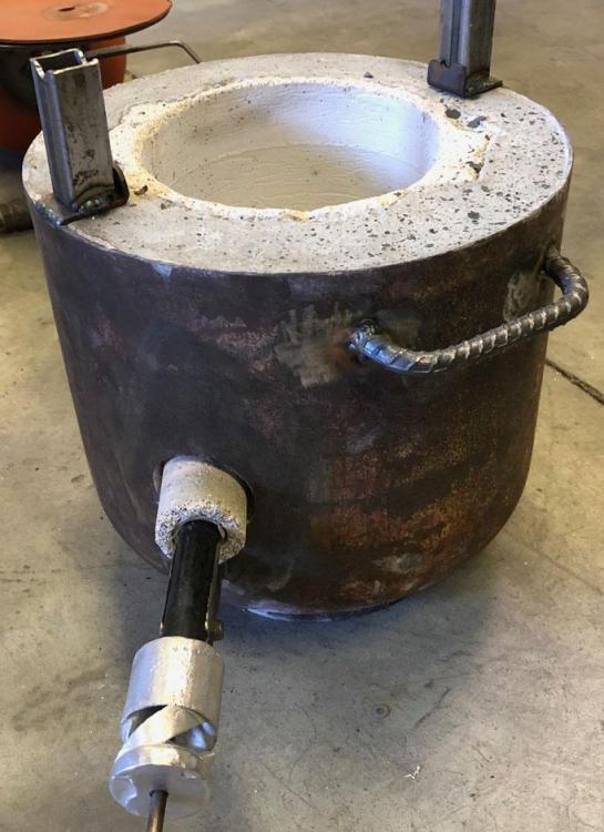

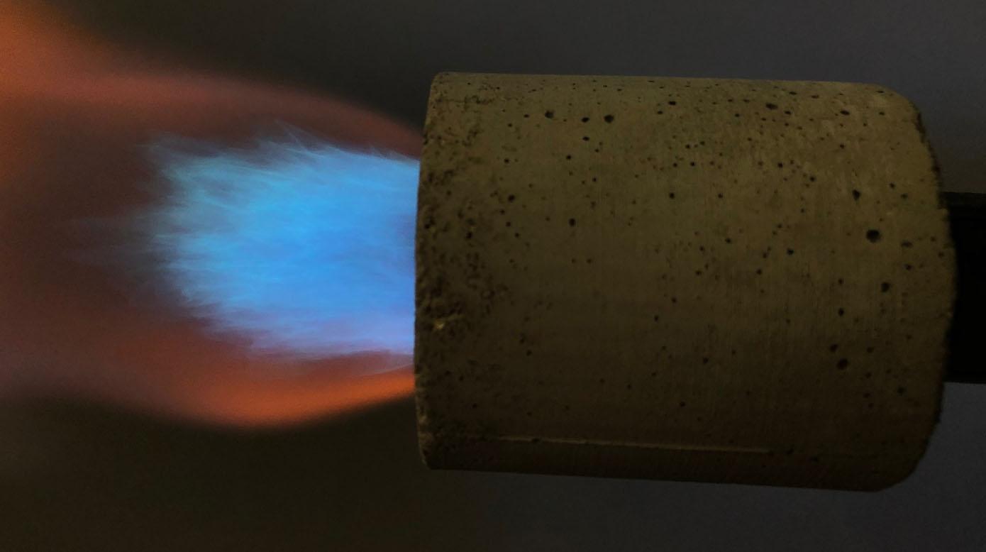

Another fun Saturday.  We finally played with the 3/4 burner.  He ended up getting the 045 jet.  This flame is at 4 psi and the nozzle ends at 1.5 inch.  It's a big slow flame.  The orange is from the kast o lite nozzle.
Here is 10 psi:
Here is the 3/4 guy:
It still needs some tinkering, more nozzle experiments, and the mix tube is too long.  When the nozzle matches the inducer, the final FAM stream is slowed, the jet size is increased, and the induction volume curve matches the fuel volume curve through fuel pressure range.  We 3D printed a thin form for the kast o lite to make this nozzle.  A 1:12 taper after a step.
We made 4 more flasks and 3D printed bottoms which include the funnel/sprues for the inducer.
We had obtained a dilapidated larger kiln and rebuilt it, so today we poured 5 experimental investment mix flasks.  We ran the furnace with the ugly salvaged 1/2 inch burner from the last pour.  We are happy with how it runs.
We have pulled out working burners but they are not good enough yet.  Investment still needs work.  The burners have porosity problems.  A good learning day.
0.045 mig tip jet on a 3/4" mixing tube? Oh MY. :wub:
Yes, Frosty. I noticed to. It seems the young scamp will end up with the best parts of your flame, and the best parts of mine :D
It exceeds my best attempts for sure, I've always pushed for the most fuel air I could force into the forge per second I could. The limiting factor has always been inducing enough combustion air.
The only thing that takes it out of my design parameters being these aren't minimum equipment and skills home builds.
I want at least one once Curtis is ready to share. :)
I have waited twenty years for the next big leap in burners; its time to see it--finally.

I'm glad you both like them.  It is exciting.  I think I have the inducer ratio's tuned in to a point I am happy.  I have scaled to the 3/8" and the 3/4" with the exact same ratios and they both do very well.  More air can be induced but then the mix tube velocity starts to scream and the induction volume and fuel volume curves don't match as well.  I think I have found a nice balance for a stable, well ranged, versatile burner.
The gentle nudges in Burners 101 were not lost on me, I will be scaling to the 1/4", just for Mikey.  I will have to change up the jet assembly for that small.
I am also starting to tinker in the NARB side of things.  I am as excited about playing with NARBs as I was about playing with inducers.  I know almost nothing about their dynamics and look forward to becoming acquainted.
Catchy name?  I kind of like Frosty's "Twisted Gizmo."  Others have referred to them as vortex injectors or vortex inducers.  I'm up for suggestions, I didn't put much mind to it.
We are getting close to aluminum inducers.  A few poured yesterday are now functioning burners.  Just ugly.  One total failure is now a burner shaped candle holder.  Big flames coming out of that one.
