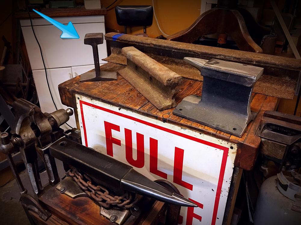

As I'm finishing up the mounting of my anvil & it's base I was wondering if anyone has added an upsetting block to their anvil base.
If so what is the thinnest you would consider usable?
Anyone have photos of their set up?
Arrow indicates where I'm interested in installing one.
You know, that's a dang good idea Grumpy!  I'm getting ready to get a stump level to mount a Fisher on and I hadn't thought about that but I like the idea a lot so I think I'm going to steel it.
I was wondering if I could make a stake style upsetting block out of this 3"x3" piece of RR track by cutting off the flat bottom & shaping it into a stake.
Then driving it into the Anvil base.
Opinions ?
I was going to do something similar. I was going to use a sledgehammer head instead of a piece of track. I would assume that your plan would be fine.
I'm more thinking about a solid bock of steel cut to fit with counter sunk lags holding it in.  The lags may not be necessary if the fit is tight enough and a router is used to sink it into the wood stand.  For good measure some clear silicone could even be used to dampen the sound and keep it in place.

Grumpy, i think your idea will work fine with just a short spike needed. After all its just small stock. I just use my anvil to upset " shorter" pieces but if I have long stock I do have a thicker plate I use on the floor. It can be put away somewhere when not in use.
I should have been more clear.
Most of your upseting will be done on your anvil face.
If your piece is too big/tall to upset on your anvil, put something on the ground and do it there.
If you drive anything into that nice piece of 4"x4" endgrain, then your upseting will split that pretty finished wood right out.

A thought:
if you can cap your wood anvil stand with a piece of 1/2” -1” steel plate, you could then either weld your upsetting block to it, or tap blind holes and screw it from the underside.
If your upsetting block mimics the side profile of your anvil and fit between the feet the whole thing will be tidy and very robust. The weight of the anvil on the plate, especially if siliconed and bolted to it, and the plate lag bolted to the wood, it would be the next best thing to an integral block.

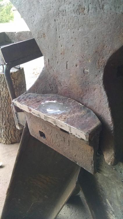

The block attached to the side of the anvil is my least favorite because it doesn't have substantial mass though it is attached to the anvil and it is supported well from the bottom but I can feel it deflect with each heavy blow of the hammer..  it is however very convenient..

You have ample room to take a thick plate and shape it to fit between the feet of your anvil  and use a longish stake going into a hole to hold it in position..  it will bounce around but it being held in position is the most important part..  By using a larger plate it will also distribute the pressure into a greater area which will help the block stay together longer..
Use the anvil and stump for awhile.. Re tighten the bolts.. Make the plate and then heat it up and burn it into the block.. This will get you the most contact.. put the stake on and put the hole in.. the pin can be round if the plate is fitting between the feet will keep it from turning..   Throw a layer of silicone on it and then set it into the hole and weight it to squeeze out the silicone..
It'd look for 2" plate or 3" if you have a way to cut it or form it.. The more the merrier..
