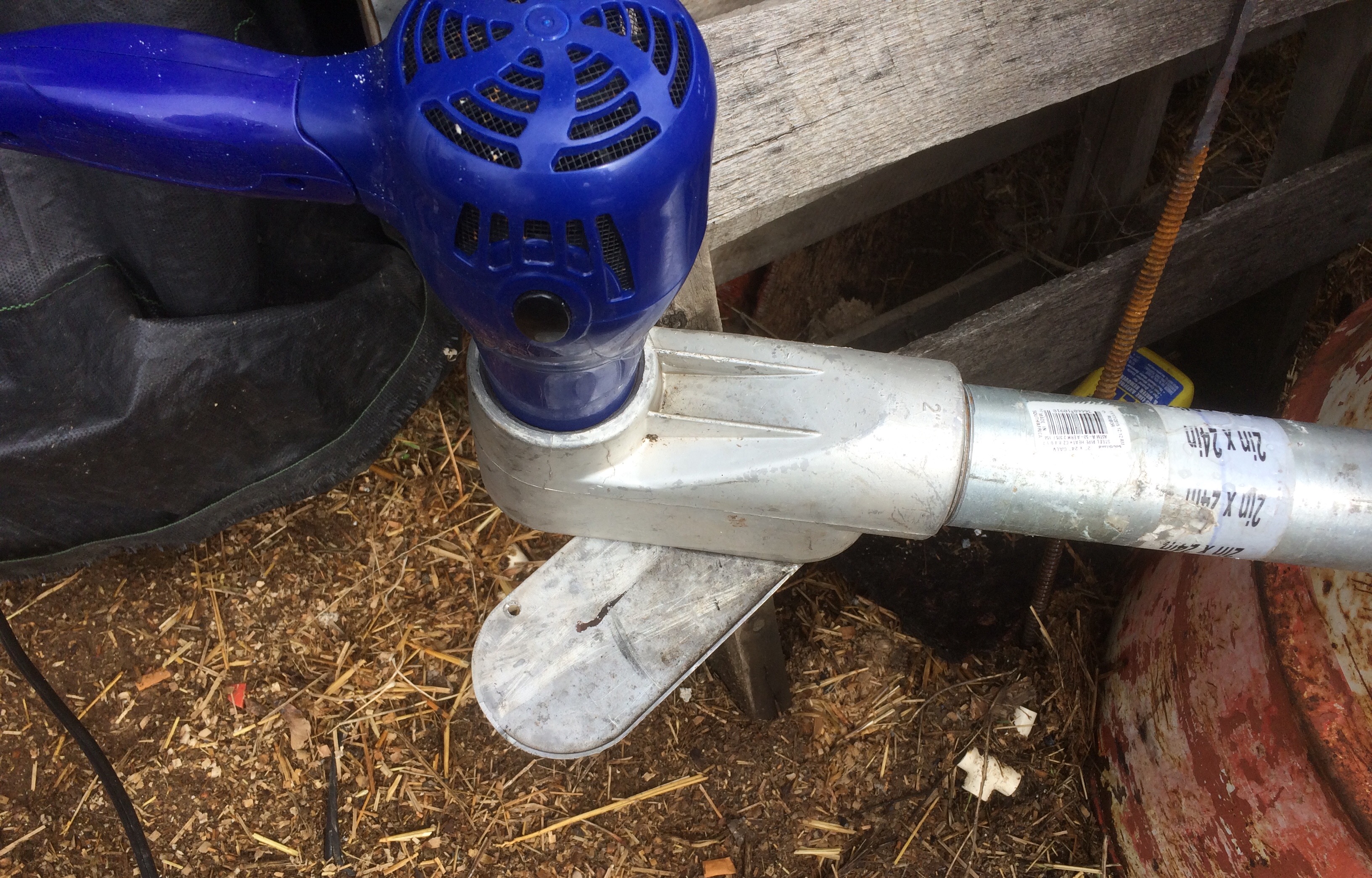

ryancrowe92 Posted November 6, 2017 Author Share Posted November 6, 2017 Ok Bad News everybody this thread is going to stay open a little longer. Ok so here's what went down this weekend. Well I didn't get the coal this week it will be around this Friday or Saturday when it will be in. well I went to pick my brother up Friday afterschool I had to go to the welding shop I bought a special wrench for welding, a few hose fittings and the tank of oxygen so the torch is now back in action. After that I picked my brother up and we stop by Lowe's for some wire and then I headed to harbor freight and I bought another welding helmet for my brother to use when he's over, I got a reciprocating saw and it was a good $20 well spent I bought a new heat gun that I'm gonna take back and replace because I melted it again I need a good air source that isn't overpowered and I got some vise grips. now for the big bad news The forge needs work to be done the pipe I got, got red hot from being in the fire before melting the heat gun does anybody have a way to keep things from going back thru the pipe If I make it a vertical shaft because the pipe is a little to big. but there is good news I got one good heat on the rebar and was able to shape it a little more but it still bends but I think I can fix that In the vise or on the horn of the anvil when I go to shape the thing. so with that out of the way I'm gonna say I got to do some work outside today and clean out the forge and find a new air source that wont melt. Quote Link to comment Share on other sites More sharing options...
olfart Posted November 6, 2017 Share Posted November 6, 2017 If you use a heat gun as an air source, you're wasting electricity. A plain, cheap hair dryer will put out plenty of air, and you can bypass the heating element to run even cheaper. Feeding the fire with 1,000 degree air from a heat gun may be part of the problem with your air inlet pipe getting hot. Also, the pipe should not be exposed to the fire, it should be surrounded by the dirt /clay to shield it from the heat. Quote Link to comment Share on other sites More sharing options...
Charles R. Stevens Posted November 7, 2017 Share Posted November 7, 2017 Ditto, ditch the heat gun, infact the hair drier will be to much air (and noisy) honestly it's hard to beat that $10 double action bed/raft inflator. Some newer microwave ovens have squilfans that are quiet, pancake fans from computers (some squirrel cages exist) quest bathroom fans work very well... little brother some times... Quote Link to comment Share on other sites More sharing options...

ryancrowe92 Posted November 9, 2017 Author Share Posted November 9, 2017 ok question my metal pipe is also getting hot, now its hot enough to melt the gun and I'm going to bypass the heating element in the thing and I cant use my grandma's hair dryer that's why I bought the heat gun and I have another one that I'm reverse engineering to take out the heat element. now hopefully I can pick up my coal this week by Saturday at the latest I still don't know yet, I got to check my cash too. now some time I promise to put up pictures but I just keep forgetting. so have a good Thursday Quote Link to comment Share on other sites More sharing options...
