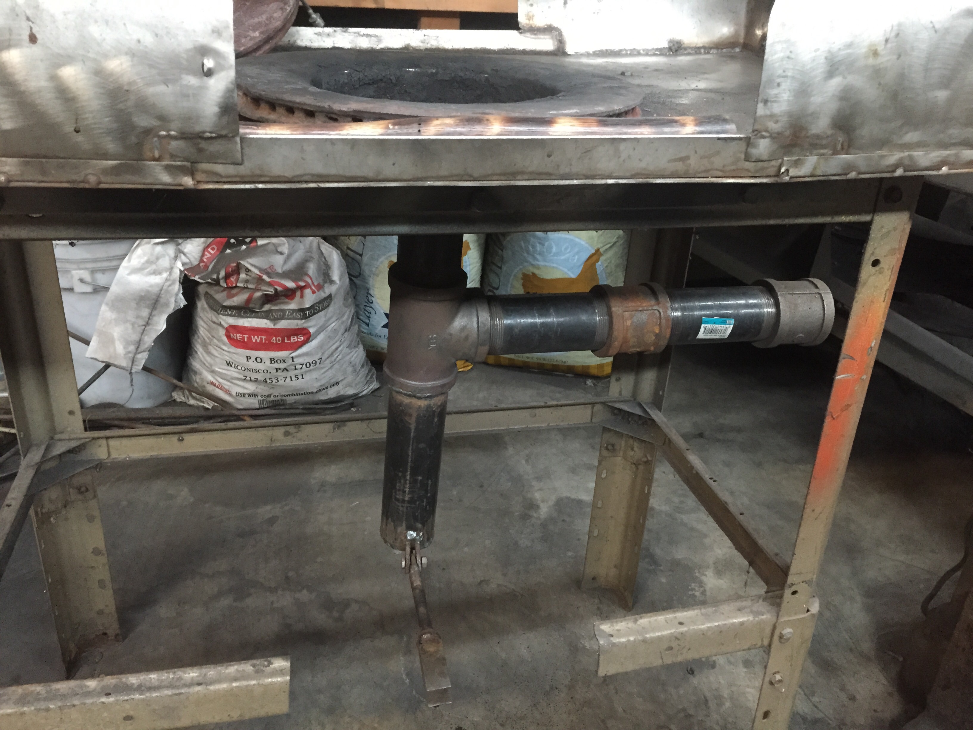

ryancrowe92 Posted November 16, 2017 Author Share Posted November 16, 2017 ok @Charles R. Stevens I'm gonna get a brake rotor then I'm going to go to the ace hardware to get some pipe nipples a tee and an endcap, plus a flange to put on the rotor the flange is going to be welded to the rotor then the pipe threading will do the rest with the help of some thread tape. After which I shall pick up my brother on Thursday thanksgiving with hopefully a load of coal on the back of the truck and at which point we will begin disassembling a lawnmower to get the mower deck off of and then proceed to use the oxy-acetylene torch to cut a hole in the deck making a table then spot welding that with a mig welder. then finding some steel to make the legs is a problem I haven't solved yet. Quote Link to comment Share on other sites More sharing options...
ThomasPowers Posted November 16, 2017 Share Posted November 16, 2017 Don't need steel legs, drill holes and bolt to 2x4's will work. Quote Link to comment Share on other sites More sharing options...
ryancrowe92 Posted November 16, 2017 Author Share Posted November 16, 2017 good idea Quote Link to comment Share on other sites More sharing options...
Daswulf Posted November 16, 2017 Share Posted November 16, 2017 You do Not need thread tape. In fact you don't even have to really tighten the fittings. Just hand tight is good. For the bottom ash dump you can pick up an exhaust flap cap at tsc and weld a bolt or something on it to weight it closed. Because 1 it will be upside down and 2 so you can lift it to dump the ash and clinker that accumulates in there. Quote Link to comment Share on other sites More sharing options...
ryancrowe92 Posted November 16, 2017 Author Share Posted November 16, 2017 would sheet metal with a hinge work Quote Link to comment Share on other sites More sharing options...
ThomasPowers Posted November 16, 2017 Share Posted November 16, 2017 with an arm & weight on it to hold it closed, yes. Quote Link to comment Share on other sites More sharing options...
ryancrowe92 Posted November 16, 2017 Author Share Posted November 16, 2017 good I got some sheet metal Quote Link to comment Share on other sites More sharing options...
Charles R. Stevens Posted November 16, 2017 Share Posted November 16, 2017 2" pipe fittings will cost you about $50-70. I thought you were going to weld up a tuyere? Quote Link to comment Share on other sites More sharing options...
Daswulf Posted November 16, 2017 Share Posted November 16, 2017 Yeah, I made mine. I just mentioned the flap cap because it's easy and you seem to like spending money. Lol really it already has the part to attach it. But making one isn't hard either. Pictured below is the one I made. It could be nicer but I was in git-er-done mode. It works great. Quote Link to comment Share on other sites More sharing options...
ryancrowe92 Posted November 16, 2017 Author Share Posted November 16, 2017 Cool Forge the pipe is going to run around $50 at ace hardware Quote Link to comment Share on other sites More sharing options...
Daswulf Posted November 16, 2017 Share Posted November 16, 2017 So, you have a welder... Why not spent that money on something like good forging steel or coal and weld up a T out of really cheap or free pipe. Quote Link to comment Share on other sites More sharing options...

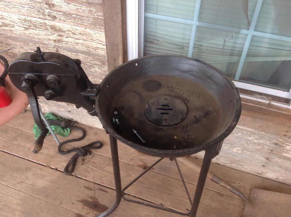

Charles R. Stevens Posted November 16, 2017 Share Posted November 16, 2017 I priced 2" black pipe fittings about a month ago, 2" fittings and nipples ran about $10 each (some more some less). Reason one I am not a fan of the brake drum/rotor forge. Folks assume its function, there for I must be talking out of my butt. Nope, it's expense, tools and time to fabricate a usable forge plus not being particularly charcoal friendly. Some times you just don't have coal or it is so "dirty" it is hard to weld in or it causes unwanted changes in tool steel, so it's still a fuel that you should keep in the back of your mind. Infact let's examin bottom blast forges a moment. In the below pictures do you see a fire pot? Not acualy a nesesity. I know we have shown you Glenn's simple 55 forge and him fabricating a tuyere out if exaust pipe. A local exaust shop would probably fab up a tuyer for you cheep, or having a torch and welder a piece of 2" thinwall square pipe becomes a tuyere fast enugh. In the example Das shows you he is using a rear rotor with a drum style parking break. Quote Link to comment Share on other sites More sharing options...

ryancrowe92 Posted November 16, 2017 Author Share Posted November 16, 2017 I think I have a piece of 2 inch that I can weld and put on some clamps to hold it. just have to get 2 nipples and the tee plus flange Quote Link to comment Share on other sites More sharing options...
Charles R. Stevens Posted November 16, 2017 Share Posted November 16, 2017 In the above example the cast iron pan is not nessisary, if you clay a drain pan (to keep the galvi from burning off). the reason I continue to advocate the sideblast is that 3/4" schedual 40 pipe is easy to come buy, and even if you have to buy a nipped it's less than $10, add on a $10 pump and a $10 oil drum... the only thing you probably have to buy is a $10 pump and scrounge a couple of pallets. We where we are at here? You have little money to spare and you want to spend $100 fabbing up a forge wile I can scrounge up the parts to build one as effective for $20 (if I buy the tuyere Why the niples, "T" and flange? $10 each remember? If you cut a piece of 2" pipe in two pieces, cut a hole in the side of one close to the end and cut a fish mouth on the other so they fit close enugh to weld up you have tuyere. It can be welded to a piece of plate (1/8" is plenty thick) or just weld two nuts to it to attach to the bottom of a tub. It can also be Barrie's in a box of dirt with one end sticking out the side, the other out the bottom and dirt filled in untile the top of the other end is flush with the top of the dirt. You seem to be locked in to just one possibility, I think you saw a you tube video of some one building a brake drum forge and now can't see any other way. I get tunnel vision like that some times too. Quote Link to comment Share on other sites More sharing options...
